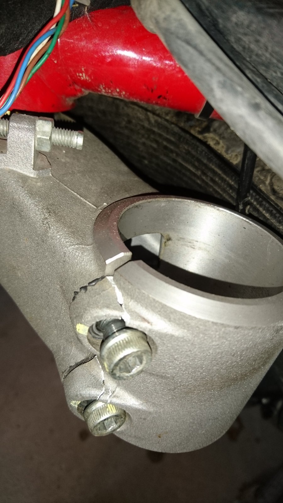

    Went to install the forks last night. Got everything lined up and started to torque. Not sure if my torque wrench is buggered or if I just didnt feel the click, but I heard and felt a click then did the next one and same..but it was a different click...I looked closer and got a nice wave of sickness race thru me.
    So now I'm on the hunt for a replacement. ARGH
  2. Well that's disappointing. I wonder if they can be welded?
  3. Its cast. Replacement time! I was so excited about getting the bike back together and maybe getting some test time. Totally bummer
  4. You can weld cast aluminium
  5. excuse for some mag ones ;)
  6. Thats what all my racing buddies are saying. Big unexpected budget hit :(
  7. Same as the old 916 yokes. Buy the cheap(er) showa ones and get them opened up. :upyeah:

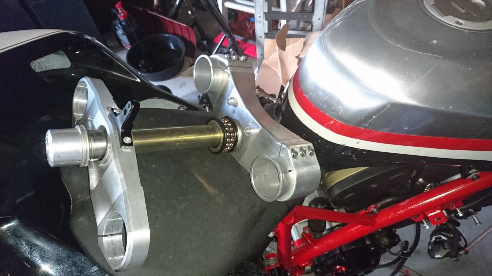

    Had a fun time. When I first picked up the triples, I couldnt get the bearings and race off the top. Contacted the seller and he seemed puzzled..'they should just slide off' he told me. So last night I try again and sure enough they just slid off. I'm figuring the difference in metals and expanding from heat made them tight when I first got them. Oh well..happy for me!
    Next I had to remove the Ohlins dampener from the old triple. WHAT A PAIN.
    It's like taking a puzzle apart! Got it done and went to mount on the new triple. JOY! The bolt was too big for the triple! Tap and dye set out and got to play with that. Finally got the hole threaded to the larger size and started putting everything back together.
    I love the Ducati triples. No castle nut to fight with! Able to adjust without going crazy!

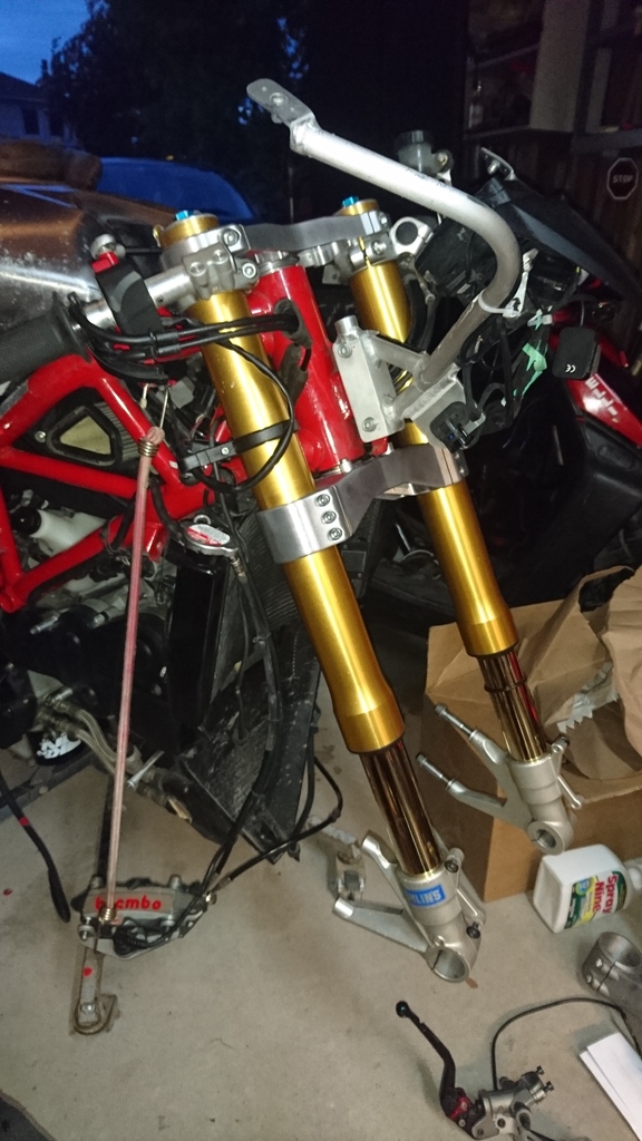

    Anyway, triples on, forks on, clipons on....then discovered clutch side wiring/lines were routed wrong. DAMN! Off the fork came to route it the right way.
    Got everything buttoned up and was trying to connect the throttle wires to the throttle. Wasnt happening. They were fighting me. Took the master off to make more room...still fighting...little voice in my head said stop for the night or tools will be thrown...so thats where she is. Bit by bit getting closer to coming to life.

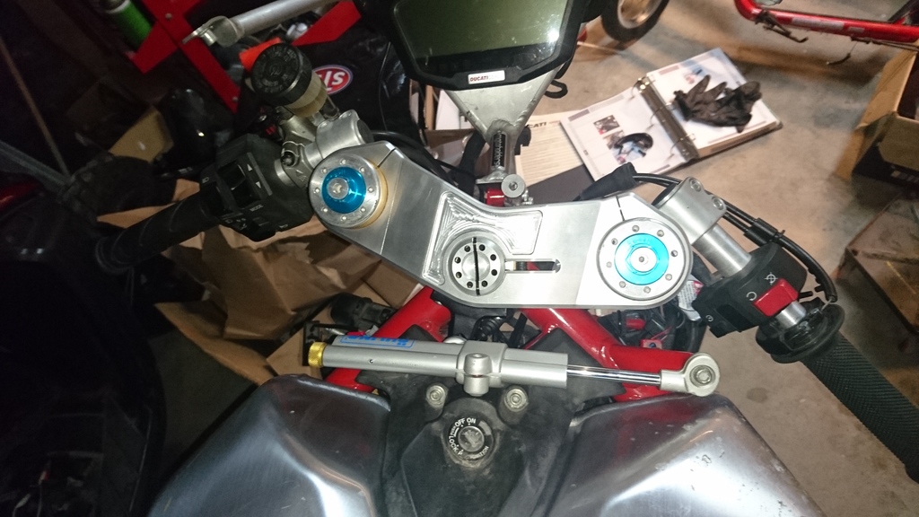

    [​IMG] [​IMG]

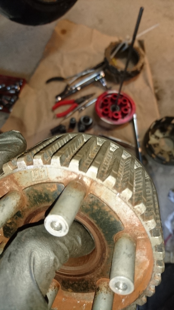

  18. Clutch was still not disengaging properly. Decided to remove the clutch and check everything out. I was told by previous owner it was a Ducati performance slipper. Took it apart but never seen a slipper like this one. Looks stock to me..in rough shape too :(
    Heres the basket
    and hub

  19. Clutch looks std. :(
  20. Clutch looks like it's rogered ! Andy
