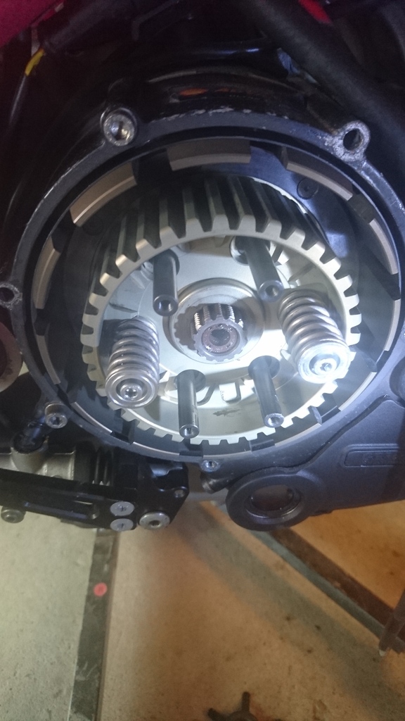

  3. Often this breakers do lie, it's true. But often the uninitiated see a shinny clutch plate and leap to the wrong conclusions.
  4. How many miles has the bike done?
  5. That's the sort of wear I'd expect from an alloy basket and clutch centre using steel friction plates .............. or a lot of miles. Andy
  6. Check the length of your clutch springs, they could be wrong length. That would tie in with the clutch possibly being swapped for a older non slipper unit.
  7. Owner and dealer told me new clutch was installed a year ago. Looks like it got swapped somewhere.
    Shit luck but what can ya do. Hunting around for a used slipper now. Bad timing with all the money I've already thrown at it. Would have been good to have known before the season started so I could've been on the hunt.
  8. Played around a bit last night. Yep clutch is fishy for sure. I took everything out and just to check the master, reinserted the plate and pin and held in while I checked the master. Everything moved as it should and lever play is what I would expect. Put it all back together and the clutch play was lost. I'm thinking the plate doesnt align properly or the pin is too short when married with the stock hub.
    I'm on the hunt for a used slipper anyway but its good to make sure nothing else is wrong.

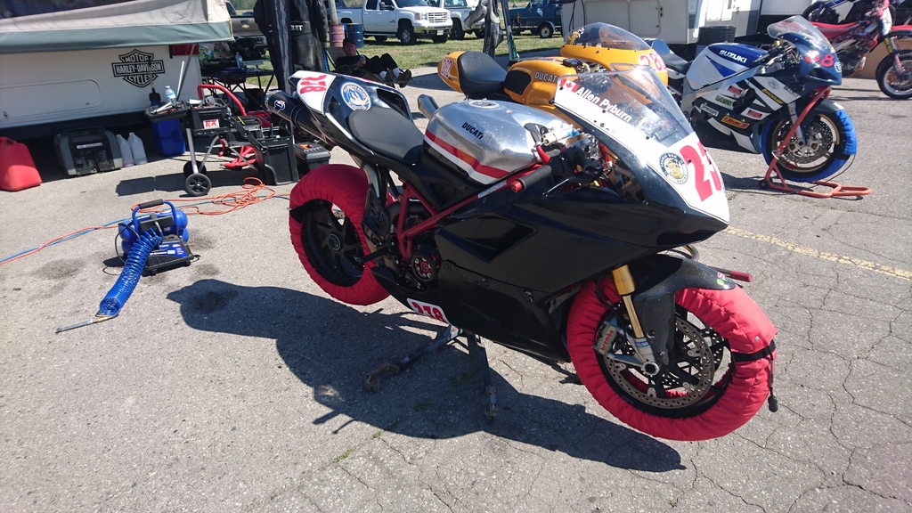

  16. [​IMG]
    Packed up and getting ready to head to the track for a test day. If all goes well I'll race twins on the weekend as well as endurance on the gsxr600. Fingers crossed

  20. Sunday night, had the clutch out. Replaced the main seal in the main shaft. Checked and cleaned plates, put on a new pressure plate, changed o rings. got it together by around 11pm.
