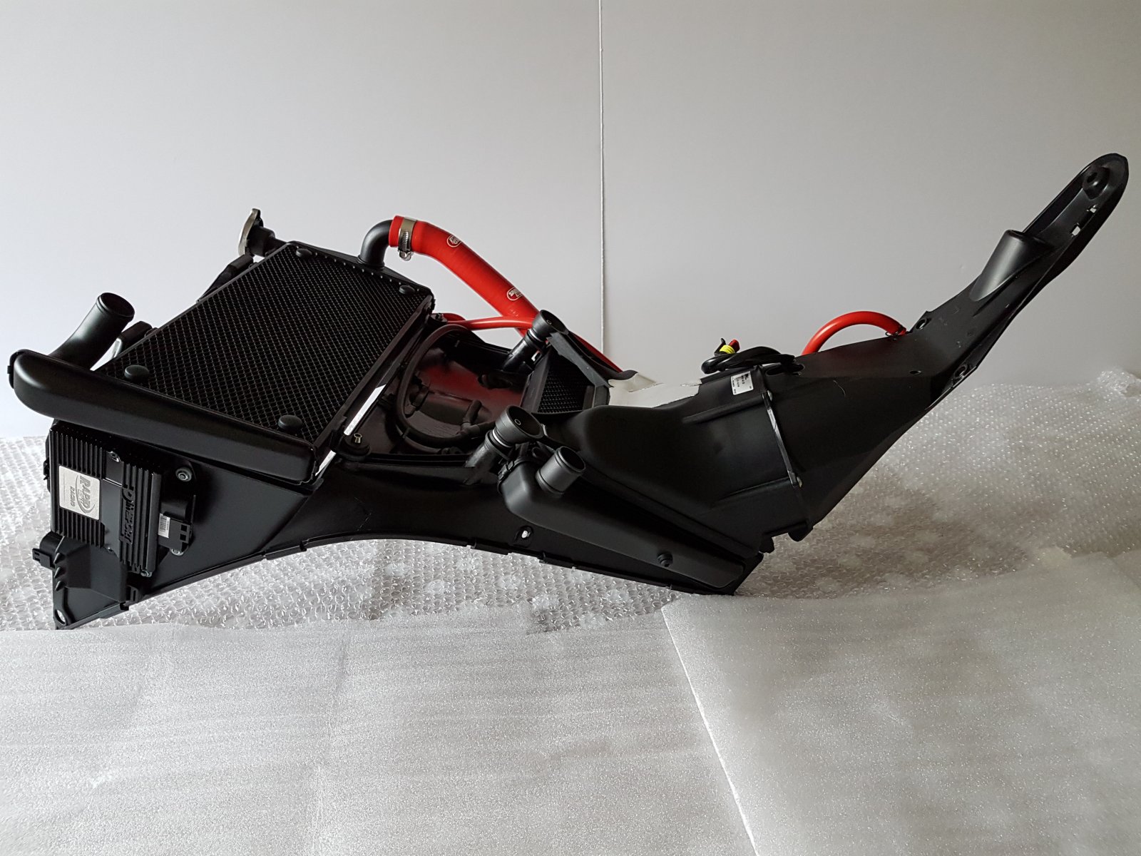

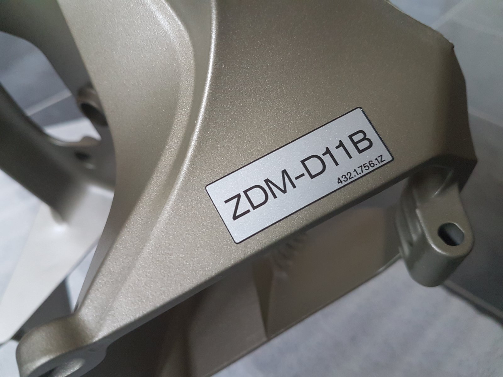

  10. So at last a big leap forward in terms of progress as the airbox, subframe and ancilliary parts are FINALLY back from the Cerakoting company. They spent a LONG time getting the colour matched exactly to the magnesium parts on the bike and they look awesome. For those of you that are unfamiliar with Cerakoting, it's usually used on firearms as it is extremely hard wearing and has the added advantage of only being a few microns thick, does not scratch and is highy resistant to corrosion, fuel and heat. I am collecting them later today, having dropped them off at the local Ducati specialist (Carl Harrison Motorycle Services - Welcome) who are fitting the head races and bearings back in. I'll post up pictures later.

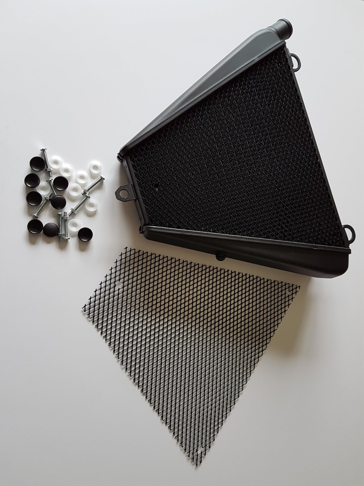

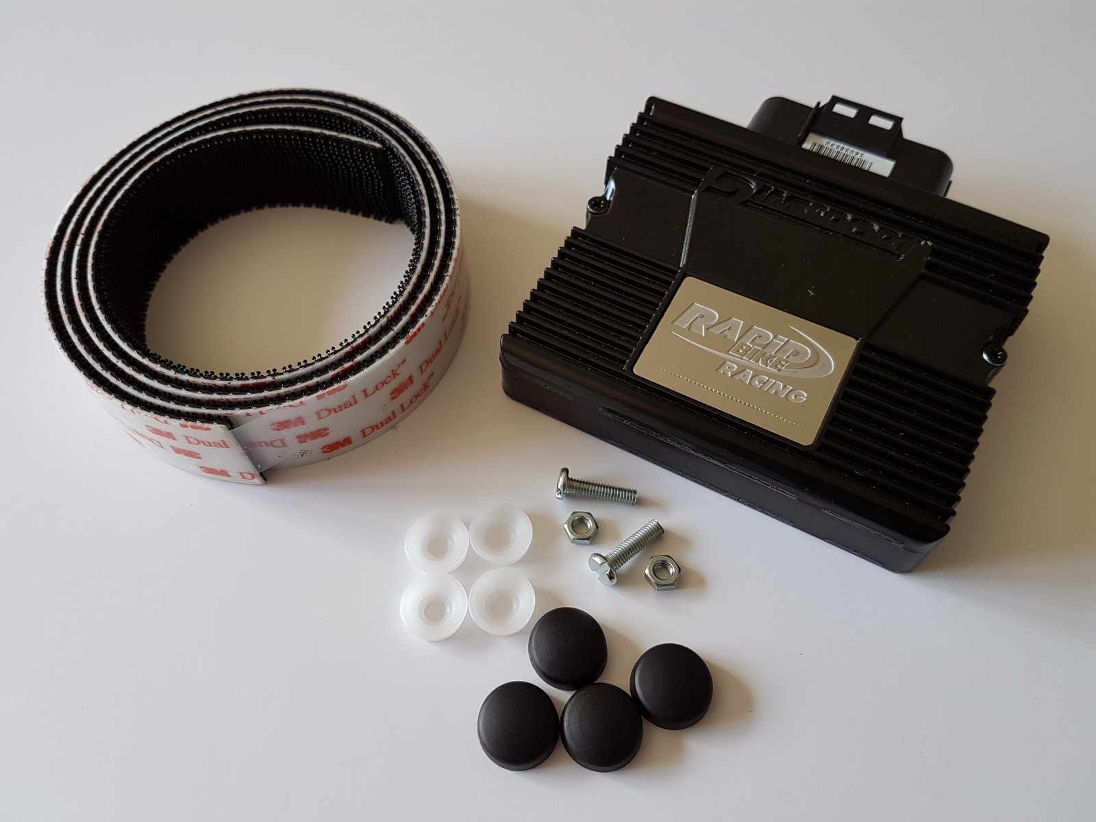

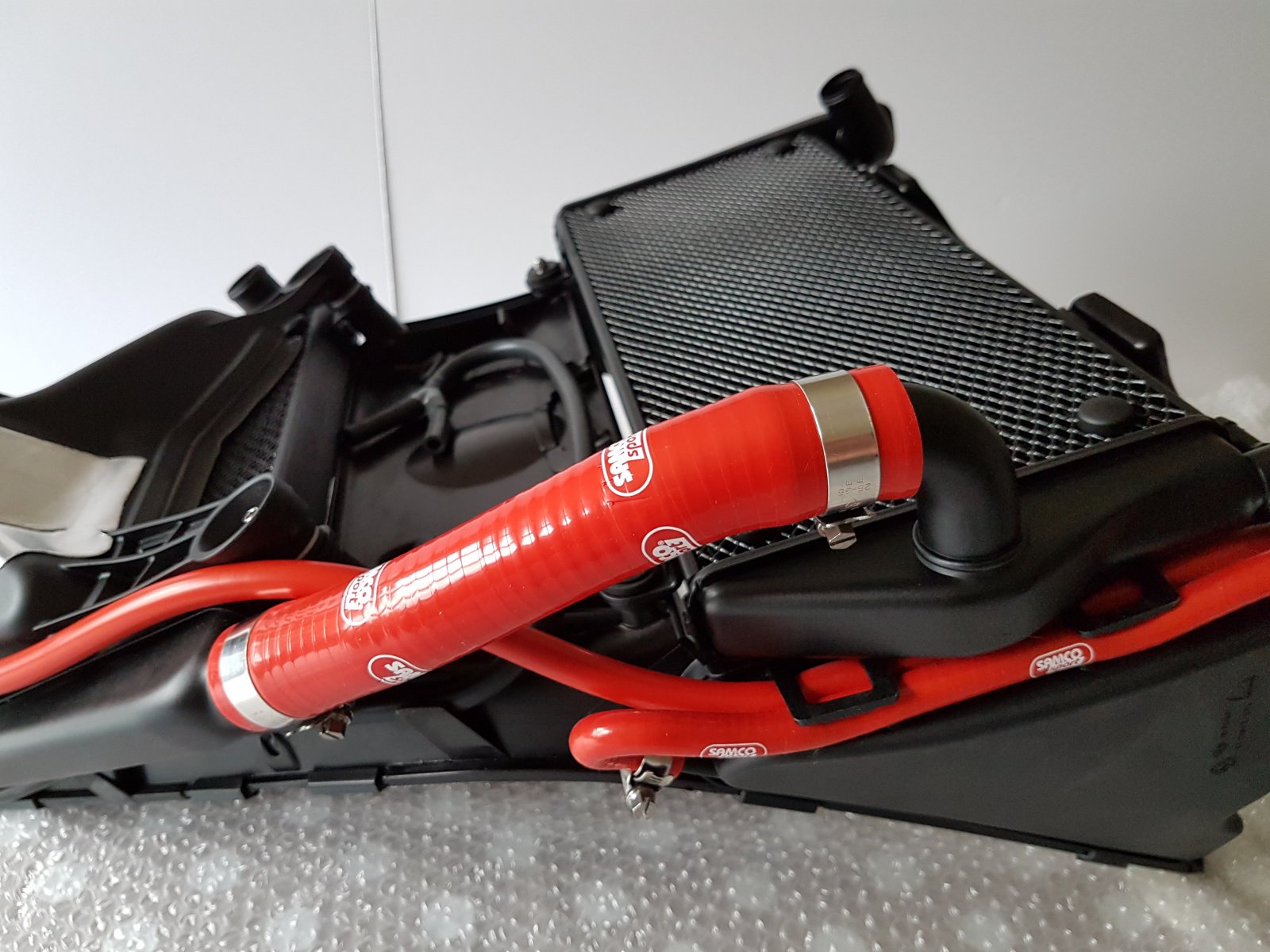

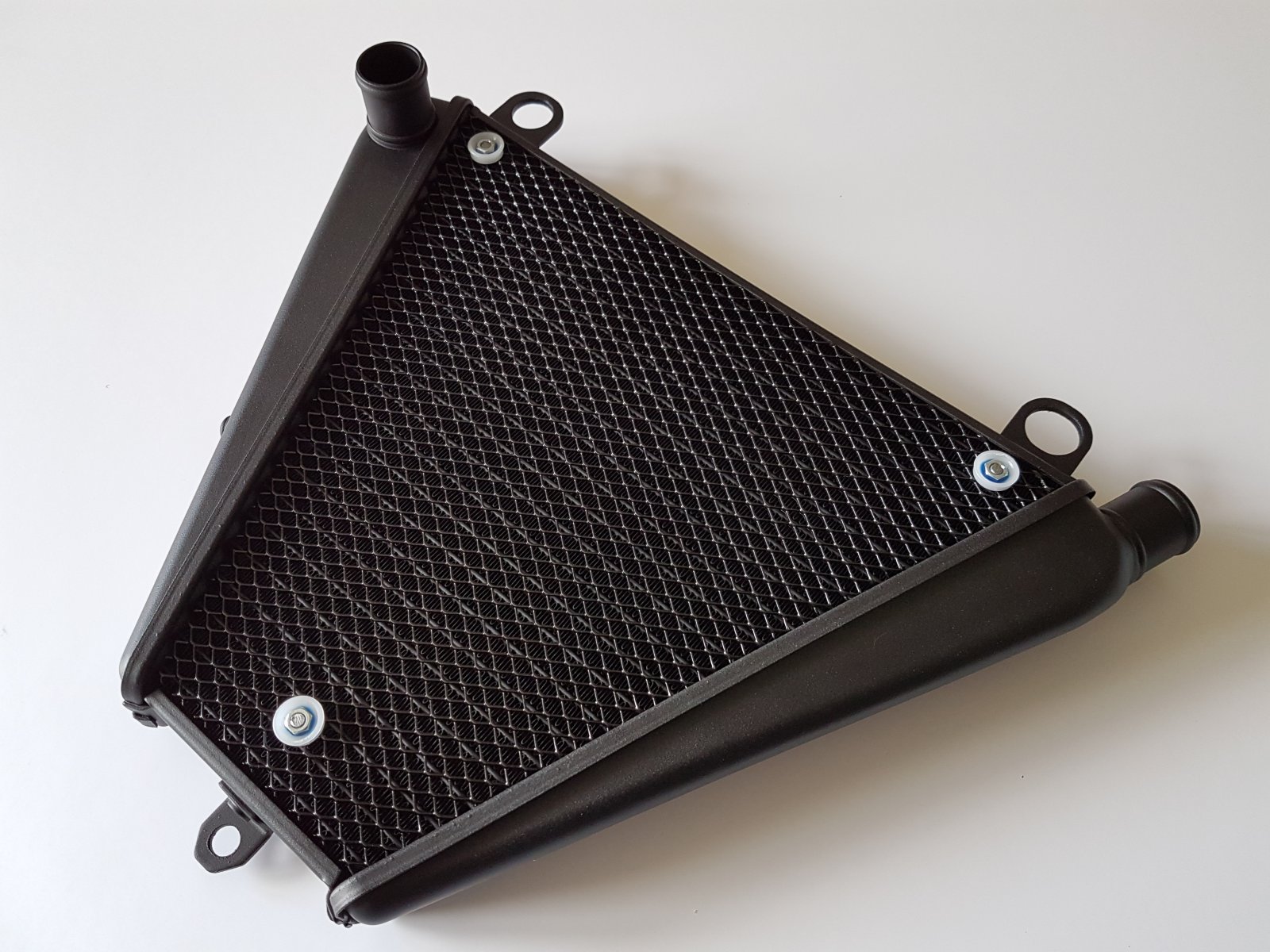

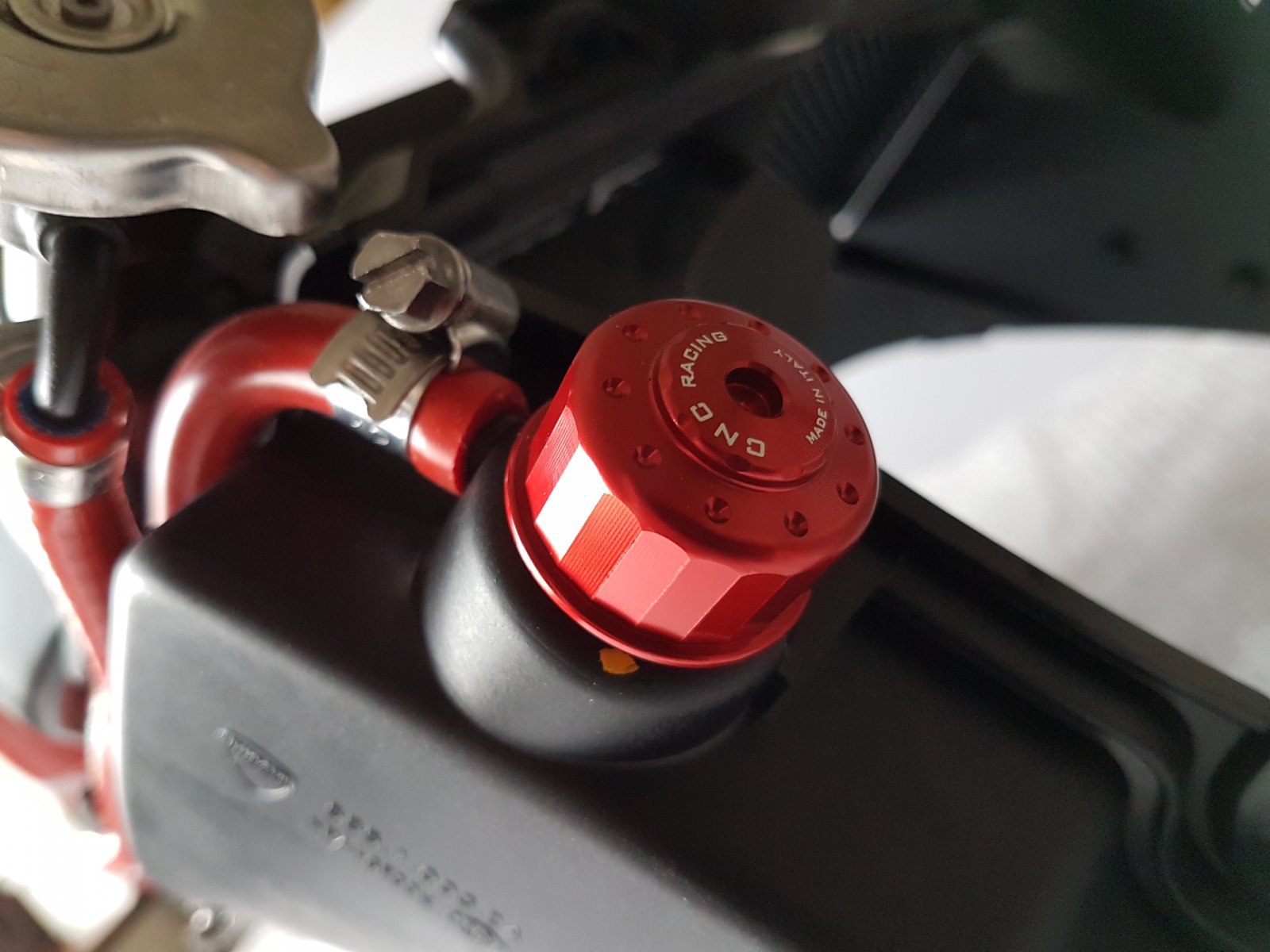

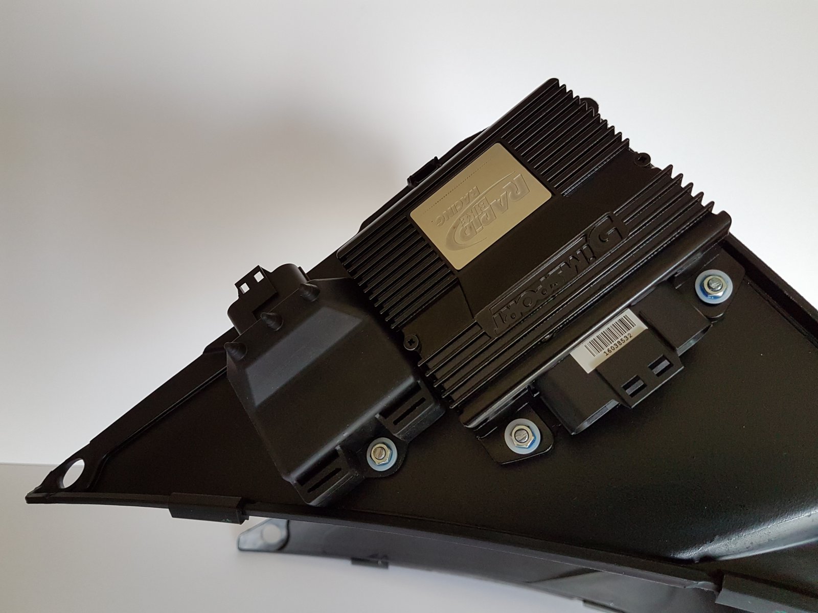

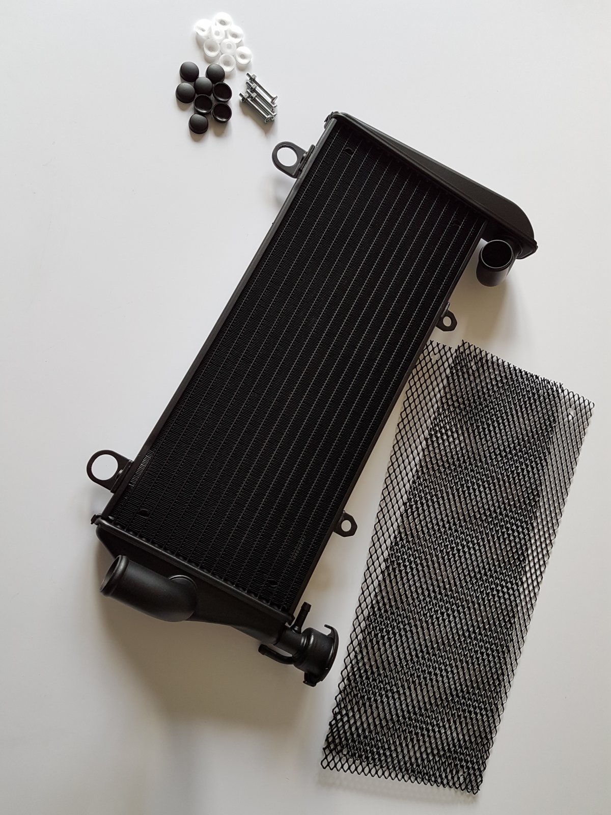

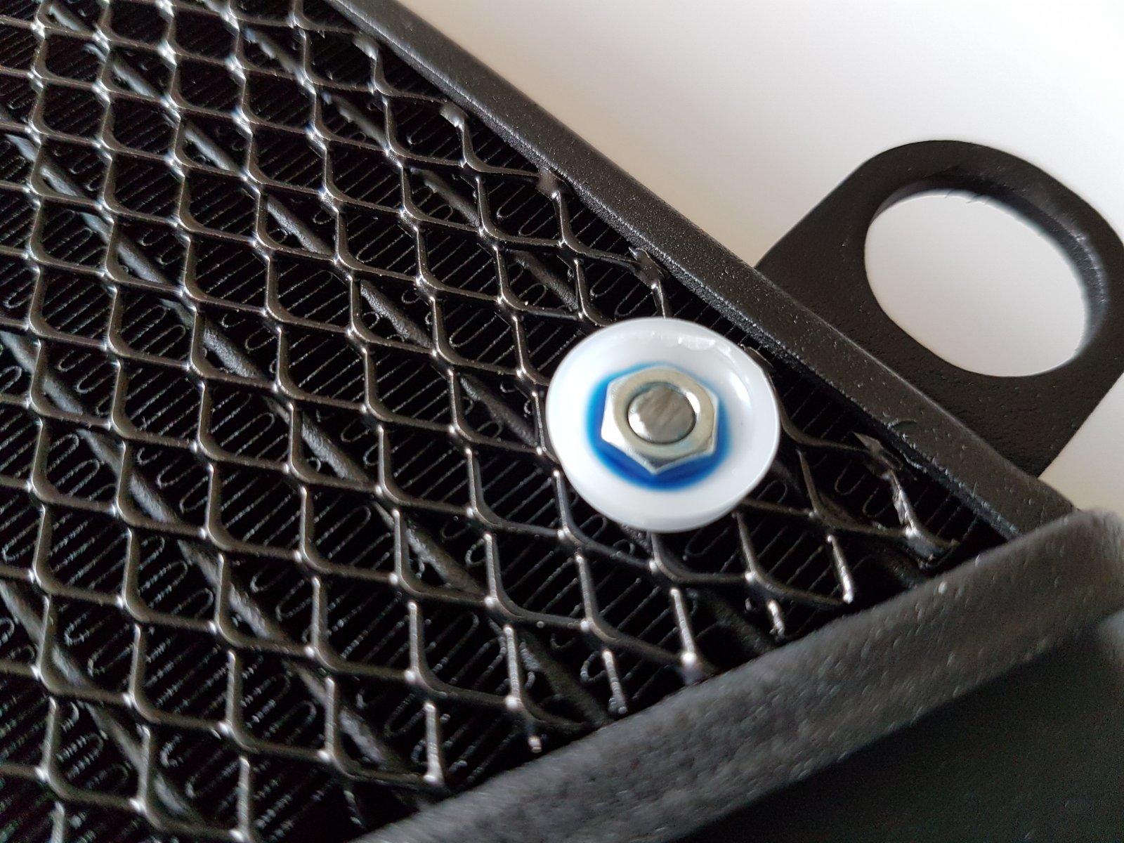

    In the meantime I've been busy re-assembling the cooling system. I had both radiators TLTD (Thermal Dispersant Ceramic Coating) coated by Camcoat (Camcoat Performance Coatings) then sprayed them with a satin radiator paint. I made up some custom grilles which were then powder coated black and fixed them through the matrix using nuts/screws and "Snap-Caps" to hide the screw head and nuts. I have done this on many bikes before and as long as you don't damage the horizontal water channels, you just need to displace a few fins to pass a bolt/screw through. Much like Ducati did on the Monster S4RS. Samco hoses then went on with stainless steel jubilee clips and I am just now waiting on some aluminium brackets to fit to the bottom of the upper radiator which will support the wiring loom for the rapid bike race module as it crosses the bike. I also mounted the RB module (Snap-Caps, screws and nuts again) and relocated the Ohlins suspension module. I had to sand down the original locating lugs for the Ohlins module and then masked off and plastic painted the area, to neaten it up.
    Here are some pics of the various parts and assembly. Other parts I am waiting on include the rear light and undertail carbon fibre panel, which are having a 'Ventureshield' paint protection film applied to prevent stone chips damaging them. I also had new exact copies of the VIN frame stickers made up, to replace those removed from the airbox and front subframe whilst they were Cerakoted.

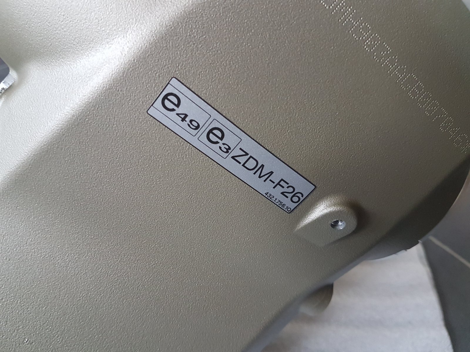

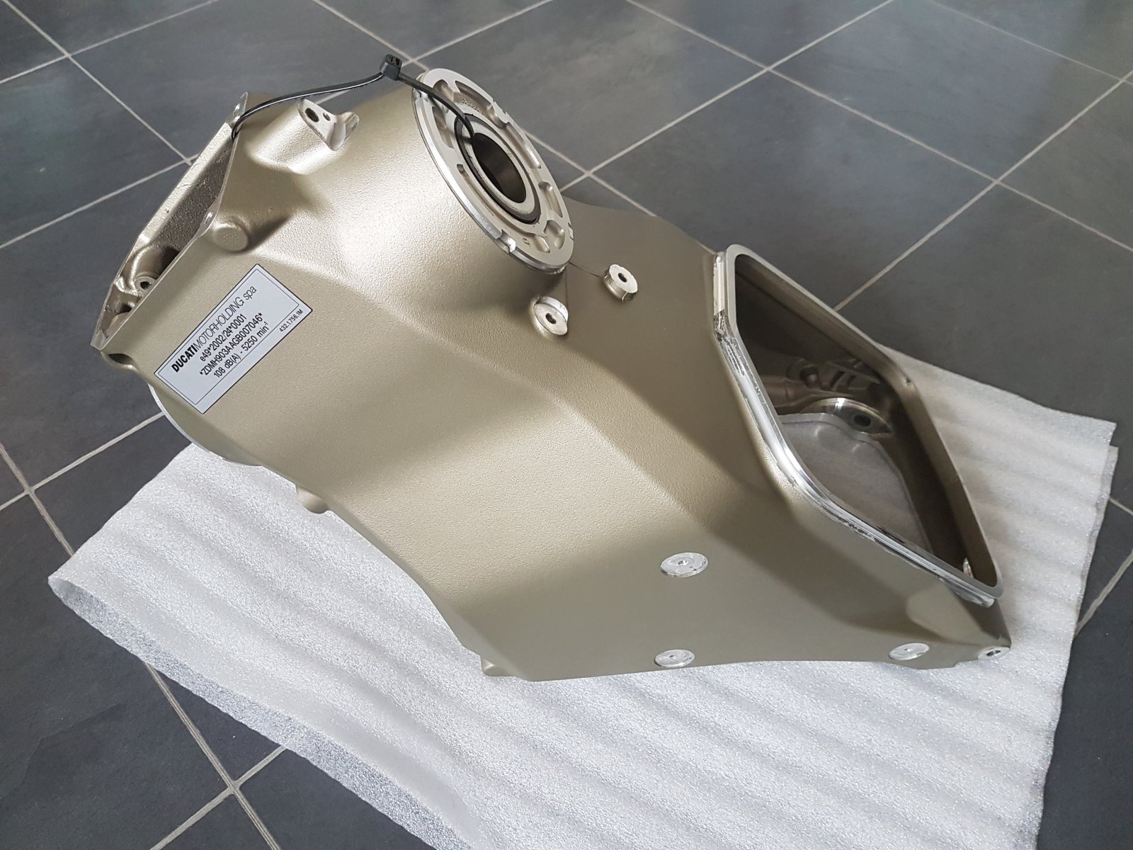

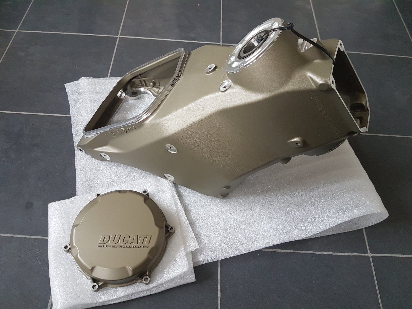

  11. Here's a picture of the airbox/monocoque frame, now that it's back from the Cerakoters. I asked them to use the clutch cover as a colour match. I think it's pretty much spot on. Applied the new VIN and classification stickers to the airbox and front subframe. I also replaced the two rubber damping pads on the front subframe with new ones. Zip tie is there just to hold top bearing race in place, until I fit the forks. Many thanks to Wesley & Andy at ...::: Hi Spec Coatings ::: Cerakote ::: UK Based :::... for a superb job.

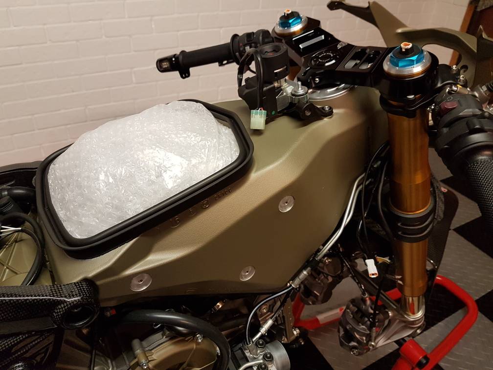

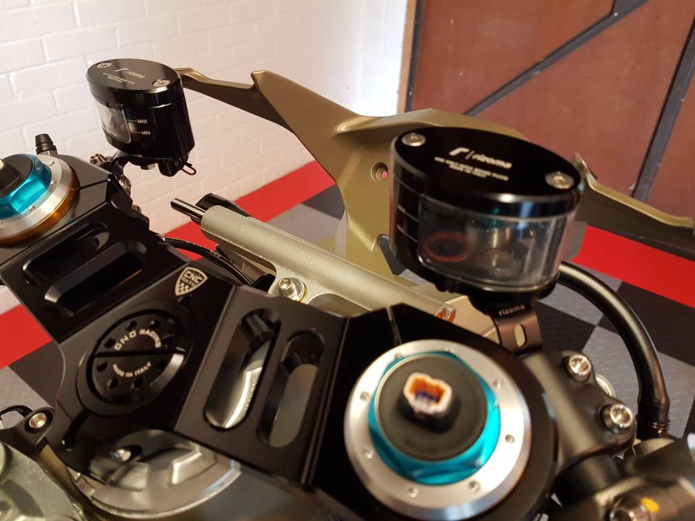

  18. Making good progress so far having re-fitted the airbox and swing arm, complete hydraulic system, exhaust system, suspension, calipers, front mudguard, front and rear subframes, injectors, sprint air filter, ABS, rear sets, top yoke, handlebars and switchgear. Still a long way to go yet but hoping to have the cooling system back on this weekend and to make a start on the wiring and electronics which always take a while. In the pictures you should be able to see the colour matching of the swing arm and airbox with the magnesium parts. I've also had a number of smaller pieces Cerakoted in a satin black.
