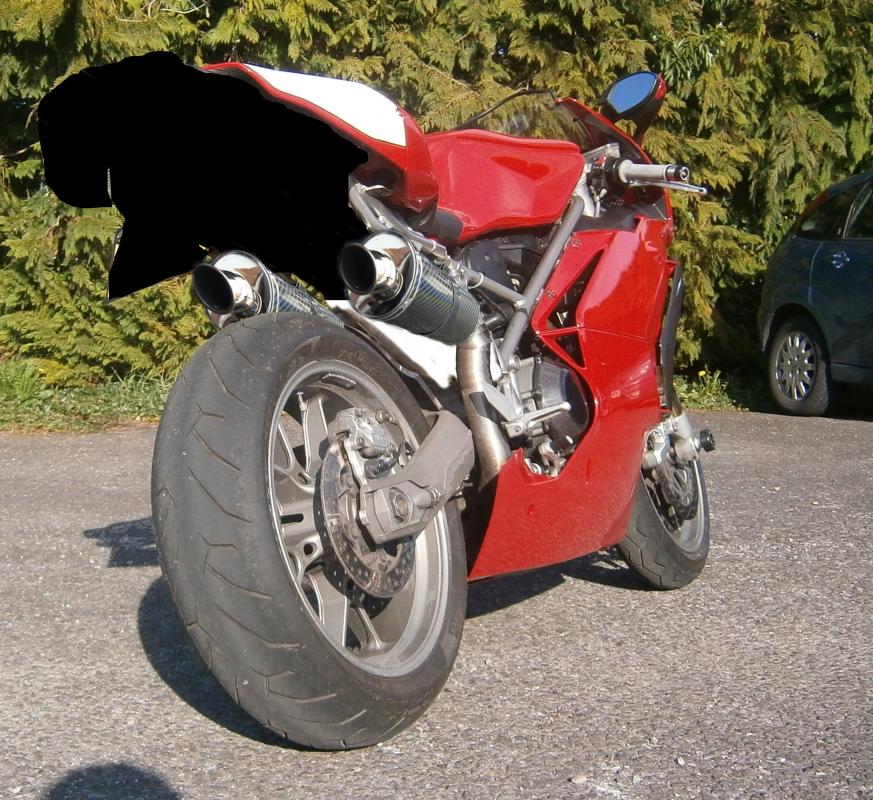

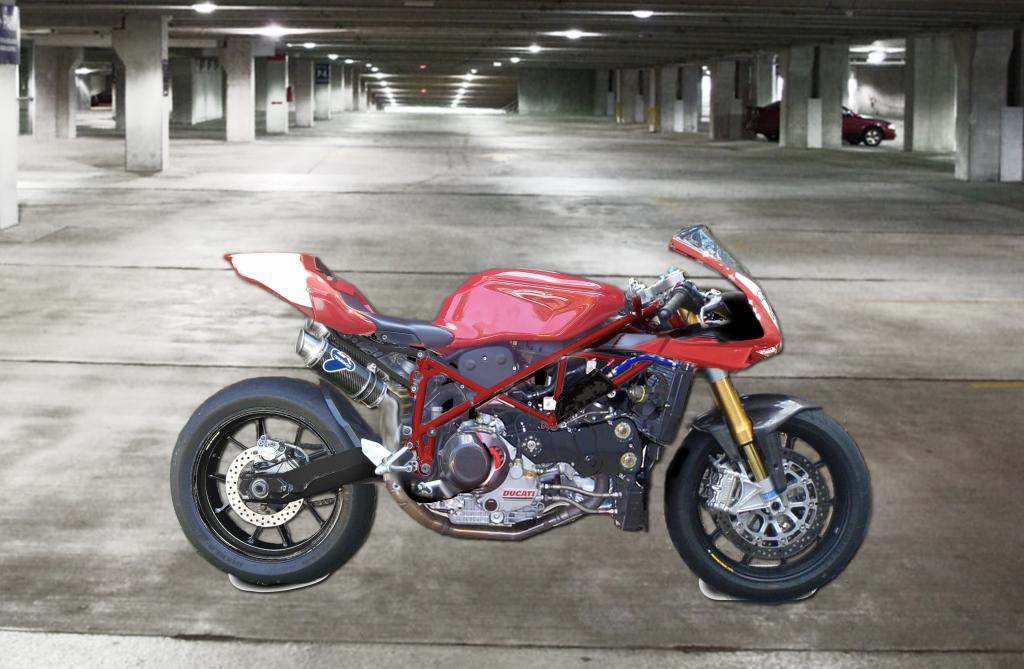

  16. Been photoshopping again...
    I couldn't figure out whether or not getting the termis off was a good thing or not. I decided that to make the project very different… It was a good idea.
    I think a stubby carbon can each side will do the business and so I've been looking at the route the header takes from the front cylinder and its quite restrictive. It must come up behind the swing arm and then push out around the tyre.
    The header for the rear cylinder is a whole different kettle of fish but I'm hoping an exhaust guru can sort out the problems that may come from different length headers. I would like to map each cylinder separately when it comes to dyno time, hence why I want to go for separate headers and cans.
    So here are the pictures… they are just to present the idea and location so I'm sorry they're scruffy

  17. The final photoshop is finished.
    This is what I ail be aiming towards.
  18. how hot will your inner thighs be…….
    and from the rear how spread will they be…….as it might spoil the narrow shape of the bike?
  19. I like what you're doing with the front of the bike.....but those pipes or that placement dont do it for me, sorry. But it is your bike.
    What about trumpet style exhausts or the shotgun effort like whats on the 848/1098 streetfighter? Lay them at 45 degrees, try an mimick angular lines of the 749 ?
    :upyeah:
