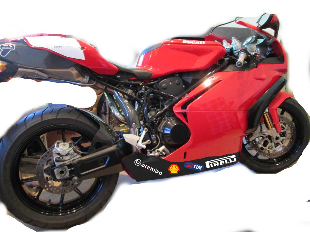

  4. I likes that 2-1 system. Bike looks shit as a street fighter though
  5. I agree, which is why it'll probably look a bit like this but with magnesium coloured wheels.
