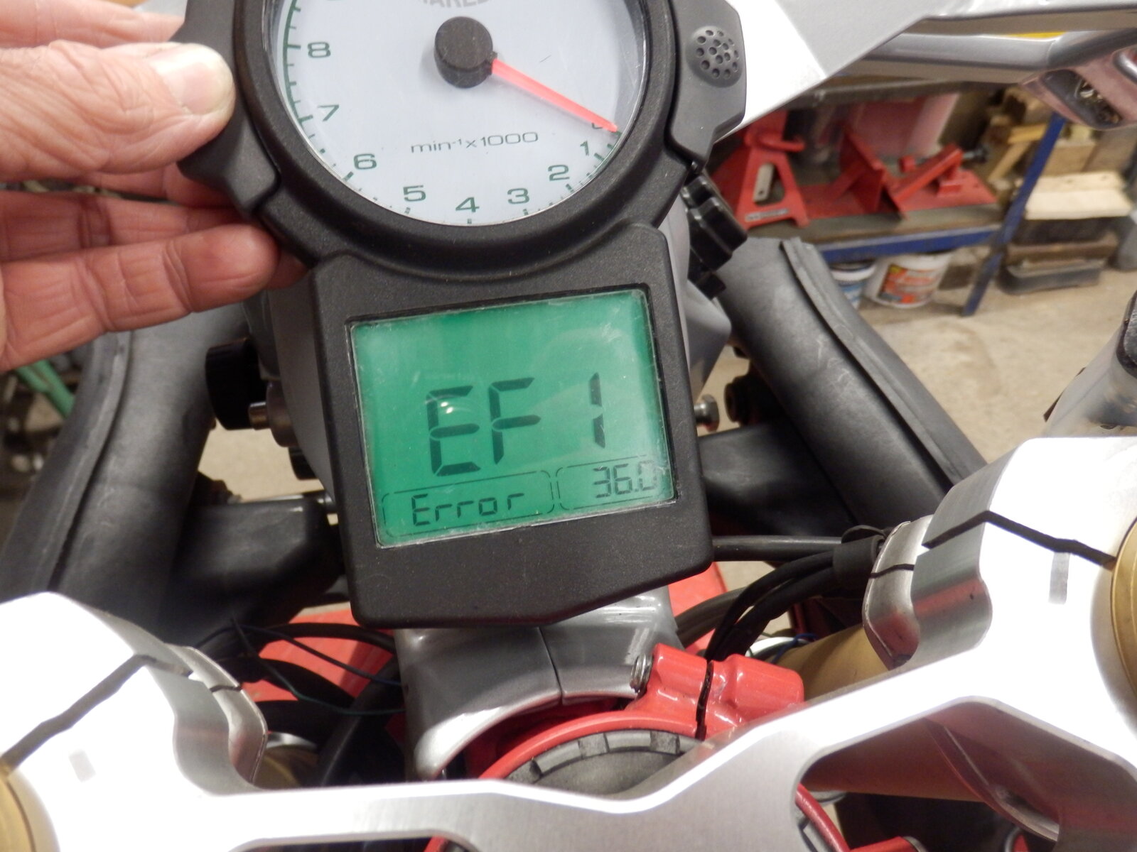

    But I did use the 'Turn the ignition on with the Left Hand Button held down' process to access the codes:
    The Error code 36.0 relates to the speed sensor of all things, but looking back through a few old threads it does appear that a speed sensor issue will result in constant illumination of the EML light. So that at least ties up.
    I'm not sure why there is a massive EFI above the code, could that also be pointing at another error of some kind?
    Would multiple codes stack at the bottom of the screen?
    Back to 36.0.
    It would make sense that the ECU could get a little confused if it gets conflicting info from the speed sensor/clutch lever switch/ignition pick-ups/Neutral switch etc
    I don't know exactly when the EML illuminated, all I know is that it wasn't illuminated, then was when I looked back at the dash.
    I do remember the Neutral light being off when I first started the bike, then it flickering before coming on properly, I did also pull the clutch lever in a few times to test it's operation and see how much of a 'Jingle' I was going to get.
    I didn't touch the back wheel on that first start up.
    After finding the code I did run the bike back up and spin the back wheel by hand, which gave me 6mph briefly so I'm assuming the sensor itself is good.
    Does anybody know how I can clear this code without using JPDiag or similar?
    I did fit a new battery yesterday before the above error code investigation, but need to go over the Earths again I think, particularly the one from the ECU to one of it's mounting bolts.
    The battery was showing 13.3V with my Multimeter on the bike without the engine running, and 14.8V with the engine running.
    But the dash was showing me 11.5V and 12.6 in the same situations.

  10. Sev is right Simon, don't be put off by the bold "EFI" bit, it's merely telling you that "you got there" - you are "in" that part of the fault-finding program, and will come up on every similar bike to indicate this.

  13. For error 36.0 spin the back wheel to create an input to the ECU. Should clear the MIL.
  14. Thanks ChrisW.
    I did that yesterday to test the Sendor and 'got her up to 6MPH', but the light was still on.
    Perhaps I should do it in gear with the clutch out.
    Note there is no Chain and Sprockets on the bike at the moment!
  15. If it was going to clear then just spinning the wheel with ignition on would have done it.

  18. Hi Nasher, regarding your issues with JPDiag....I don't think it's you or your laptop at fault.
    I have problems connecting to my 999s (59M ECU) but connecting to my '07 Monster695 (5AM ECU) is easy.
    I think there is a comms issue with the 59M ECUs (assuming yours is the same?)
