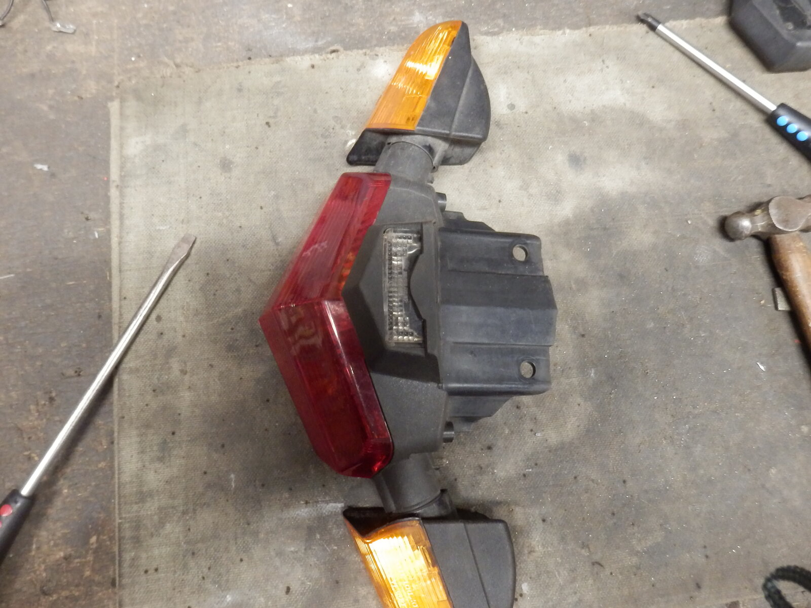

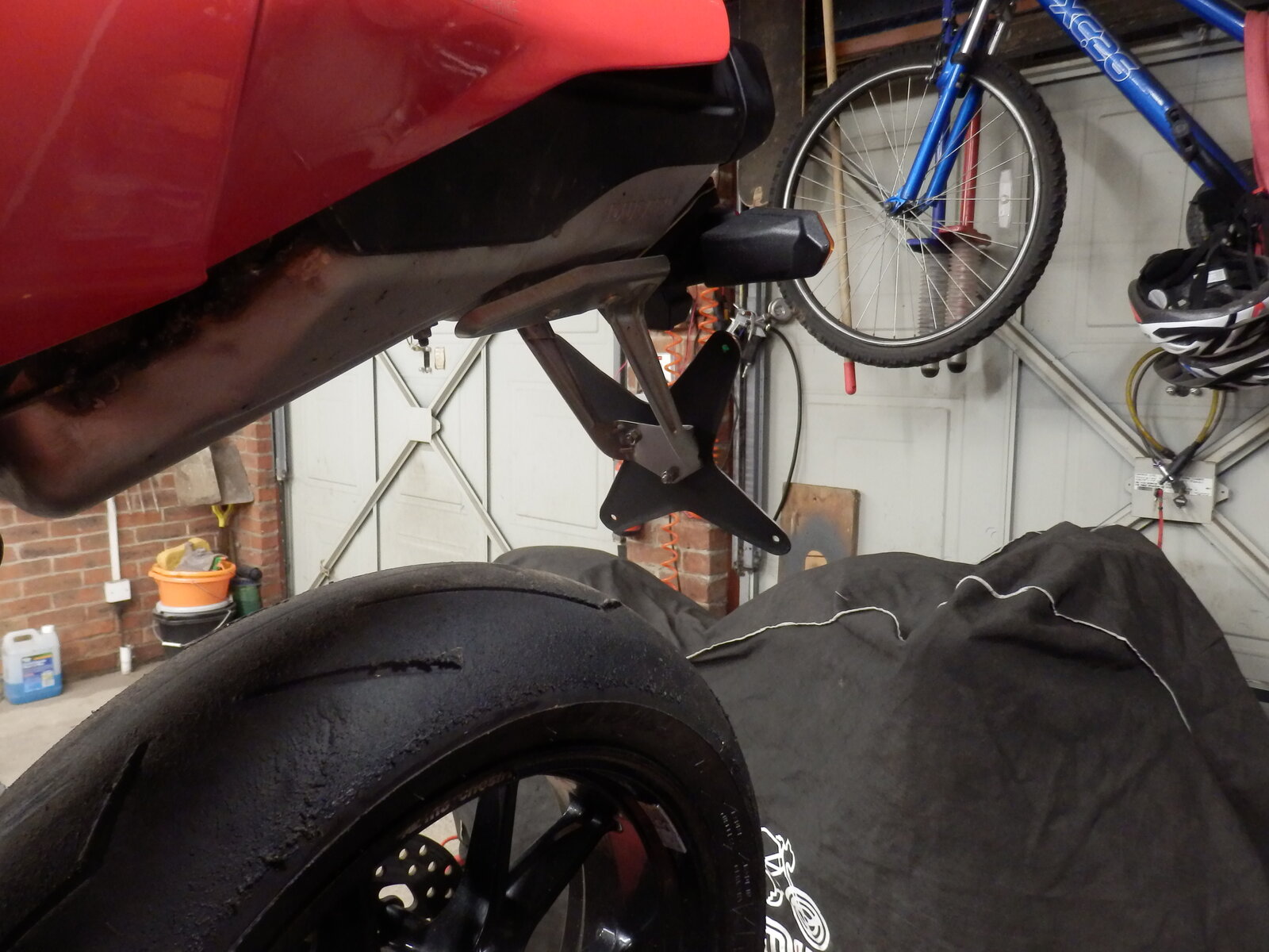

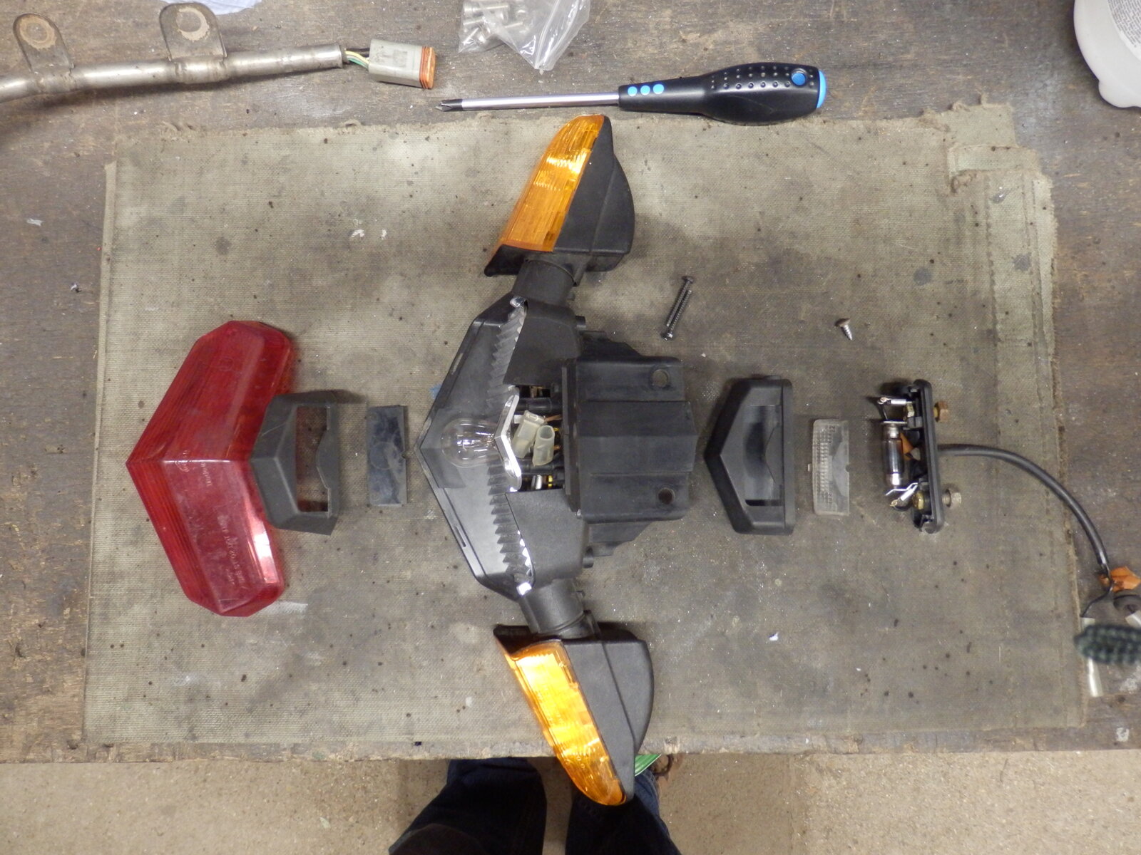

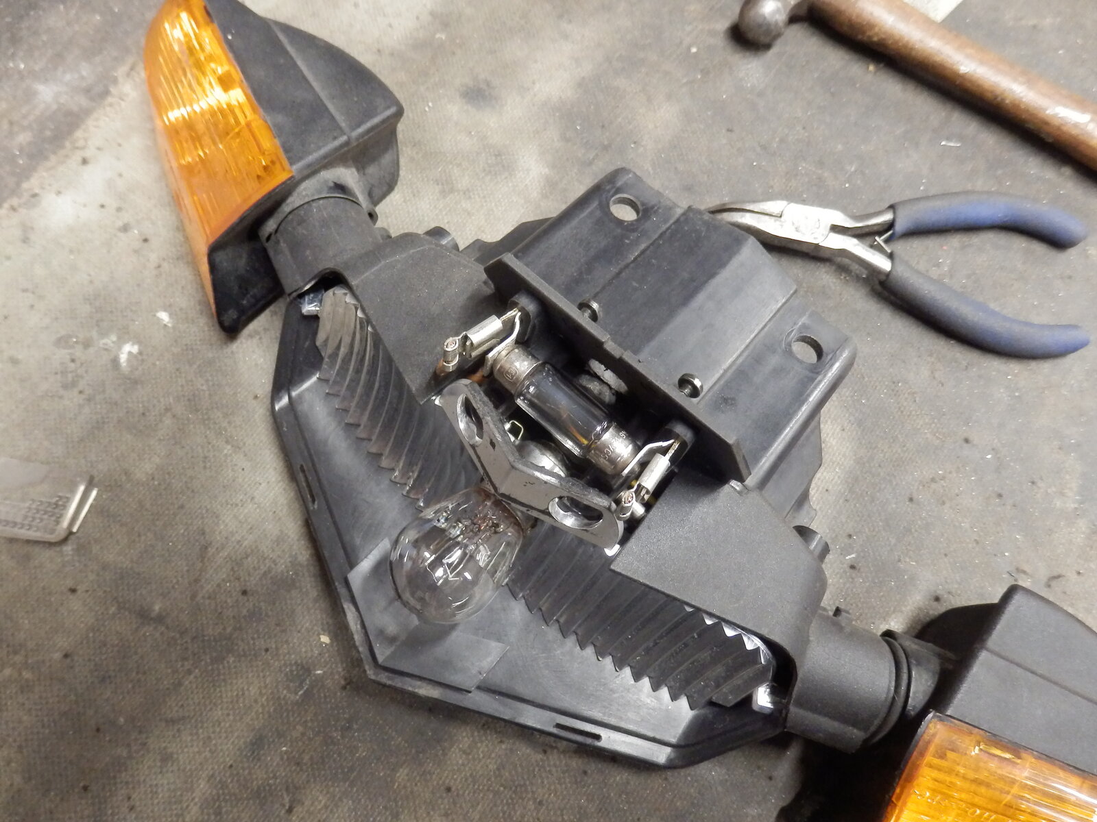

  13. Now I've got the silencer sorted I thought I'd clean and fit all the stuff that bolts to it's underside.
    It looks a bit odd to me that the numberplate light in the main rear light housing is blanked off on the 749/999 and a separate light is added lower down.
    I wanted to raise the numberplate a little, but retain a factory look.
    The 749/999 shares it's rear light moulding with the Multistrada 1000, which doesn't use a separate numberplate light, so I thought it must be really easy to swap and change a few parts around.
    I found I couldn't swap the bulb holders from the separate light unit into the main housing, but as there were slots there I did manage to bend up some contacts from some old blade contacts I had hanging around:
    And then used the clear lens from the separate unit in place of the blanking plate originally installed in the main housing:
    #213 Nasher, Dec 30, 2021

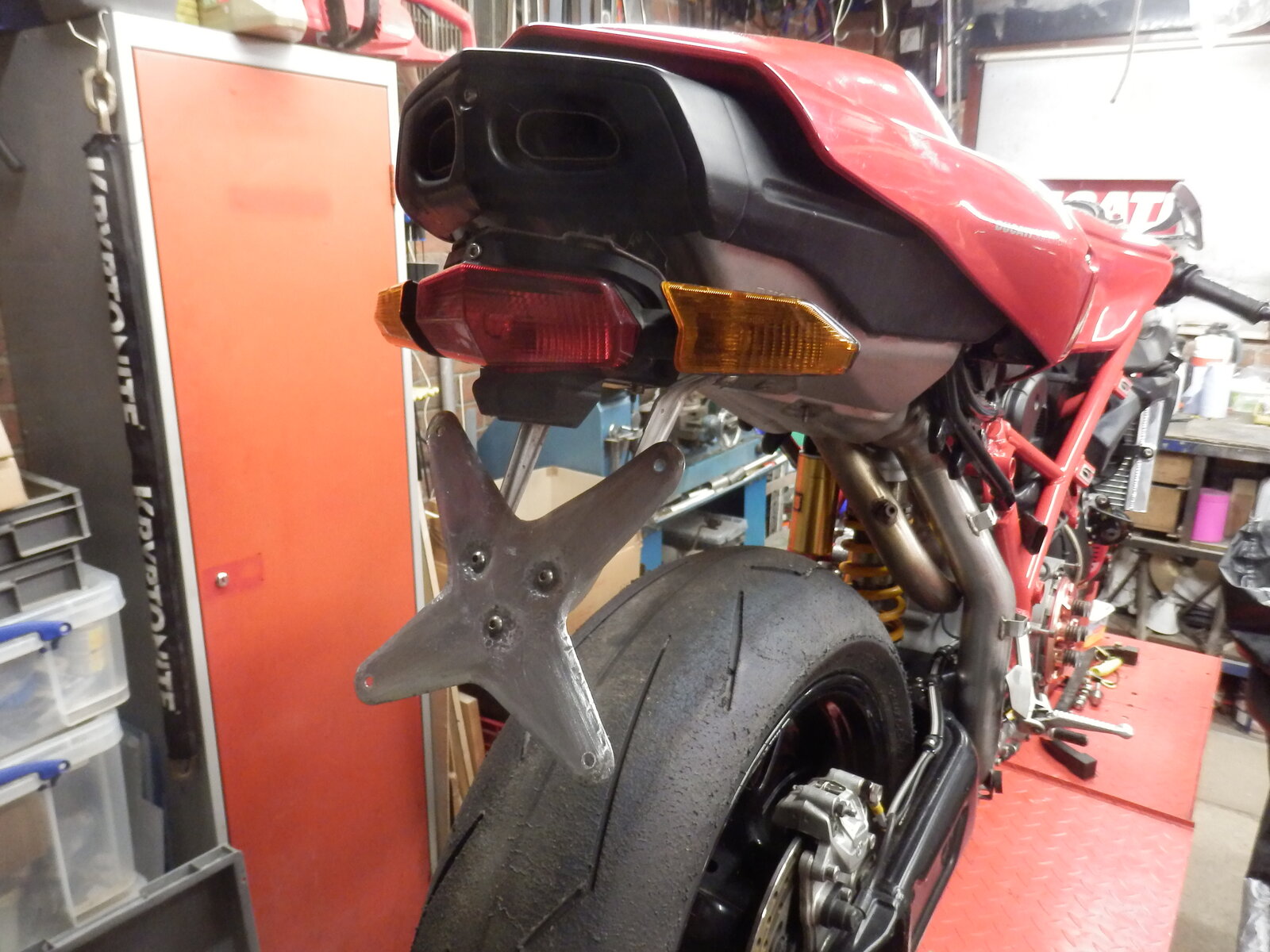

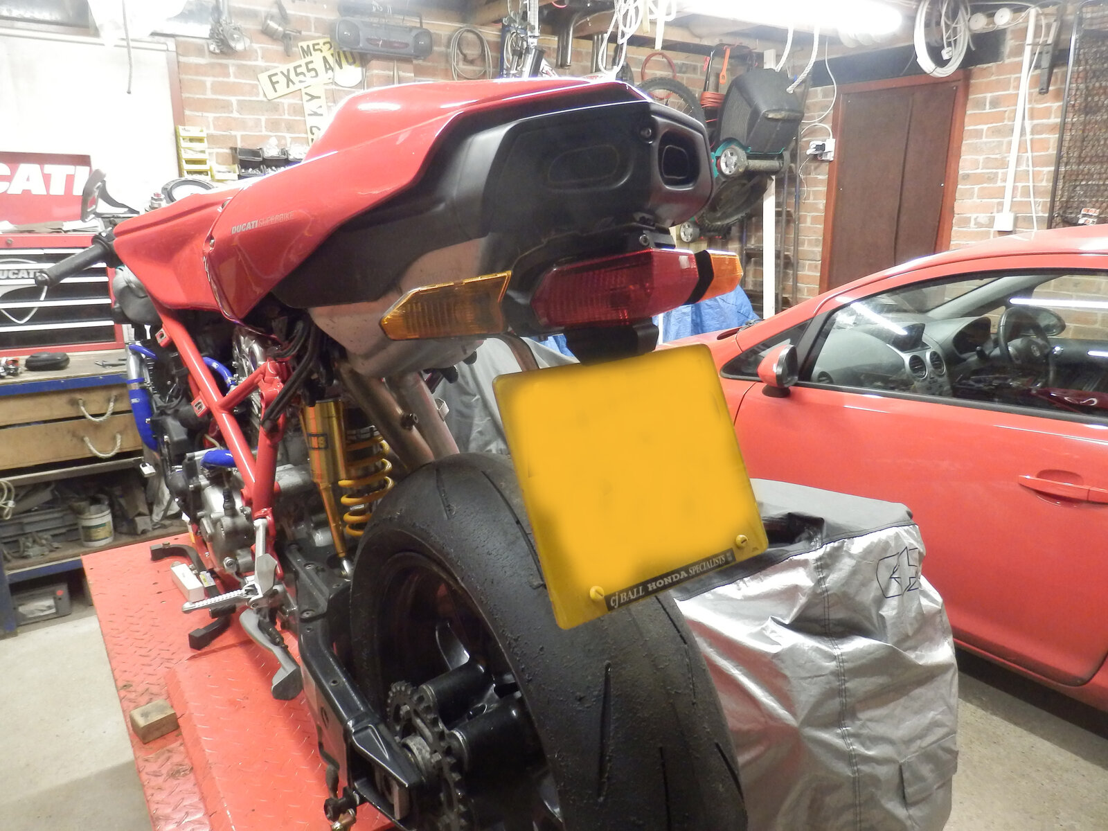

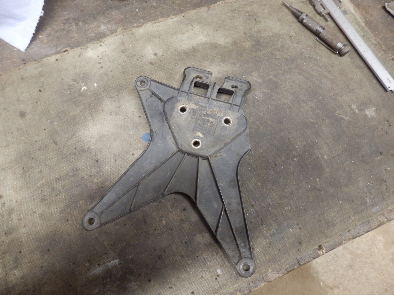

  14. I wanted to move the Numberplate up a bit and the old plastic mount was broken anyway:

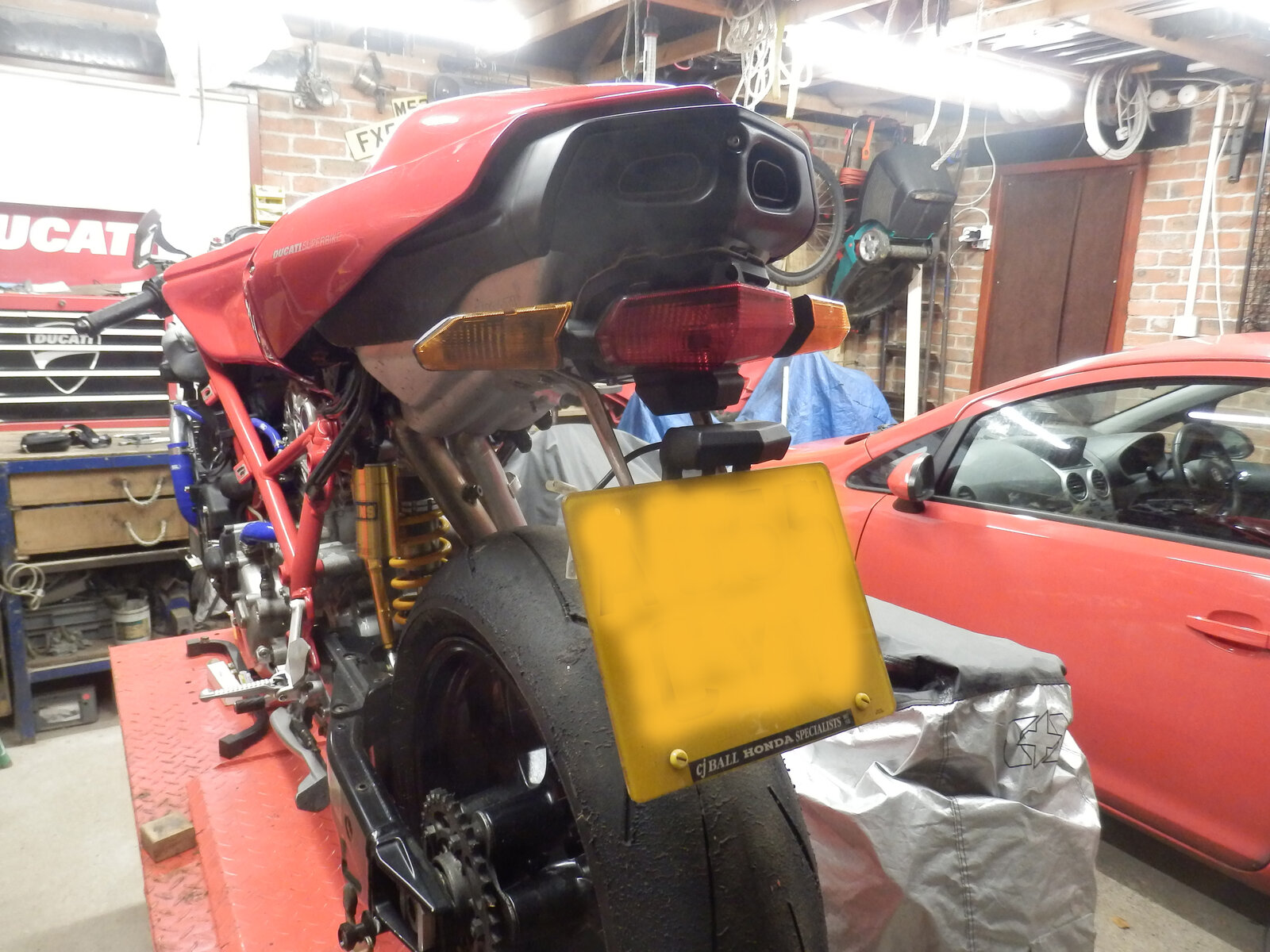

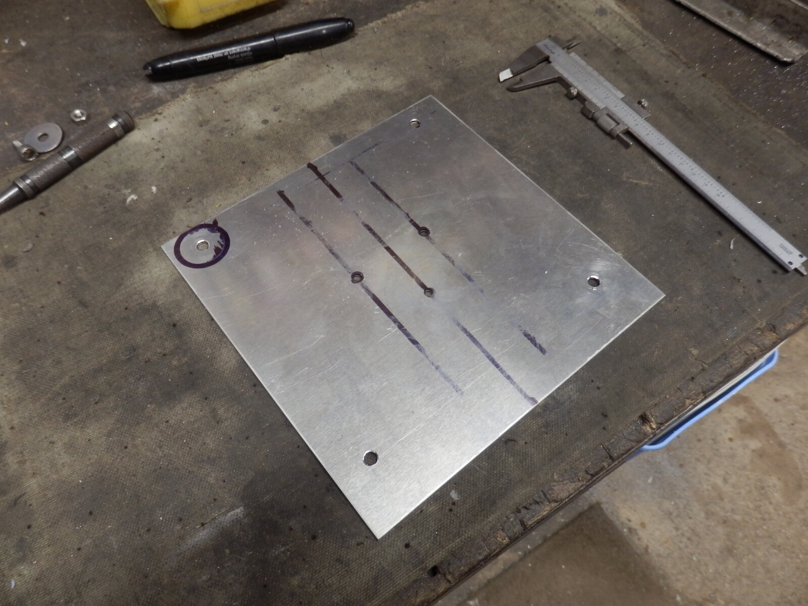

    But as I rather like the original stainless hanger I wanted to reuse it, so started with a flat sheet of 1.5mm Aluminium to make a replacement for the plastic mount with the holes in a different place:
    Cut to shape with the edges turned over for rigidity and dimples hammered in for dome head screws it fits quite nicely:
    And with a little paint positions the plate right where I wanted it:
    Unless you look closely it looks standard, but I think looks better.
    My next step is to replace the tail light reflector etc with LEDs.

  15. Thanks Sev, I looked at that.
    I realised the separate light was a little further forward, but my aluminium bracket makes up for some of that by being significantly thinner overall than the original Plastic one.
    When I replace all the guts of the rear light with LEDs I plan to position the downward facing white ones slightly further 'out' to help, and of course they will be significantly brighter.

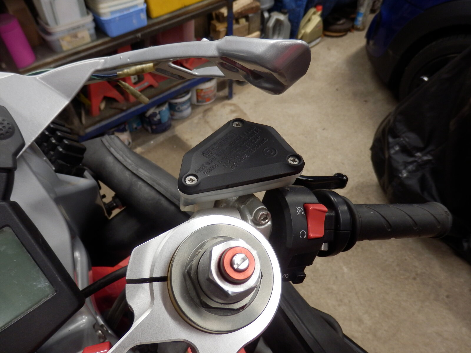

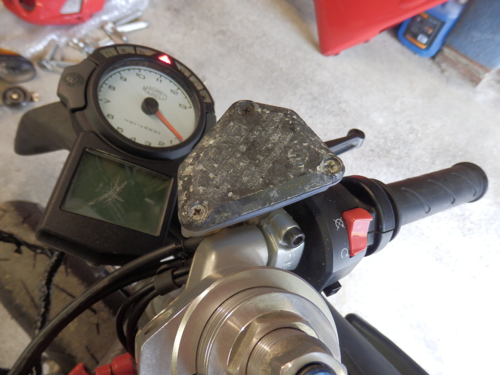

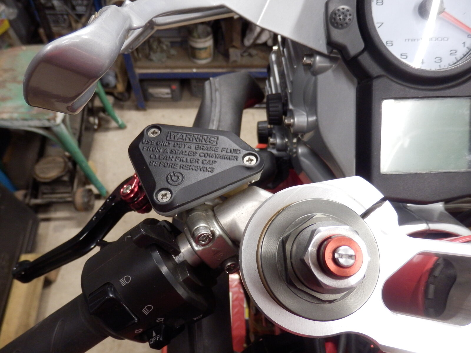

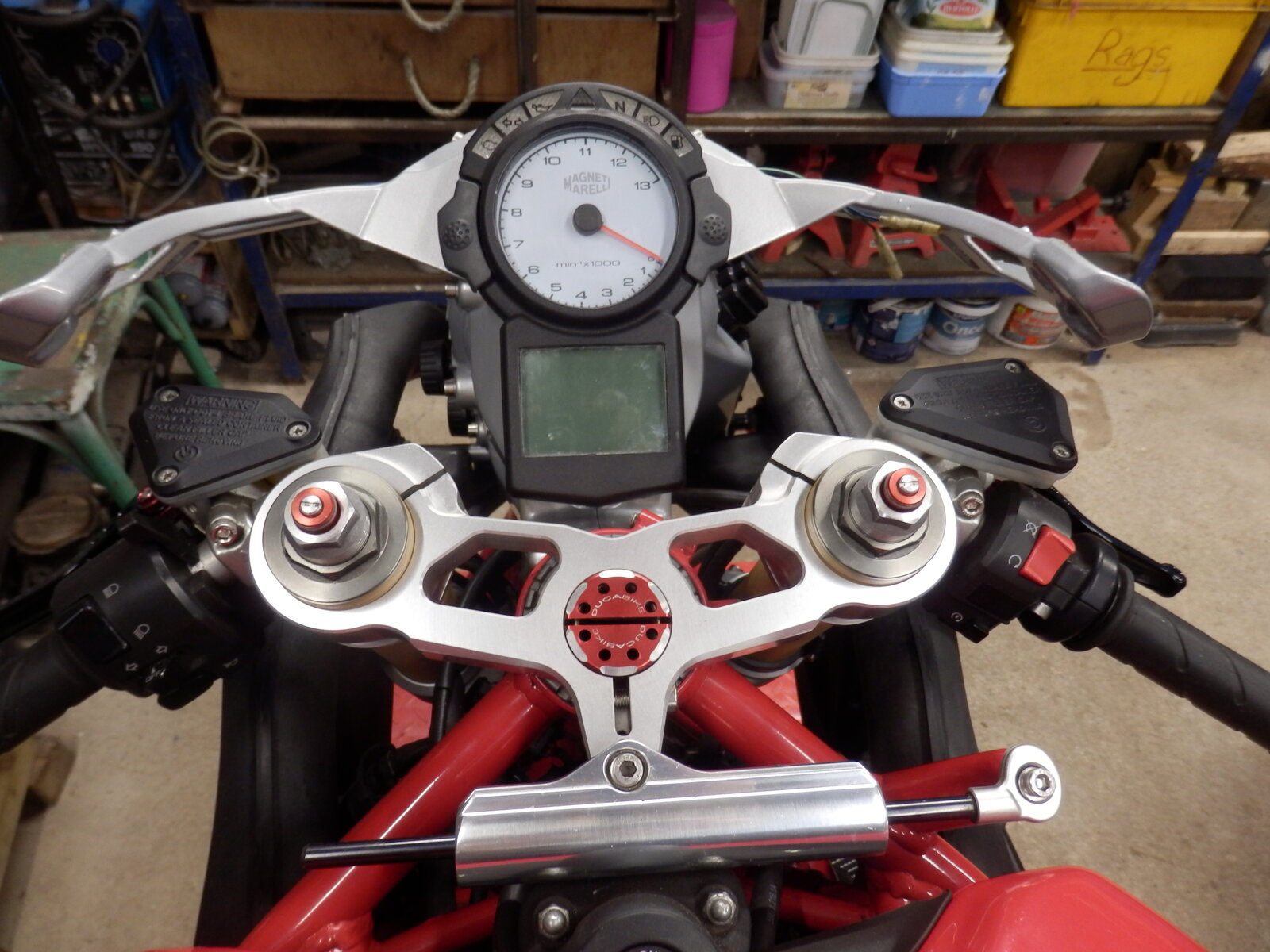

  17. I couldn't stand looking at these awful Front Brake and Clutch reservoirs any more:
    Considering the difference just 15 minutes made with a stainless Wire brush, a rattle can of primer and another of Matt Black, I should have done it ages ago.
    It also helps having a huge stash of assorted Stainless screws and bolts hanging around.
    It's often the little wins that stare you in the face afterwards that keep the enthusiasm going on a project:

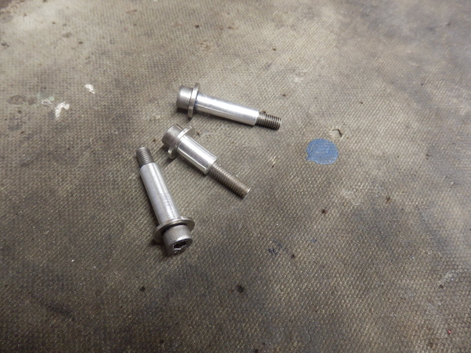

  18. The special screws holding the Air tubes and Air filters to the Airbox were not only very rusty, but nearly all had quite badly rounded out Allen sockets.
    So I spent an hour at my Lathe today making up a couple of sets of these replacements using M5 Stainless Allen Cap head screws and Aluminium round stock.
    They shouldn't rust or round out:
    • Like Like x 8

  20. Regarding the number plate light I started hacking into a 999 tail light I got from Ebay to get the illumination from the tail light itself. Recycling the clear lense to slot into a chunk out of the red lense and then patch up the hole. Some Japanese bikes have this - my FZR years ago had this and my ZX9R does it like that too.
