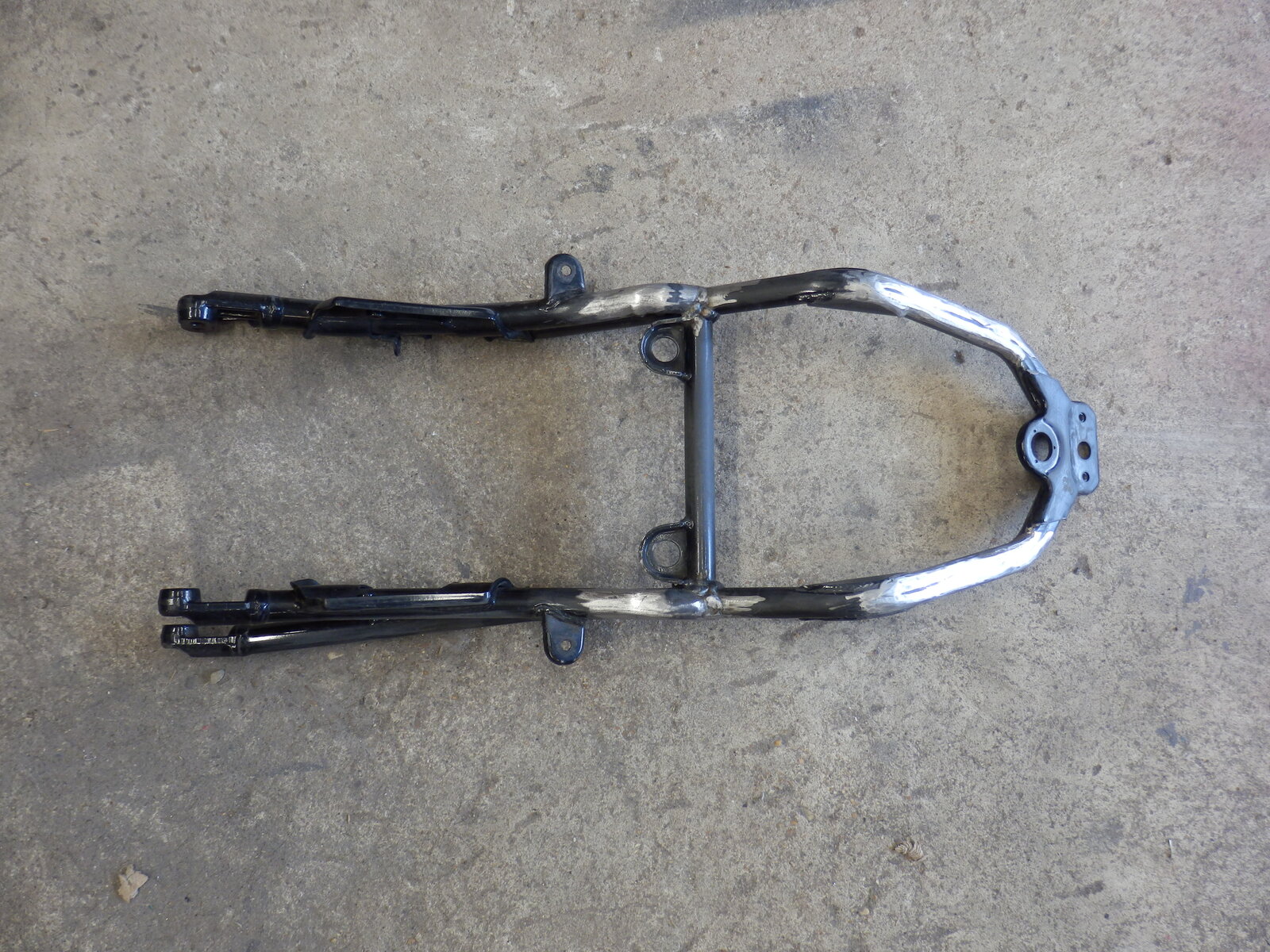

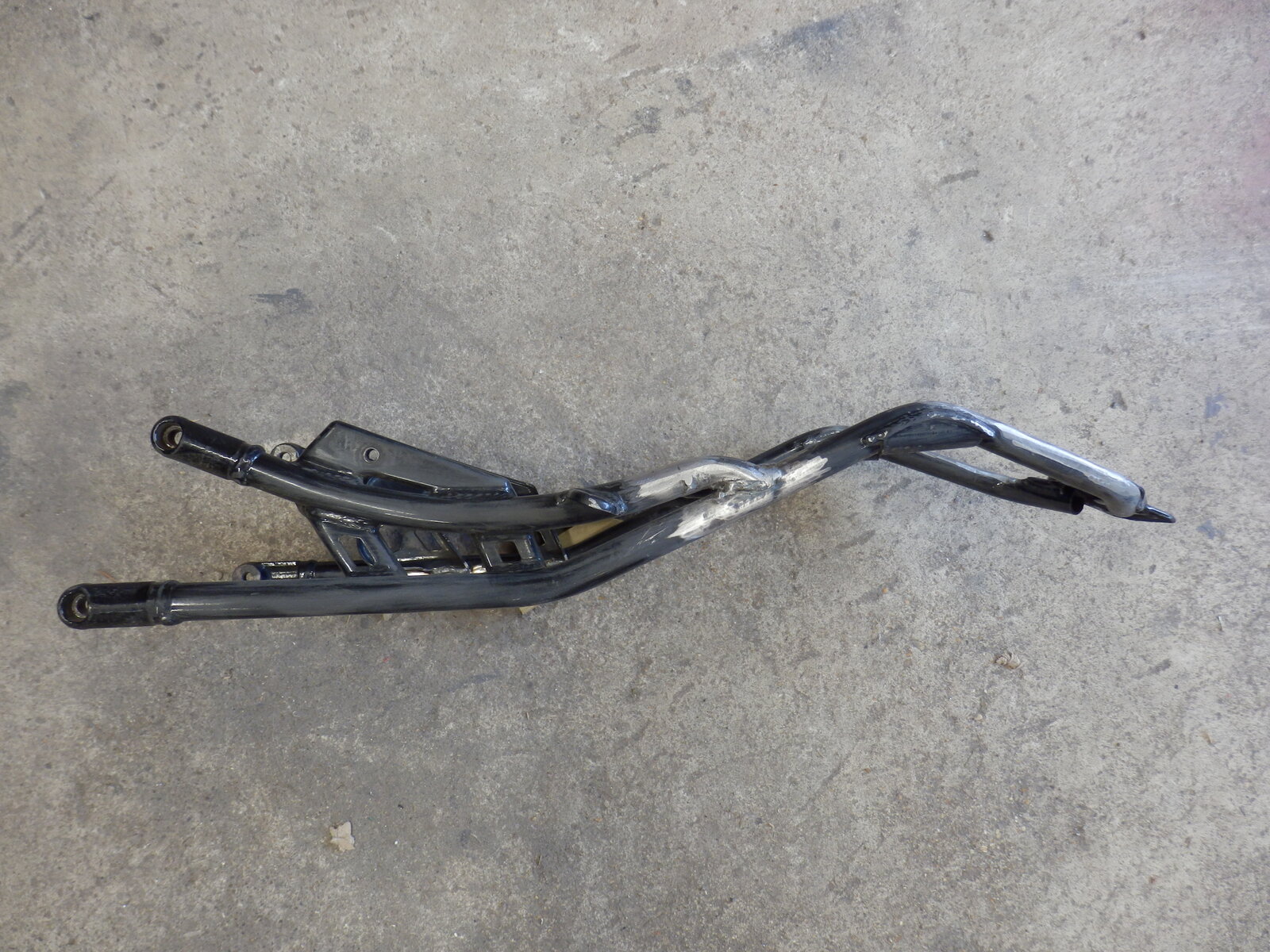

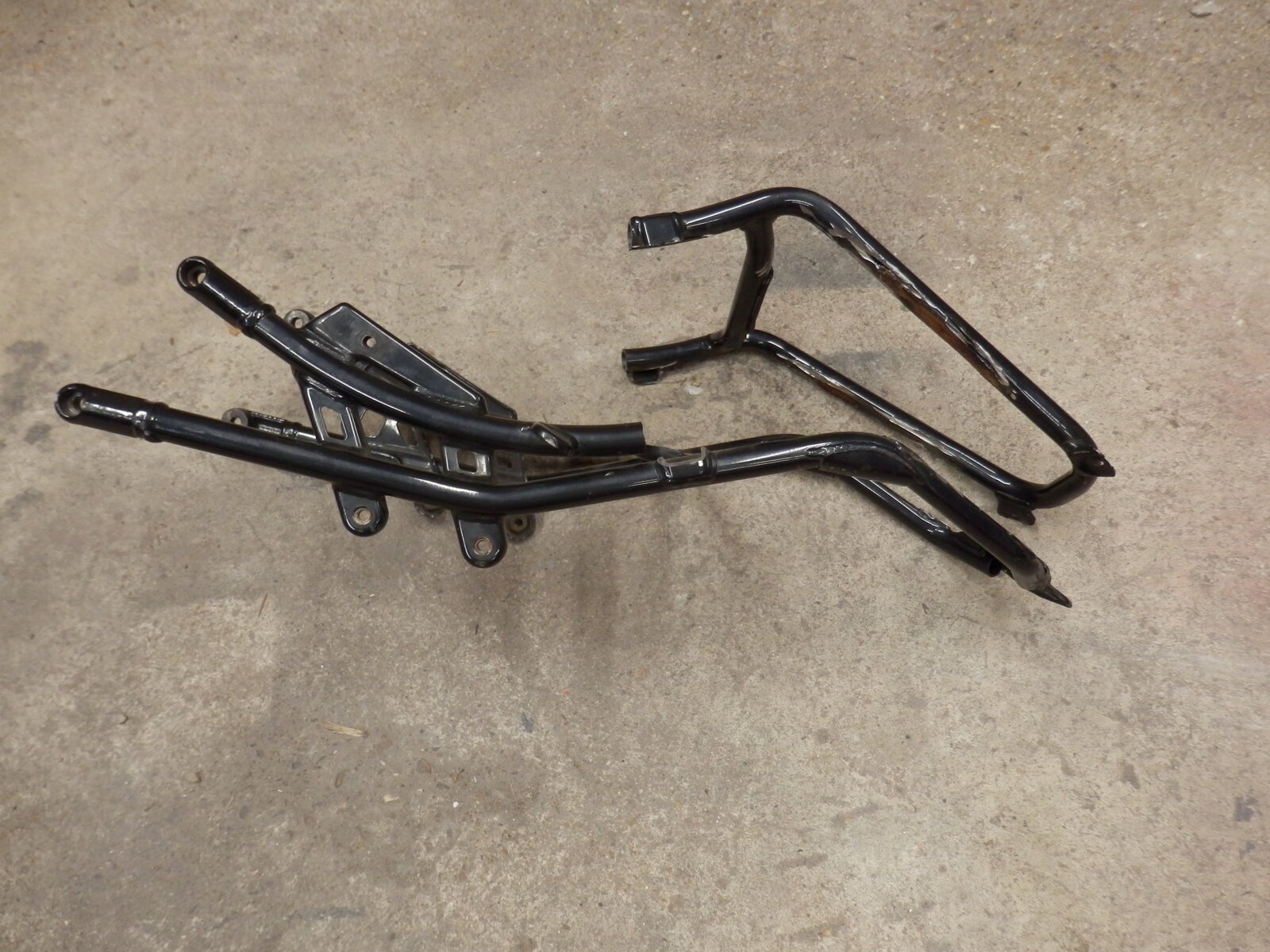

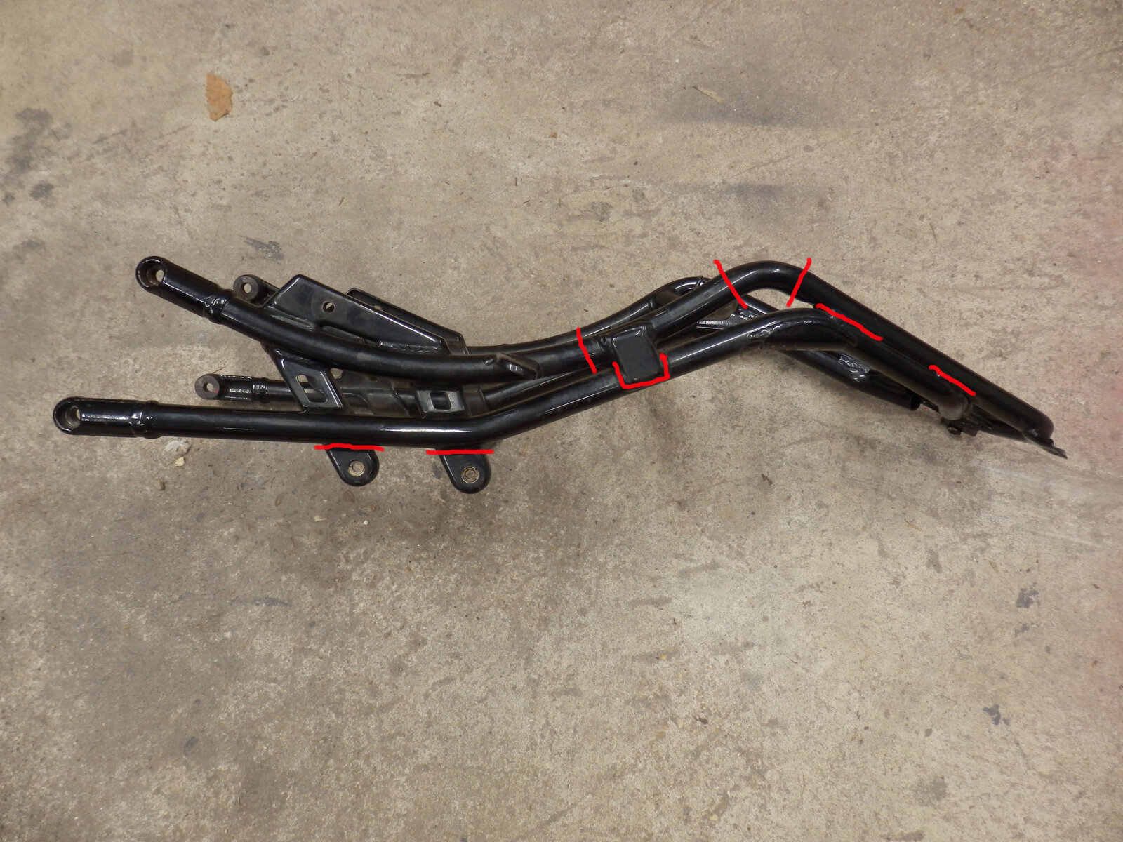

  9. Of course to use the RS tail I need a Monoposto 'Style' Subframe.
    I am obviously completely against the idea of spending £250 on a steel replica Mono subframe, or even more on an original Ali one, so need to turn to my spare Biposto one.
    As most know it's possible to convert a Biposto subframe to Mono by cutting off the top loop and doing some other small mods.
    I worked out where I'd need to cut it so I could weld back in the original bends from the top tube and make it look like it might have been meant to be that way.
    So after a session with a 1mm cutting disc:
    I cleaned it up with a grinding disc and welded the bends from the top tube in to finish it off again:
    The welds need tidying up a bit more, and of course it needs painting, but I'll do that when I know it all fits and doesn't need more mods.

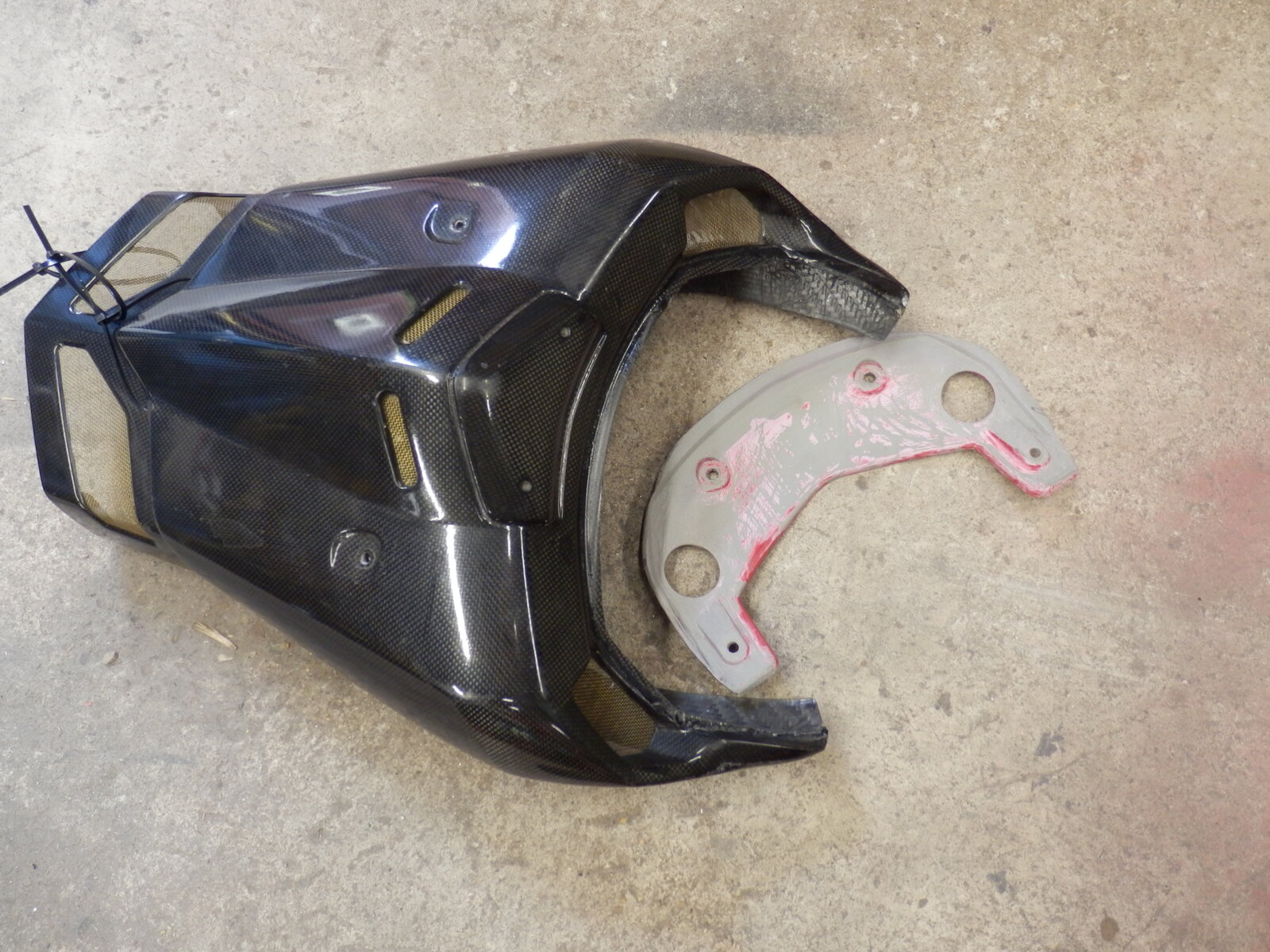

    this has already been retrieved from my storage container and is back on the options list:
    It's got @5 layers of paint on it over the Carbon, some of which haven't adhered to each other very well so have bubbled and peeled.
    What I'd really like to do is strip all the paint off completely, repair the damage it has then come up with a paint scheme that covers where I've repaired the damage but leaves small bits of the Carbon showing, just lacquered.
    Need to find a good chemical stripper that will get the paint off without effecting the Carbon.

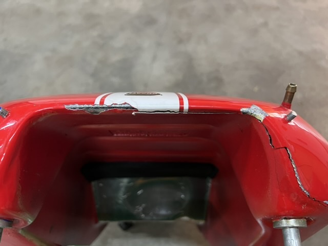

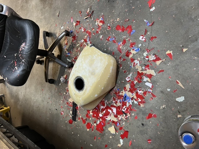

  17. Not sure if it is an option but may be worth a mention: I had the misfortune of damaging (to put it mildly) my 851/926 Carbon tank. It had a beautiful paint-job previously, but once damaged the previous layers sort of stratified and I was just able to scrape back the 3 or 4 previous layers with no stripper necessary:
  18. Thanks 749R, that's exactly what has happened to parts of my tailpiece, but only parts of it, and like yours only down to what looks like high build primer.
    I've had a good pick at it like a teenage boy with a Zit, but I want to take it all off back to the bare Carbon
  19. 749, is that not a Kevlar tank?
  20. No, carbon fibre, moulded in two halves (so they can install the fuel pump mounting gubbins, internal brace etc) and it has just split along the join. Raw carbon visible during repair prep:
