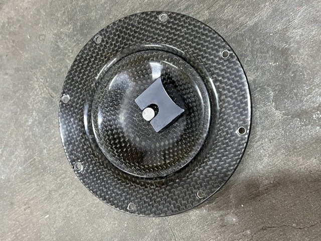

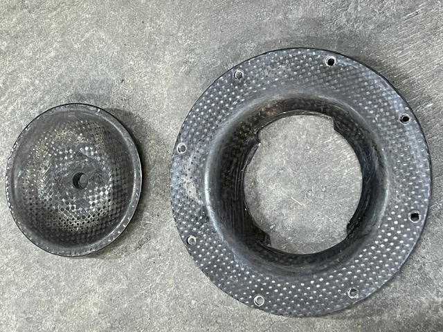

  1. Don’t be too worried about mild damage to the surface epoxy when you strip it back, it’s easy enough to repair.
    Here’s a cracked snd badly damaged Corsa carbon fuel cap, cheap as chips for obvious reasons:
    A quick sand to get back to solid substrate, mix epoxy as normal then thin it with 10% acetone, and spray as you normally would a clear coat. The acetone evaporates out leaving a nice epoxy finish. Another quick sand and polish (took all of 5 minutes) and Bob’s your mother’s brother:
    Note: I prefer a softer “glow” (it’s a race bike, “full tart mode” doesn’t really suit) than a full mirror polish but the latter is easily achievable if that’s your thing.

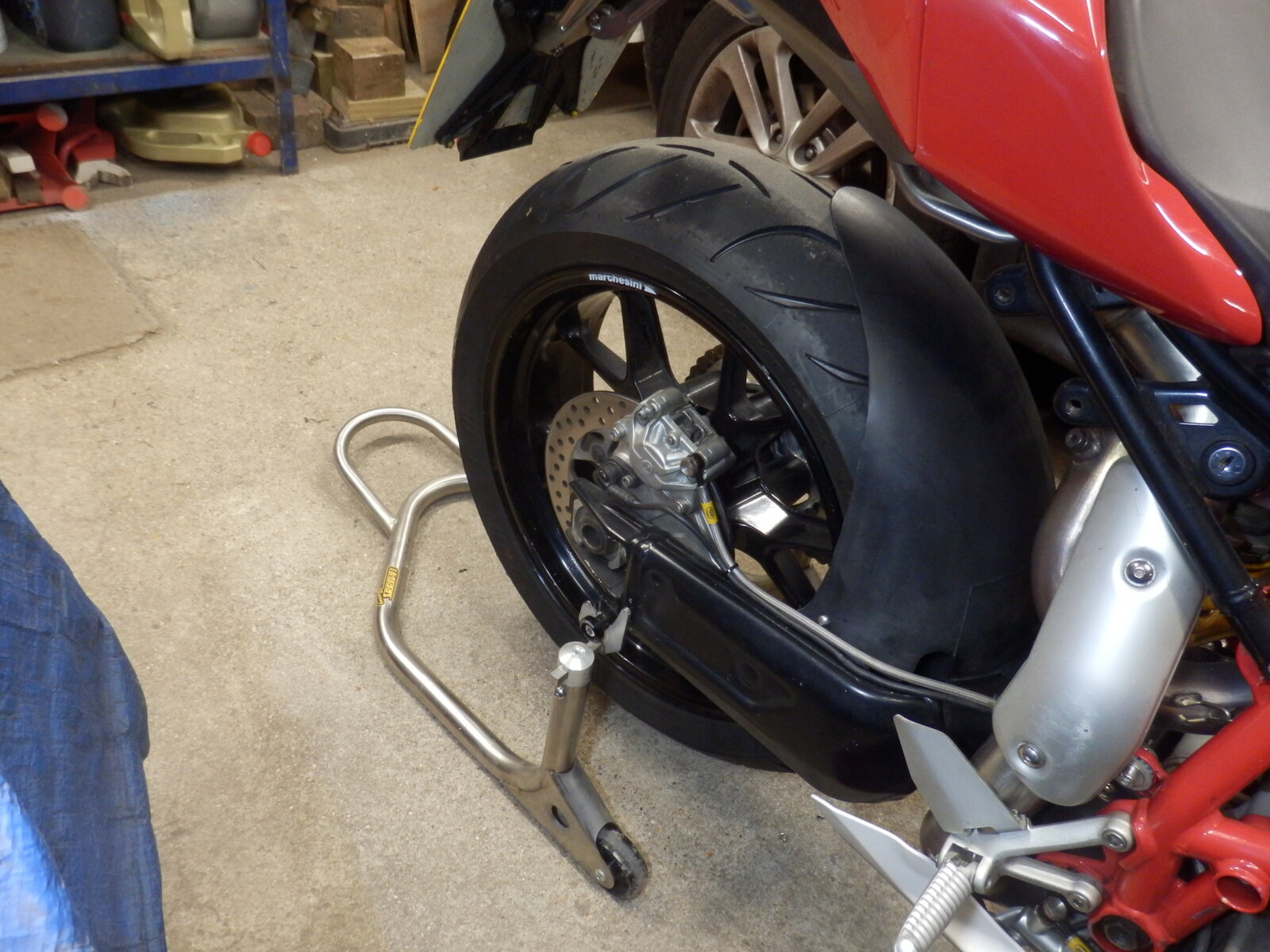

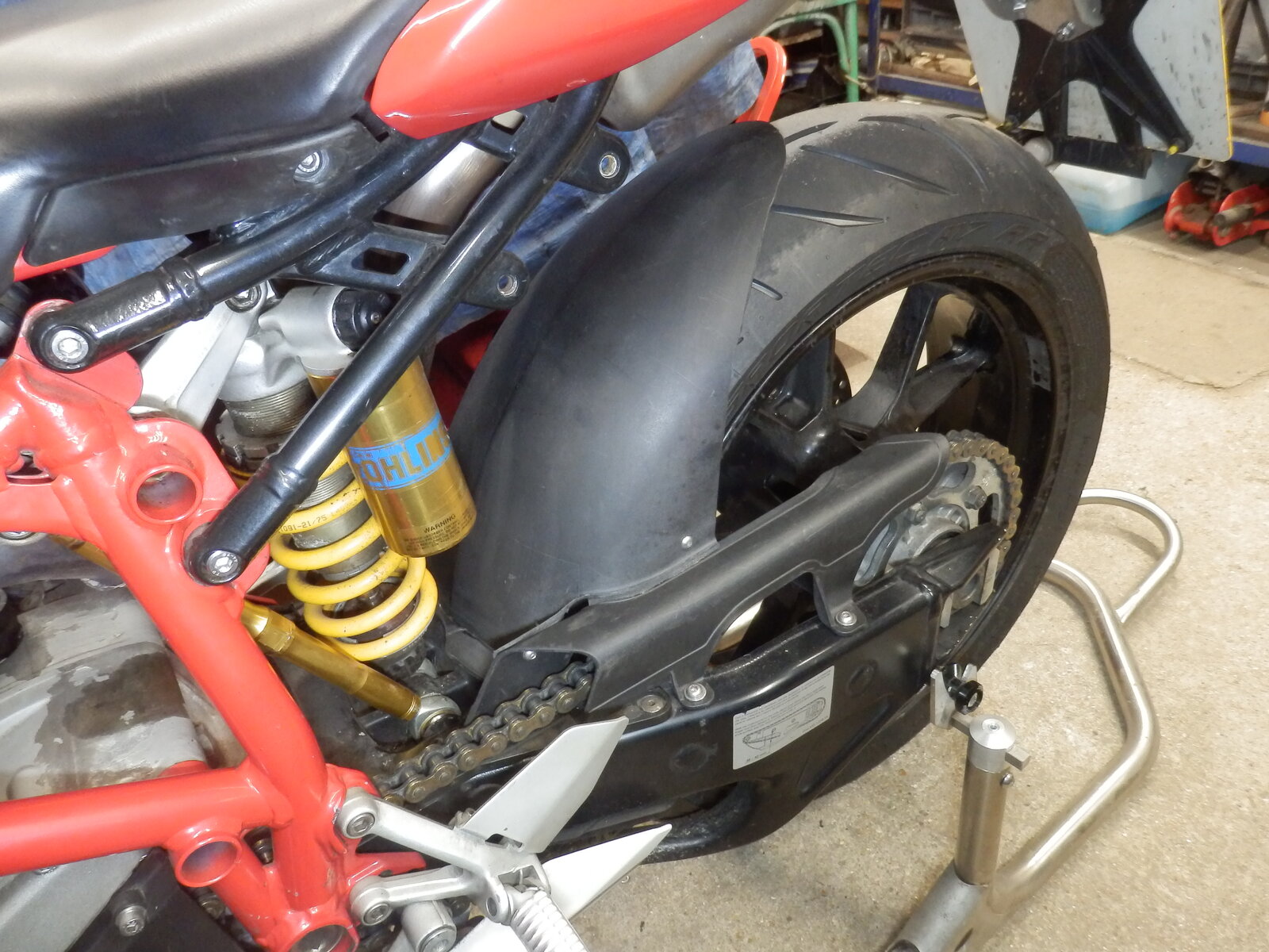

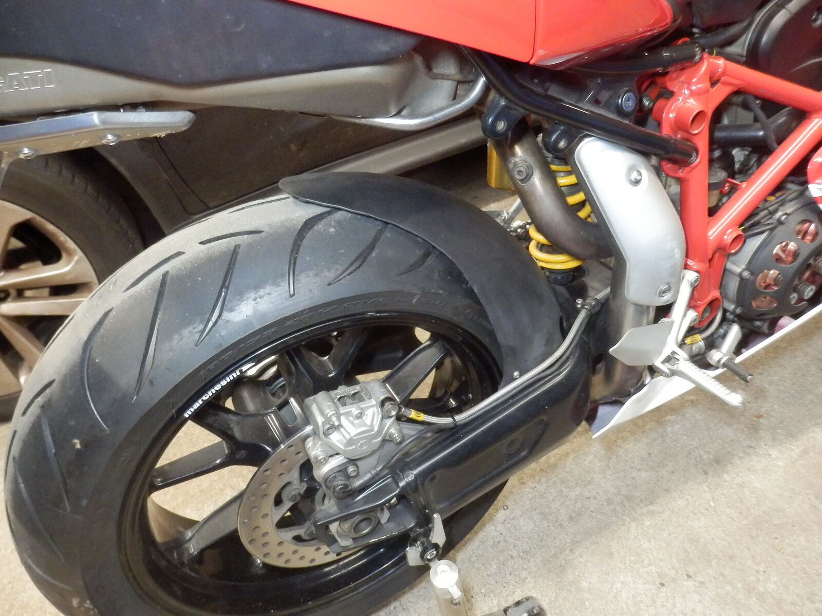

  2. I think most would agree that Ducati should have fitted a rear hugger to the 749/999.
    The look without one is good, but the shock is right in the firing line of any road crud etc, which is especially daft if you have an expensive Ohlins or similar shock.
    I've been looking for an aftermarket hugger for this project 999 since I got it on the road, I'm using the bike quite often, and am also fed up with the build up of crap around the bottom of the rear shock.
    All the time the roads haven't been salted I'll keep using the bike so need to do something.
    There are a couple of aftermarket options available for the later Black swingarm, in Carbon and fibreglass, but I don't actually like the look of them.
    What I want is a hugger that looks like it was factory fitted, so should really be in moulded plastic.
    With that in mind I had a play in my workshop yesterday with an old OEM M900 rear hugger that was broken in the chainguard area.
    I cut it back to make it shorter, trimmed it back around the original 999 Chainguard and made a couple of small hidden brackets.
    It's still longer than the aftermarket ones appear to be.
    I'm more than happy with it to make the bike more useable this time of year whilst I keep my eye out for an aftermarket one I actually like:

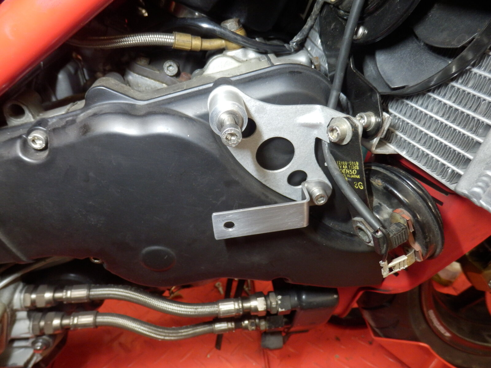

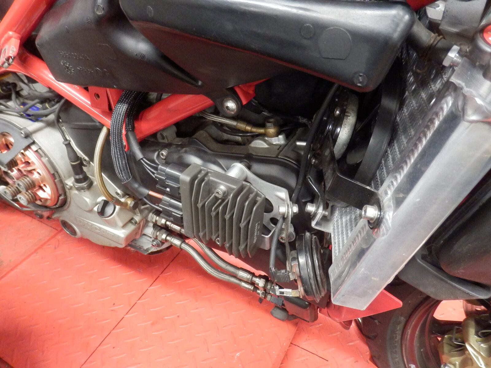

  14. Last weekend I finally found time to swap out the leaky Stator for a used replacement from a 749.
    But extended the cables over to the other side of the bike and mounted a later style MOSFET Reg/Rec from a Multistrada using the Horn bracket and some NHM parts.
