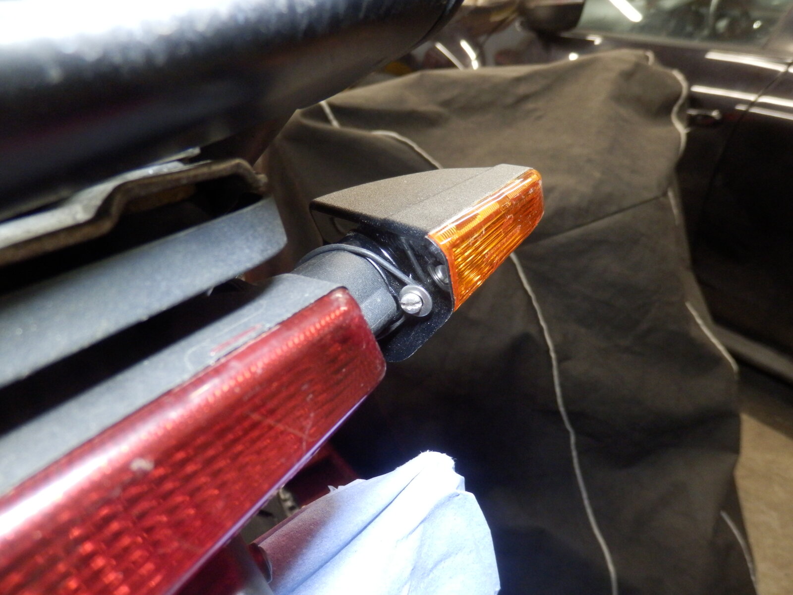

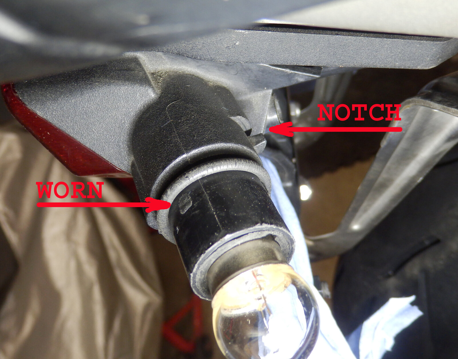

  5. Not sure if anyone else has had this issue, but I've now lost and had to replace two rear indicator lenses on this bike.
    The light unit is the same on the early Multistrada, and actually I quite like it and don't want to replace it with a more modern small clear one.
    But I can't keep replacing lenses, so needed to investigate.

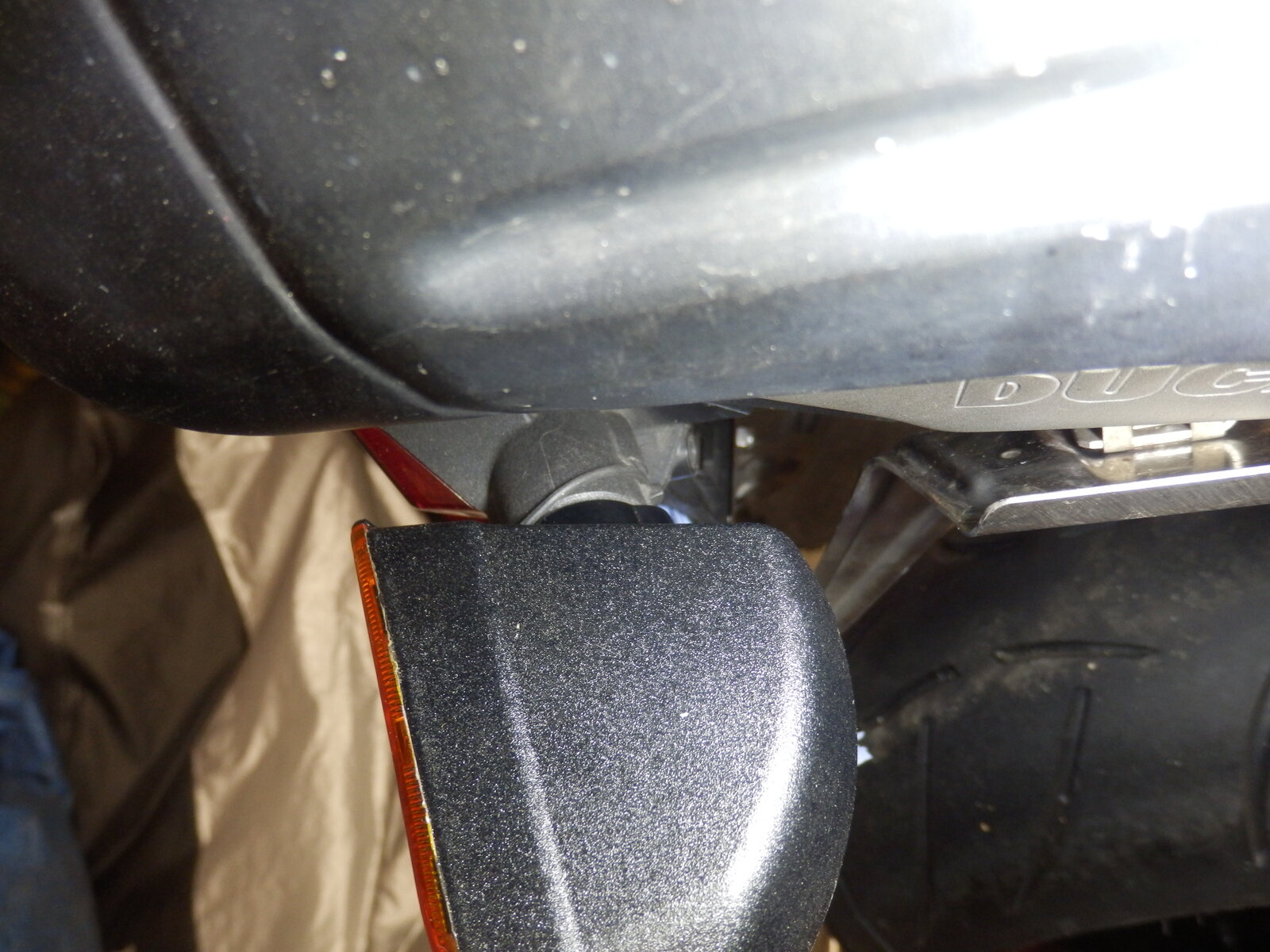

    The Indicator lenses fit on with a 3-pin Bayonet type fixing, but have always been very loose on this bike.
    The problem is that the 'pins' moulded into the main housing body have almost completely worn away and hardly now provide any location:
    But I noticed there is also a 'Notch' moulded in which I thought I could use as a back up to locate the lenses whilst I try to find a better used housing.

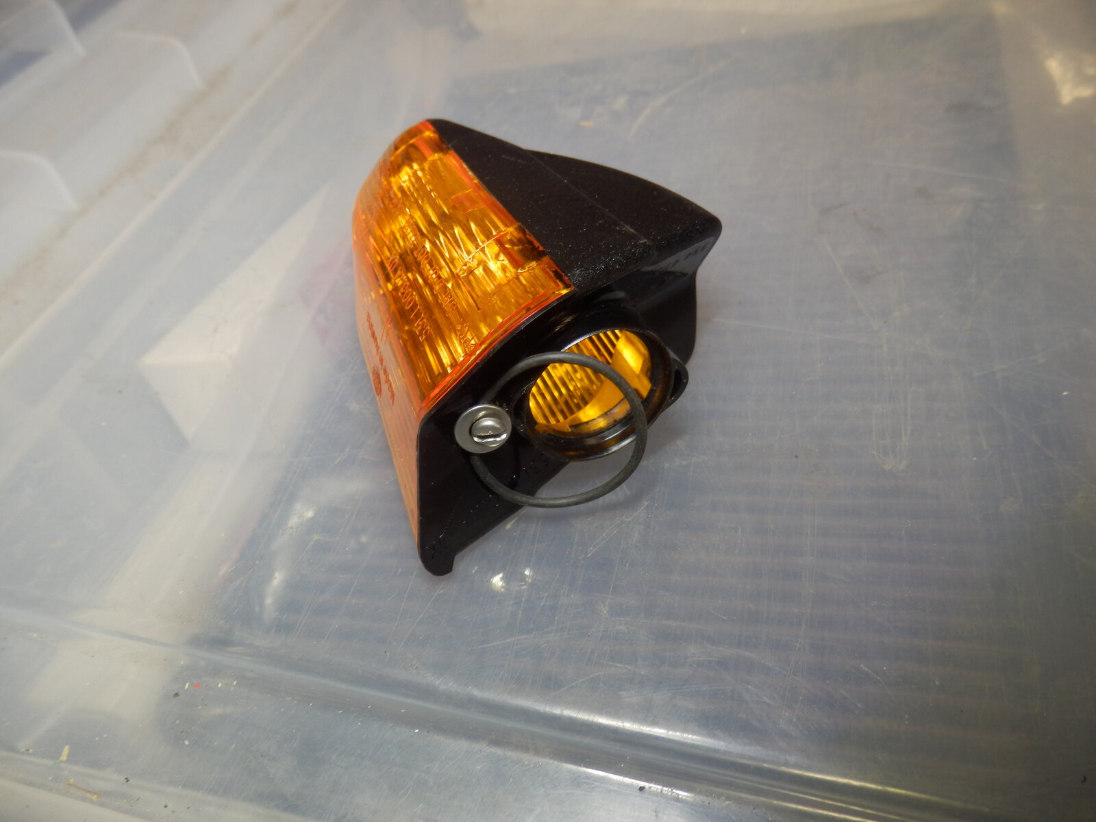

    I added a small Stainless screw and washer trapping an O-ring:
    Once the Lens is on the housing the O-ring is hooked into the notch providing a much needed back up to hold the lens in place.
  6. Nice O-ring fix! You could go belt and braces and build up the worn ‘pins’ with a drop of superglue and baking soda
  7. Bit of insulating tape wrapped around the joint?

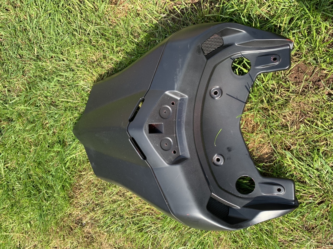

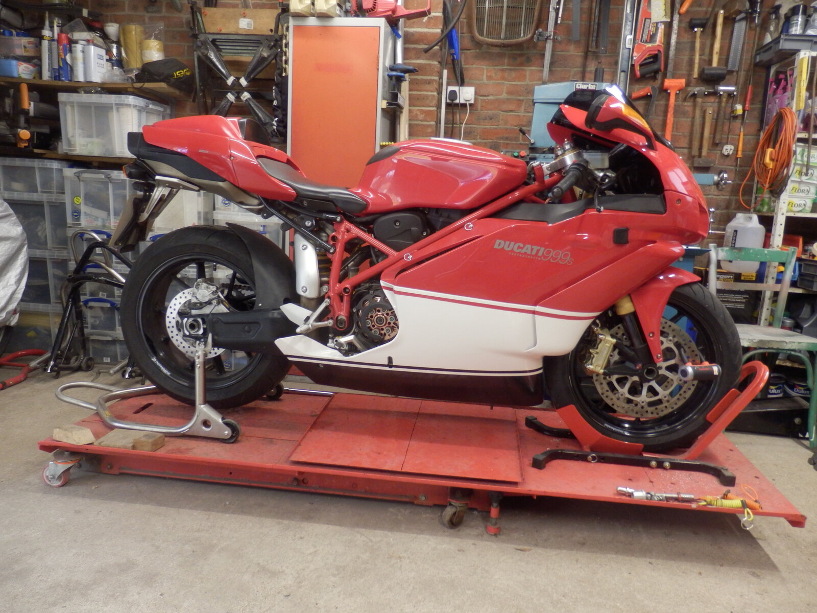

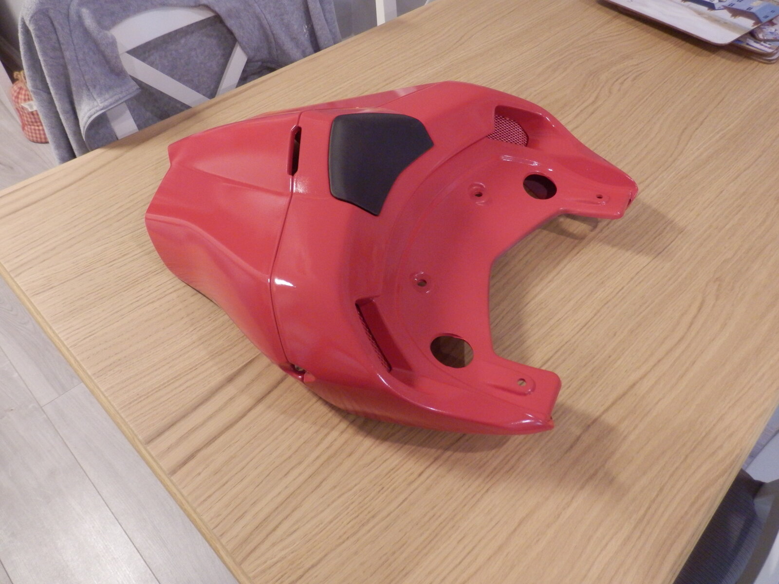

    With that in mind a while back I brought a standard Monoposto tail unit from another member on here, but in my usual way went for one that needed work because it had been Matt-Blacked, and unfortunately when I tried to gently get it off with thinners the Red came off underneath:

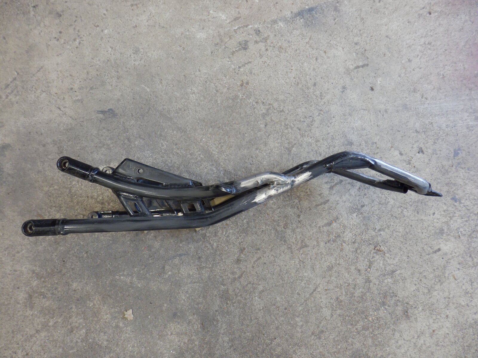

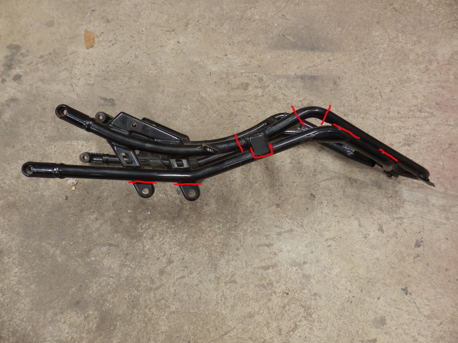

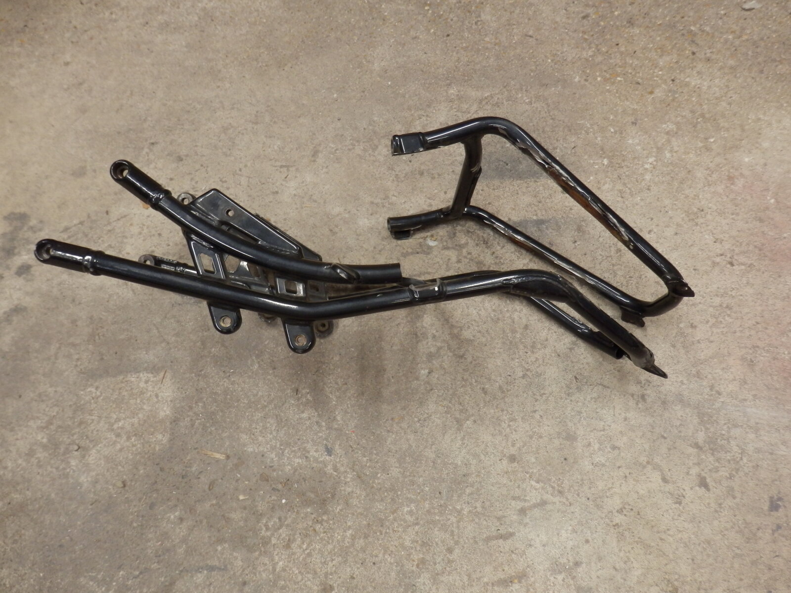

    I also of course needed to finish off the Monoposto subframe I was converting from a Biposto one.
    To recap.
    Cut here:

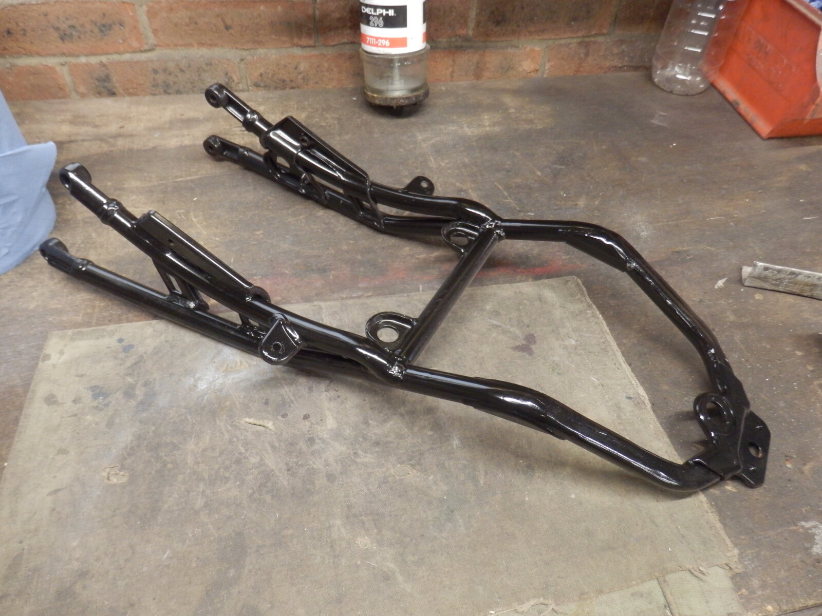

    Weld it back together using bits of the part I cut off to tidy the ends:
    Then give it a couple of coats of Black Smoothrite:

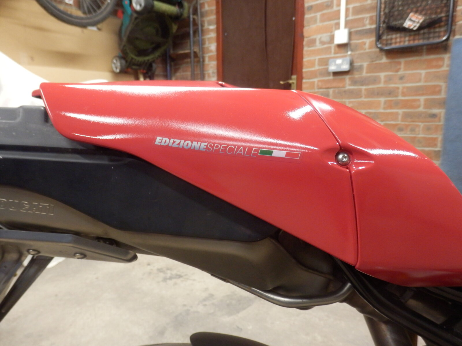

  9. The plastic got one of my 3ft paint jobs, definitely better than a 6ft one, but not perfect enough for 6in scrutiny.
    Note that although they look great I specifically don't want to go with White number boards on this bike:

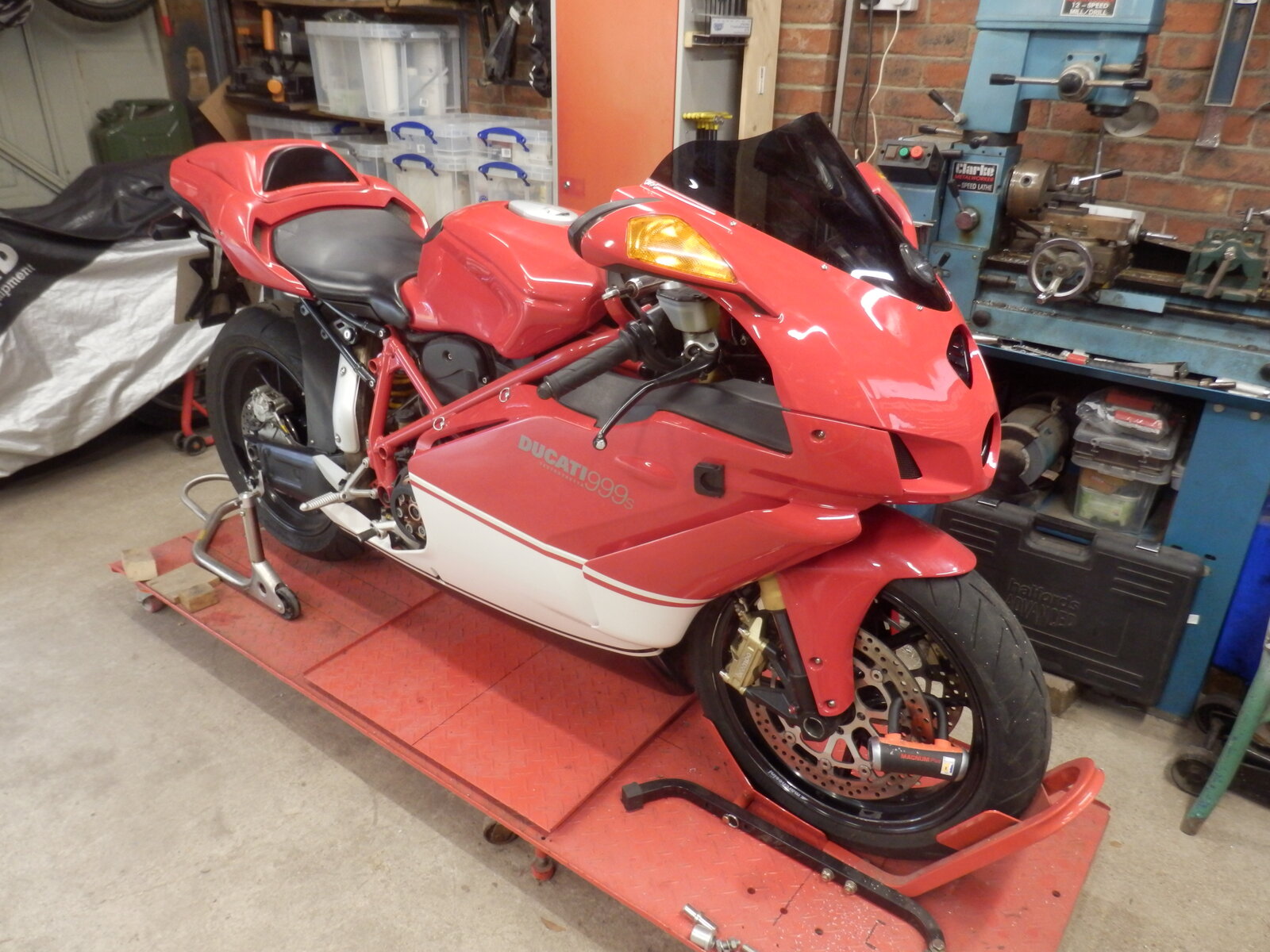

    And there it is:
    I quite like it, and have added some decals I brought ages ago, in the same colour, style and position as standard ones, but not the standard text:

  12. Had the same issue and used black tape myself to make it stay in place!

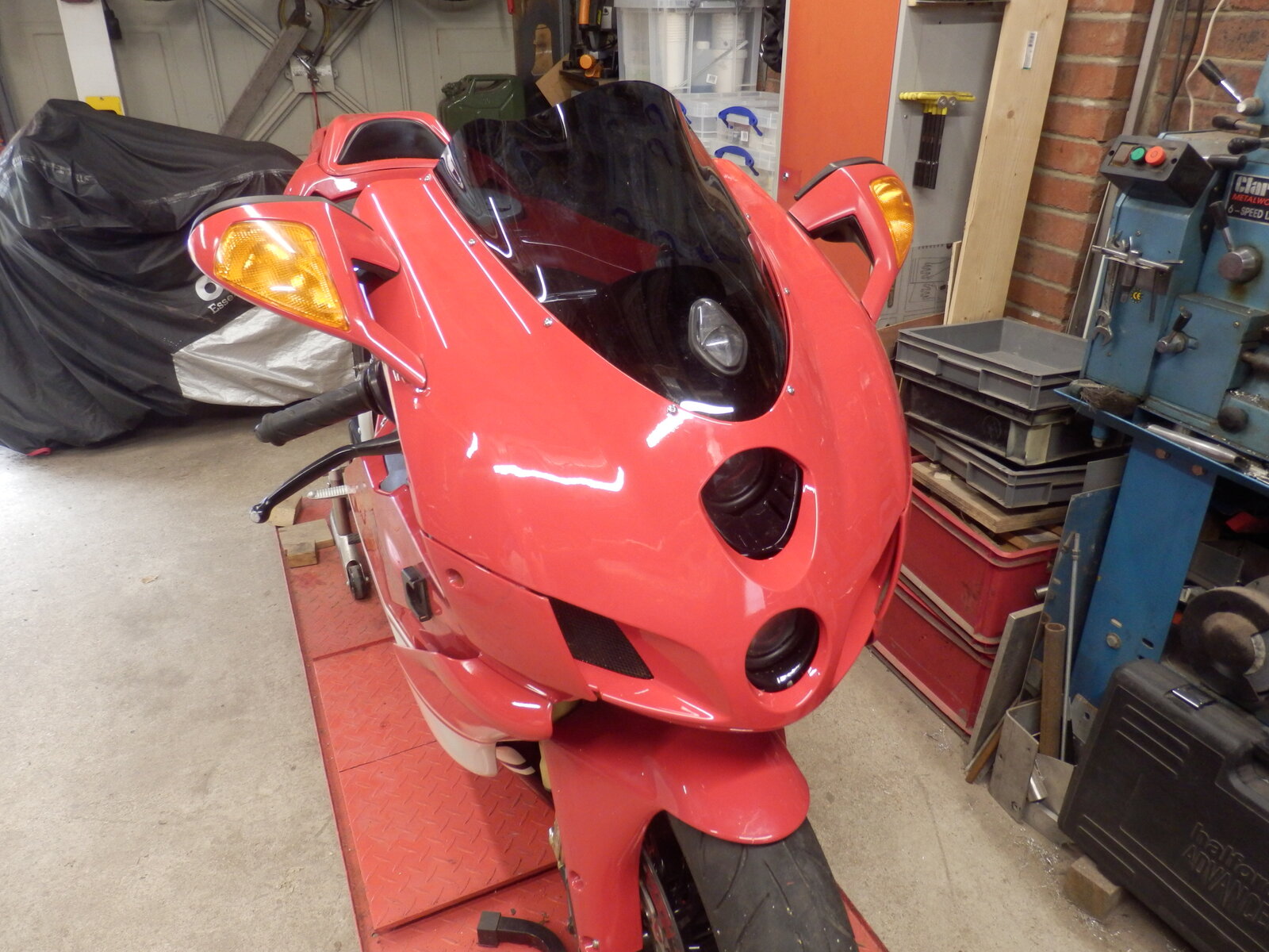

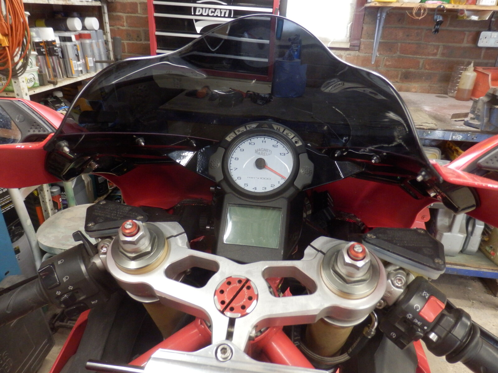

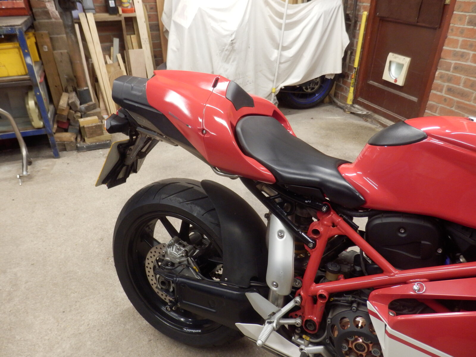

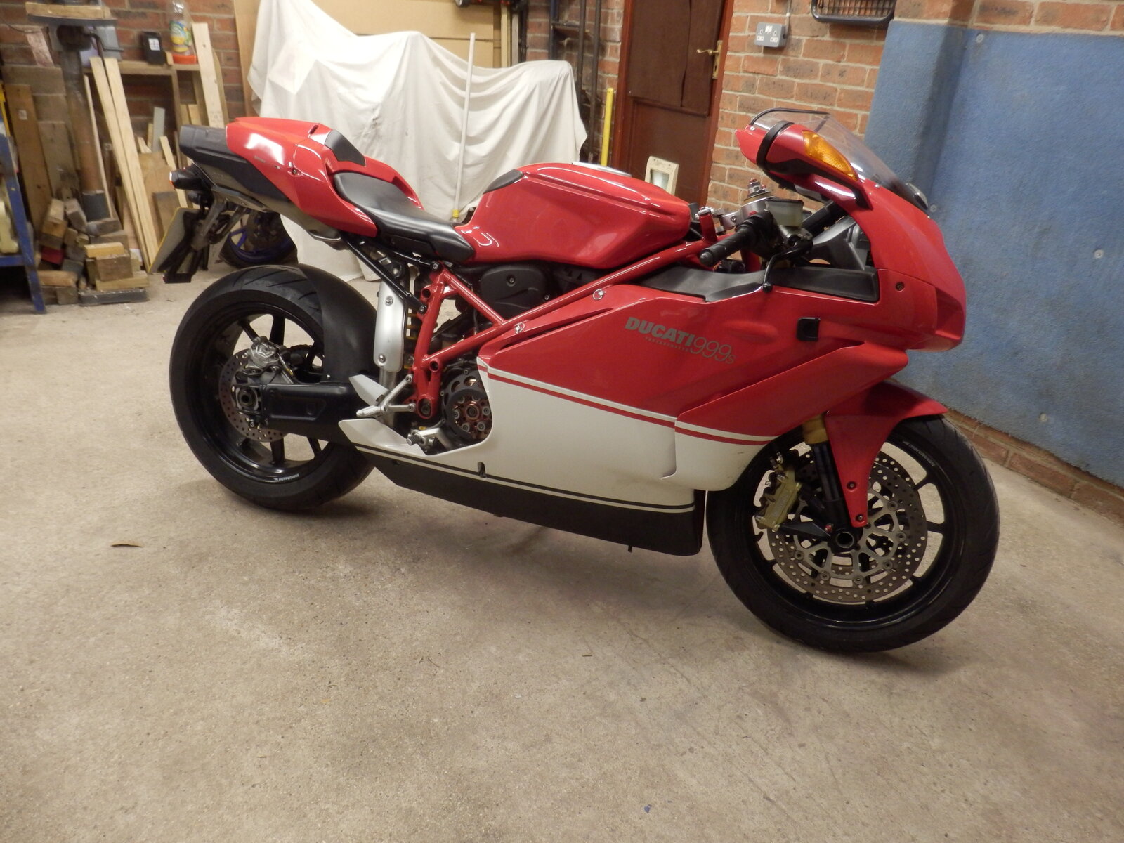

  13. This bike is now back with the Biposto seat unit, but with the Ducati Performance single seat converter I first fitted.
    I prefer it, and it provides a small locker to stash some tools or a disclock.
    It also now has a Black headlamp shell, which I think contrasts better with the Red bodywork, and a Black aftermarket screen.
