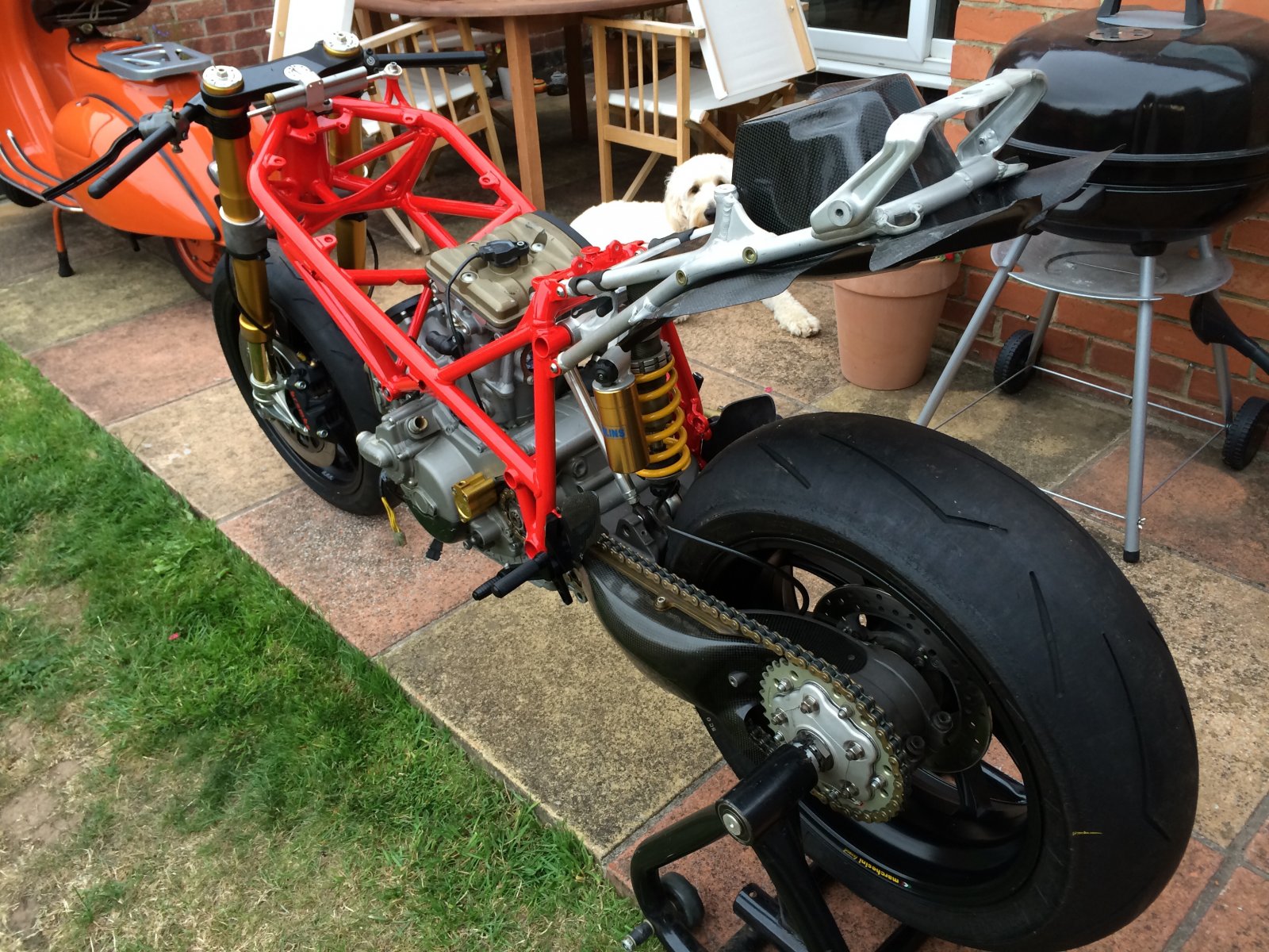

Project "dark Horse" 748 Hybrid
Discussion in 'Builds & Projects' started by Tommy B, Jun 3, 2015.

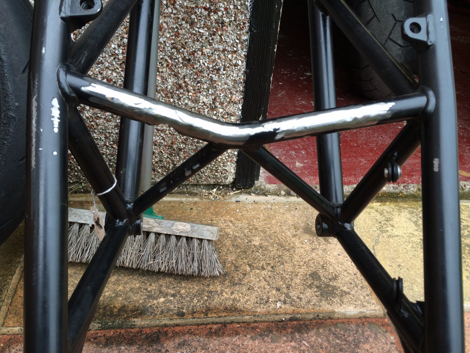

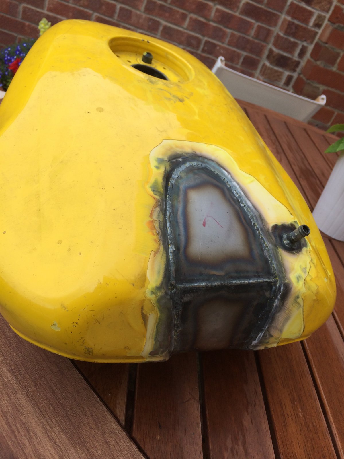

  1. Nope, a chap called Nick down in Bucks.
  2. Trevor from?

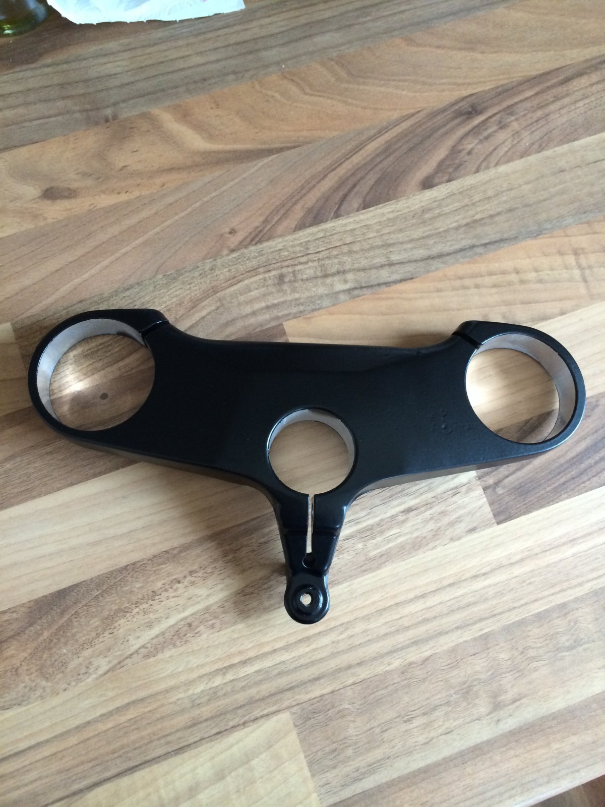

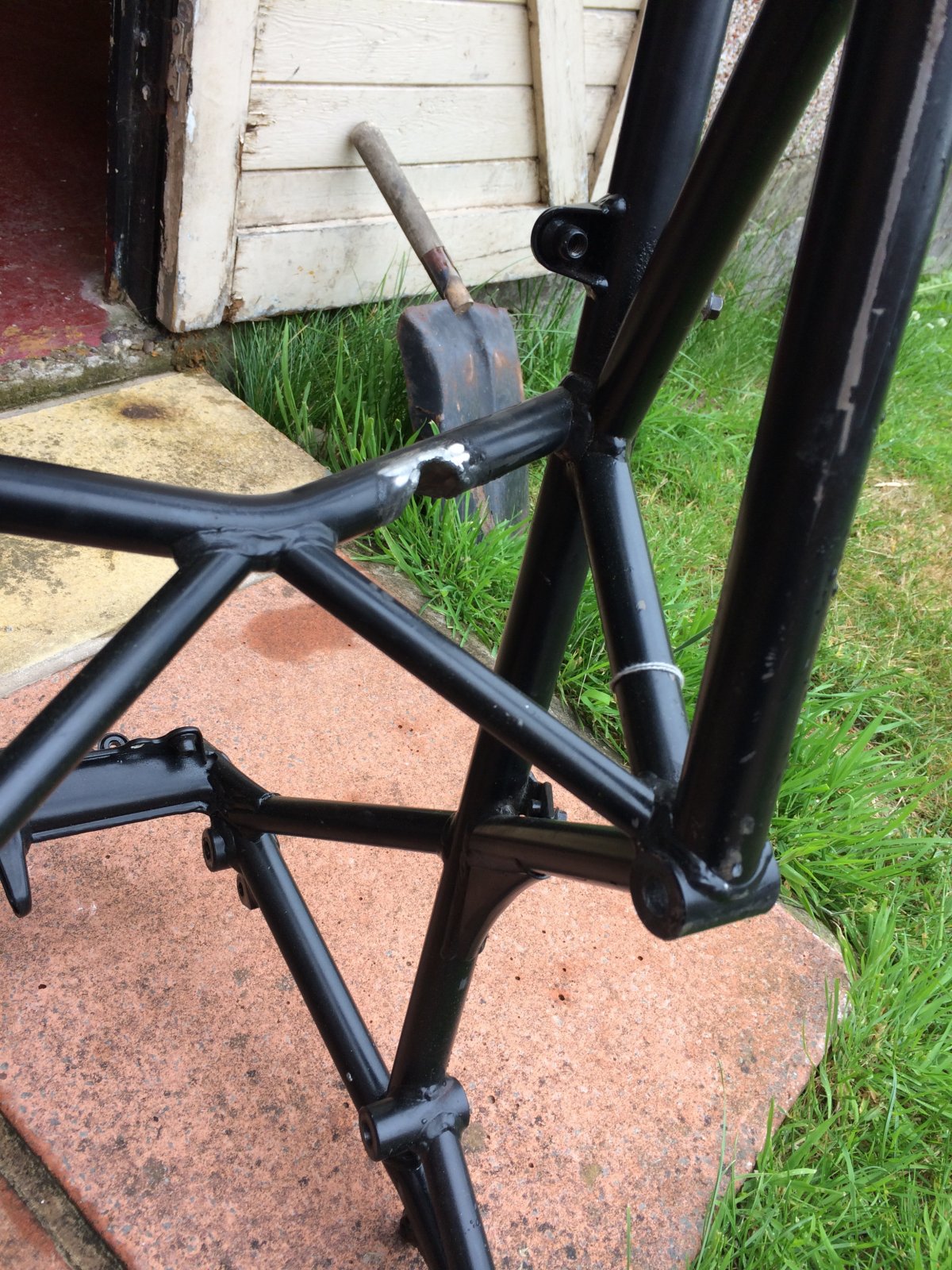

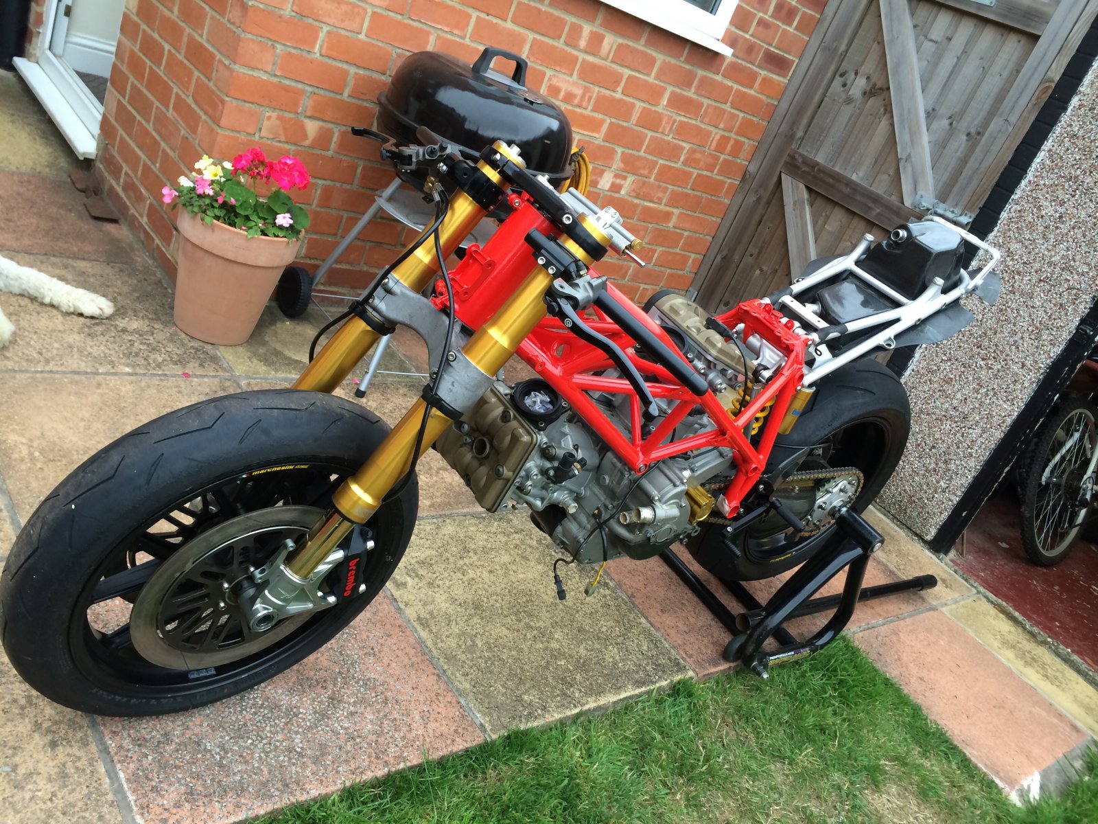

  3. Frame and tank back from the welders. Could be neater but hey ho.
    Top yoke powdercoated and trimmed of excess ally.
    Frame being blasted then painted next week.

  5. What gearing are people running on there's? @Nelson
  6. I'm running stock 1098. IIRC is 15 38. I did play with a tooth lower on the front, it was too low for the road IMO.
  7. Cool, I'll try standard first then.
  8. Nice project

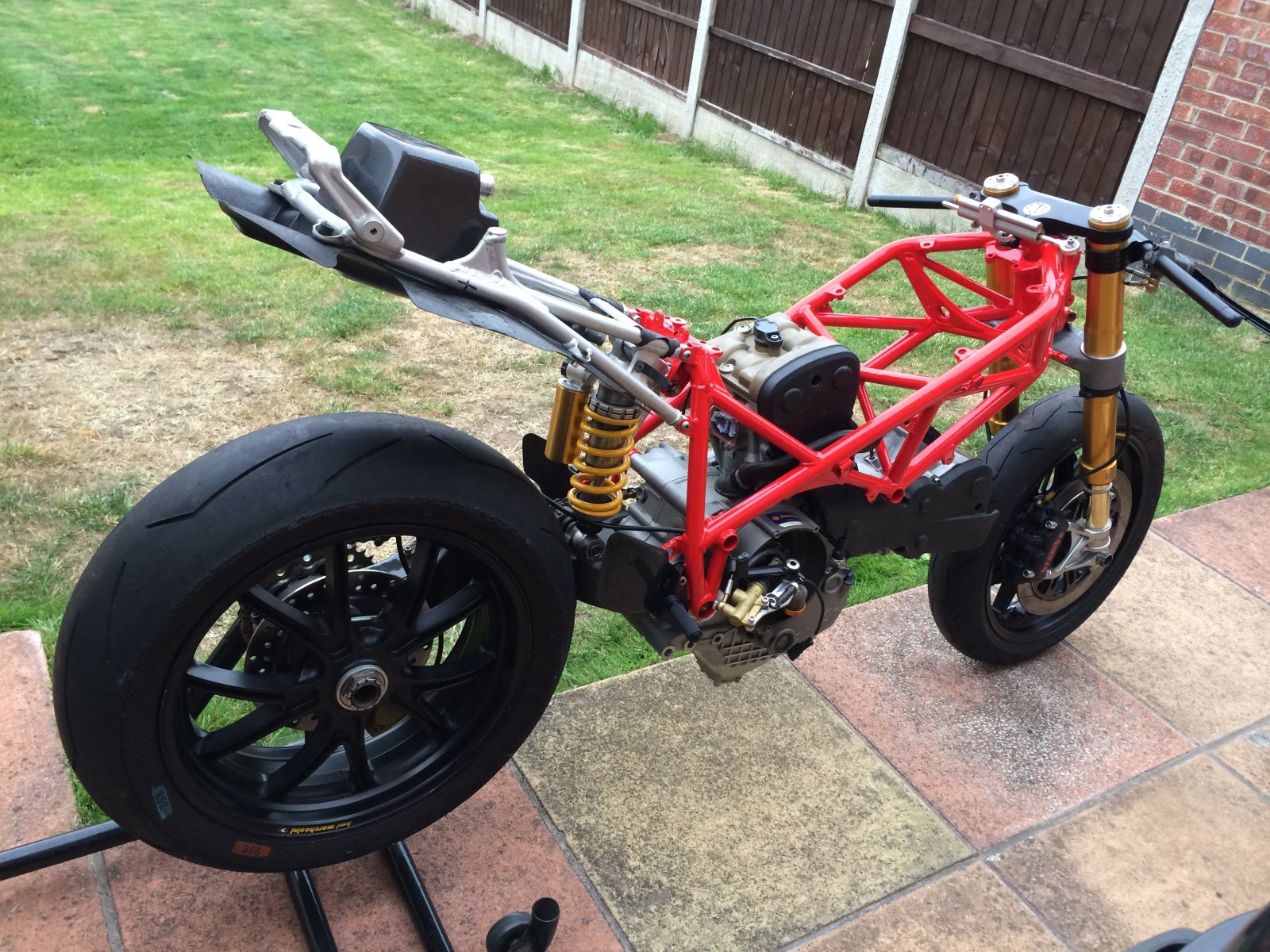

  9. Made some progess today, least it now rolls!

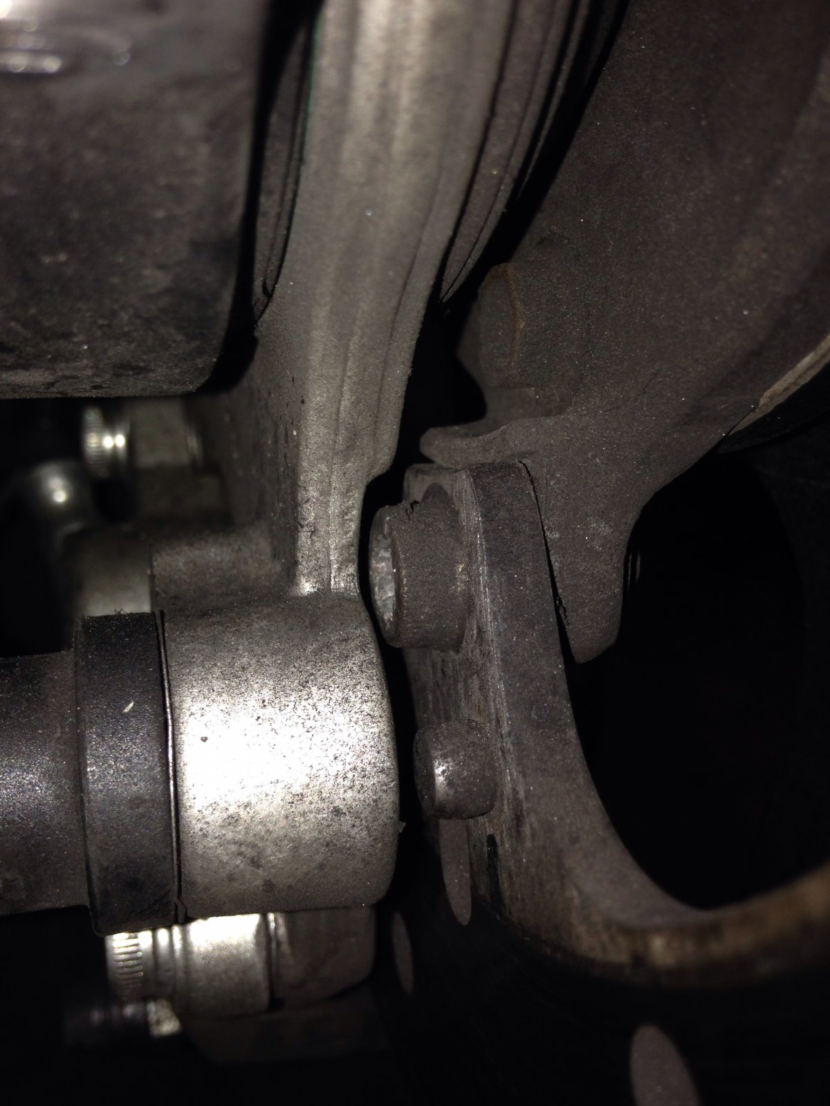

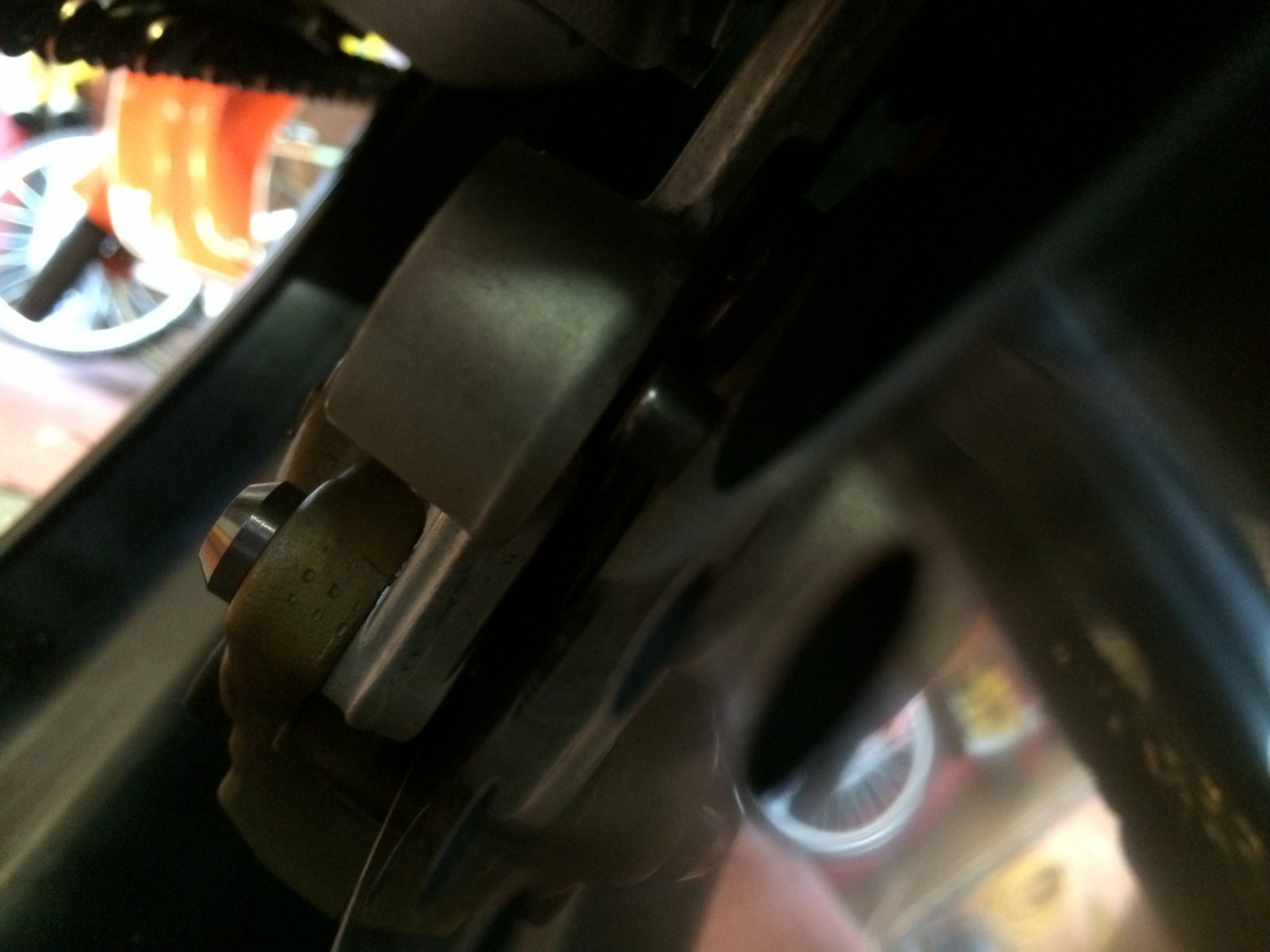

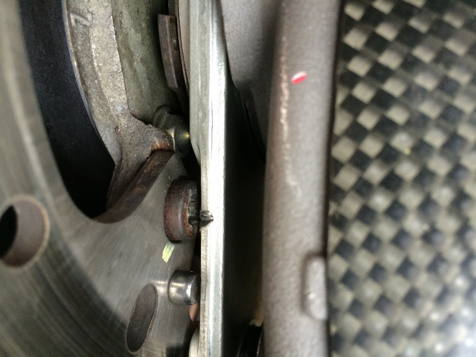

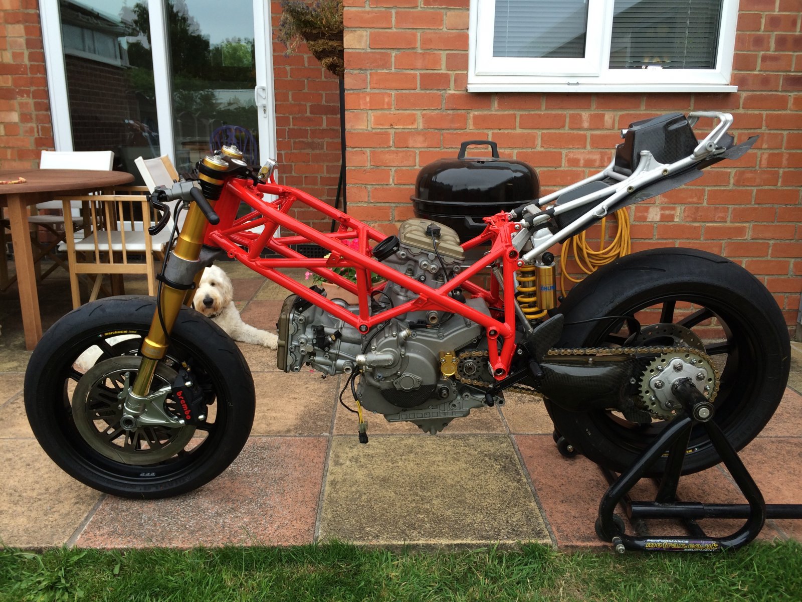

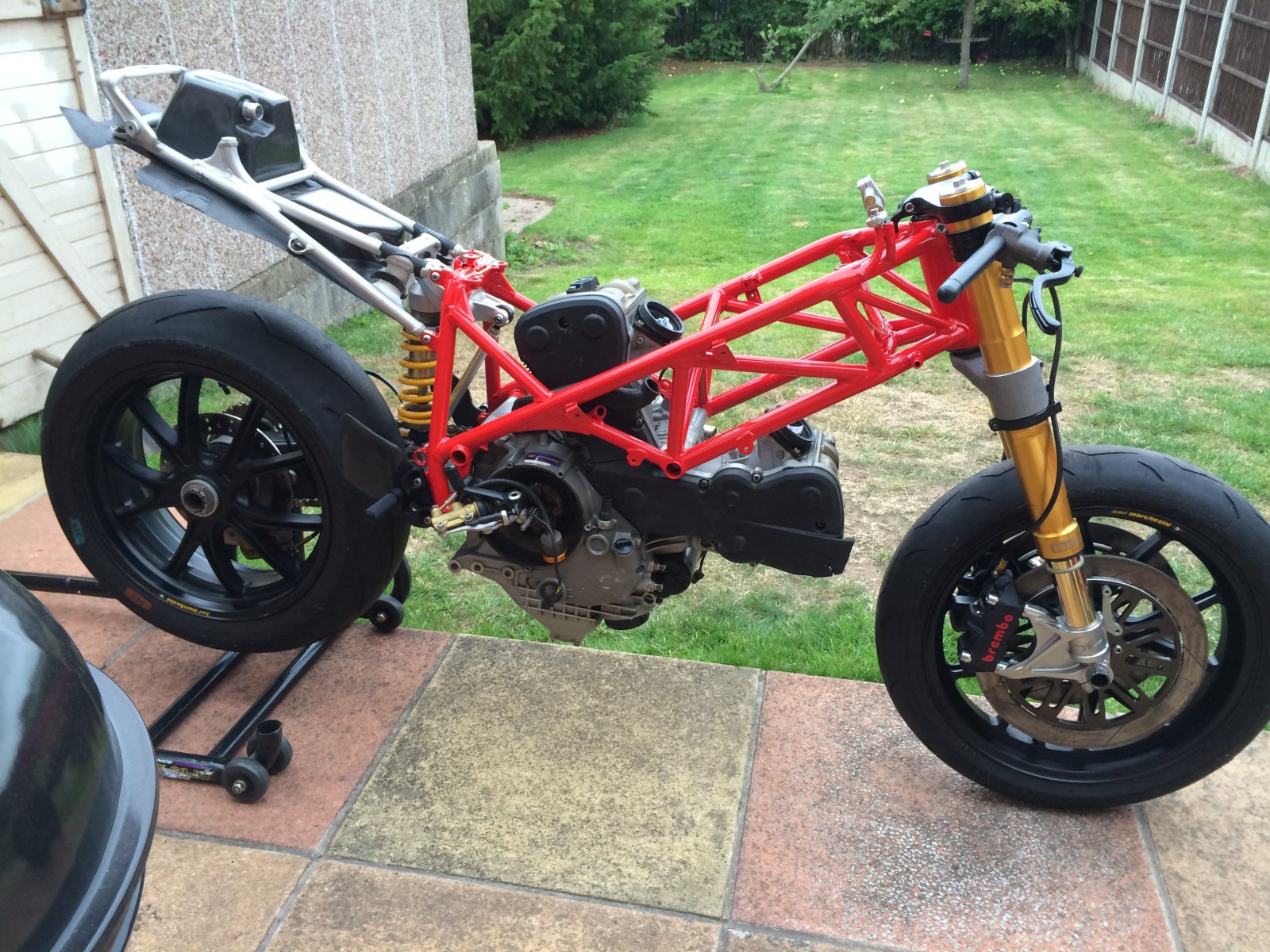

    Having problems with clearance on the 848 caliper hanger and the pips on the 848 disk!..thoughts anyone?..feels like I'm missing a spacer/washer some where??
  10. Is it an 848 hanger?
    When I see a project in that state it always tempts me!
  11. Yep, 848 hanger and disc, 748 hub etc. Just seems very very close...unless the hangers bent?
  12. Hmmmm - check all the clips,washers, clips, washers and more clips and washers are in there.

  15. The pips on my disc are literally faction of a mm away from the hanger!...actually, seems to have settled itself a little after wheeling it around. Now looks a little better.
  16. The pips on my disk look longer than yours!
  17. They need to run close for the sensor pick up.
    Yours do look a bit longer TBH
  18. Yes Bud, there off an F4 RC...good as they come standard with the 30mm nix cartridges.
