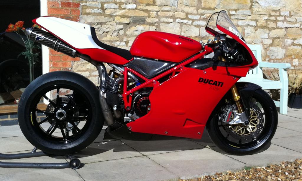

    As you seem so obsessed with "the real world" heres my bike i built!.............that should have the real world experience of ducati bike building covered.
