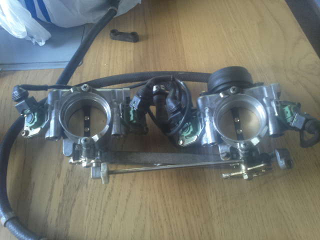

  6. I thought the 4 injector throttles worked ok on the sps etc, as they worked sequentially. dual ign pick-up and P8 ecu.
    On the 996 they worked concurrently. You can get an Ultimap chip and r/road set-up to get them to run on two injectors.
    Restricted, please take advice from members, they could offer great advice and save you some cash. Also, I know you are doing an ebay only build but don't discount items offered here, as they might be cheaper, or indeed hard to find.
    Andyb has vast knowledge on Ducatis. I am not sure he has a build thread on here but here is some info.
    http://www.italiansportingclub.co.uk/my-748r-build_topic5483.html?KW=
  7. Indeed, if required you can just disconnect 2 injectors and then it is as per the single injector TB, so nothing lost if only single injector is required...
  8. You cannot just disconnect the injectors, as the injector timing pulse needs to be altered (extended)via the new chip.
  9. Agreed, but what I meant was that if the bike was built with, for example, a 748 ECU then unplugging the injectors would make it the same as single injectors. So actually this TB setup gives more options with the build as the option for twin injectors is there which would not be the case if single-injector TB was fitted (ECU dependent)

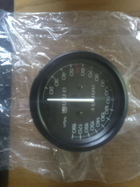

    brand new old stock speedo... should be zero miles but has 1 on it, close enough...

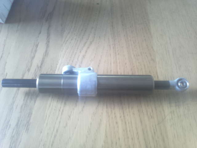

    found a steering damper for next to nothing so that's ticked off

    so I present the SPS throttle bodies...

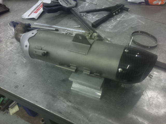

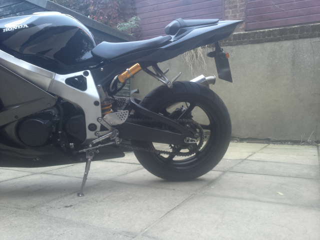

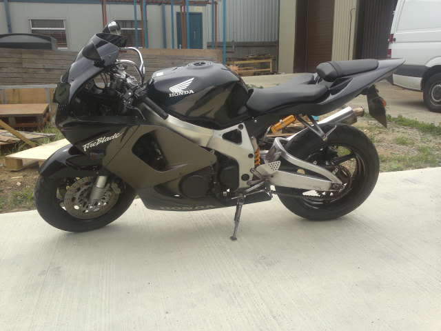

    in other news I got my custom end caps fitted to my replacement cans for my 'blade
    yes they are standard Yamaha R1 cans, to go with the R1 subframe and seat unit I have fitted to the bike, just need to finish fabricating the headers I have made and I can sign that job off..

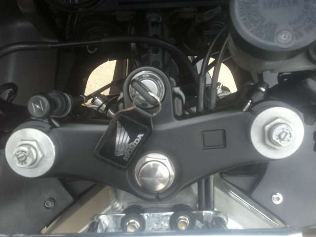

    and got my top yoke and swingarm painted and fitted
