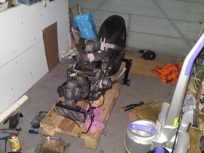

  6. Crap bike 1 me 0. Forgot I do not have the tool for top yoke. No worries will start from back .... Out of 4 screws holding the rear mud-guard two have sheared at head, one rounded off and one went out with no hassle. Had to drill the head off the rounded off one to remove mud-guard. Now do I drill the sheared bolts out? It is an alloy swing-arm. Front mud-guard not much better two out of 4 white mounts had to be cut off. On good note frame is now off the engine be it with yokes still attached but progress.

    If they hit some big revs then hey - get the crank balenced. many of us will never afford either the time, money or interest to do so? Its a very simple motor capable of putting up with a lot wrong before it will blow its guts out. :upyeah:

  13. A fix for the yoke nut is to drop the forks through the yokes and use the top yoke clamped to the ally nut and tap it round with rubber mallet.
    Don't dispair with all the pokey comments, it will look well when done and the fact you have done it yourself will give added pleasure, just SEEMS like a bitch at the mo! keep plodding on.
