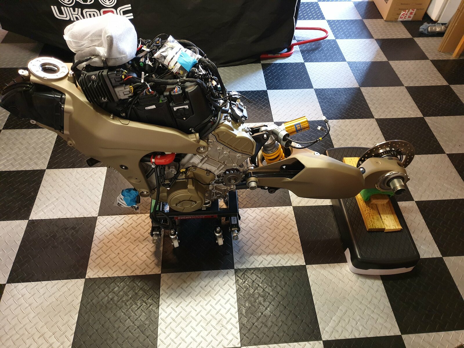

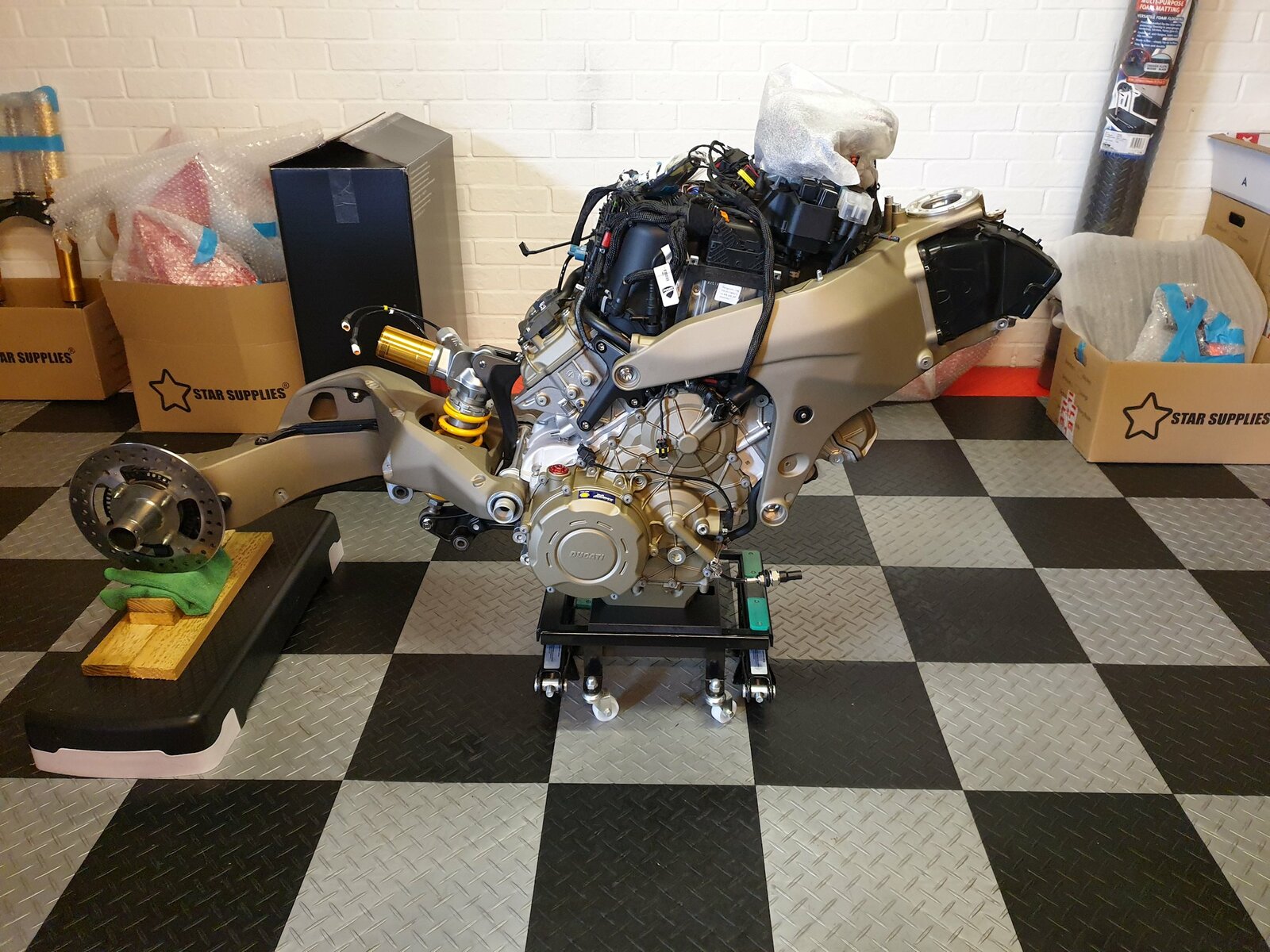

  3. It'll be a while longer sadly. Have suffered a few setbacks. The tensile strength of the stainless steel bolts I had manufactured for the rear suspension were not as per spec and exhibited thread stretch at 90nm, long before the 120nm they are meant to be torqued up to and so for the sake of safety, I have decided to use the stock steel items. As a side effect to this discovery, the two link plates/tie rods were damaged during the assembly so these are being replaced and the new ones will have to be re-coated. This has pushed back progress by a week to ten days, notwithstanding more pressing work commitments. Frustrating yes but once I am over this minor hurdle, things will move on pretty quickly.

  5. I've decided to have the OEM nuts and bolts Cerakoted (back with me tomorrow hopefully), as they are safety critical bolts. As for the stainless steel frame bolts which I have already fitted, these are of a lower torque rating, and are thankfully fine. Everything else remains stainless bar these three bolts. I will upload a few more pics later on today.

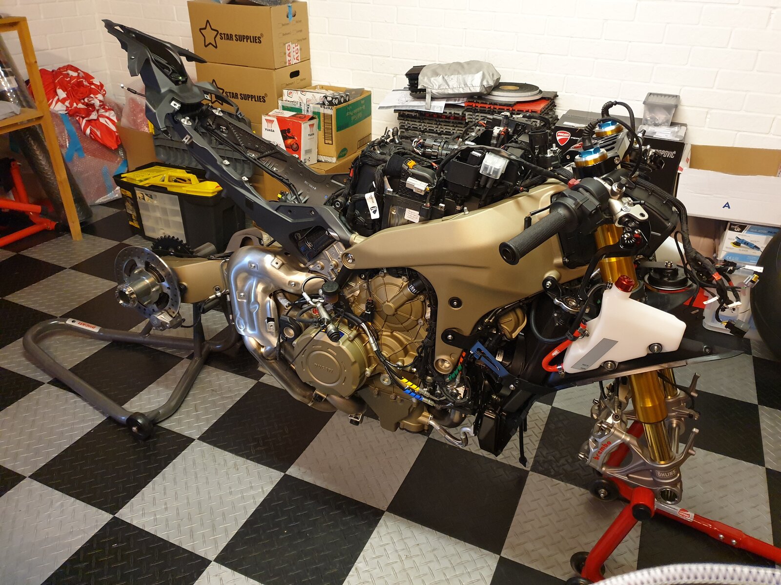

  6. Frame and swingarm re-united with the engine. Still waiting for the "dog-bone" trailing links to come back from the Cerakoters, then I can fit the rear sprocket and paddock stand, then move onto the front forks, with the aim of getting to a rolling chassis by the end of the weekend (if all goes well, in between packing boxes in the house before we move!). More info and a ton of new pics on the project page.
