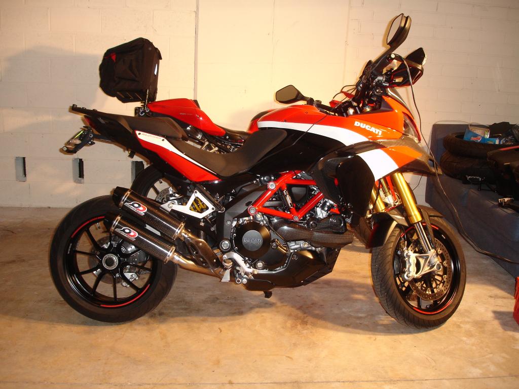

    Quat-D's on a PP :)

  19. The QD's DO have a c'stand stop/bracket thing on them. I posted a pic ages ago when none of you buggers were paying any attention to my bleatings about the QD's but no one listens to me except Andy & Ebrew :)
    ...and if you look closely or enlarge the pic of the worlds greatest machine posted earlier, you will note the c'stand "stop" directly under the right peg.
    It stands out like dogs bollocks, probably because it's not black anodized same as the exhaust hanger isn't as was pointed out to me by some whining old bastard ;-)........WILLIAMSSSSSSSSSSSSSSS :)
