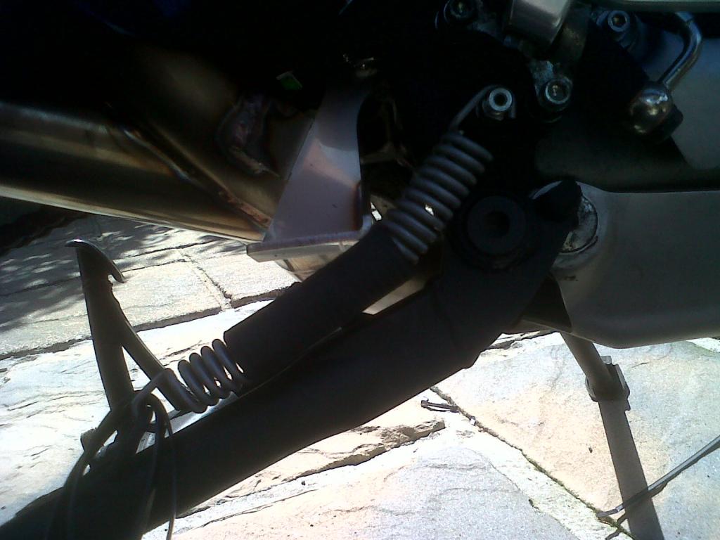

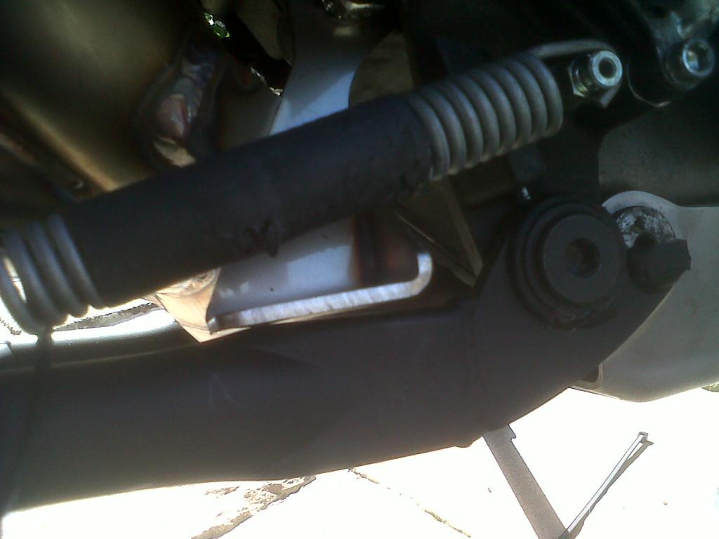

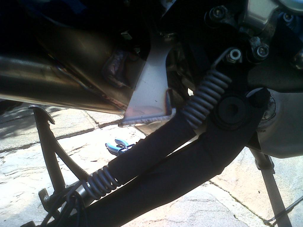

  6. E-Mail just sent to QD exhausts;
    "Hello
    I have bought a QD system for my 2010 MTS 1200S and fitted it today.
    It fits fine but the centre stand stop plate is a disaster.
    The spring sits above it, rolls over it when you put the stand down, tearing
    the rubber covering then jams between the bracket and the stand, stopping
    the stand going up fully.
    Did you try this before putting this into production?
    The only thing to do is to cut off the bracket then try and fabricate
    something that works.
    I am very unhappy about doing this so will use my bike without the centre
    stand until you give me a satisfactory solution.
    I look forward to hearing from you.
    Pictures enclosed."
    Properly pi55ed off with this, the design of that bracket is utterly pants. IMG00212-20120618-1037.jpg IMG00214-20120618-1037.jpg IMG00215-20120618-1037.jpg
    You can see the damage done to the spring covering after trying just the once as the edges are like razors.

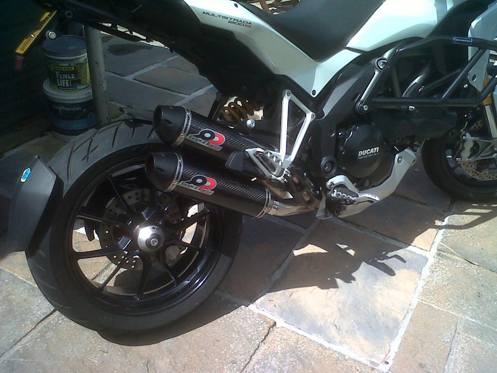

  7. Morning Triple. Mine should be with me tomorrow, sorry to here about this mate but I need to ask, how does the thing sound!!!!!!!!!!!!!
  8. Fine. Louder than I expected with the DB killers in if I'm honest. Not quite as fruity as a MiVV and Termi though.
    Not ridden it yet, plan to do that a little later.

  9. I sprayed the can hanger and joining plate satin black yesterday, it needs that IMHO.
    When the winter comes I'll have them powdercoated along with the rear footrest hangers as well.
  10. Well they sound really nice. I've left the baffles in.
    Love the sound, very disappointed that QD haven't replied however they may no work on a Monday so I'll give them the benefit of the doubt and another 48 hours.

  12. Its hard to tell from the pictures, but can you not bend the centre stand bracket away from the spring....youve probably thought of this already....just wondering???
    :upyeah:
  13. That will be my next action Fritz.
    I didn't want to do that in case there is a mistake and it needs to be sent back or replaced under warranty.
    It can be made to work but when spending well in excess of a grand you shouldn't have to do it.
    I'll see what they say and go from there.
