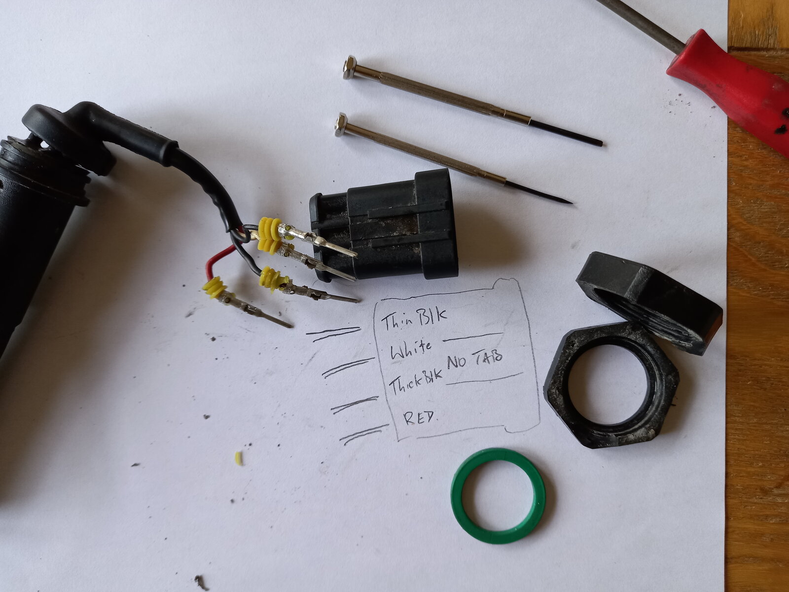

  1. Bit of a fiddle but job done ...
  2. Just ordered a new alloy nut from California Cycleworks (not in California), and a fresh viton seal - ouch, best part of a tenner for that.
  3. All fitted and bike up and running again, the hardest part was refitting the pump housing into the tank with the new O ring fitted, i could not get it to just push in by hand without the O ring popping out of the side, i ended up getting it all square and screwing some slightly longer screws into the 3 holes and carefully and evenly screwing the housing into the tank by that method and it worked, its no longer leaking ,also fitted a new fuel filter while i was at it.
  4. Thats how your meant to put the pump back in btw. :)

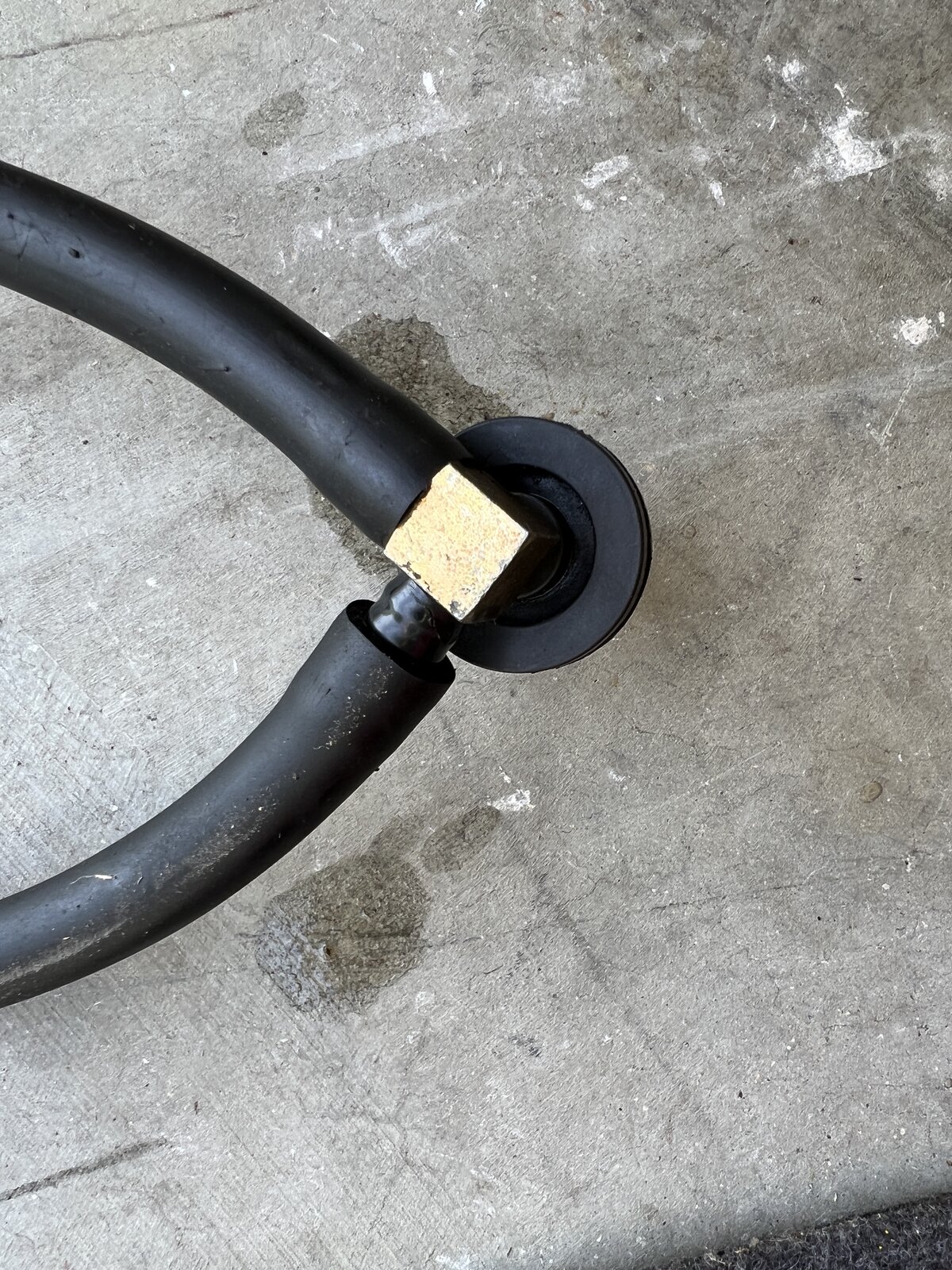

  17. I'm in the process of trying to replace the hoses that feed my 998's injectors, as one of the quick disconnect fittings literally snapped when I was removing the tank. I've got the airbox off (well, up) and I've got this guy off the bike.
    There is a soft rubber outer hose covering a hard plastic inner hose, and that plastic hose is very hard to remove. Is there a secret to getting it off, or should I just carefully cut it off? I need to get rid of the plastic hose so that I can attach the new rubber hoses to the brass union that goes up into the airbox.
    I'll be replacing the factory quick disconnects with these guys.
  18. Isn't the hard plastic part just a nozzle that the softer rubber pipe pushes onto? ..if so just pull the rubber pipe off and replace - or am i missing something?
  19. I think I might be missing something. The soft rubber hose appears to only protect the hard plastic; the soft rubber doesn’t seem to actually carry fuel.
    But the hard plastic line is on there really, really tight..
