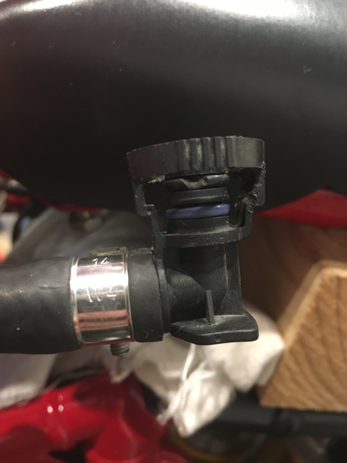

  18. Just in case it helps for anyone's future reference...
    The part number of the OEM plastic "Quick coupling union" (to fit my 04 999R) was 814.4.010.1A . They are just under £10 each from Ducati.
    The same plastic coupling looks to fit many of the Superbikes (999>1198), Monsters, Streetfighters, Multistrada, SportClassics and Hypermotards of various years.
