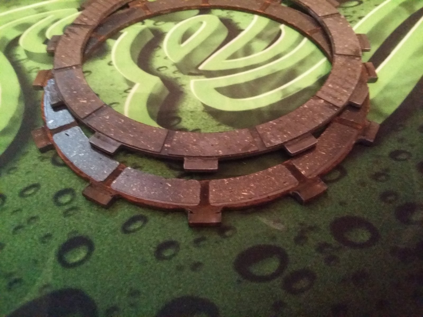

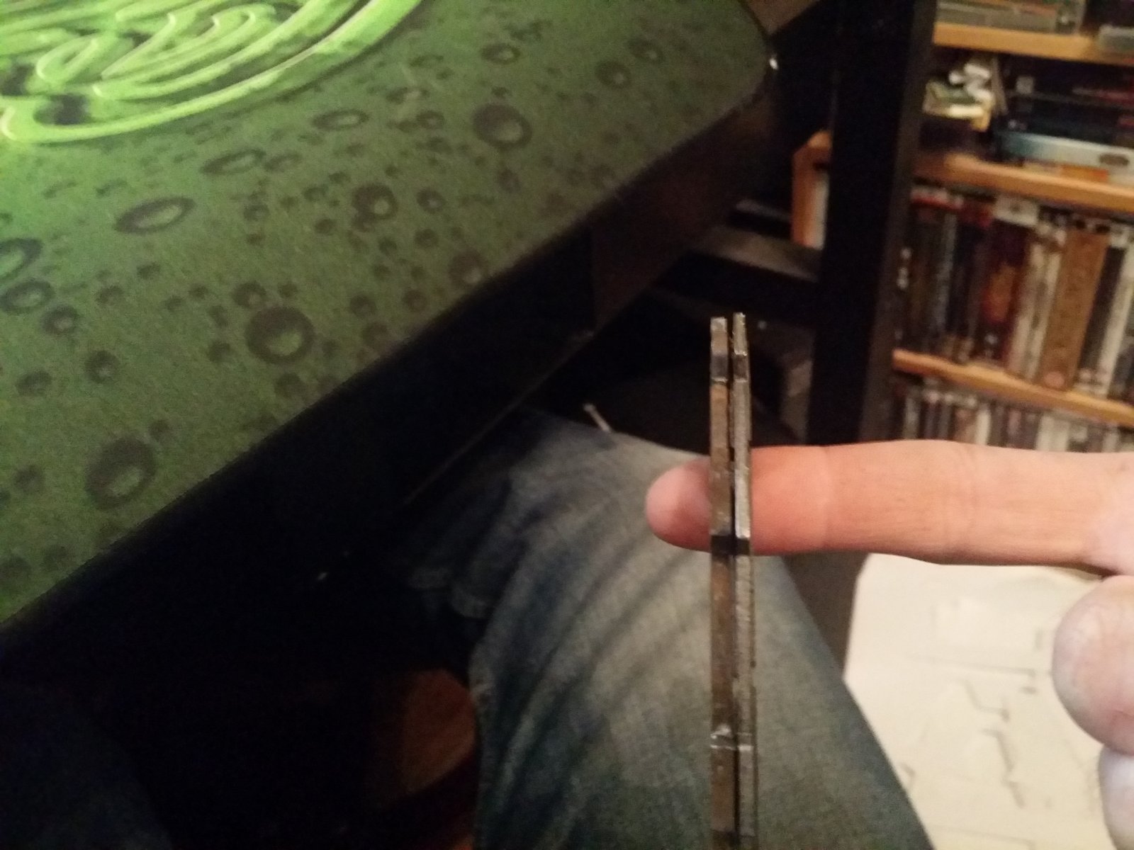

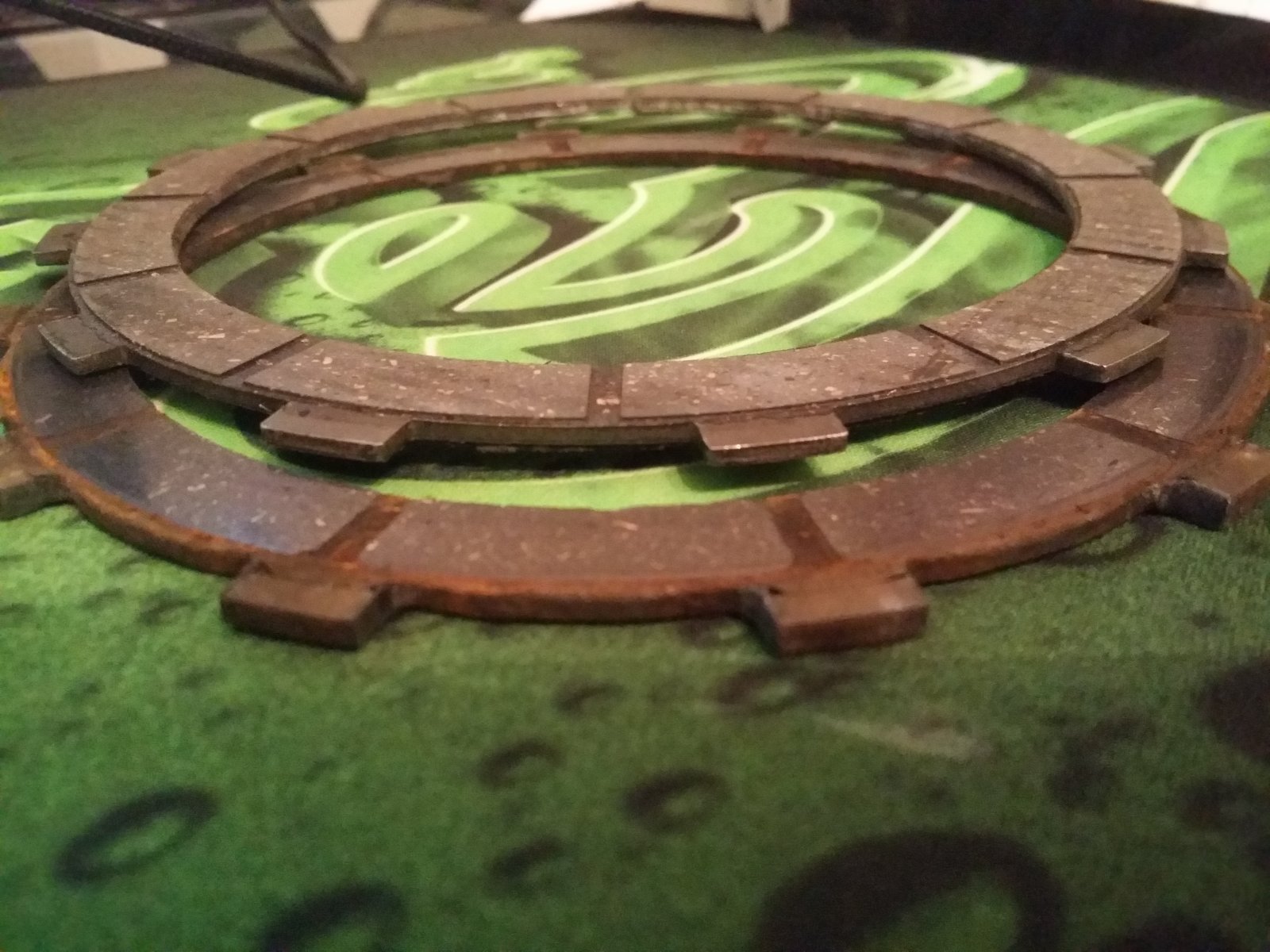

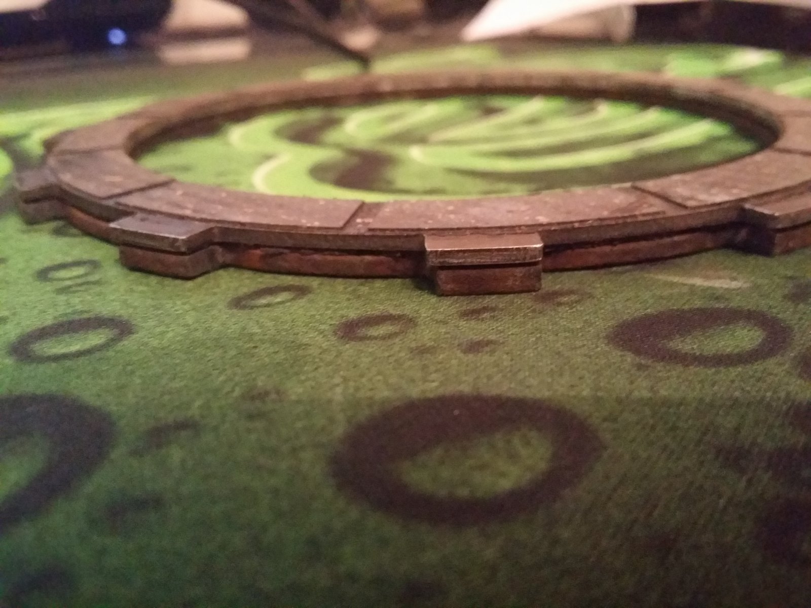

  13. @Old rider ive done your method, and it works for a few minutes, and when the engine gets hot. BAM. its draggin like a cunt again....
    here are the pics of my new plates vs Old plates, as you can see the old ones has a thicker notch, but a smaller one in length...

  17. I think he has the same issue I had, which is slightly oversize pattern plate tangs binding in the slots. As they bind, the clutch drags more and heats up, so the problem suddenly gets a lot worse.
    I've completely cured my problem by putting some old plates at the top of the stack, so the clutch can clear.
    It works so well that at rest, I can now easily engage neutral by tapping down from second.
