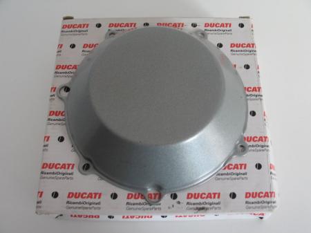

  13. Quiet you say you need to start with one of these ;)
  14. Got one of those, don't like it.
    As it is now, it's nice and jangly with lever in, nice and quiet, lever out and no longer plain-Jane - luvverly :)

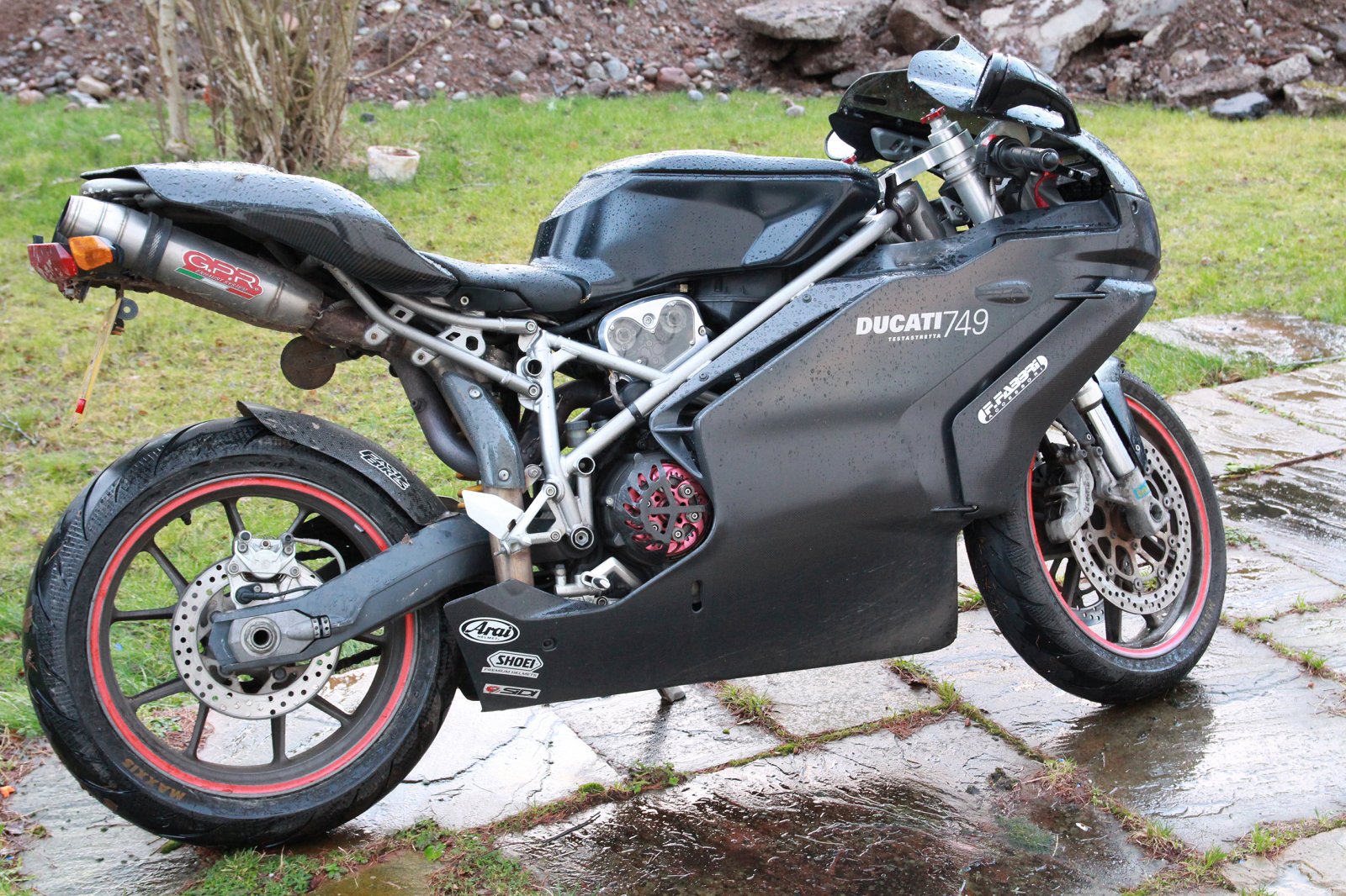

  15. this isnt how i actually ride my bike... i was in the middle of adjusting the clutch and it wasnt quite right yet, so i never installed the fairings and the open carbon clutch cover that i normally use. i knew he couldn't fail me on the clutch nor the fairings, so i took it like that...
    this, is how my bike normally looks.
