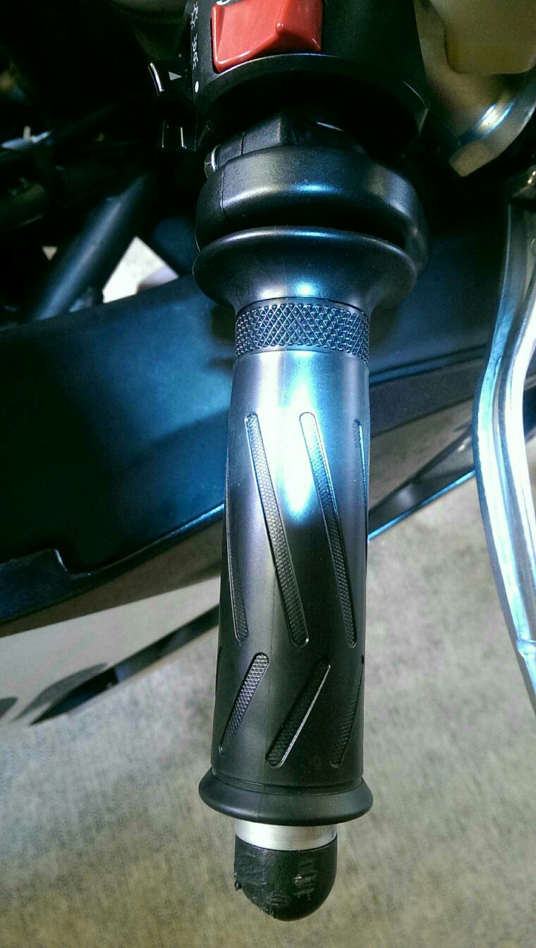

  9. All done, did you guys find it came up a little short?
  10. Mine fitted dead on. If the exposed metal in the pic is the end of the clip on (not the throttle tube) can you not just loosen the clamp bolts and nudge things along a bit.
  11. Oh and new bar ends would be nice:grinning:
  12. No, the throttle housing has a bump that fits in a hole in the clip on. It is the clip on sticking out.

    As seen, bit short so will cover with black tape I think. Or maybe hacksaw time........ Or maybe some fancy CF clip ons......
  15. Yes, they come up short. I went the black tape route.
  16. Black tape done and looking much better.

  18. I fitted the black grips that have shaped slits exposing a red layer beneath, which I reckon look great on a red bike. No length issues with those
    I also have the smaller Oberon Streetfighter bar end mirror in black on the right side.
    It sits over my little finger. It's neat, discreet, beautifully made, fills in the blind spot immediately behind perfectly and is highly recommended.
