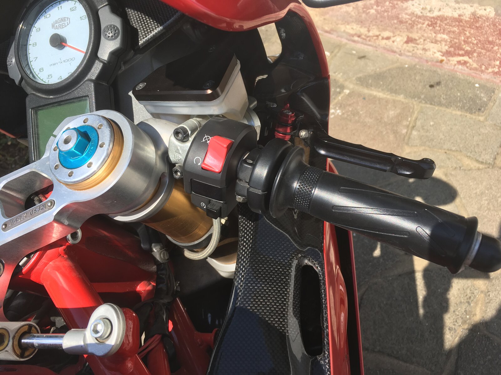

  3. IMG_1223.JPG Finally put me tube on this morning and it does feel a bit smoother.
    Whether it improves my riding skills ?
    Probably not!

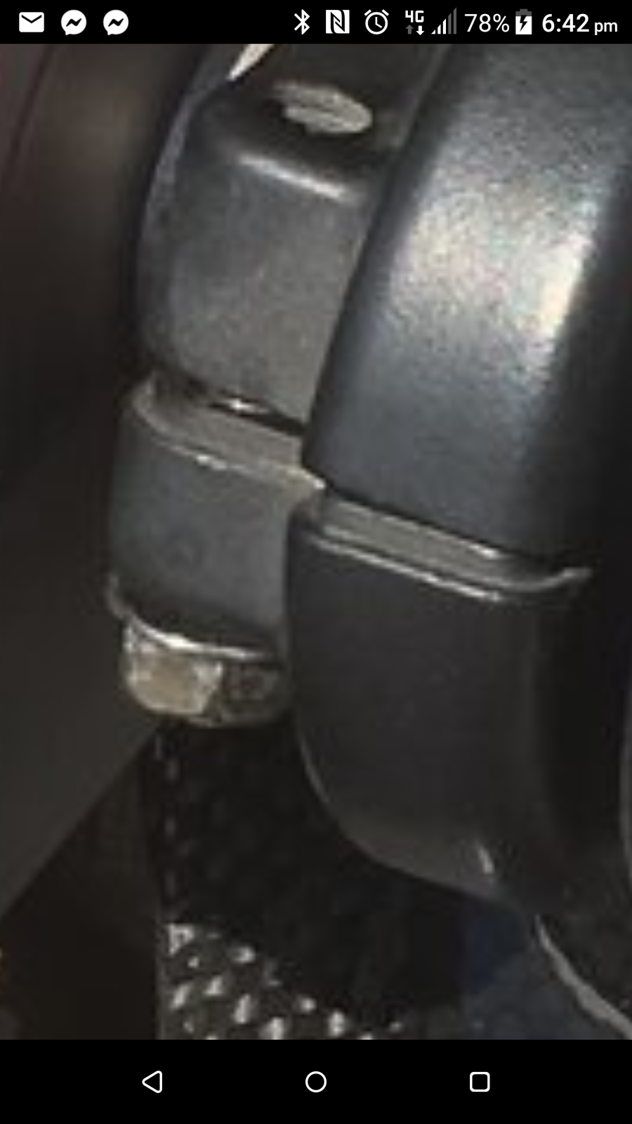

  4. Twist doesn't seem to trigger back as well as it did. A bit sticky. Has anyone else had this issue ?
  5. Your picture looks like the casing around the cable cam is not seated properly. I had no issues on a 999 and 1198 with binding.
  6. :confused:I can't see what I've done wrong
  8. :upyeah:Thank you
  9. Will be sorting this in the morning and putting my new exact start cables on :bucktooth:
  10. Is that not just the pin not seated in the hole in the bar?
  11. The locator pin is on the switch unit. No need to touch that when doing the mod.
