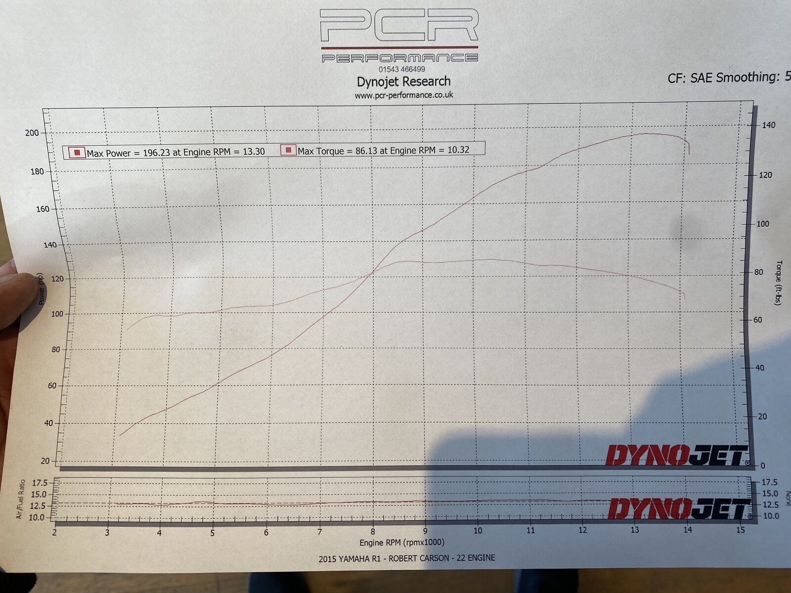

    • Useful Useful x 2

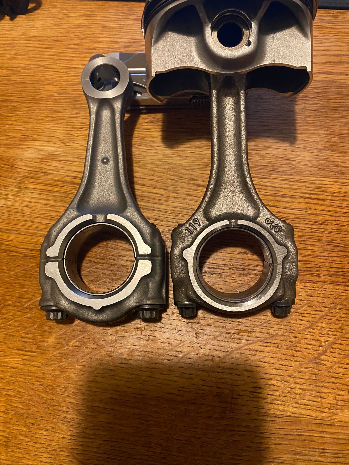

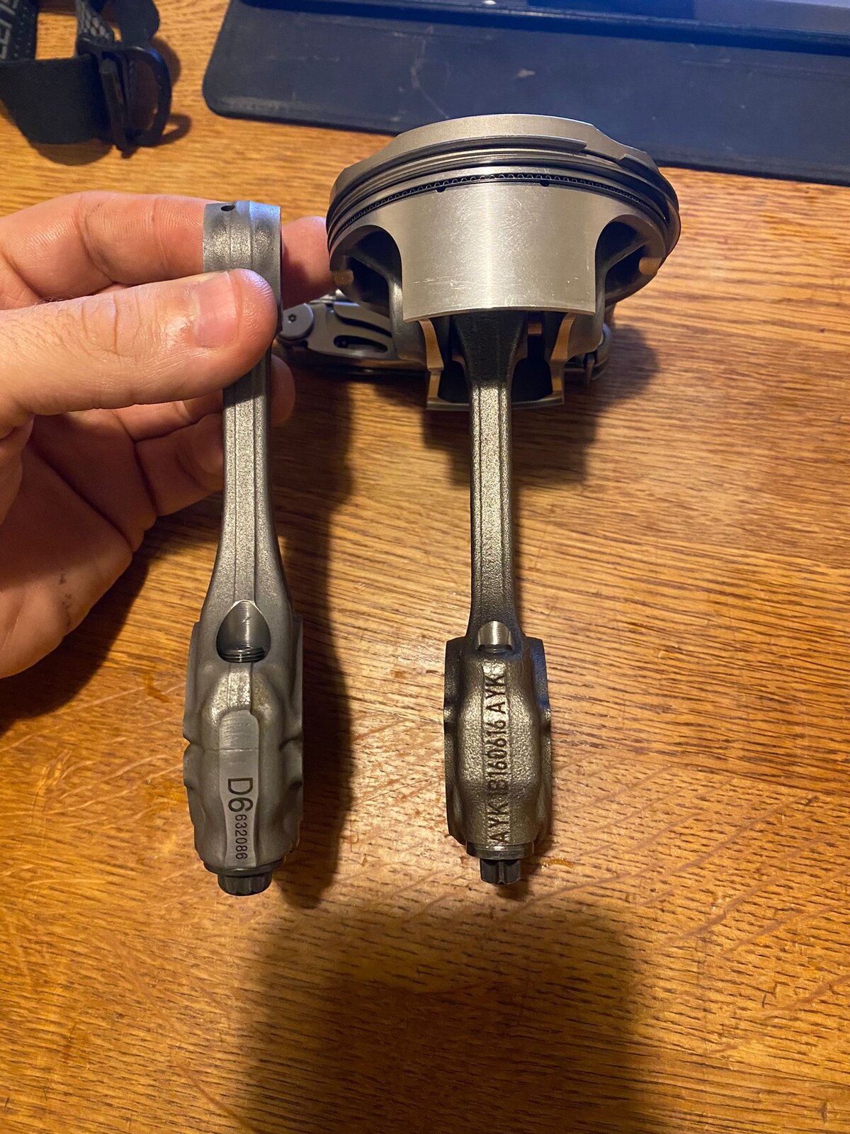

  12. A mate was doing some comparisons as he’s building a s1000rr engine, the r1 Conrods are pretty chunky but titanium, s1000rr much smaller but still 40g heavier

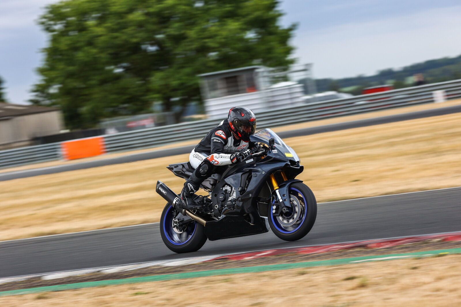

    Anyway.. here’s mine on a good day…

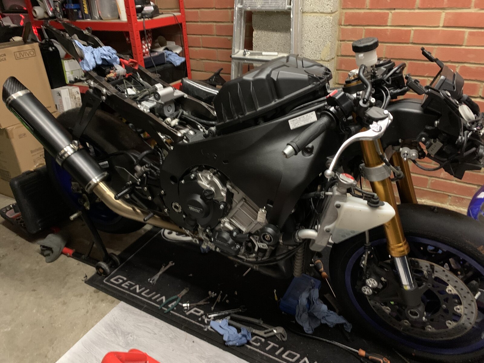

    And currently in bits!

  16. I had my bike run in on the dyno and some other bits and pieces done, plus I already had it mapped by PCR last year which meant I didn't have to fork out for another map key. You'd be better to call them mate and ask for an individual quote

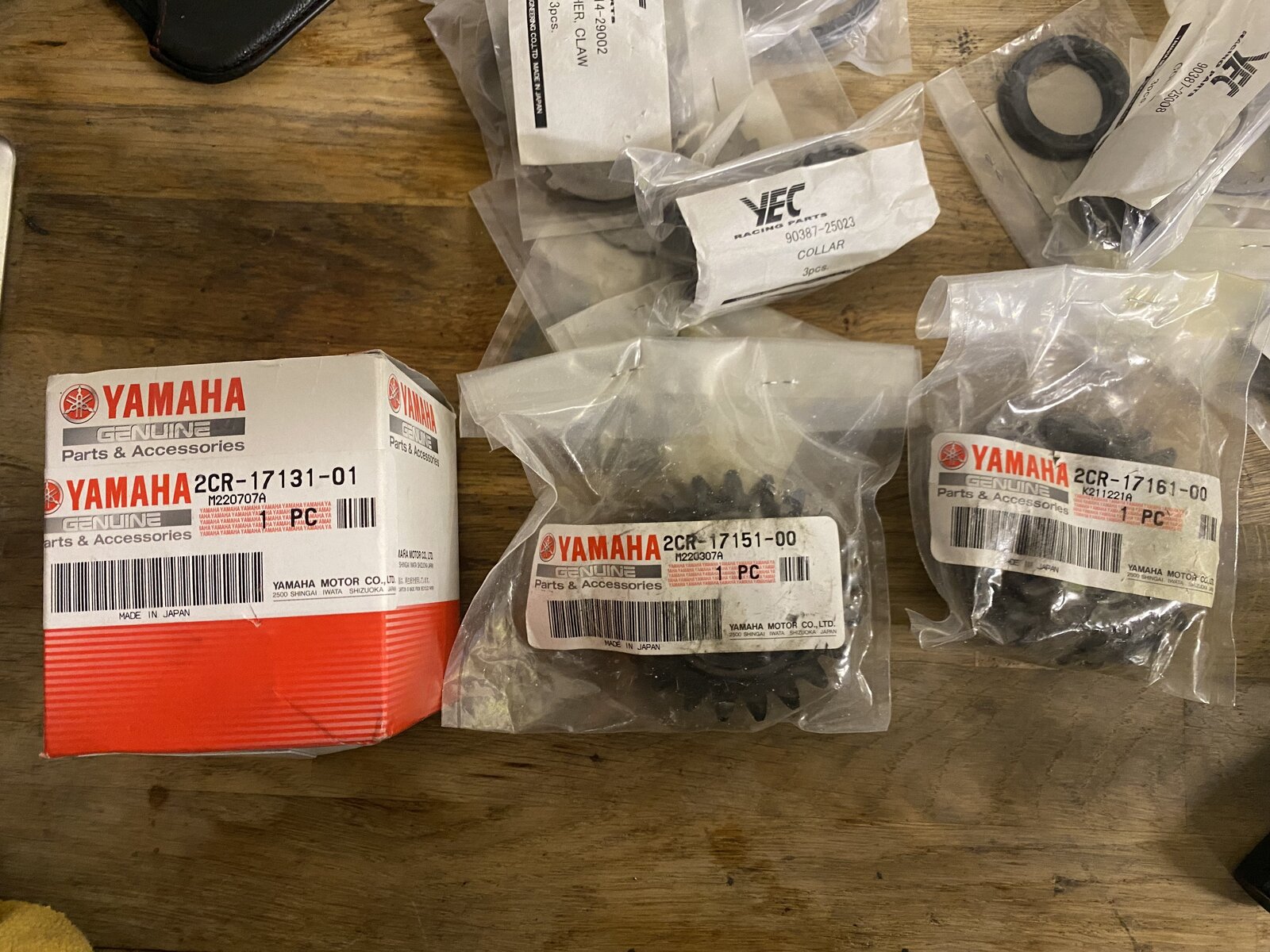

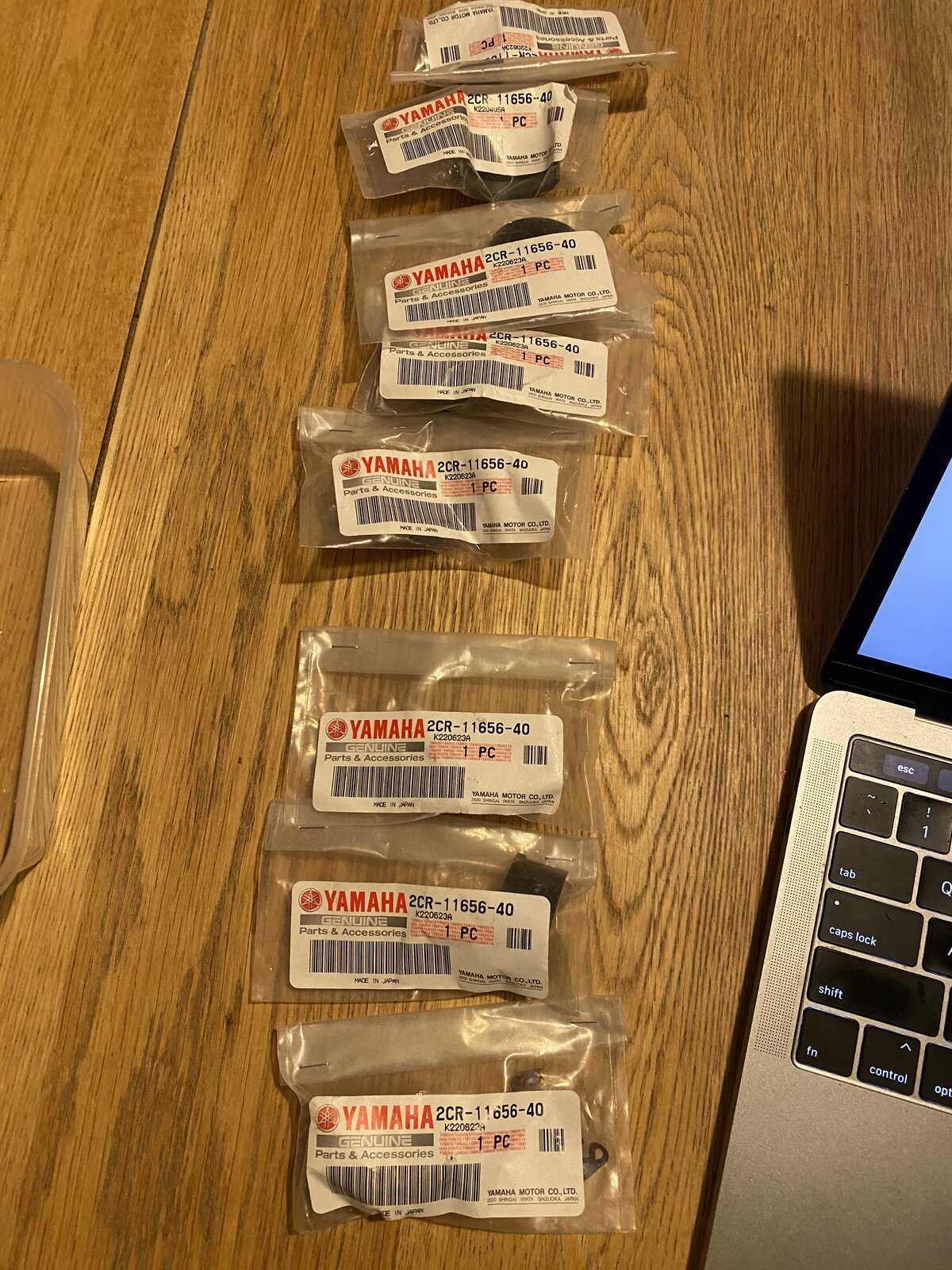

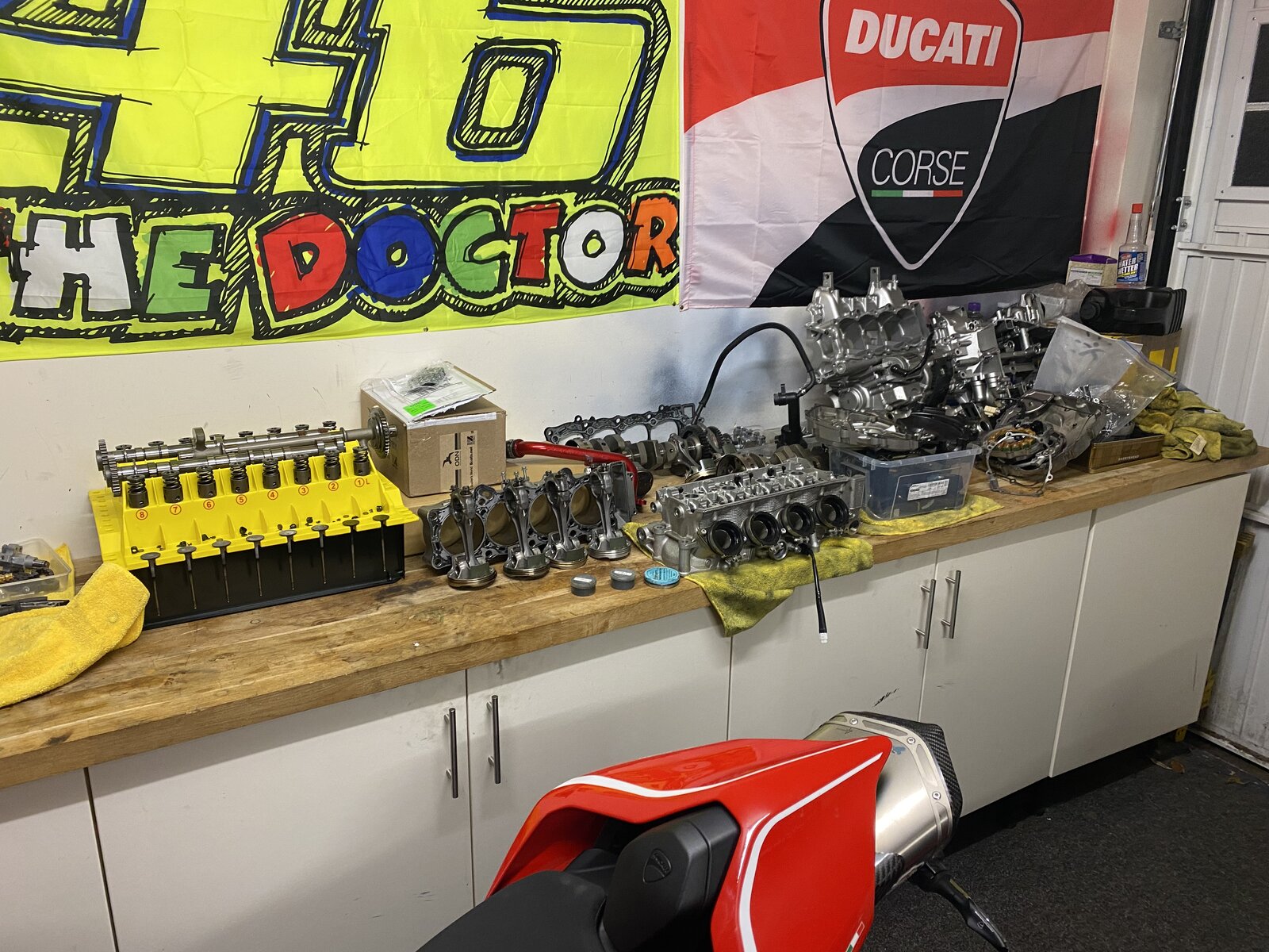

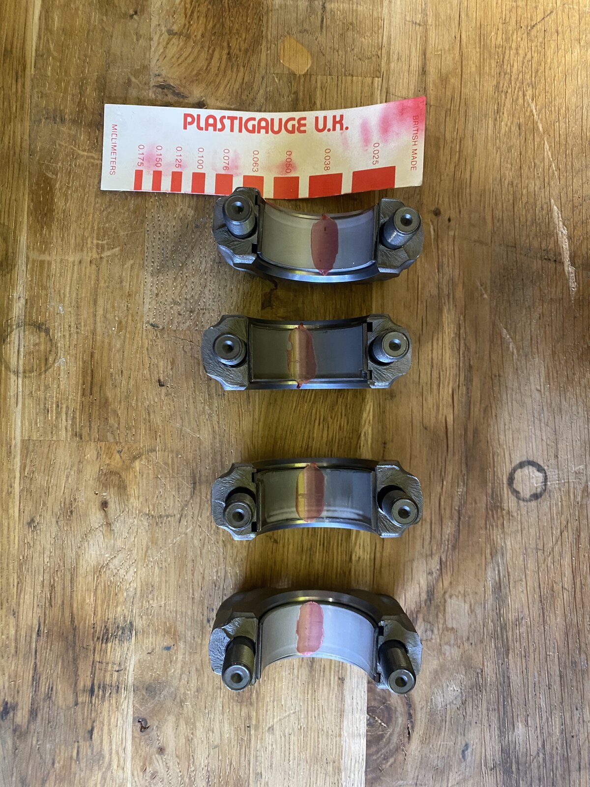

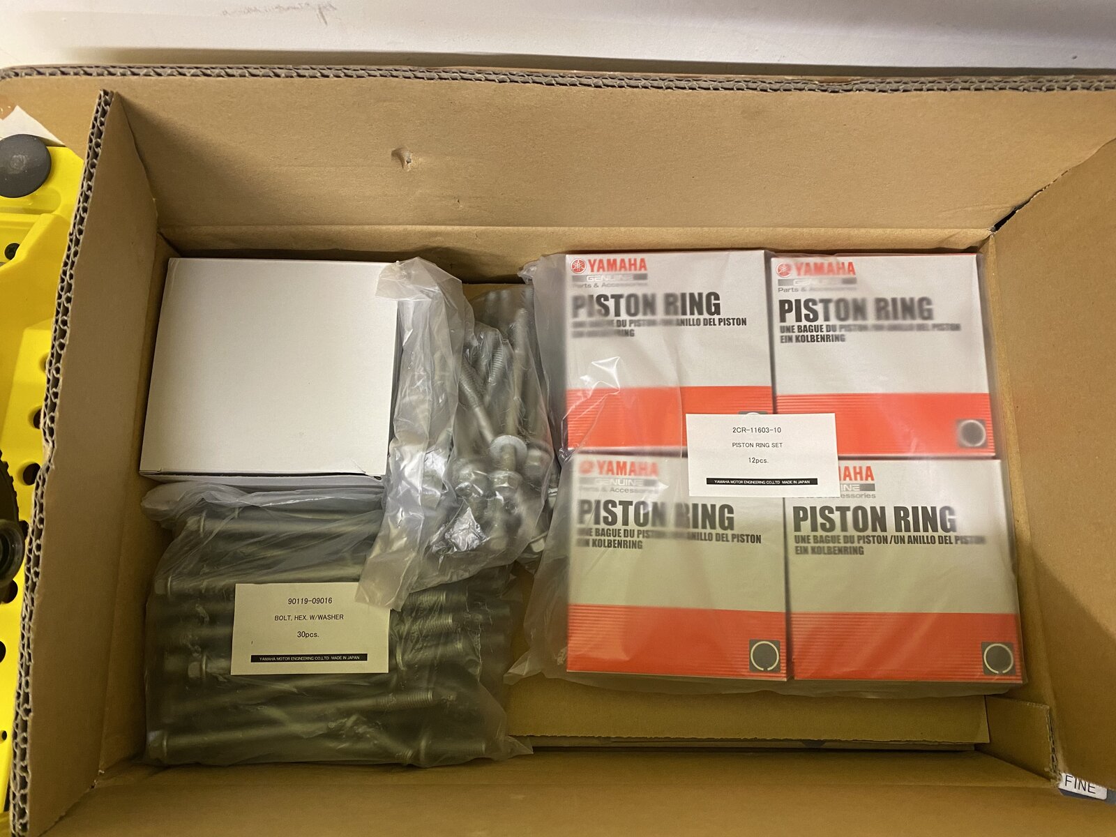

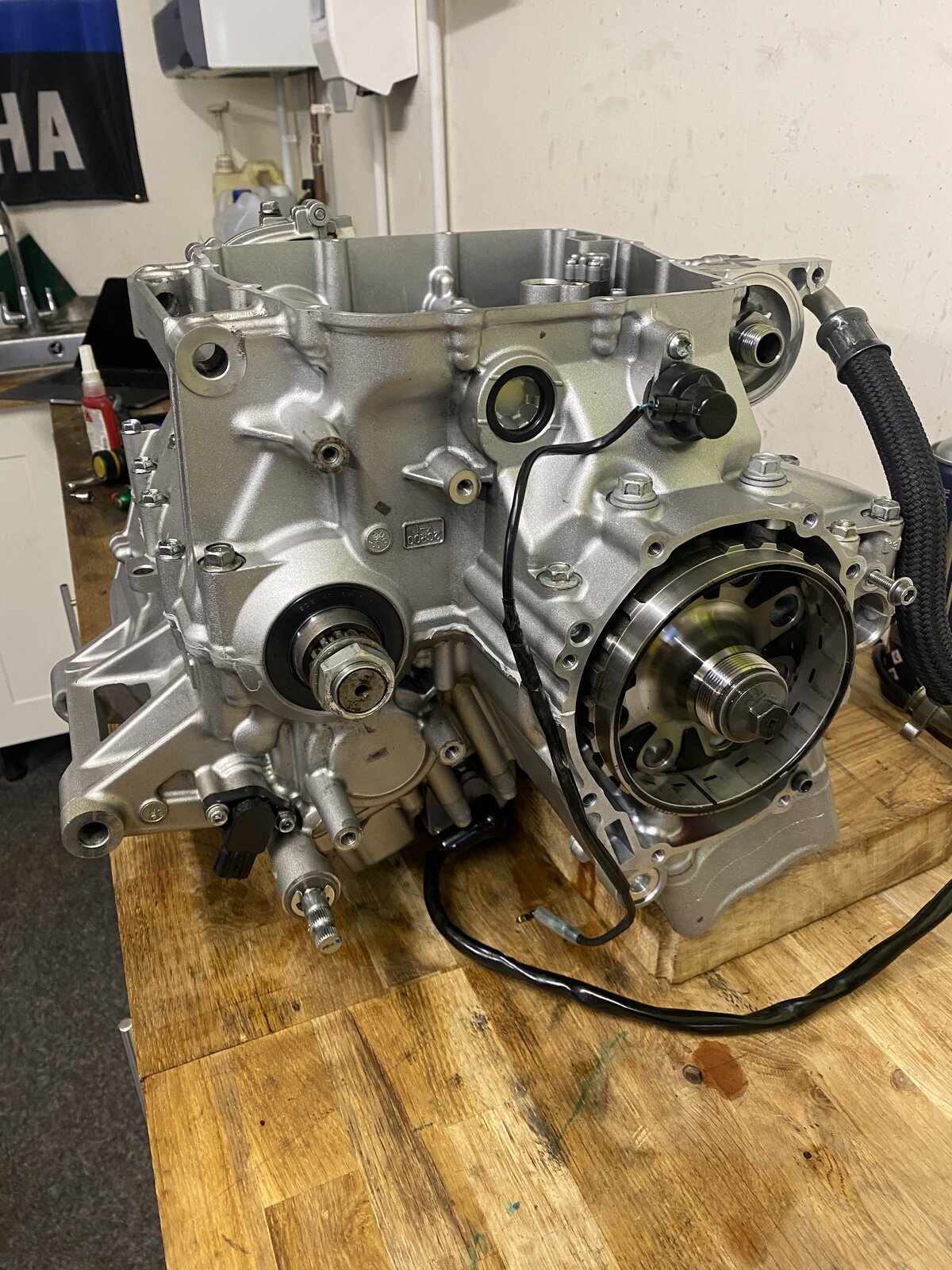

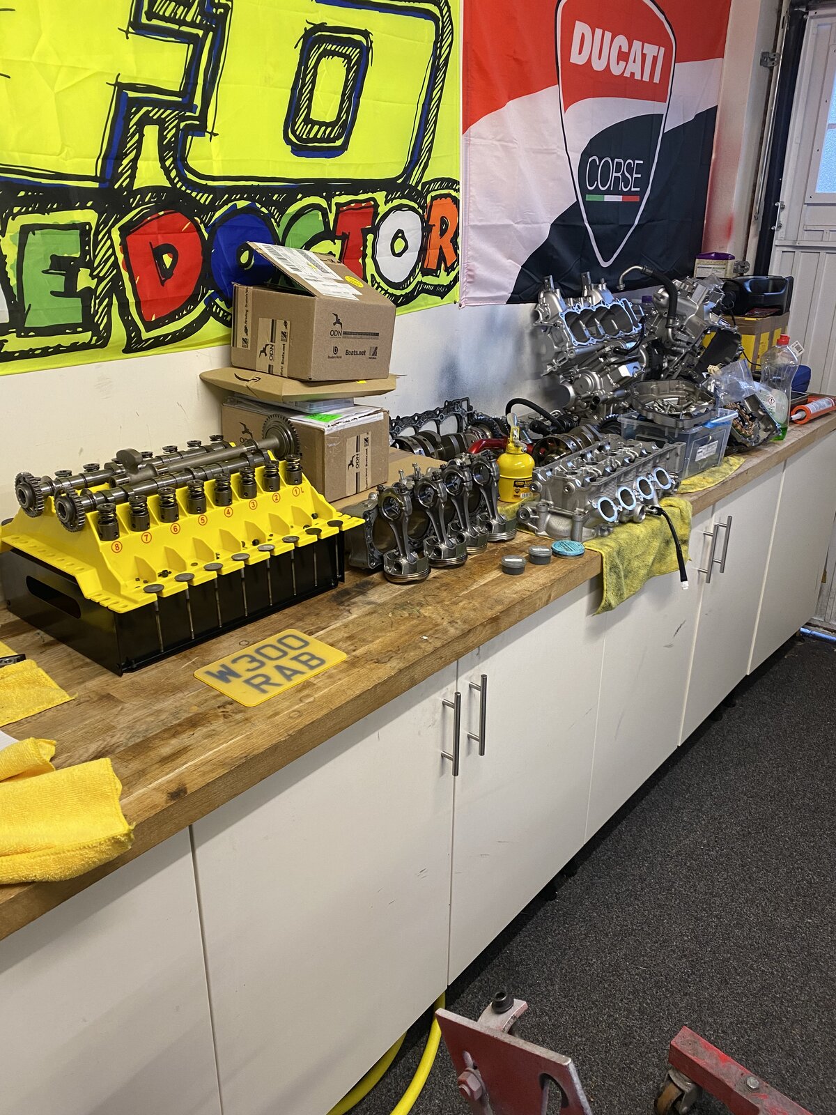

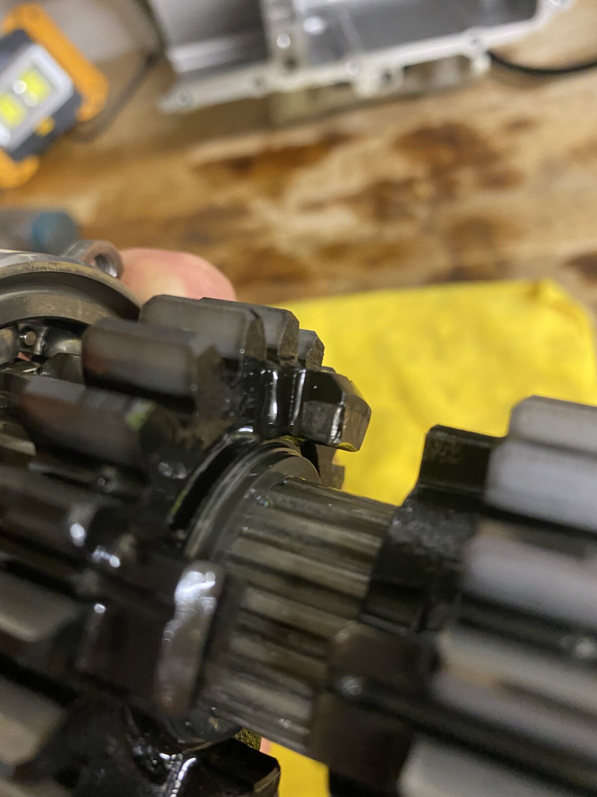

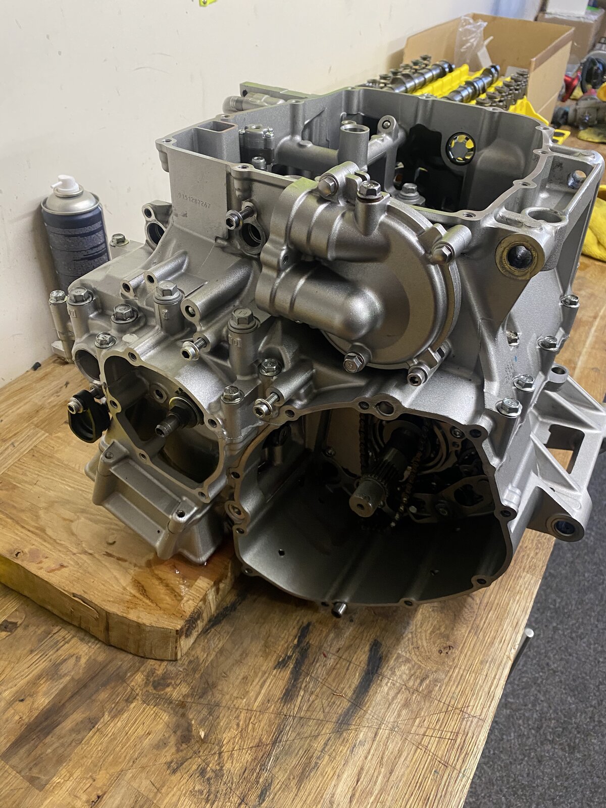

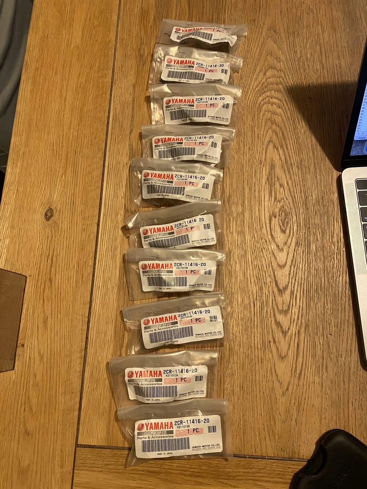

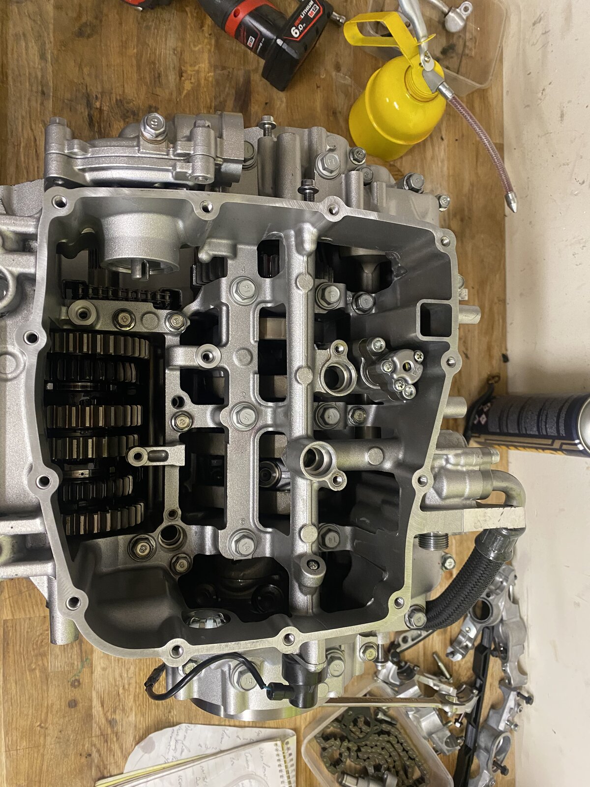

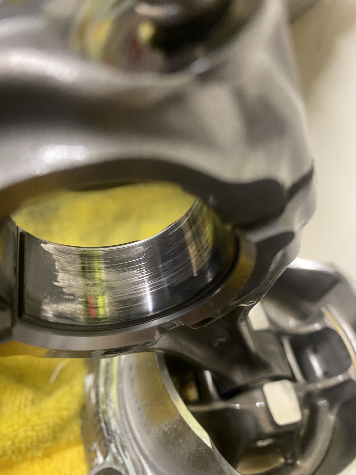

  17. I've been round the R1s since I got my bike license in 2002 and had about 9 or 10 of them in various guises. For sure there are loads of engine failures on the 15-19 bikes (hopefully sorted with the 2020 engines) but almost all of them have been track/race bikes that have all went past refresh intervals or had aggressive maps/improper tuning.
    You'll very rarely see a road going 15 on R1 fail that's been maintained properly and that goes for race/track bikes if they're refreshed in time which is eye wateringly early and expensive should it all go wrong.

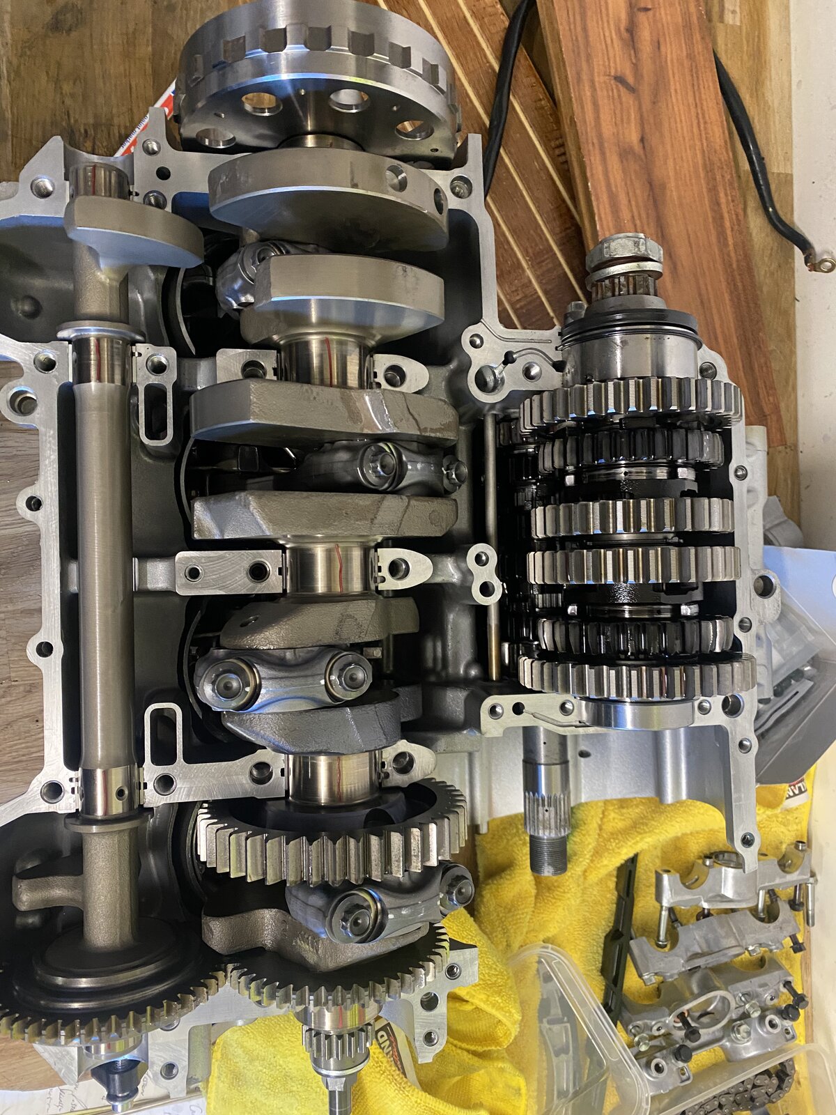

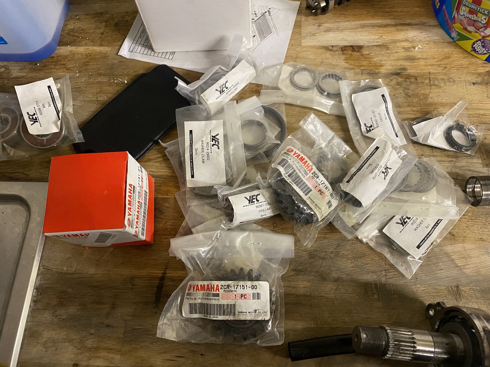

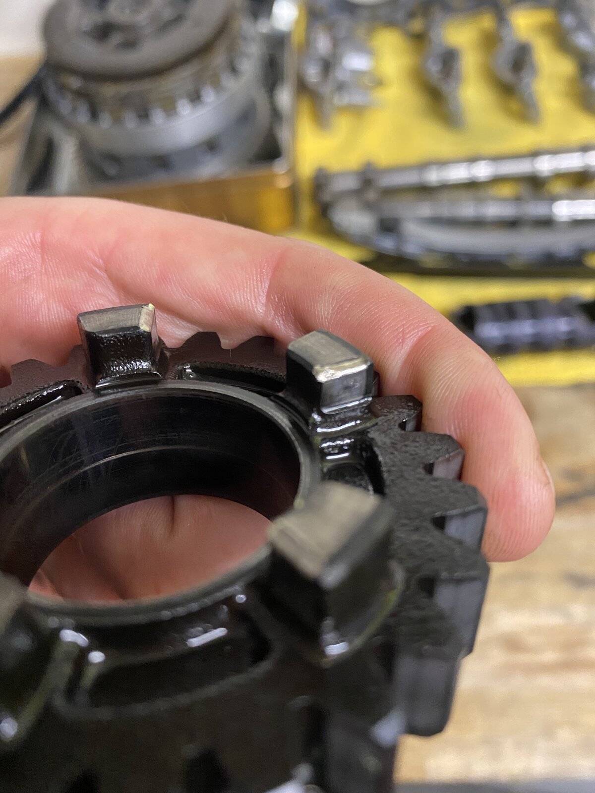

    Just rebuilding the engine for my 2nd bike now:
    IMG_3774.jpeg IMG_3773.jpeg IMG_3772.jpeg IMG_3764.jpeg IMG_3758.jpeg IMG_3698.jpeg IMG_3697.jpeg IMG_3702.jpeg IMG_3684.jpeg IMG_3683.jpeg IMG_3678.jpeg IMG_2122.jpeg IMG_1323.jpeg IMG_1325.jpeg IMG_1219.jpeg
