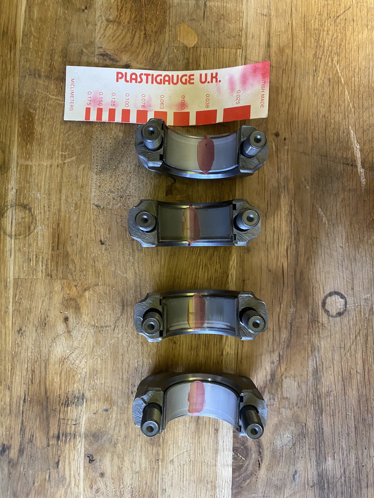

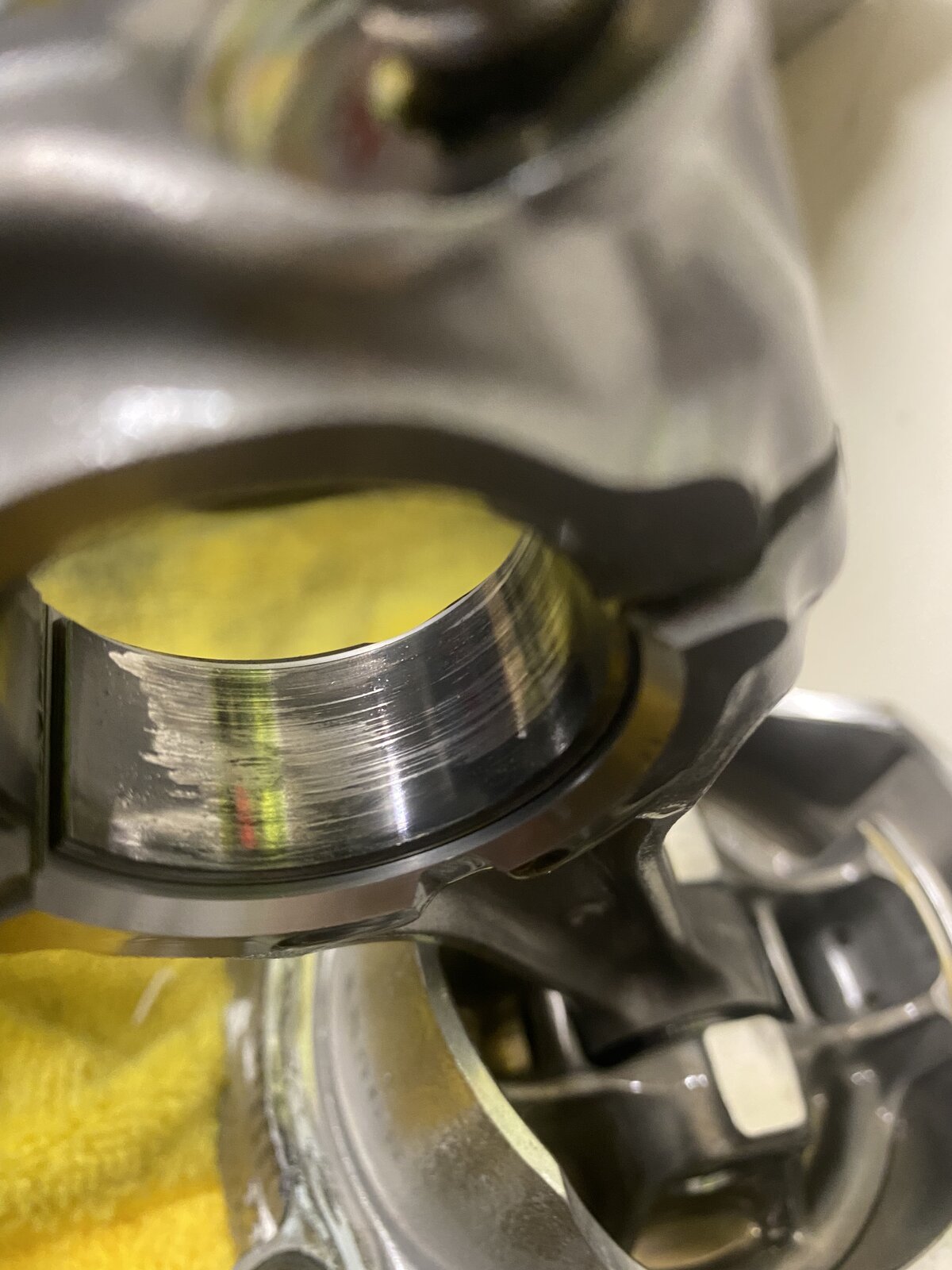

    What I found strange on my bike was that the main bearings were worn on the outer edges and if you look at the width of the 2020 onwards mains, you'll see that they're wider than the earlier bearings. Very strange for a plain bearing like that to wear on the outer edges. I've heard that it's possible to install the new wider bearings on the earlier engines.
    I believe that if they're refreshed within a proper time frame they're as reliable as anything else.

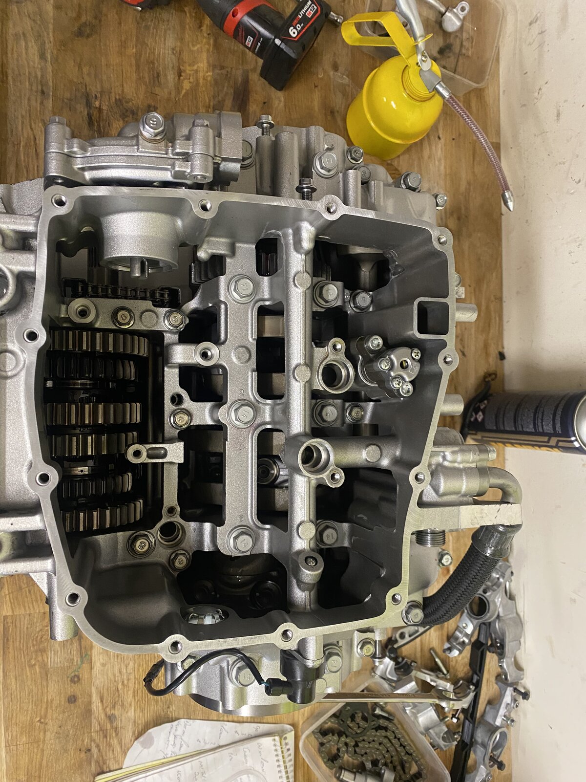

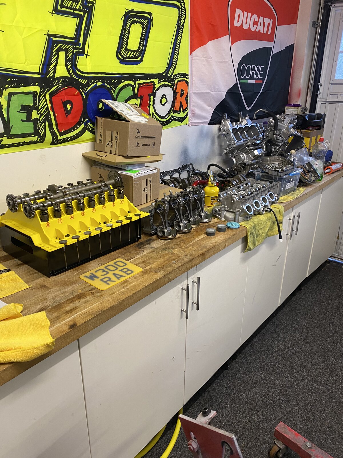

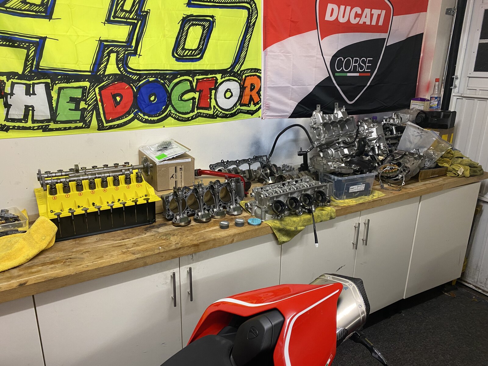

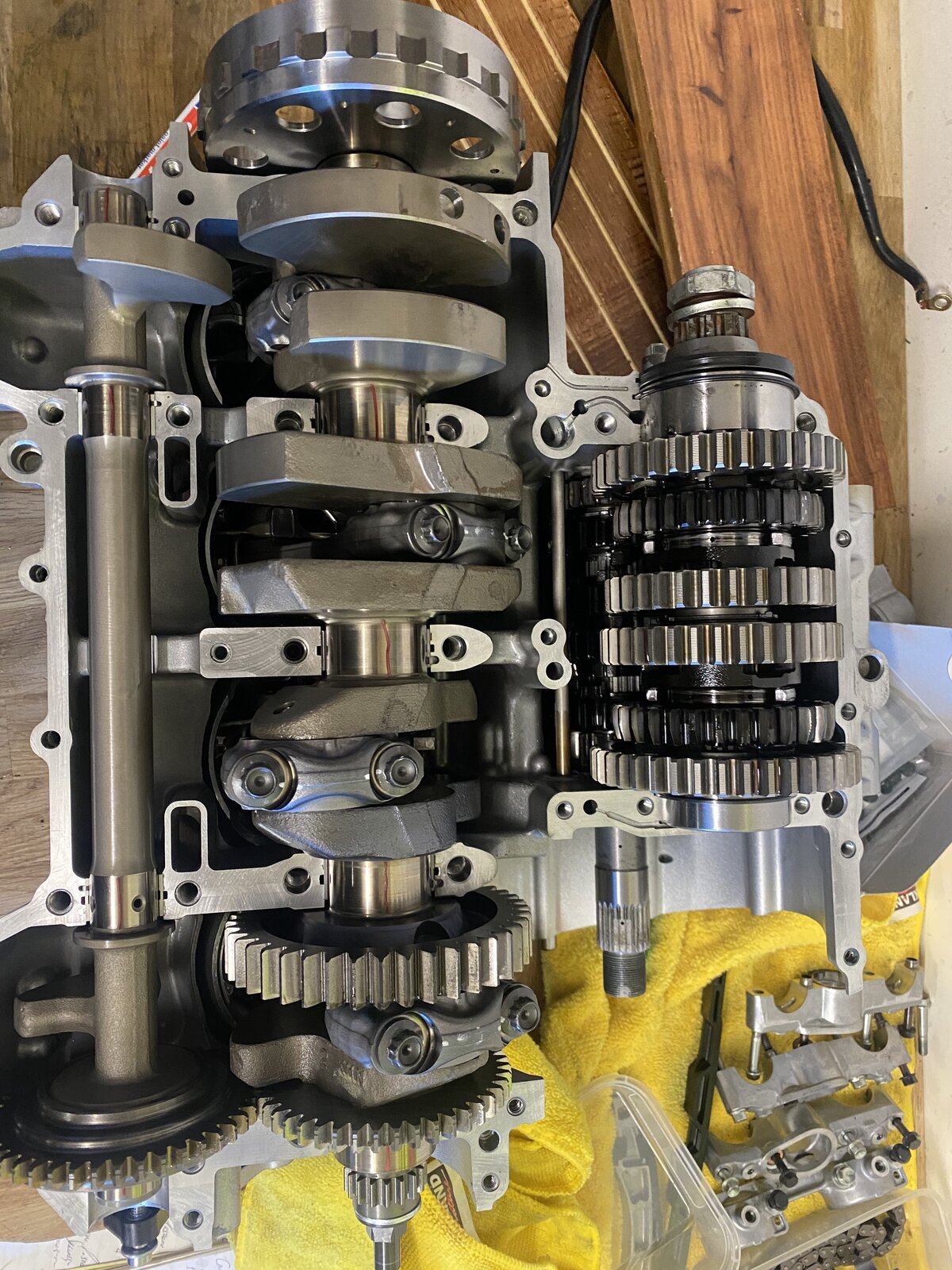

  5. Are you doing that all yourself on your own engine?????
  6. Yes mate
  7. Very impressed here.
