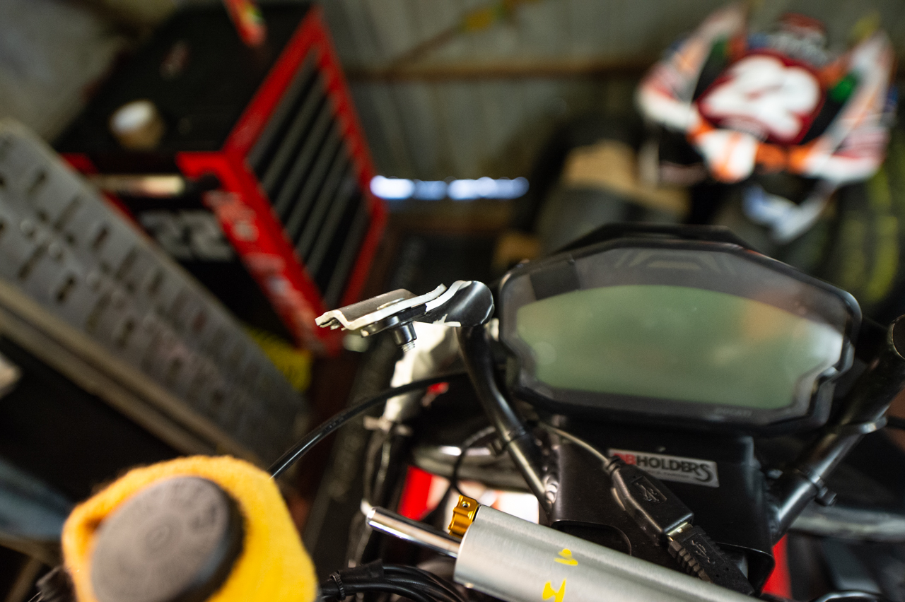

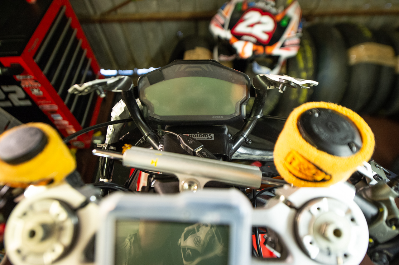

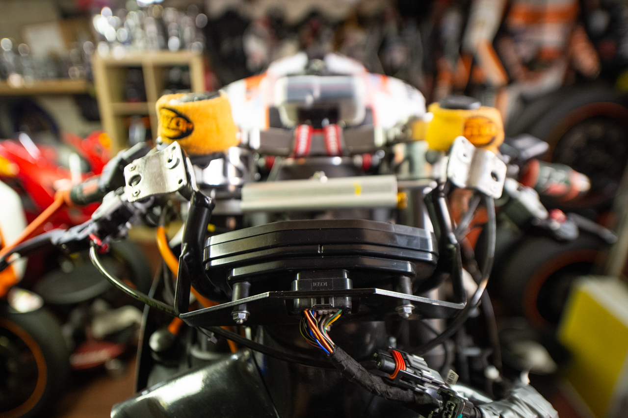

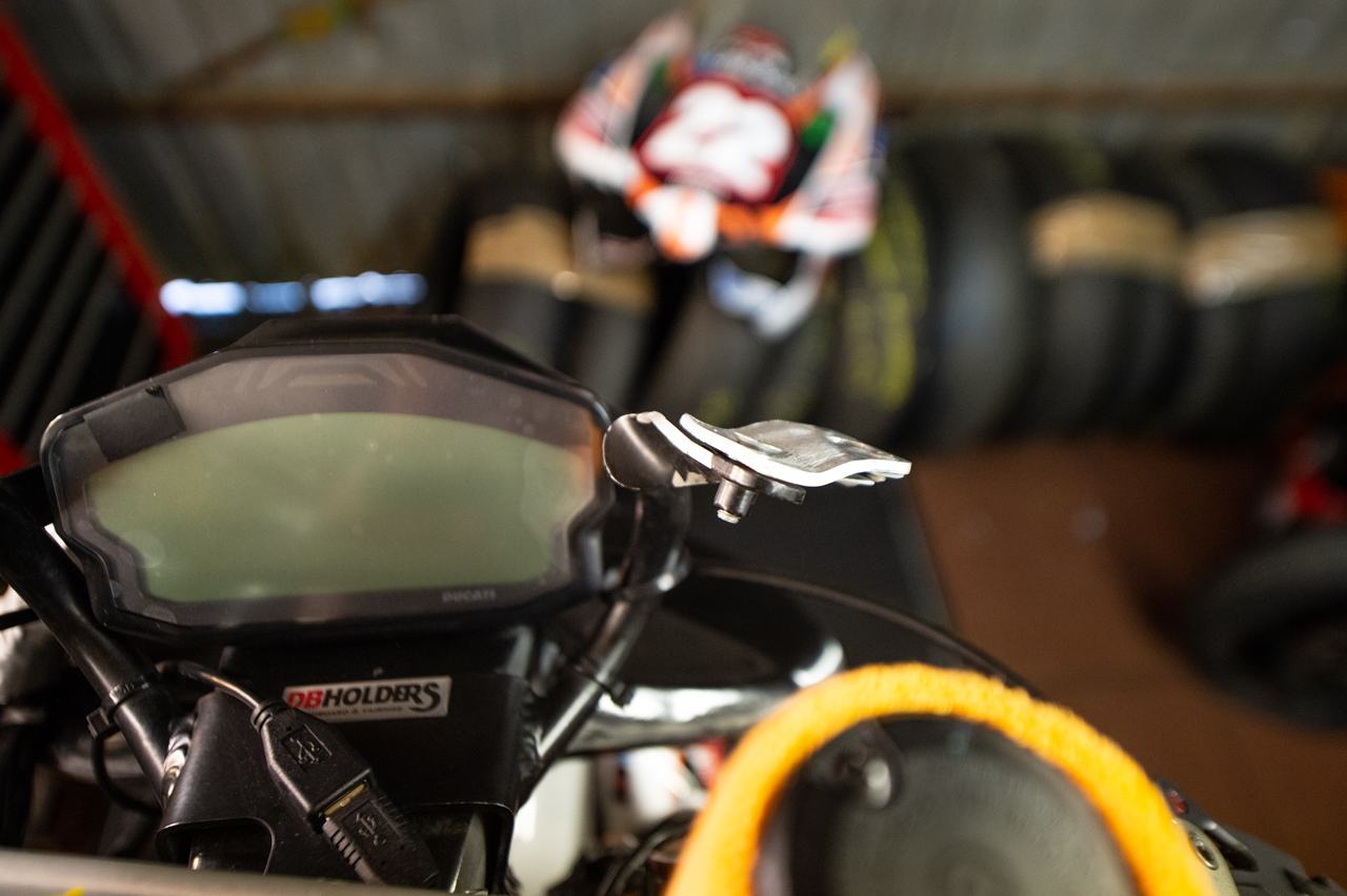

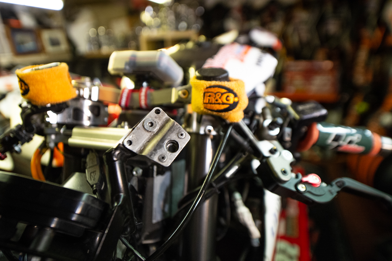

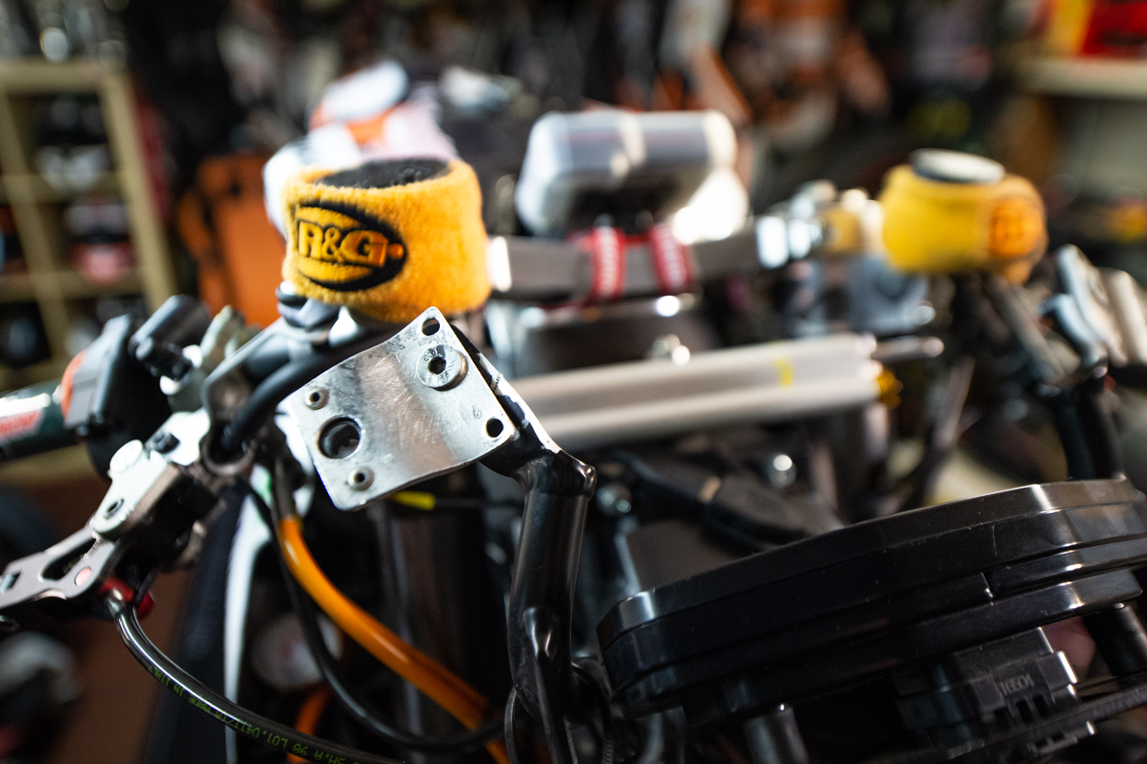

  1. 20191011-_DJM3032.jpg 20191011-_DJM3033.jpg 20191011-_DJM3034.jpg 20191011-_DJM3035.jpg 20191011-_DJM3036.jpg 20191011-_DJM3037.jpg There you go mate, few pics of the DB holders kit in situ. You can see where the paint has come off because I have manipulated it slightly to fit. If you choose not to use the brackets for dzus fasteners then you may not have to bend it. You will have to use a threaded fastener though which will slow down removal. You can see in the video I removed the nose cone with one hand as I was holding the camera. The air duct slots in and out but I have held it in place with cable ties to stop it falling away when the nose cone comes off.
