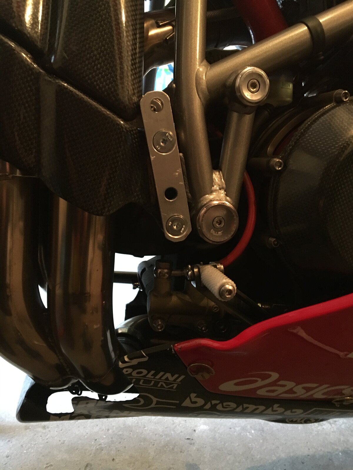

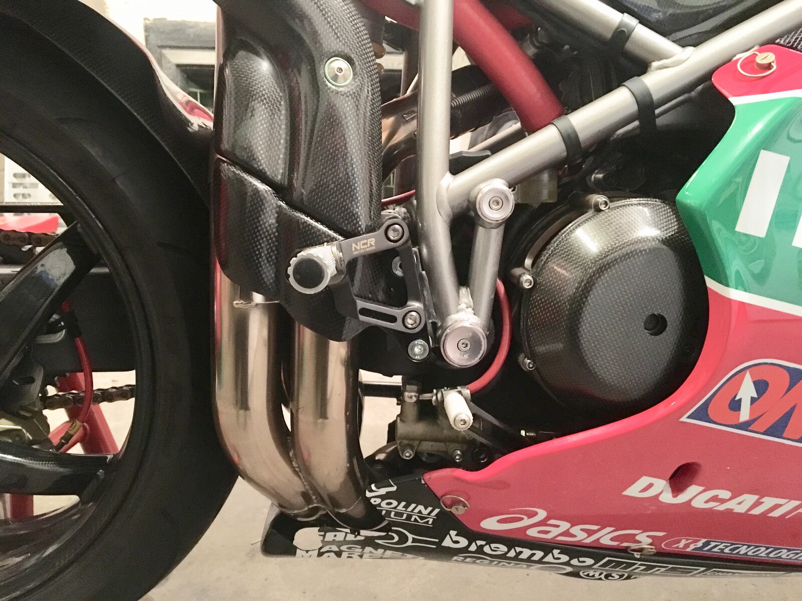

  1. Yes, it's close but doesn't touch.
  2. Had a moment on the last ride out where coming off a roundabout, I went from 2nd to 1st instead or 3rd. Back wheel spun up a bit but not uncontrollably. Woke me up though.
    That’s the problem I had too @cookster, to get comfortable, I had to have the gear change pedal on the lowest position possible with it just missing the fairing. Been dicking about with frame plates to lift the rearsets 25mm. Feels better and no more cramped when they were fixed in the std height position. I can change gear a lot easier and don’t need to move my foot around as much.
    Going for a ride out over the weekend so i’ll have a better idea then.
    A4CE584A-3B24-475E-BA0E-542E31CE70B2.jpeg 4BA7C12F-7BA5-49A9-B100-972643EAC31B.jpeg
