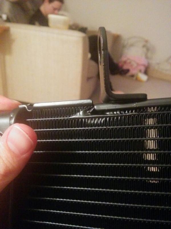

  6. It is for the reg/rec. Should have been done in 2008..... Pick my rad up from northern radiators in leeds this Friday so will sling a pic up of the repair. Cost a whole £40 + vat! Got poo poo'd of by ducati, we'll fooked off with them!
    there ya go. Repaired for a whole £48... northern radiators in leeds, very honest good bunch and can highly recommend them! Main dealer can stick it!
  8. All this happened to me October last year... Not good, but a call to my dealer Ducati Wolverhampton & two weeks later they gave me a new one that I exchanged & fitted myself... Bearing in mind this is a 2008 bike I was amazed at how quick they said yes & ordered me the rad..... Cant hurt to moan at HQ in the hope they force the dealer into action... Its a known fault ffs
  9. I have moaned....wanted to de exactly the same as you. Ducati uk suggested I get it to leeds (75 miles) for an inspection to "see" if there was anything they could do... as I couldn't ride the bike it would have cost me more in van hire/fuel in the end for an inspection with a possible fob off and have to collect it again. They point blank refused to help me with getting it there and wouldn't accept just the rad as they wanted the whole bike. Think they just wanted to make it as out of reach as possible. Just got on and repaired it, by far the better option price wise in the long run.
