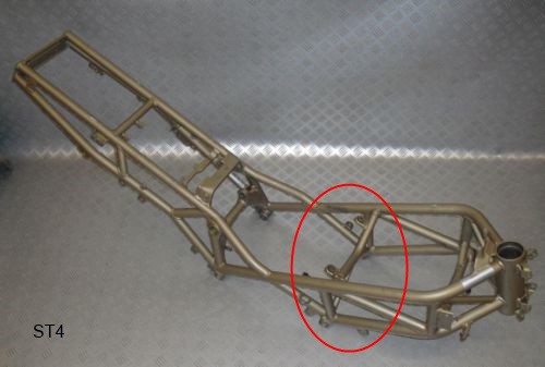

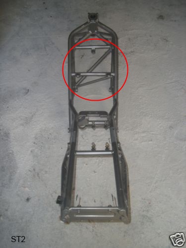

  4. A picture paints a thousand words...
    The ST2 (and all other 2v variants of the ST and 2nd gen Monster) has a diagonal brace across the bottom tubes, a single brace across the top tubes and another diagonal from top to bottom.
    The ST4 (and all other 4v variants of the ST and 2nd gen Monster) has a single X-shaped brace that served the top and bottom tubes, no diagonal brace.
    This doesn't affect bolting the engine in but 2v throttle bodies foul the 4v bracing and vice-versa. It always annoys me when I see an ST2 frame on eBay with "will also fit ST4"... It just won't!

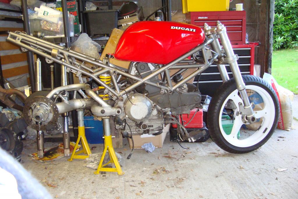

    Here's something I mocked up a while back: ST4 frame, linkage and shock, S4R swingarm, 900SS motor.
    Notice that there's no inlet on the vertical cylinder because the frame-bracing is in the way. If I'd gone any further with this then (as I've already said) I'd have had to modify the frame bracing so the carbs/TBs would fit. If you use an ST2 frame then you won't have this problem.

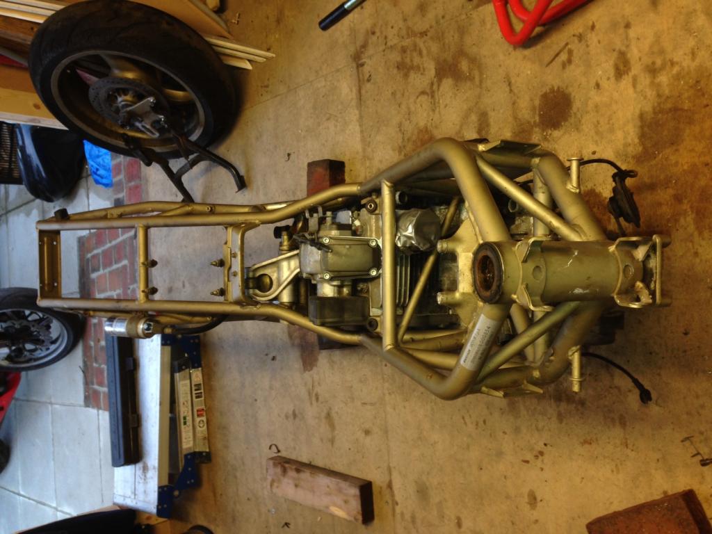

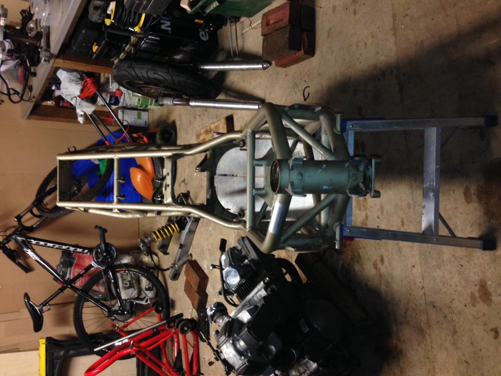

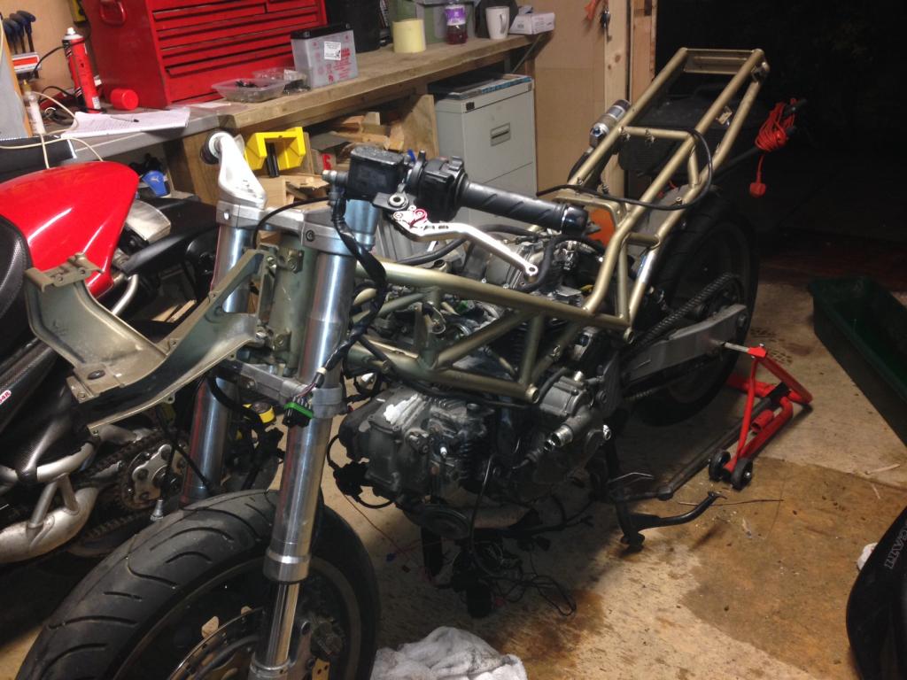

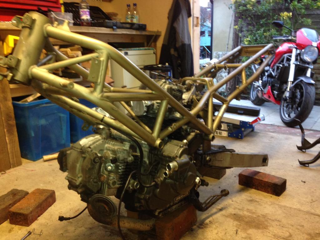

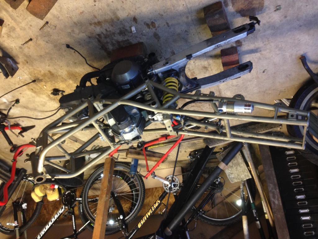

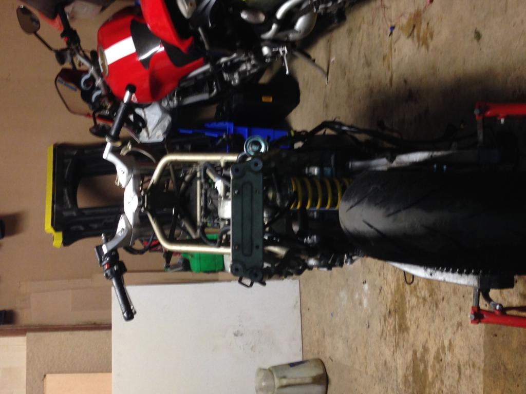

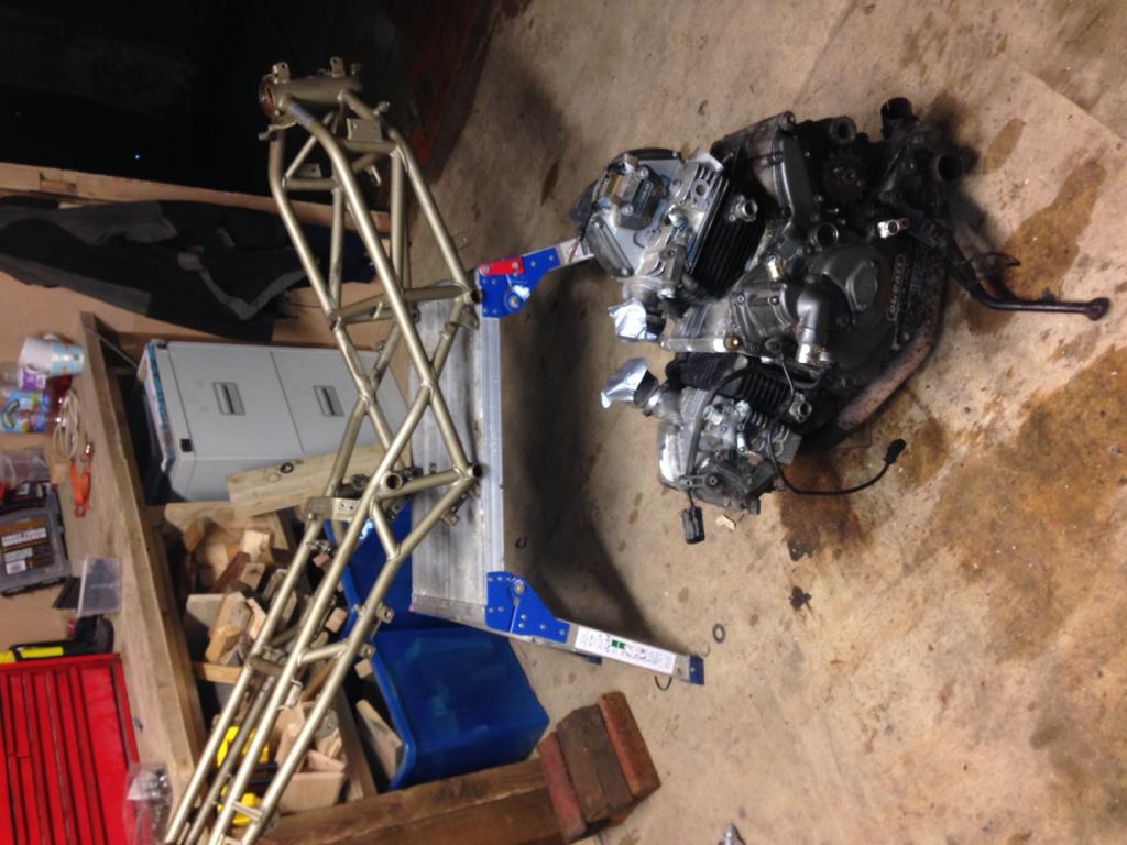

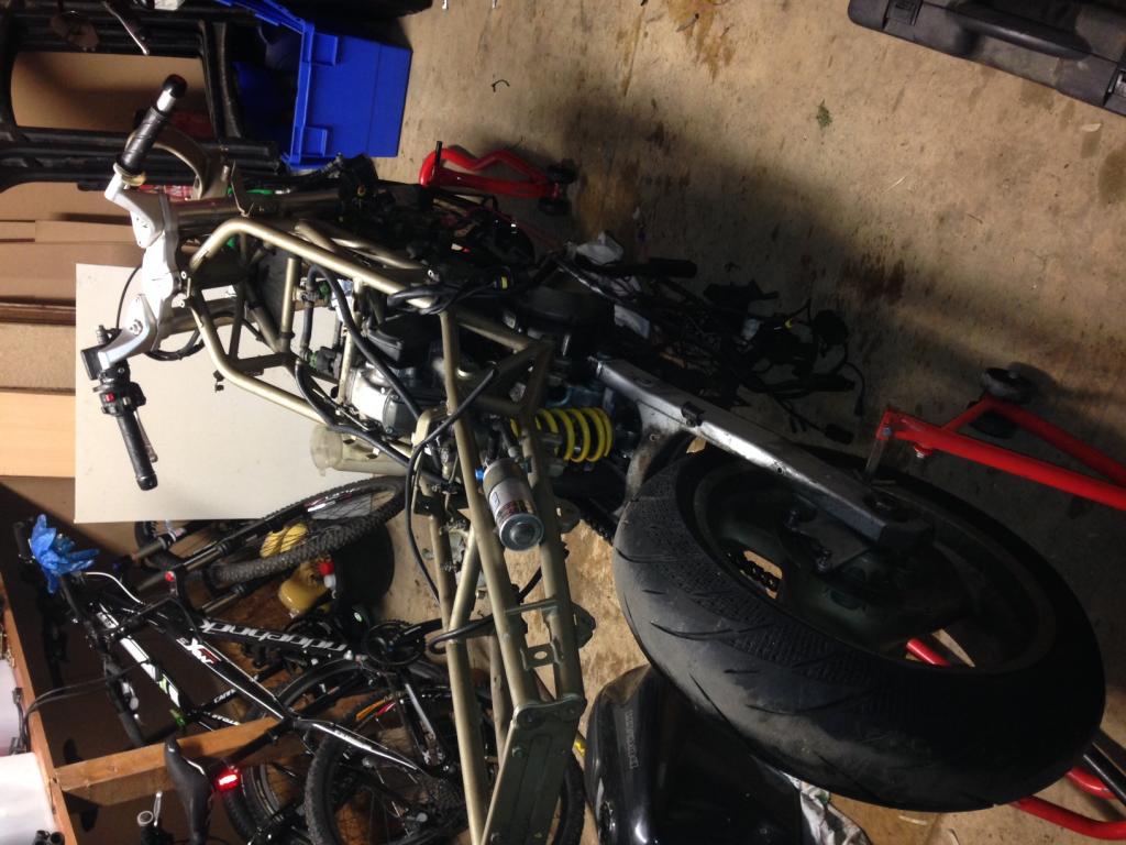

  17. Morning all, here's the latest on the project...
  18. God knows why the pics are going in upside down and sideways!? That's not how they appear on my machine!
    Might try and drop in the s4r front end today, depends what the wife says!
    Oh yeah has anyone else ever gone to undo the main engine to frame bolts and found they are quite loose!? I suspect there is moreto the history of this bike than meets the eye but the i thought its an unloved v-twin that may rattles itself loose!? Any ideas?
    And finally, the horizontal cylinder exhaust flange nuts literally flake off in your hands, is this common?
