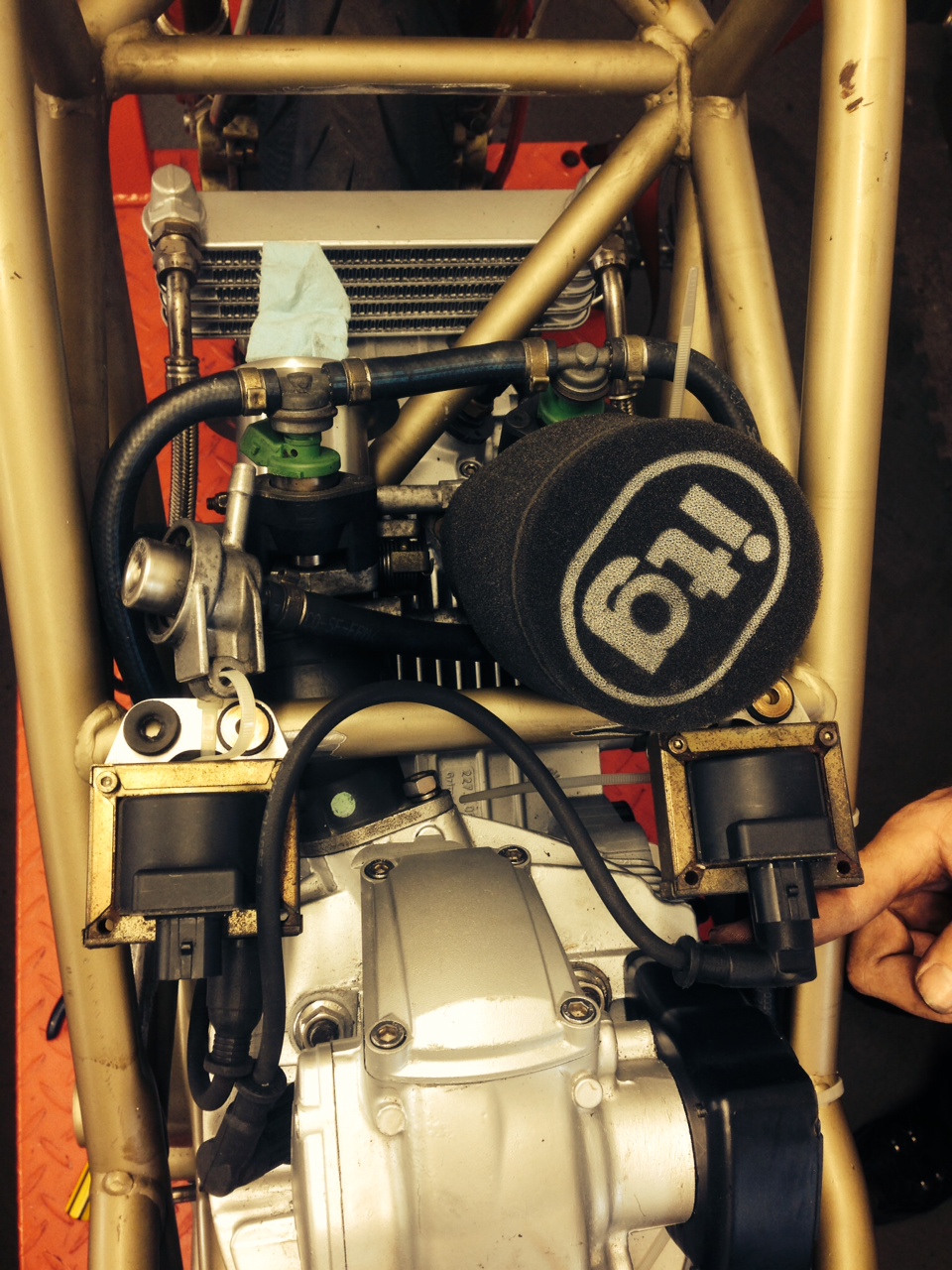

  1. started making some decisions on housing the electrics now with Marks help, he has tacked on some brackets to mount the coils and ecu. I'm hoping by using a tiny battery tucked up under the tank i can hide a lot of the wiring without having to mod the loom too much. Although i'll probably end lopping a bit of it off. There's a surprising amount of room under the tank when you go for this layout. This pic is just a mock up but gives an idea of coil location, i didn't mind making a feature of them so you can see them from the top and side views when the tank is on.

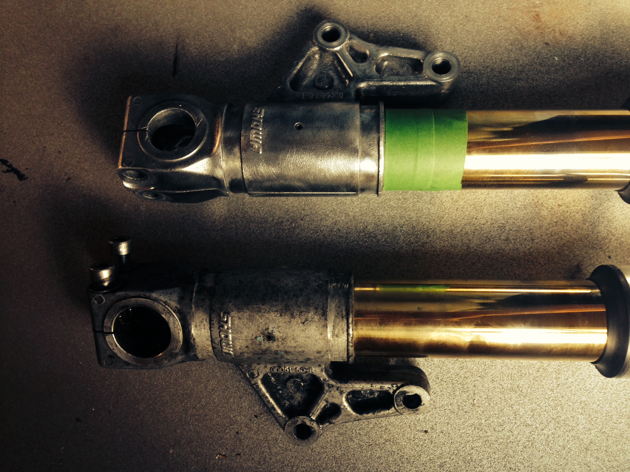

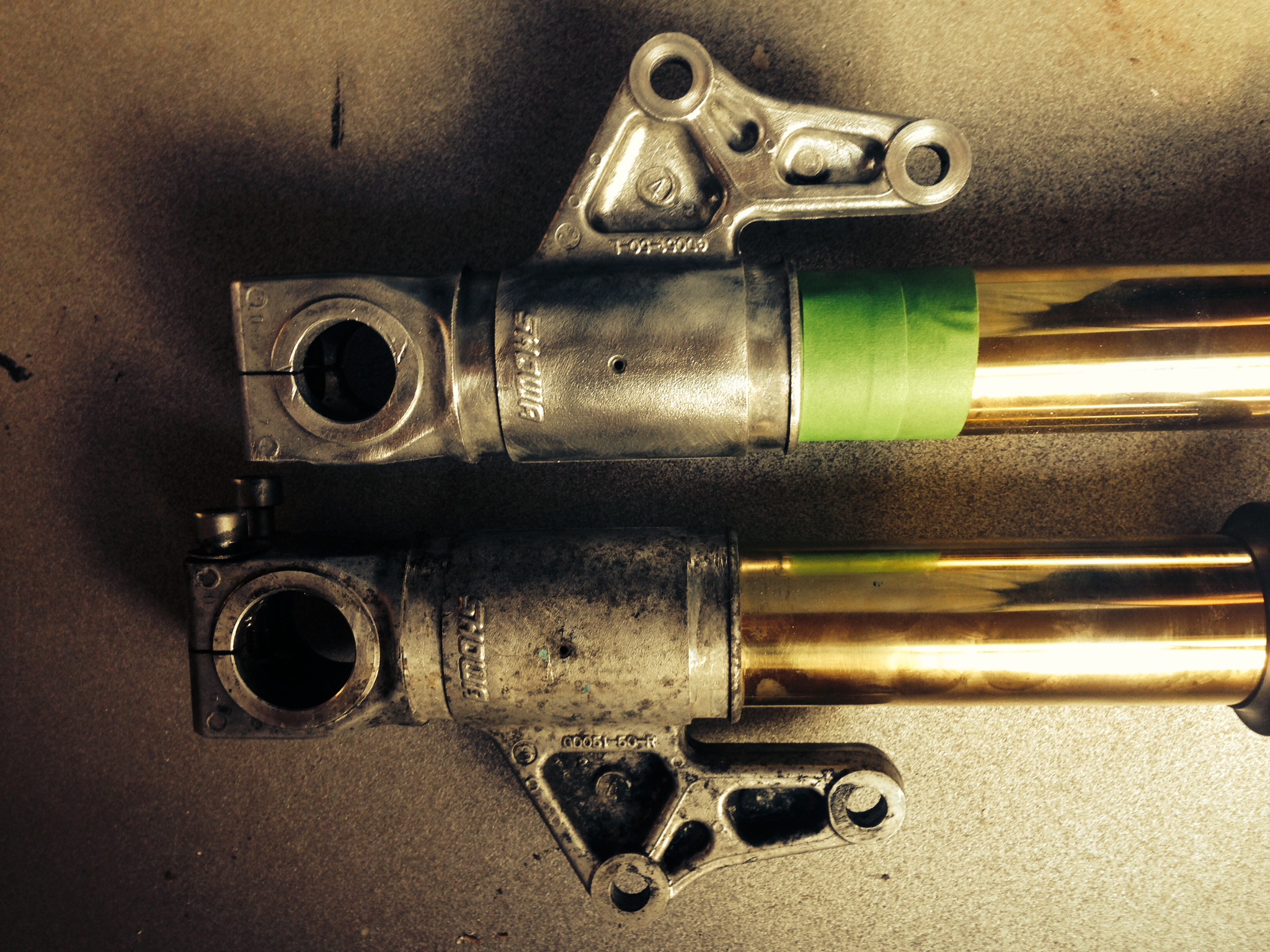

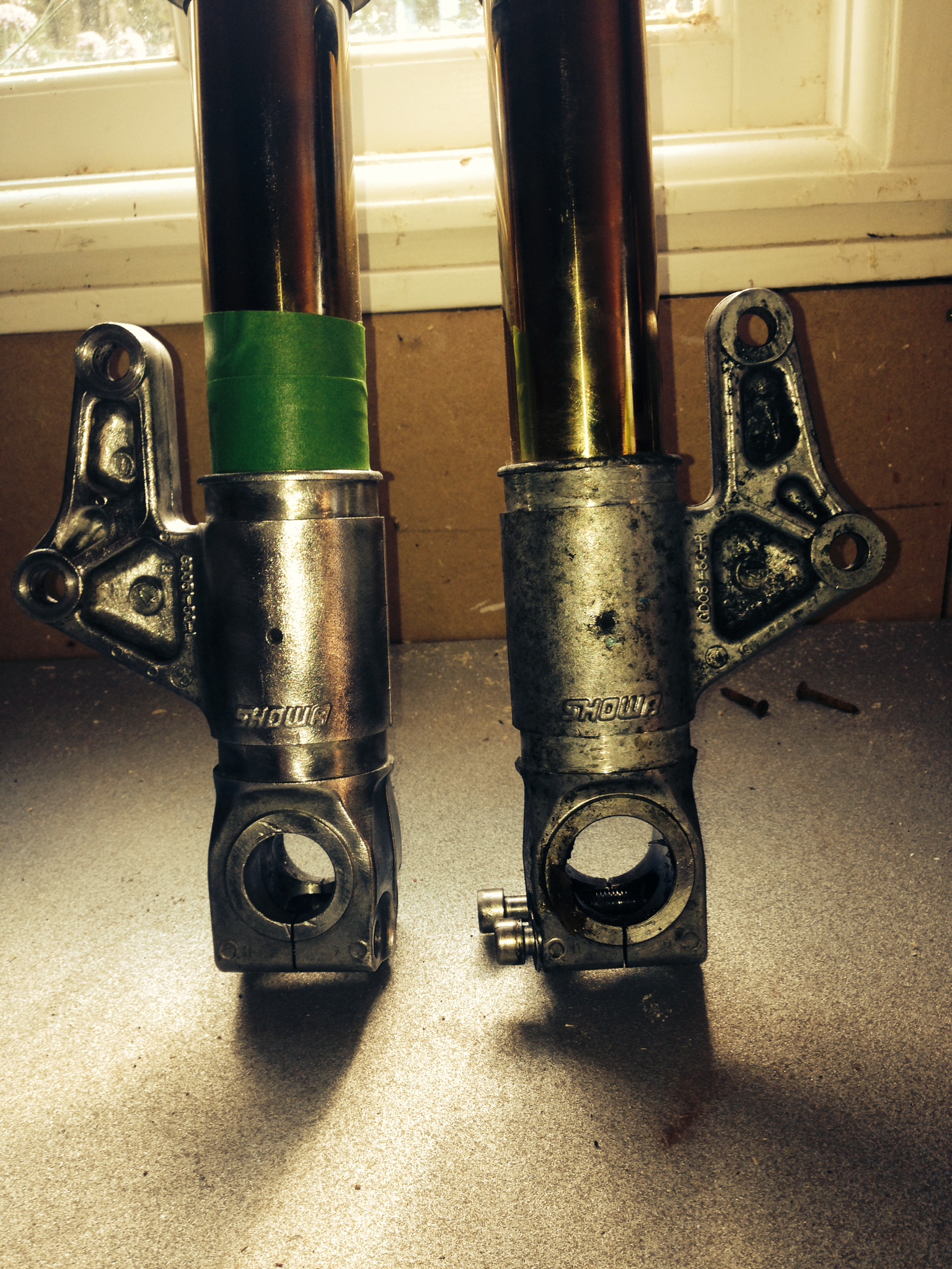

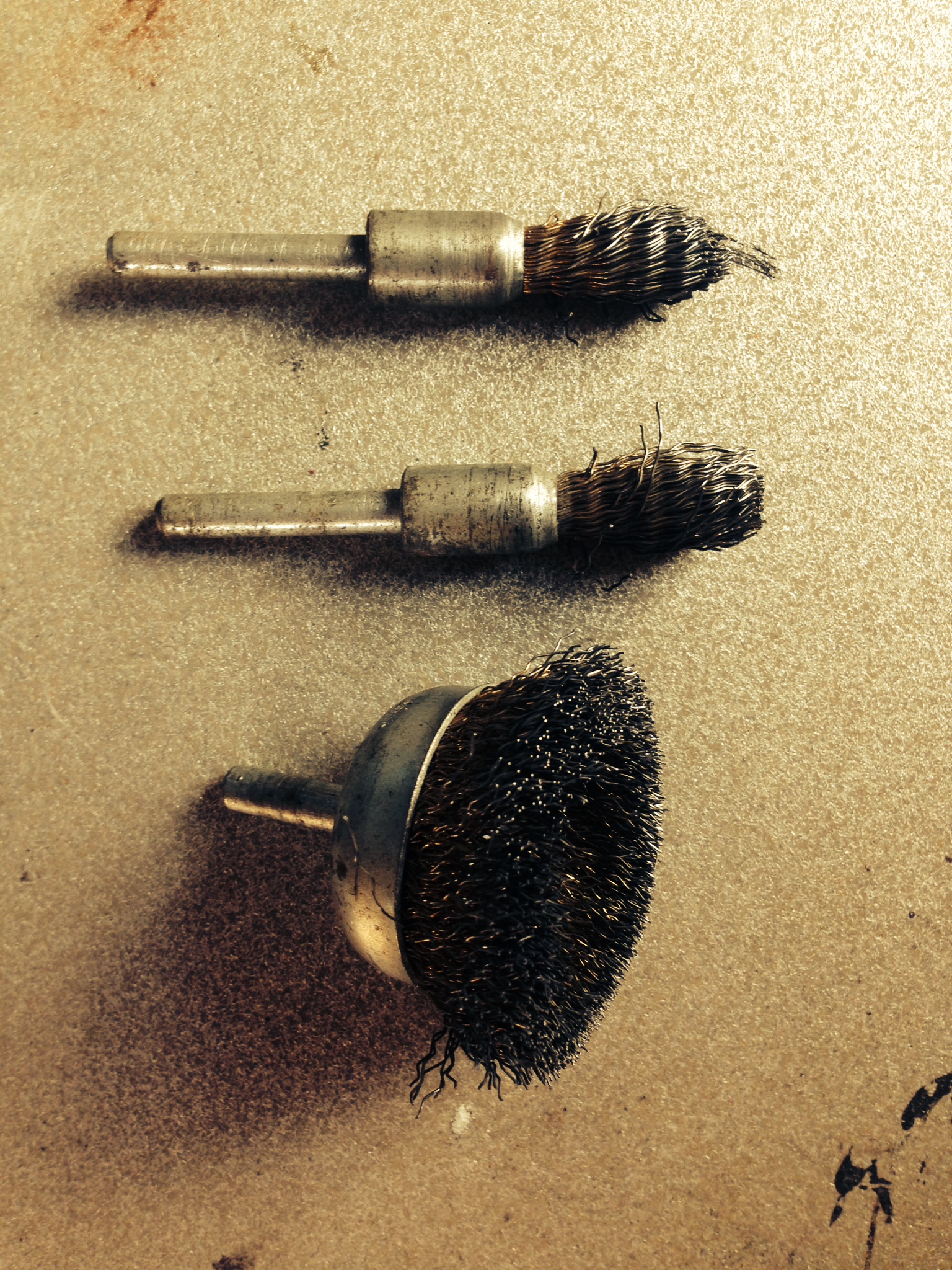

    Started cleaning up the fork bottoms today, used some brass wire drill bits and was well pleased with the results. They were heavily pitted and I hadn't really had any joy using a wire brush and brake cleaner and would recommend using these drill bits. Check out the pics for before and after. Suspension cleaning (3).JPG Suspension cleaning (4).JPG Suspension cleaning (1).JPG Suspension cleaning (2).JPG

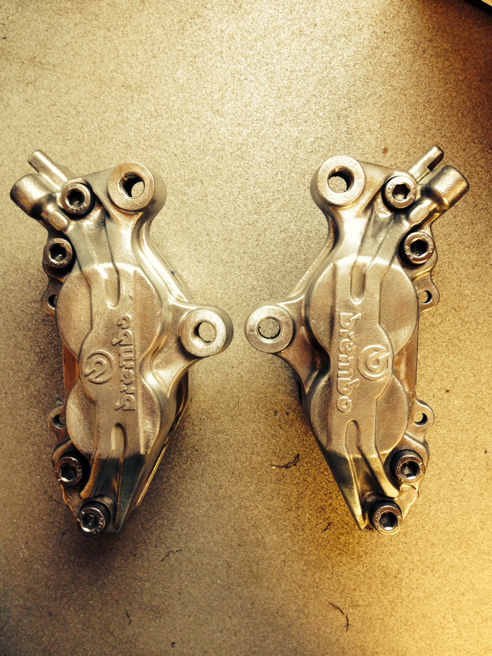

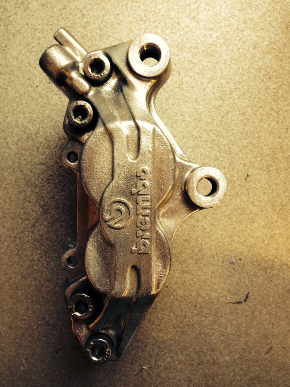

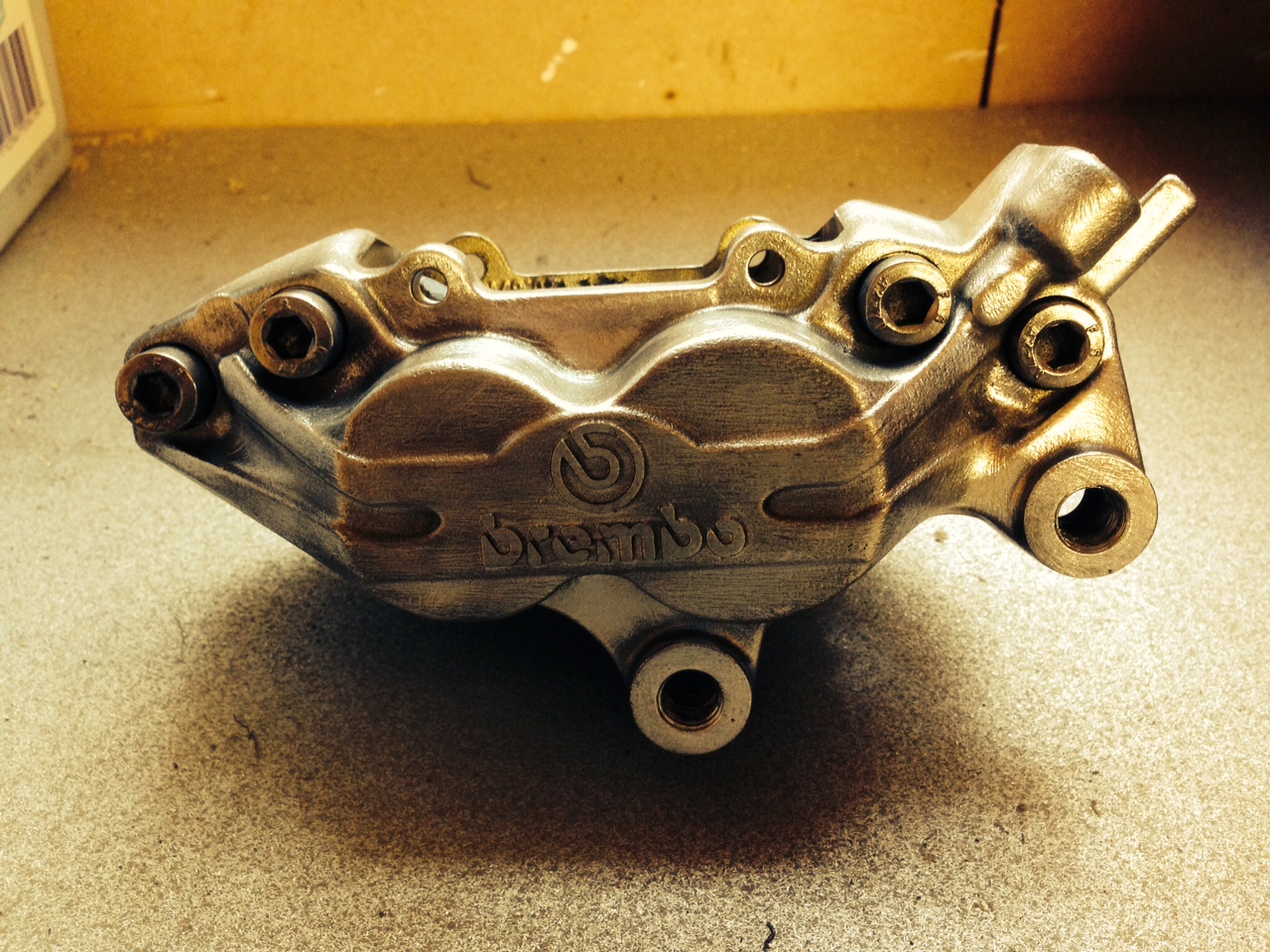

  16. got the calipers cleaned up at last, was going to just give them a good clean but 25,000 miles and no cleaning meant the grime just wouldn't come off. needless to say i stripped the paint off them and now i think i might just keep them with this finish. anyone know if i need to lacquer them or not? Calipers cleaned (2).JPG Calipers cleaned (1).JPG Calipers cleaned (3).JPG

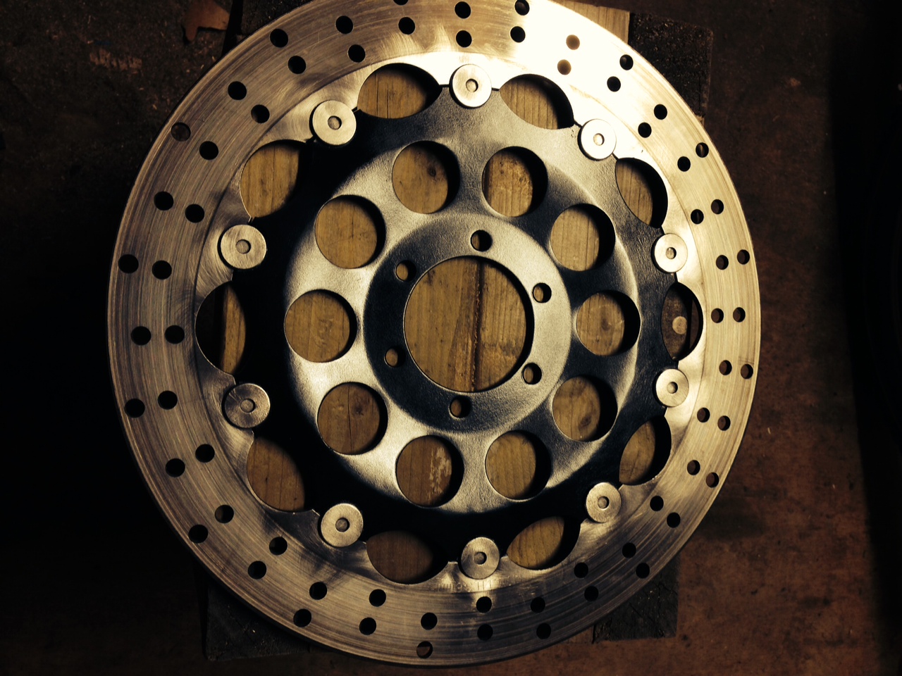

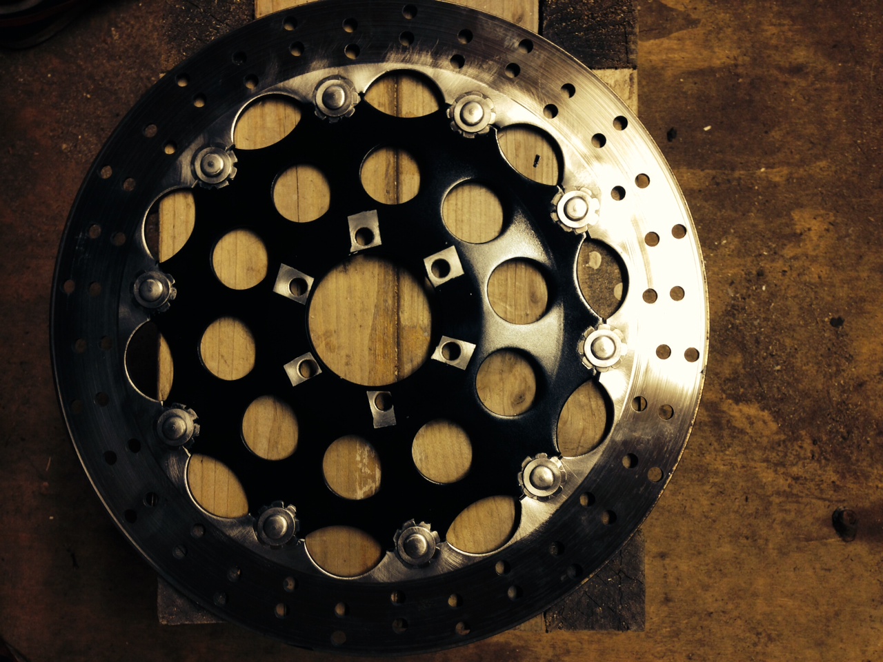

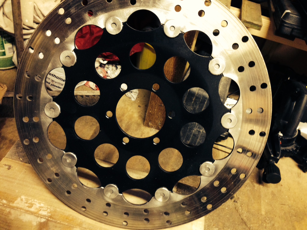

  17. Got the brake discs sprayed up and ready to re-mount. I wanted the black centres but new they were something like £200 each. Think these came up ok...
  18. Wish i'd spent more time making those surfaces round the holes on the back side more uniform! oh well they'll never be seen
