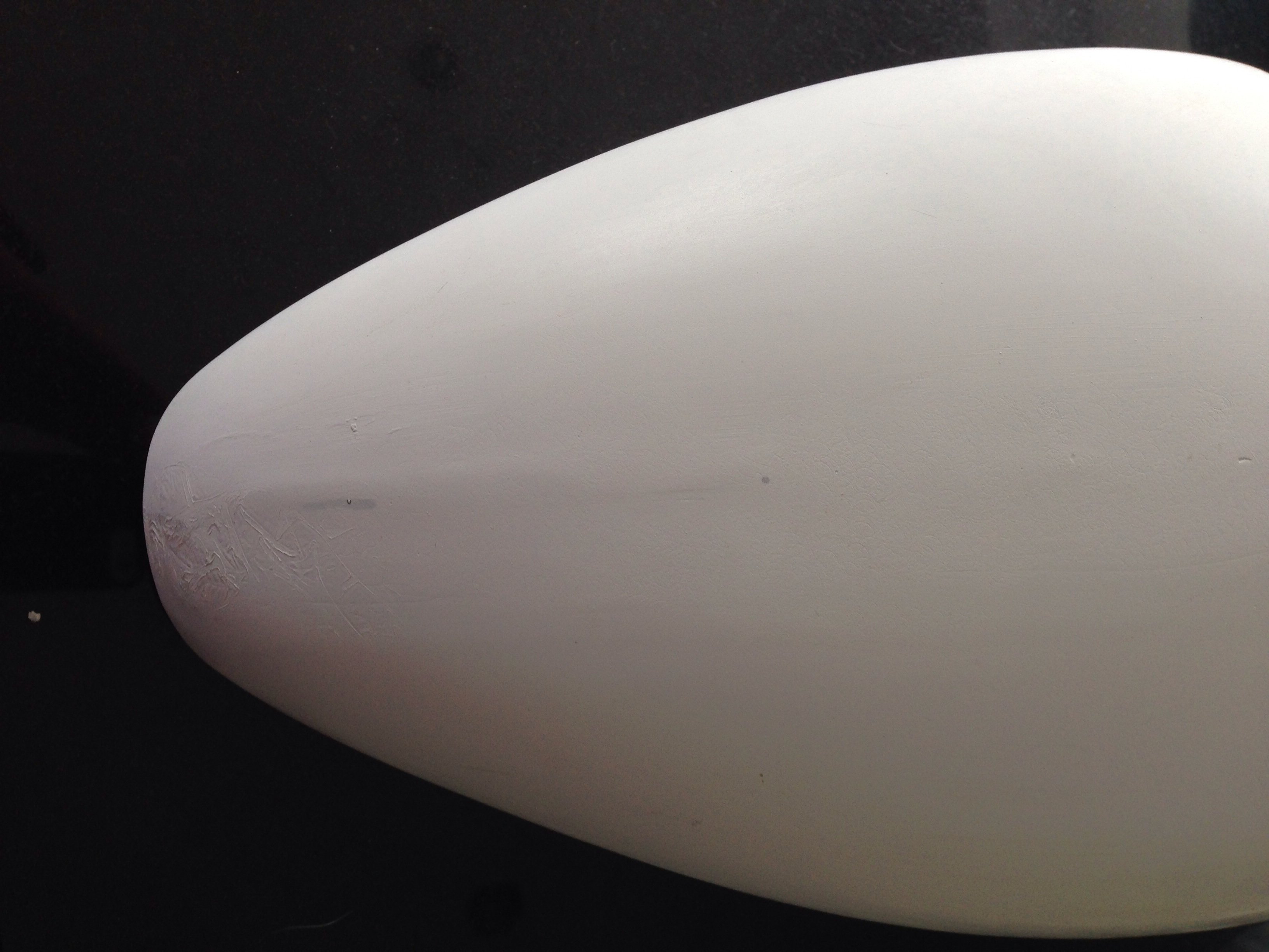

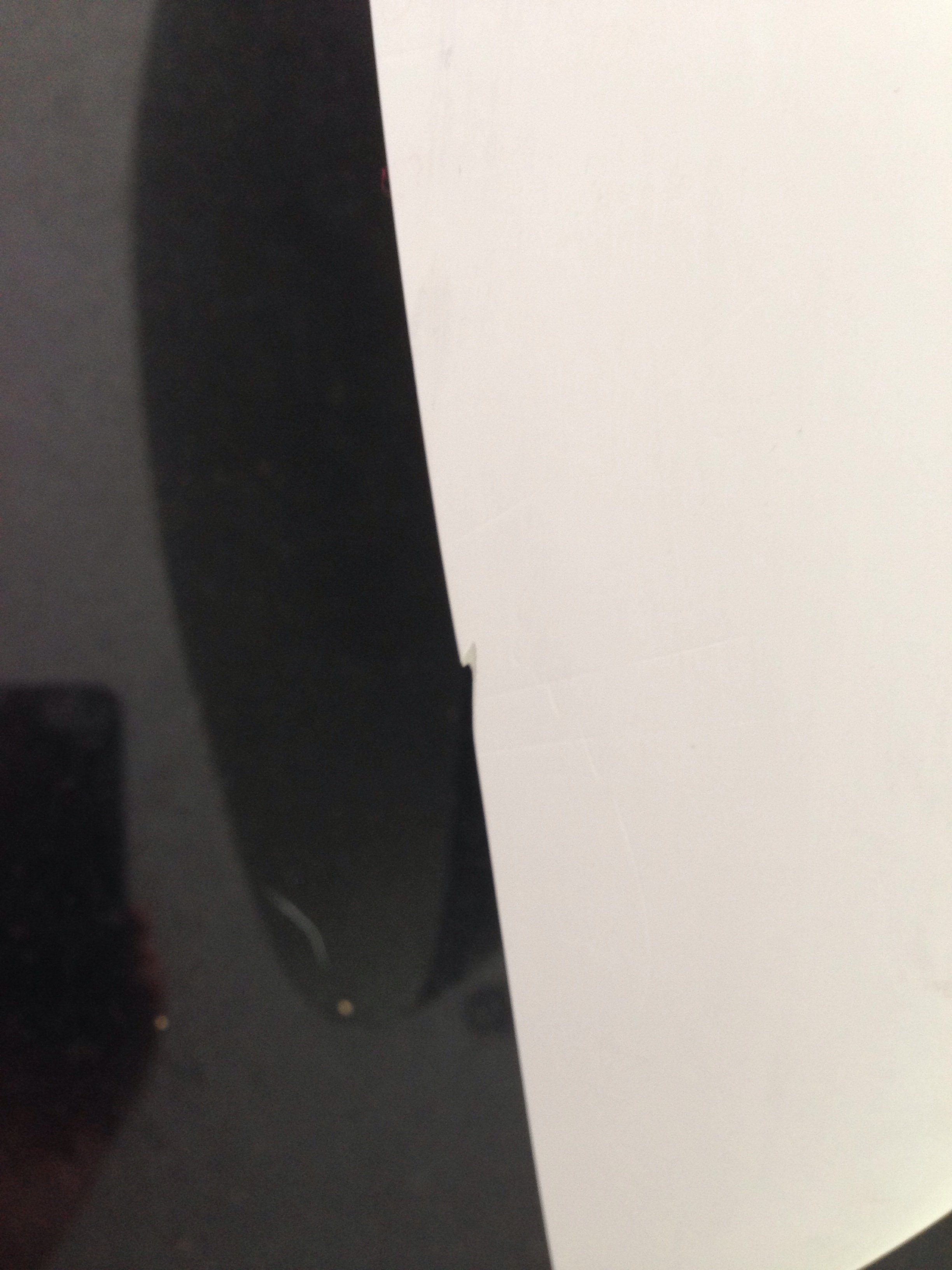

  16. Just received my seat and whilst I love the look the quality is not fantastic v thin fibreglass will need to reinforce it for everyday use, it's not symmetrical and it has a few gouges in the finish . Had hoped for better for €180. Will post pics later
    Just some of the niggles but hey oh it's hand made and it's not pissing fuel ;)
  18. just because its hand made is no excuse for a poor quality finish,he cant be to bothered about his reputation.
  19. As above, it really should be better than that. If it was £30 and second hand off ebay you wouldn't mind!
