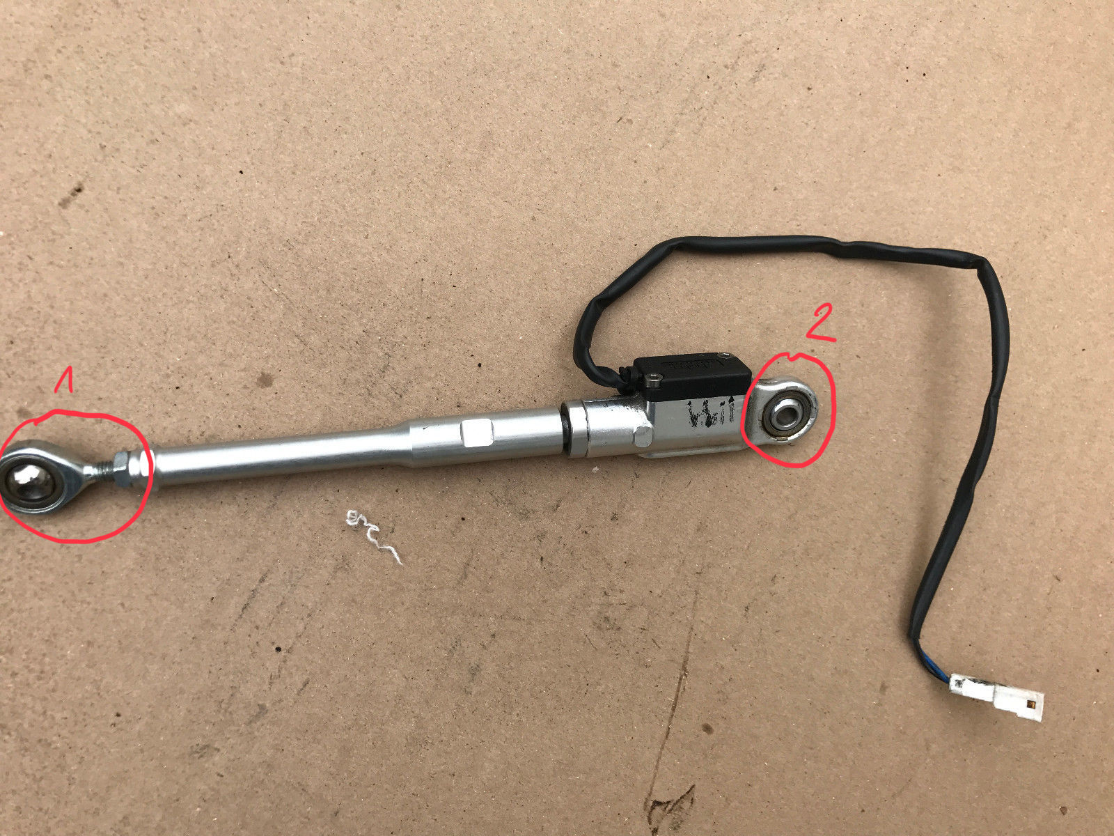

  4. Topolino thanks for the reply and instructions. My technical english is not so OK I see:joy: what I meant is do you get in the kit the ball joints(or at least one of them)? The "back" ball joint that is mounted to the rear sets you can unscrew from the OEM shift rod but what about the front one as it is one piece with the OEM shift sensor? see the picture. Sorry if my questions are stupid but I would like to know if I need to buy something else before the kit arrives.
    Cheers
  5. No you dont need to replace the front one as its part of the strain gauge. Just unscrew the OEM rod and remove the ball joint from it which you will need to re-use later, as explained above.

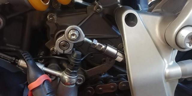

  7. [​IMG] Here you go..
  8. Thanks...all clear now :upyeah:
