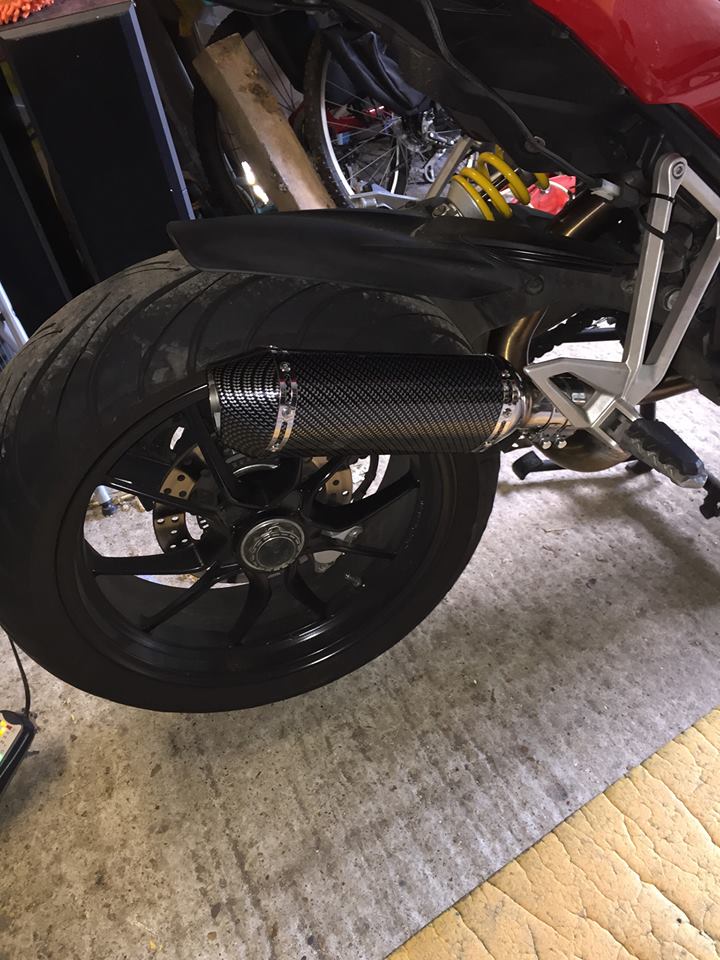

  6. Well I have gone de-cat - unfortunately with a Danmoto. It fits reasonably well, apart from the exit to silencer pipe, which points the cheapo silencer too close to the back wheel. So now I have to find an engineer welder who can modify it for me. Serves me right I suppose.
    I have put the original silencer on and it does make a nice noise, will be able to decide if it's too noisy after a spin out tomorrow.

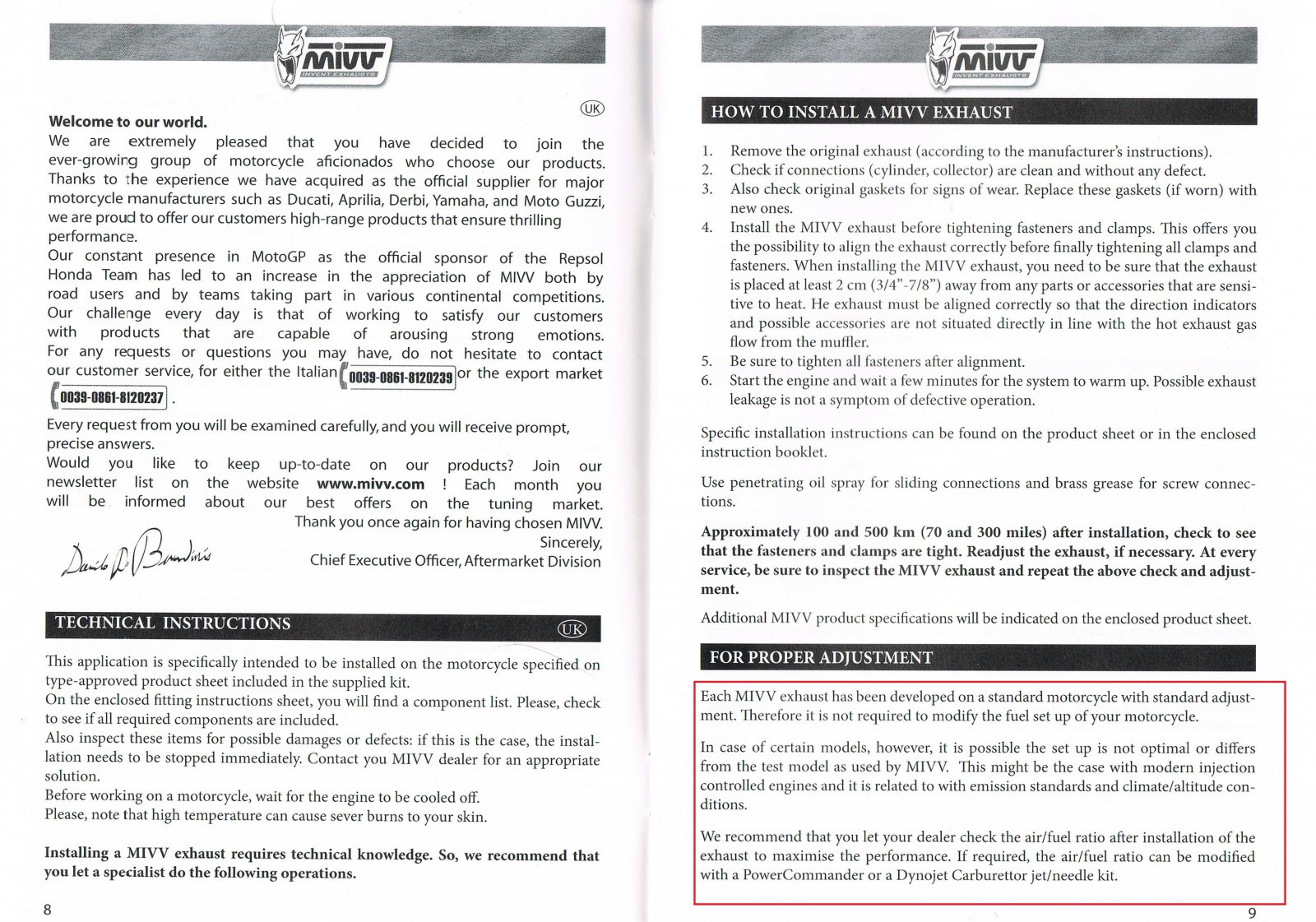

  9. I put a mivv on mine 3 weeks after buying the bike. I fitted it with out the noise stranglers in the down pipes my dealer said after I've fitted it they will check the error log for any mixture alerts but it was fine.
    Check out the text in the red box.
  10. Yep way too noisy. So I need to either baffle the original exhaust, get the Danmoto pipe modified so I can fit the silencer I bought, or go and boil my head.

  13. Thanks for your input, I have found a local welder who is going to modify the danmoto for me.

  14. and done. and the exh valve gizmo has arrived :)
