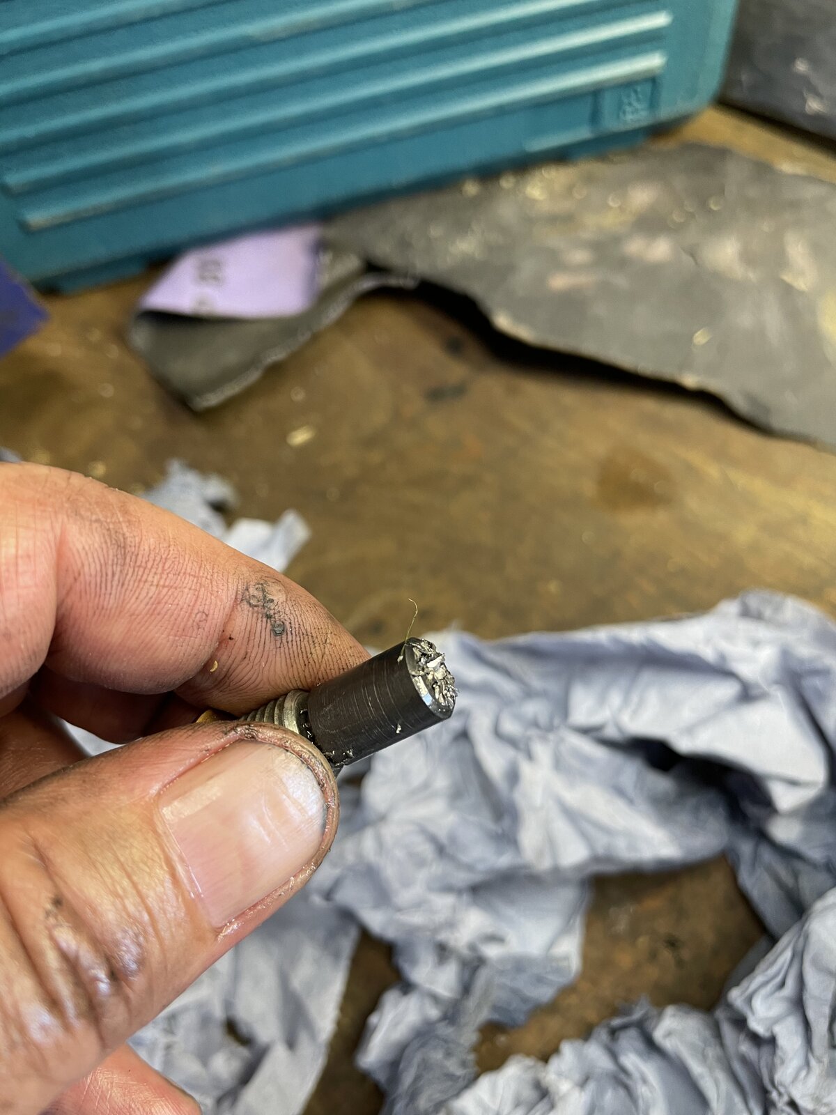

  1. Can’t be sure other than the new bearings had the Ducati part numbers on the invoice. I didn’t ask Neil re the bearings that came out as by the time I had paid the invoice, Ducati had already declined any good will. I was going by what had been discussed on the forums re the poor quality main bearings fitted to 2011 - 2012 MTS1200 and Diaval bikes. I have attached some pics of the fragments that I mentioned.
  2. Thanks. OK , I understand. Well, those fragments betray catastrophic failure. COmapring to mine, which were RHP, mine did not disintegrate in that way. but surface deformation of a ball had gradually increased. And the tracks help up well.
    Perhaps then, it was a limited run of poor bearings bearings fitted, , and a Chinese-sponsored state factory had made claims about bearings that did not stand up. If that's the case I am still astonished, because I cannot imagine a motorcycle's engineers falling for claims on mains bearings by a Chinese start up. Sounds more like a finance/marketing management intrusion into decision making.
