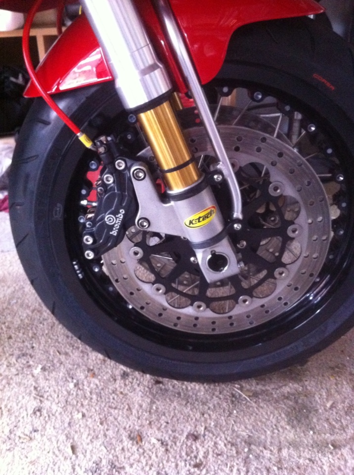

  4. I had them made. A local bike shop that makes hel lines came around and custom made a set to fit my uprated callipers, he also made a matching clutch line .
