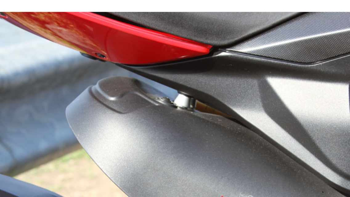

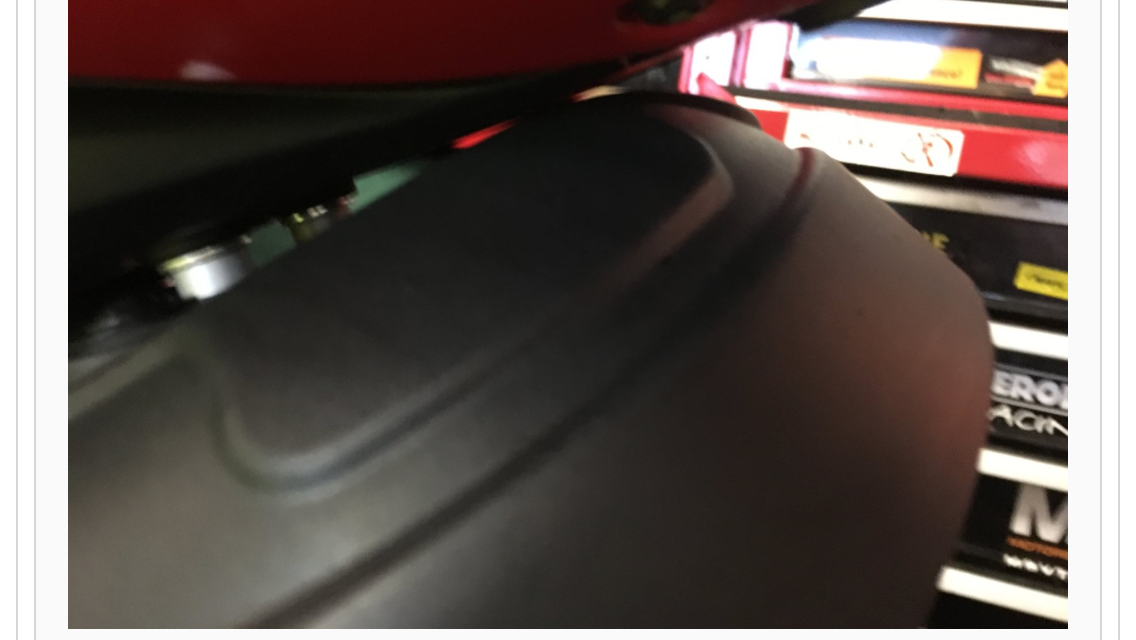

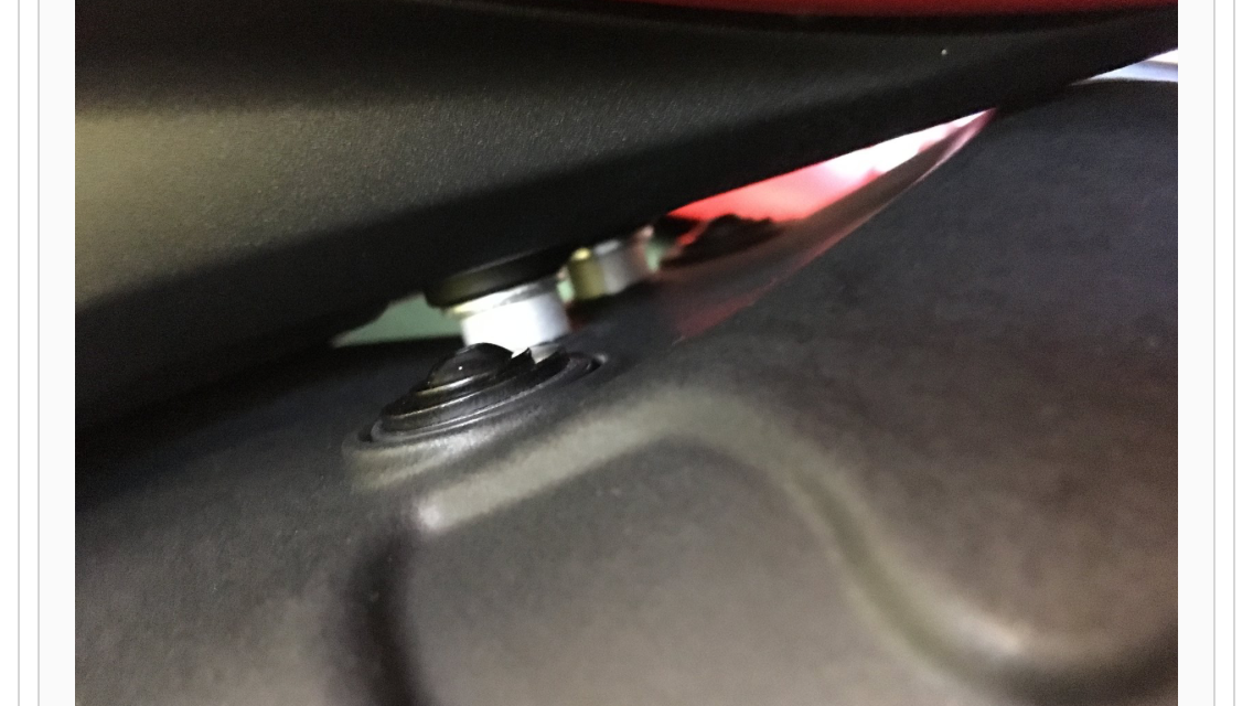

  8. There has to be a gap as the spacers are in place to stop the undertray hitting the subframe
    It should look like this with one pair of spacers
    Or if you were lucky enough to get 2x pairs of spacers at PDI (mine didn't come with them!) it would be like this

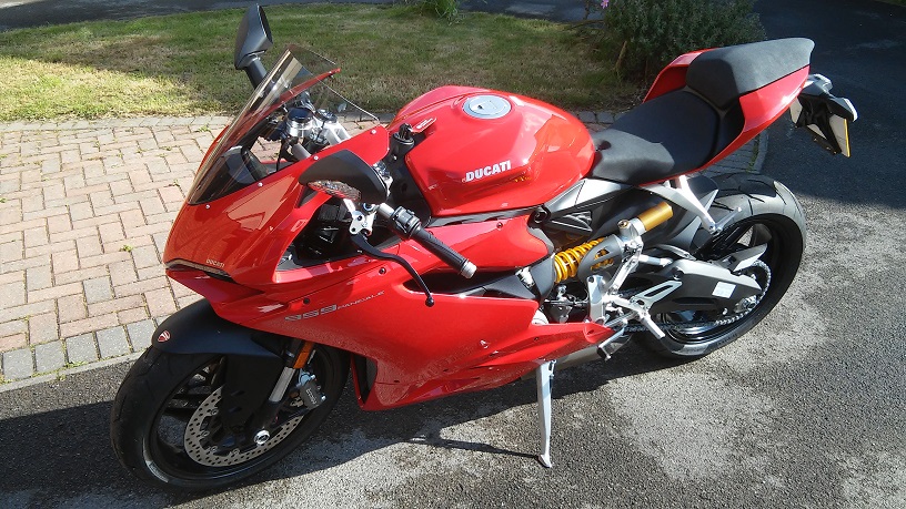

    Thanks for all the pics and info....Red is the best colour!! Mine below
