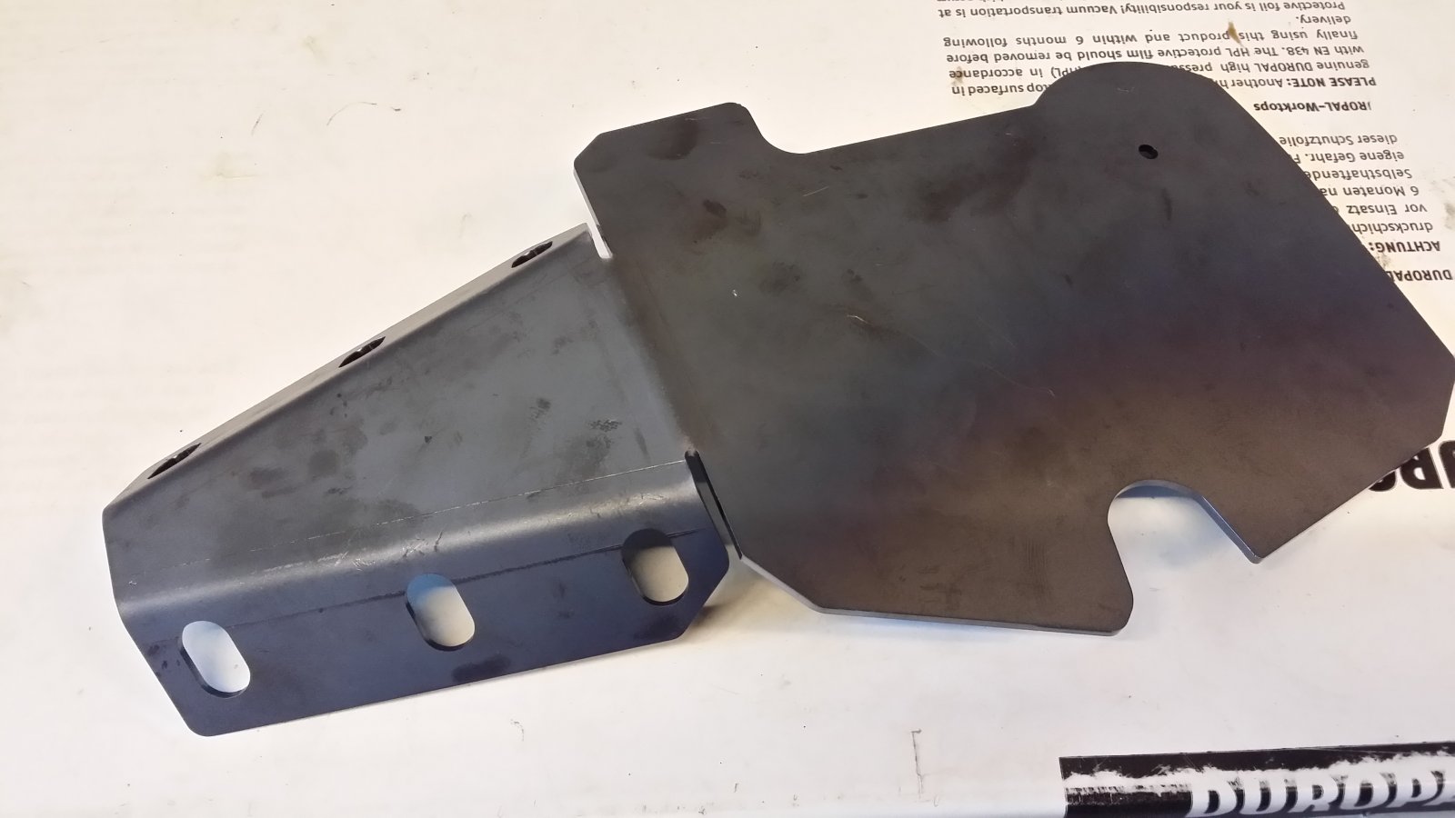

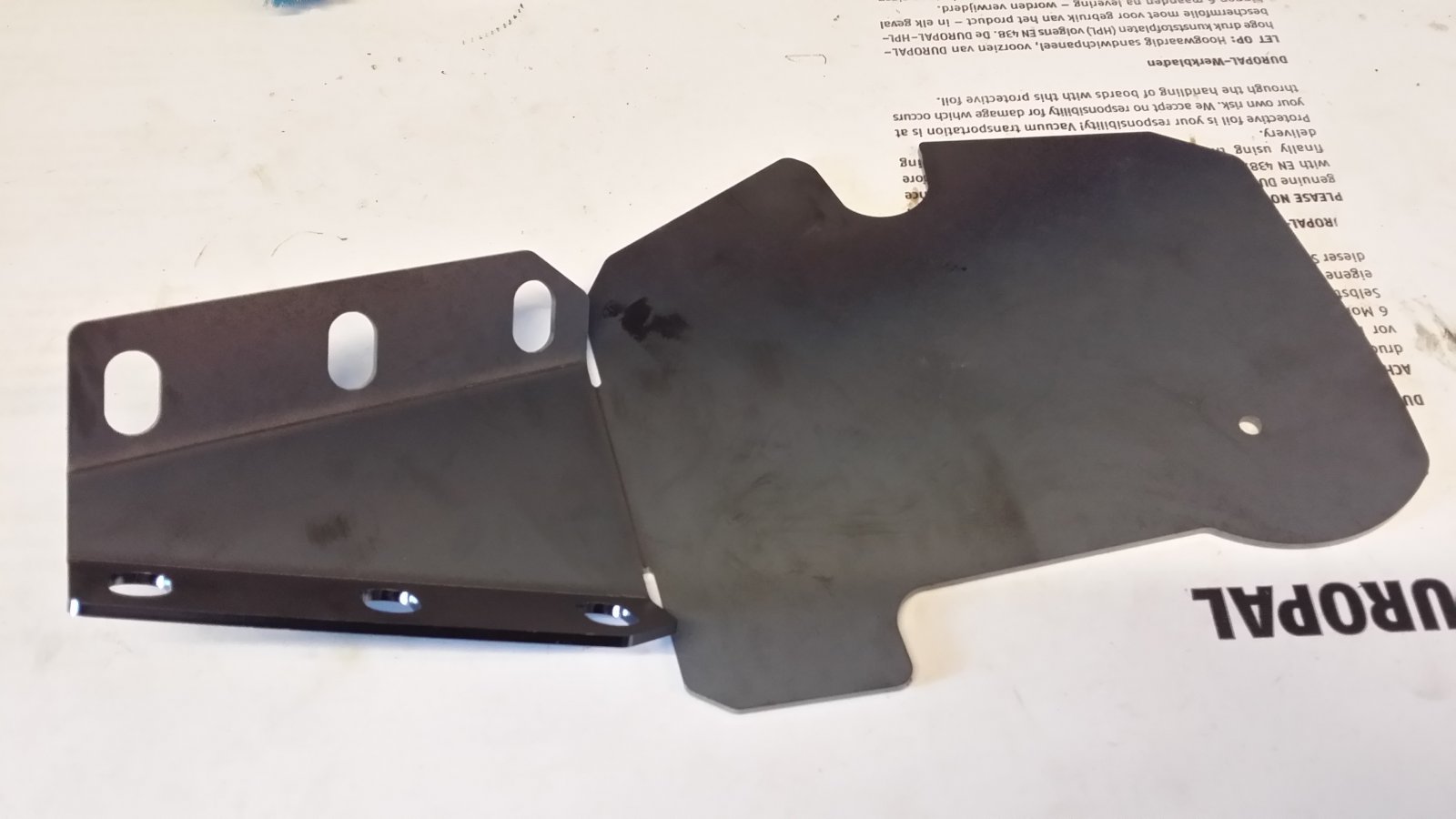

  2. At last the sample is ready - he made it out of mild steel ( dunno why as I asked for the sample to be stainless ) but hey at least it ready - hopefully will collect it tonight.
  3. Got it... Not fitted yet but plan to later on... Think I'm gonna have to hack it around a bit more... 20141009_170507.jpg 20141009_170455.jpg

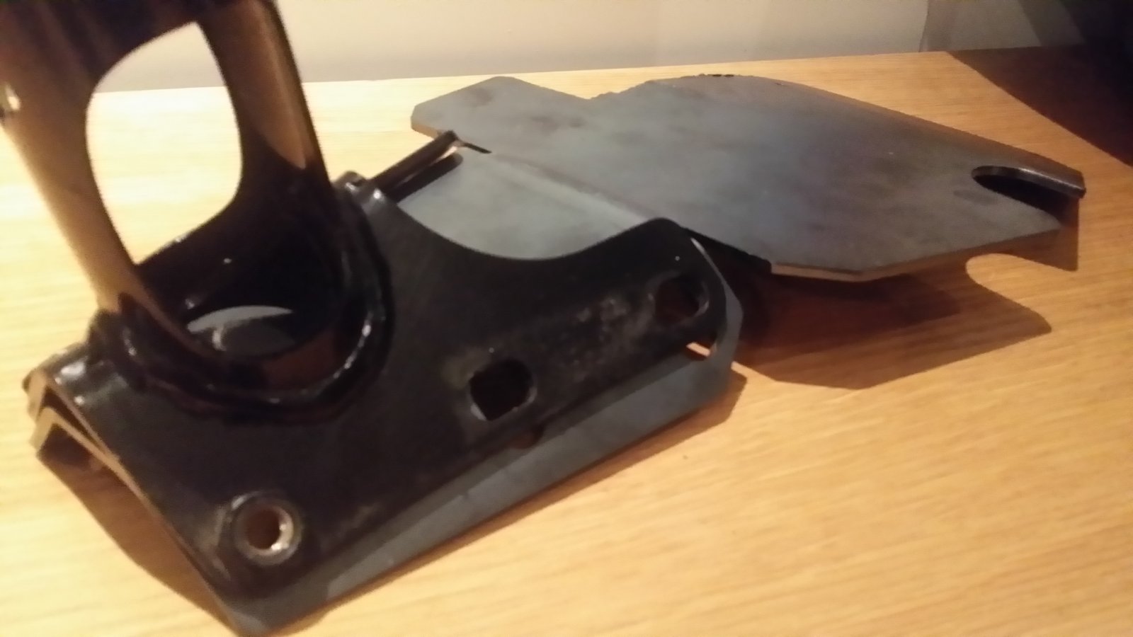

  7. Ok.... Hacked it around a little but the mount isn't right but initially it could look really good based on the fact that it won't be seen... [​IMG]
    Any thoughts anyone?
  8. It's looking neat - does it give you the option to use more of the 'boot' space under the seat?
  9. Dunno....don't think so...never really thought of that...here's a question...should I stay where I am with regards to what its covering or....make it bigger...ie go down a bit more and a bit wider....or does it become more bulky at that point and start to loose sportiness....
  10. I suppose you could push some clothing down there....

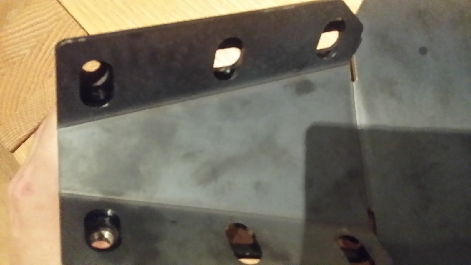

  11. Ok. Hacked it around.... Have taken the termi mount off so he gets the fitting just right... As you can see....
