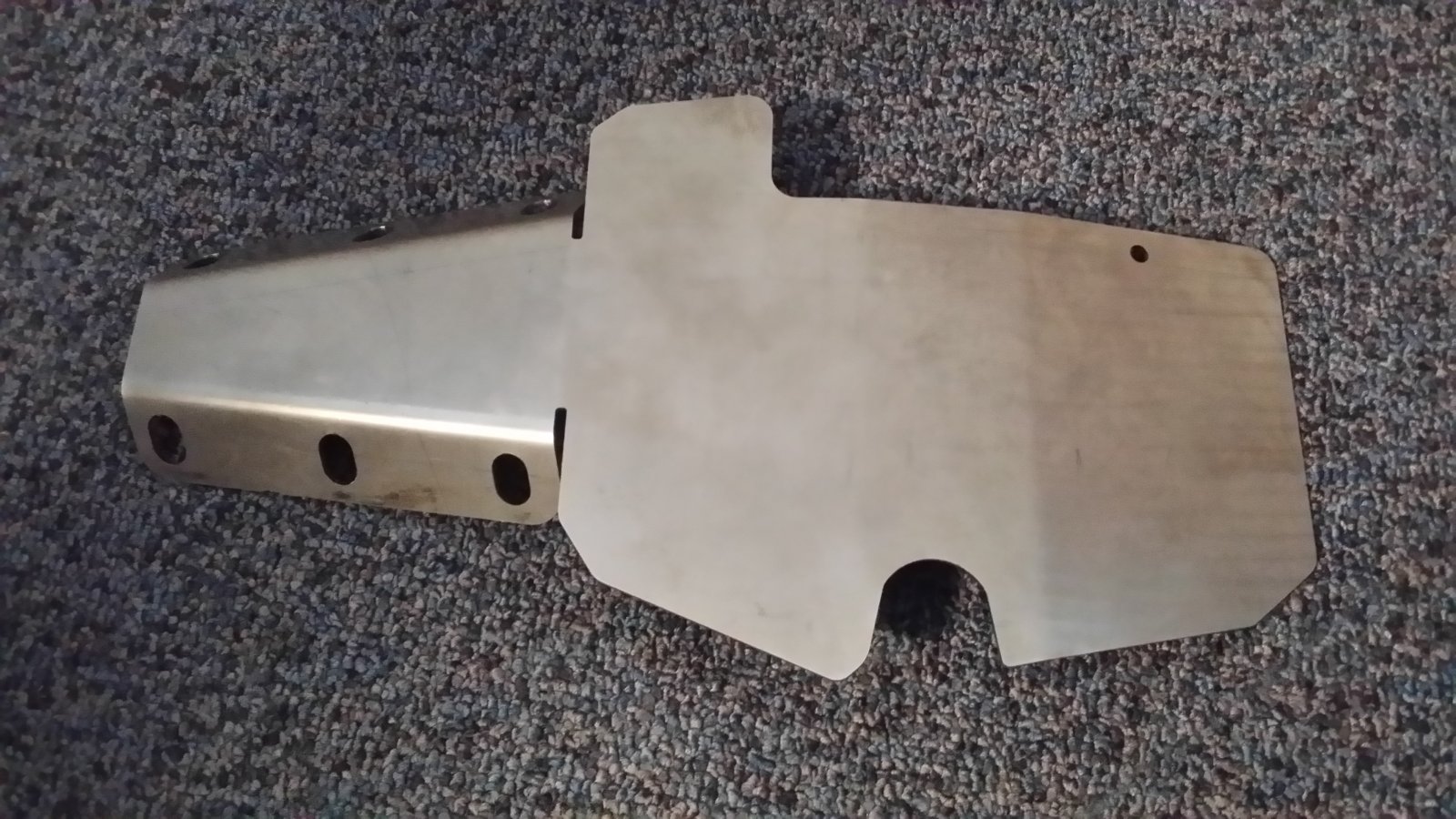

  14. Ok - just got into work from collecting the final revision (final if it fits and covers what its supposed to!) - here you go....
    If I get time ill fit it at lunchtime....if not tonight....assuming all is ok ill then have to have 10 made, so, if you want one let me know....

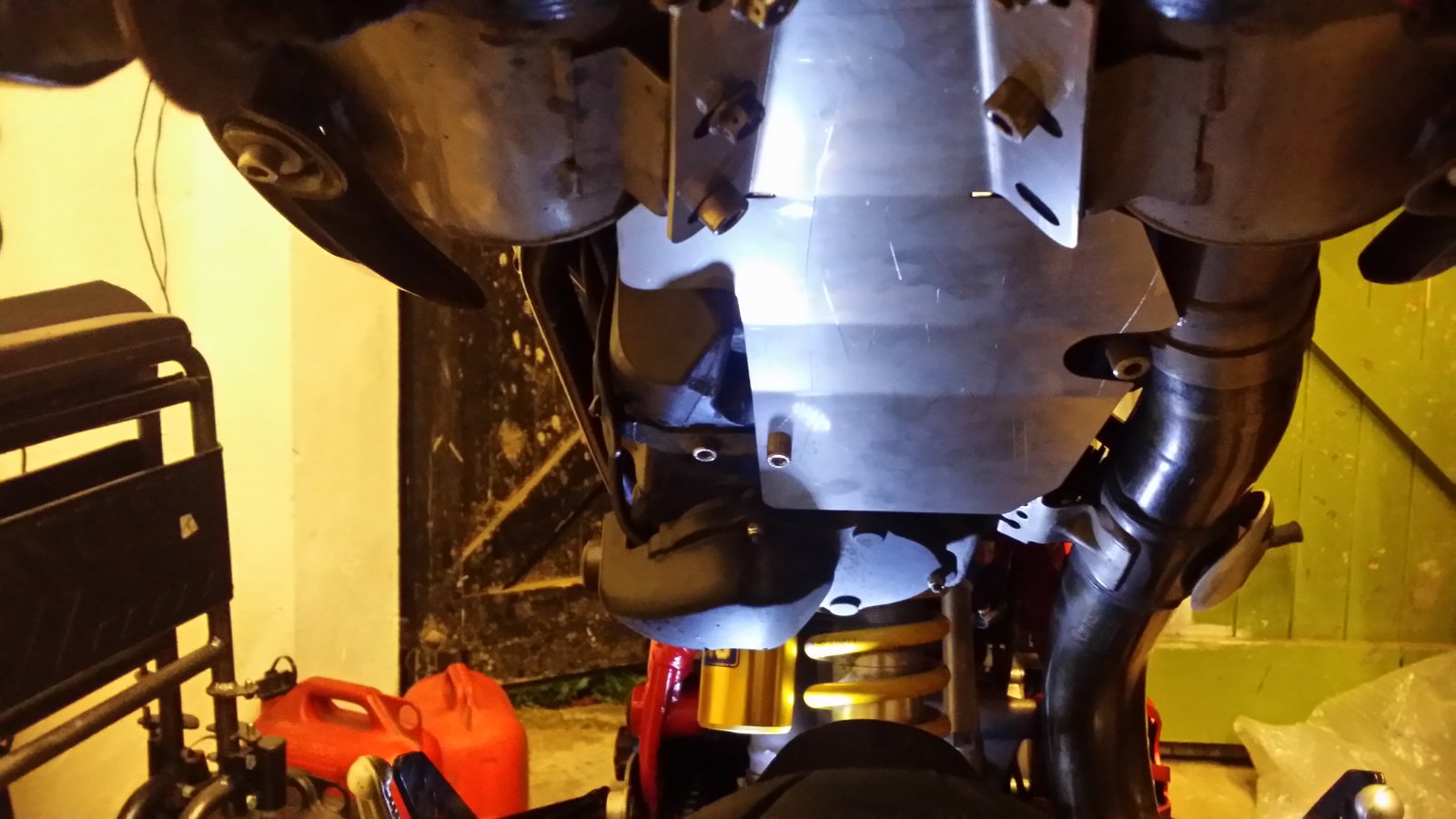

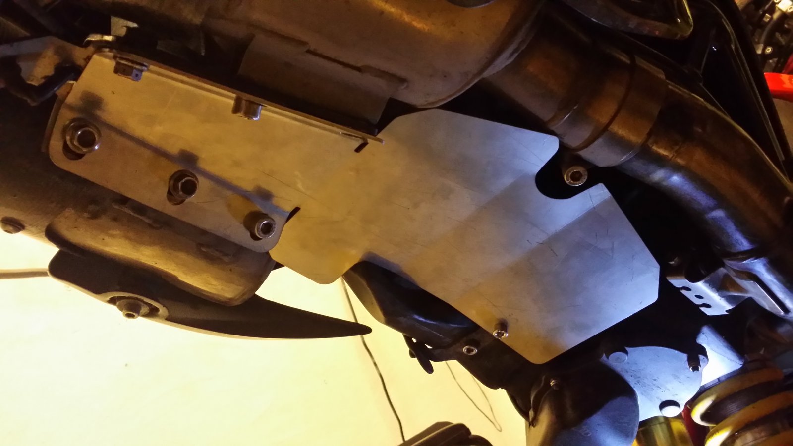

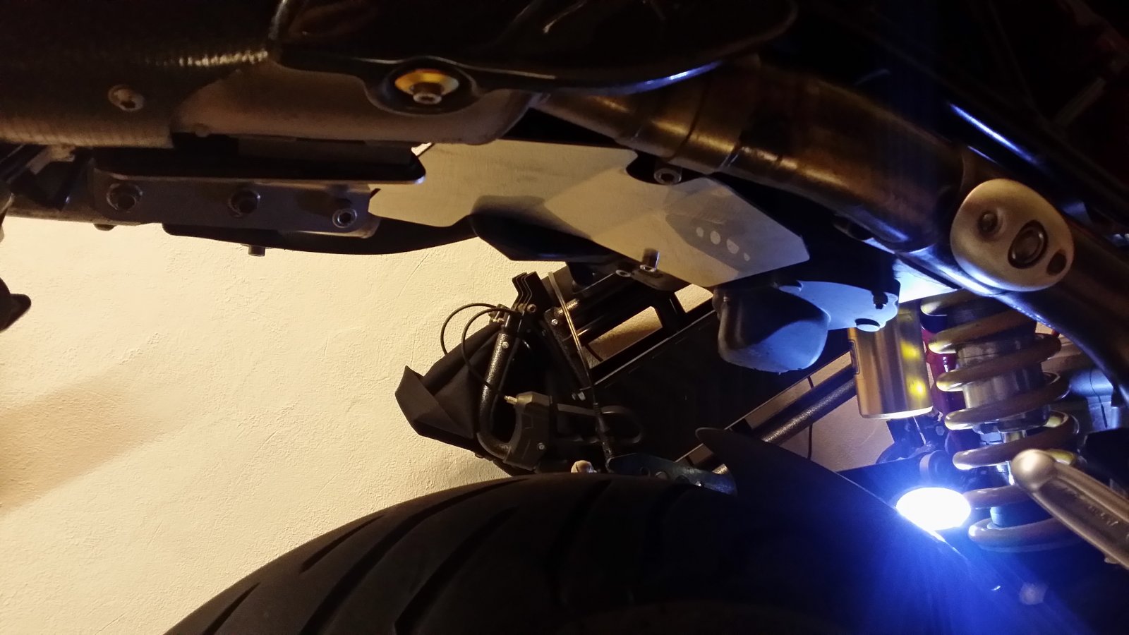

  15. And it's fitted. Here's a few shots....
    Oh... Yeah.... I lost a bolt but it's solid. Quite chuffed with it.

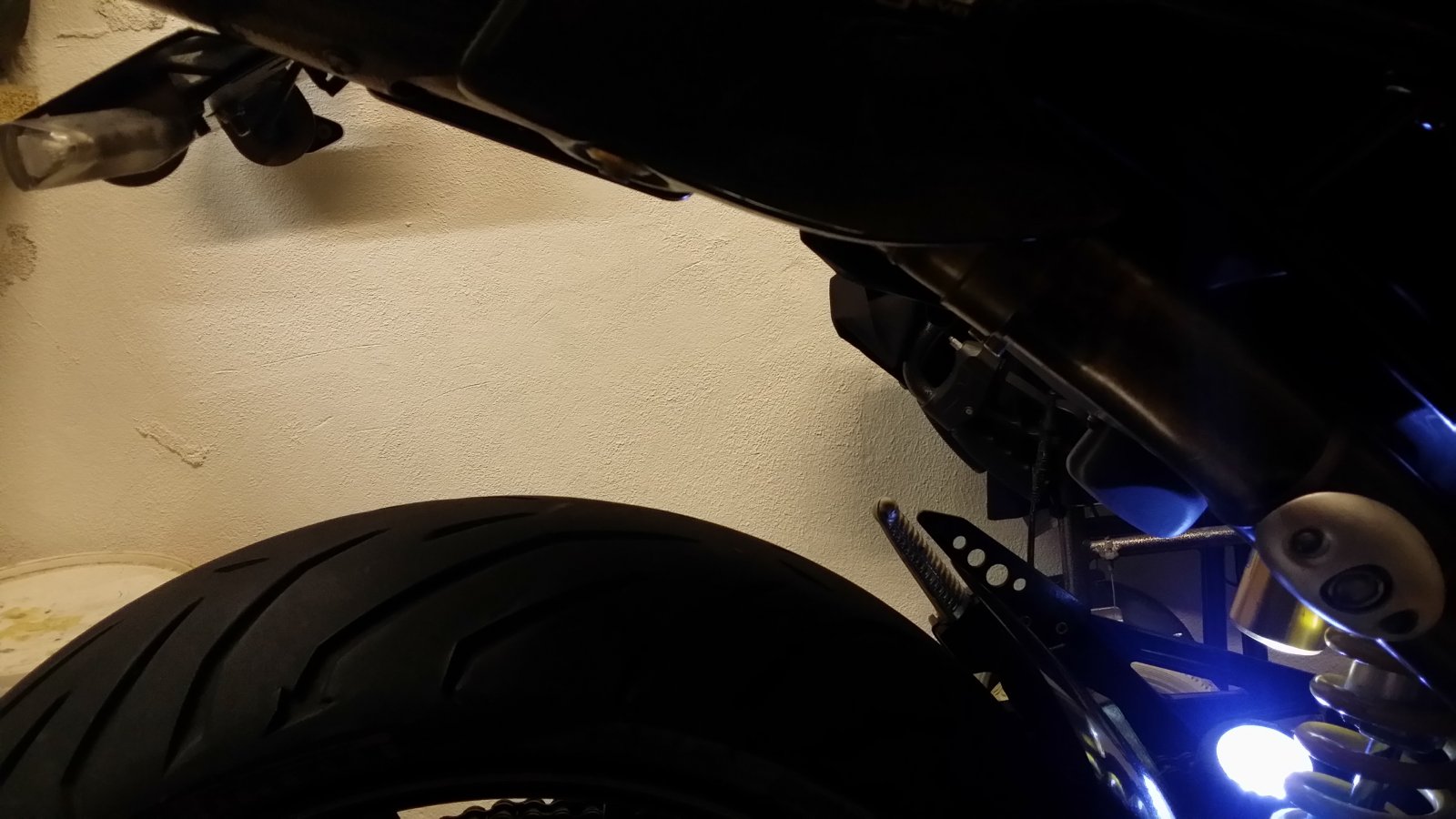

  16. Well....got caught in the rain tonight and it works brilliantly. ...kept up inside round the battery area nice and dry...
  17. Looks good if not a little thick ;)
  18. Looks really neat. I'm guessing it only works with the under seat pipes as opposed to the race termi?
  19. Not sure if you've got that shape for the mount then I guess it would fit yours....
