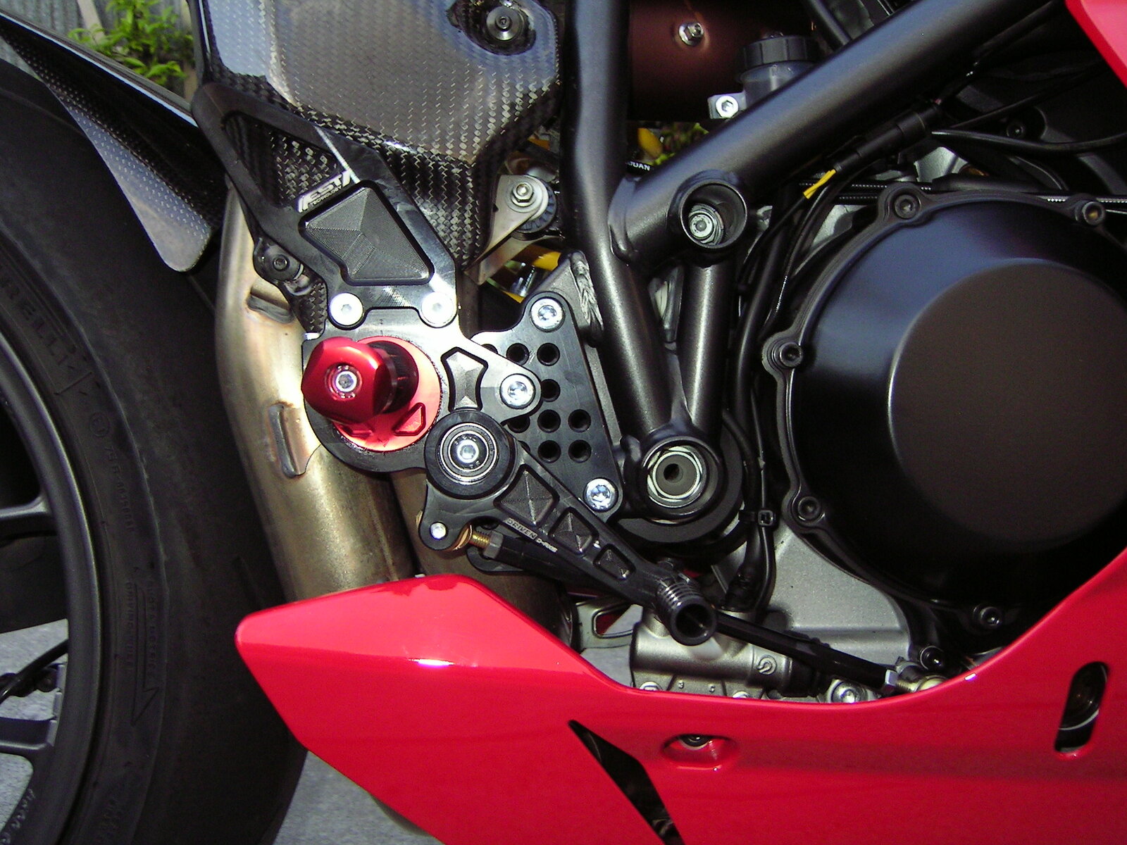

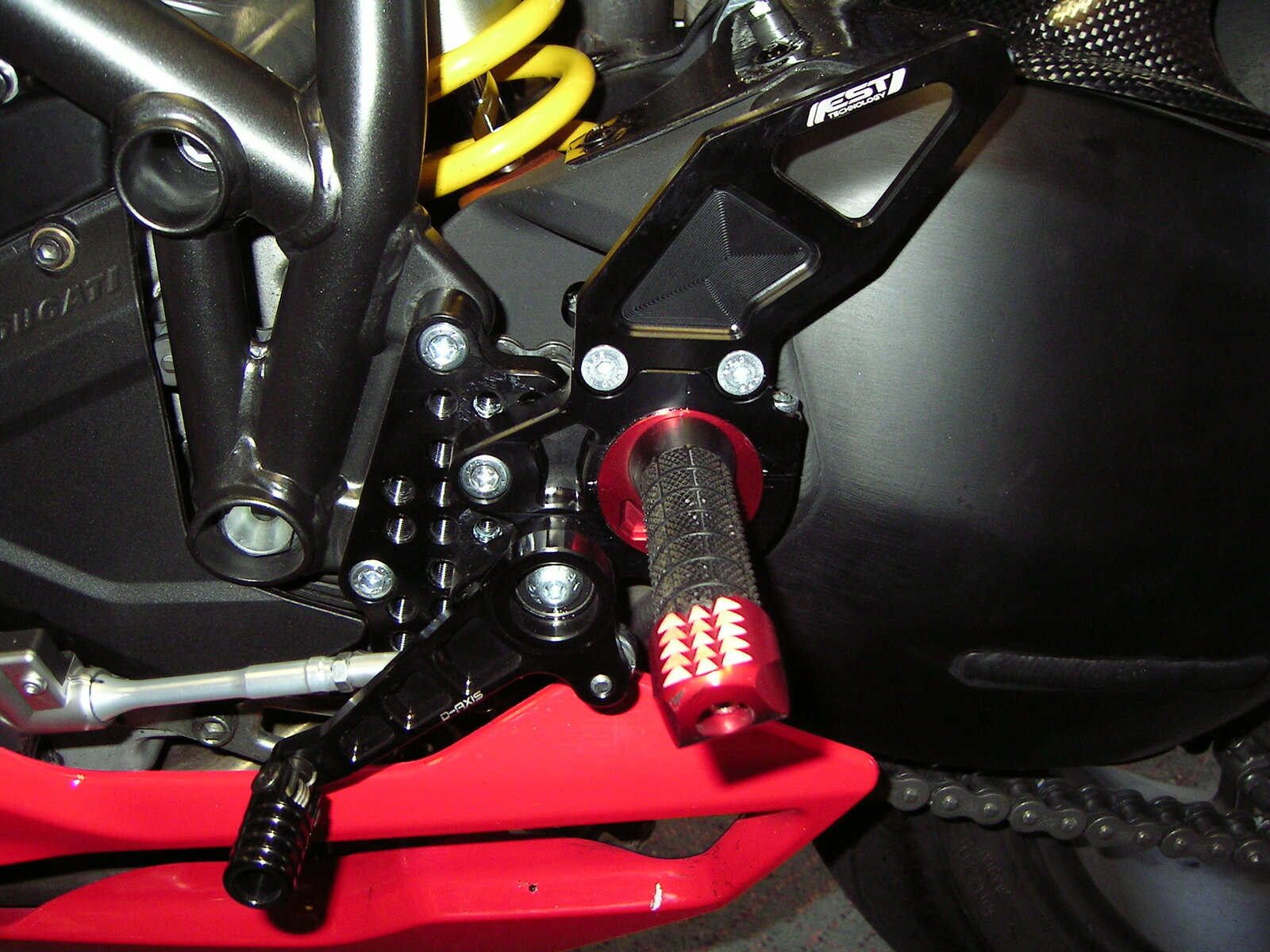

  2. SANY0055.JPG SANY0059.JPG Driven D-Axis Rear Sets. Amazing amounts of adjustability. Foot pegs also rotate on an eccentric
  3. I am 6ft 5", superpole seat and vario pegs.

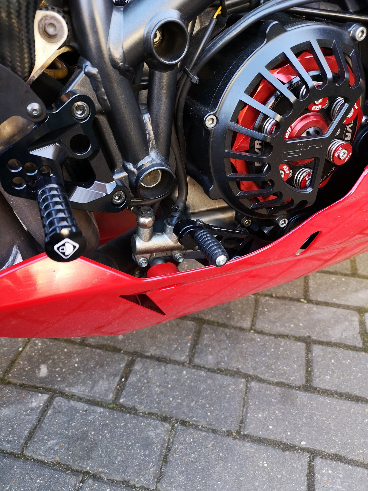

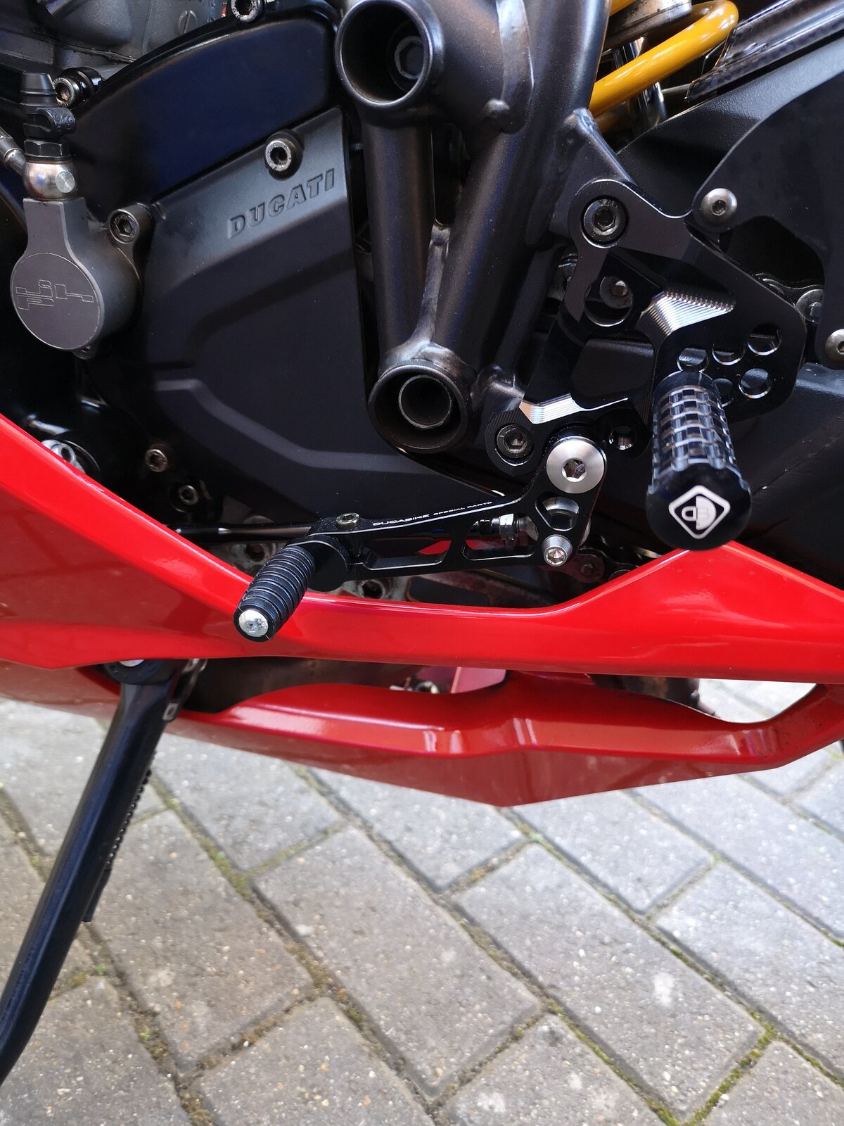

  4. All fitted and adjusted . Just waiting for extra adjustment plates .. Quite happy with the set up now though
  5. Look very similar to mine. Seems the Metaltech, Factory, Ducabike ones all use similar main plate, just the footpads and toe pegs differ. J
  6. Does your gear lever hit the lower fairing? I've just put the extra plates on for more adjustable comfort and the gear shift rod end bearing hits the lower fairing .... Only option I see is to put a cut out in the fairing
  7. Mine does too. I spaced the belly pan out by a few mm and it clears it now.
    Mind you, that is with a race bellypan and fairings.
  8. Cheers .. that's the option I was thinking
