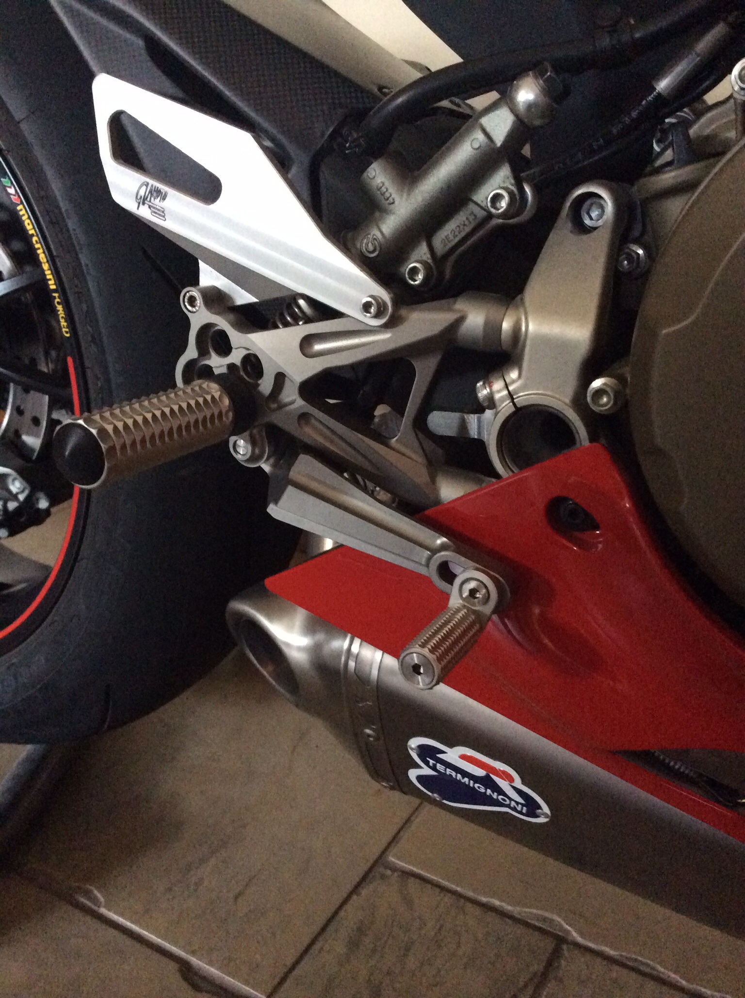

  3. Cupid, I agree with you entirely. Rear sets were, funnily enough, rear set when I was a kid. That's why I was asking how far back some of the aftermarket ones are now. 'Design Corse' posted pics of some really good looking ones on here but how far back. So basically we're both saying £500+ for bling pegs n gear levers? Think I've gone off the idea. Think I'll go on a carbon frenzy instead.
  4. On our old bikes the pegs were further forward. So rear sets pushed em back a fair bit. Modern day bikes have em set a bit further back so I suppose don't need to much adjustment on them. I like the Rizoma ones eyed them up today in pro twins :)

  6. If your about over the weekend could meet up somewhere you can try mine out as I have the rizoma ones fitted :)

  12. I have Rizoma rearsets on mine, they are quite plain compared to most but they feel nice under foot grippy foot rests and no problems shifting through the gears whether using QS up the box or down with the clutch.
