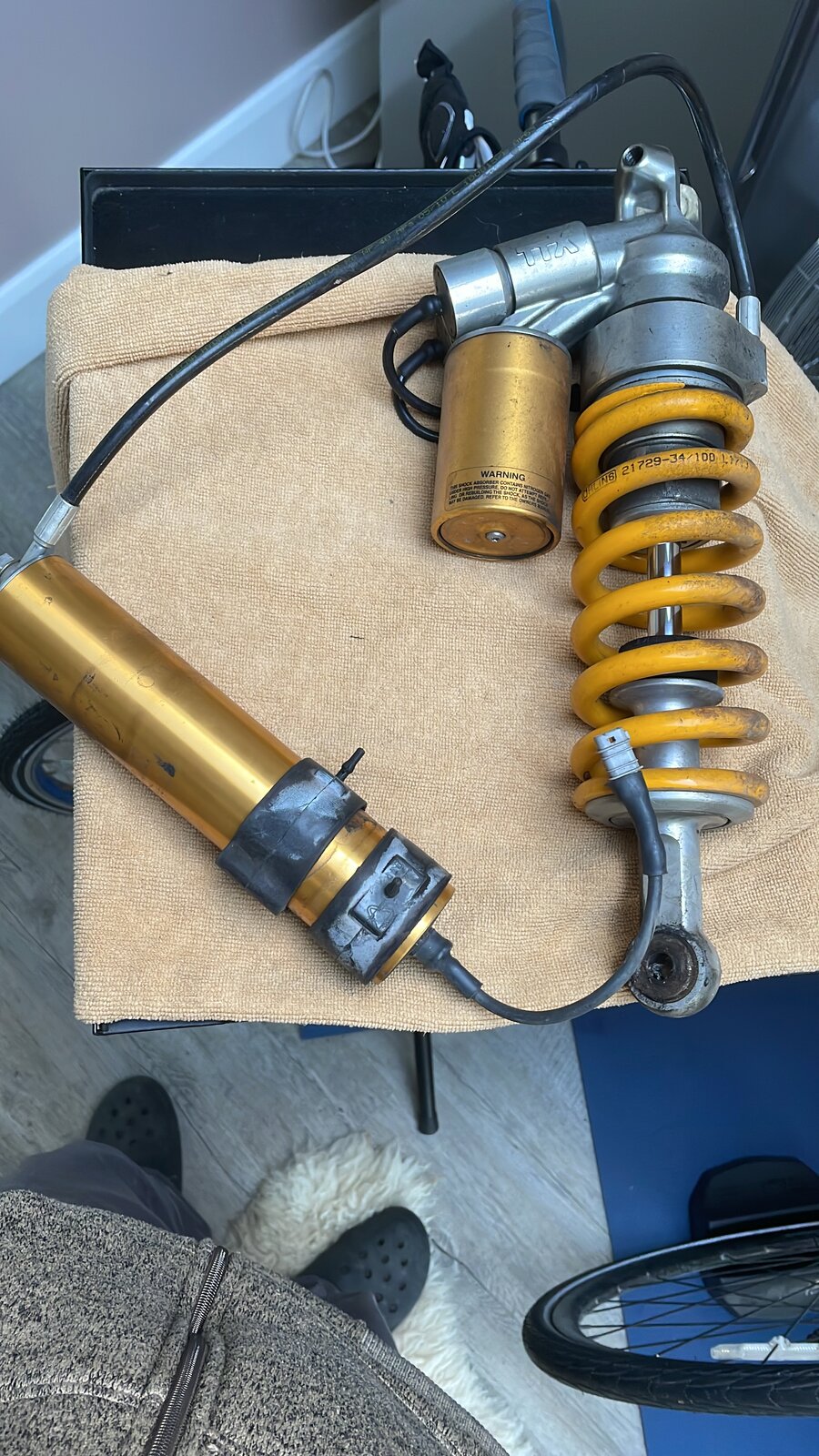

  8. Well, to dig up an old thread…..
    I took my rear shock out today as I am getting it serviced. on re-assembly back in 2018, I copper slipped the lower bolt, torqued up and then filled the swing arm recess with black silicone.
    took me 20 minutes to dig out the silicone with a penknife, then the bolt came undone with a 3/4” ratchet & hex socket
    Longest part was the gazillion bolts that to get the reservoir out the subframe/panels. happy Sunday 4730095B-5BB9-428A-B71E-DB43C878058B.jpeg
