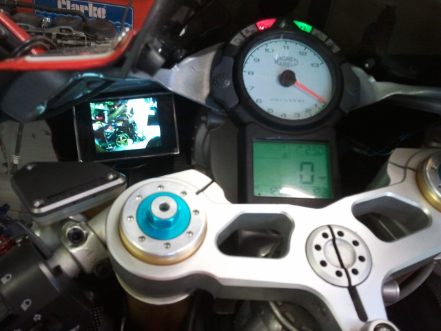

  14. So did any of you guys mounted theirs? I went for a big test ride today, I went to London city centre in rain. I must say it worked quite well main issue I had was I kept looking first where mirror should be to realise shit not there. After sometime I started looking in correct place 1 time out of 3 so needs work. Lol. I had cars on high beam right at my back I could still see car, I had a big scooter thing with I think high beam on right at my pipe as well, all worked I could still see riders head. I need to get around to test night operation where I am actually on the road. Might do that on Friday.
  15. sorry about the pic took it on my phone wile holding the camera with the other will post more when done
  16. its a 3" monitor form china cost £14 i got two of them one for each side of the clocks with the cameras mounted under the seat
