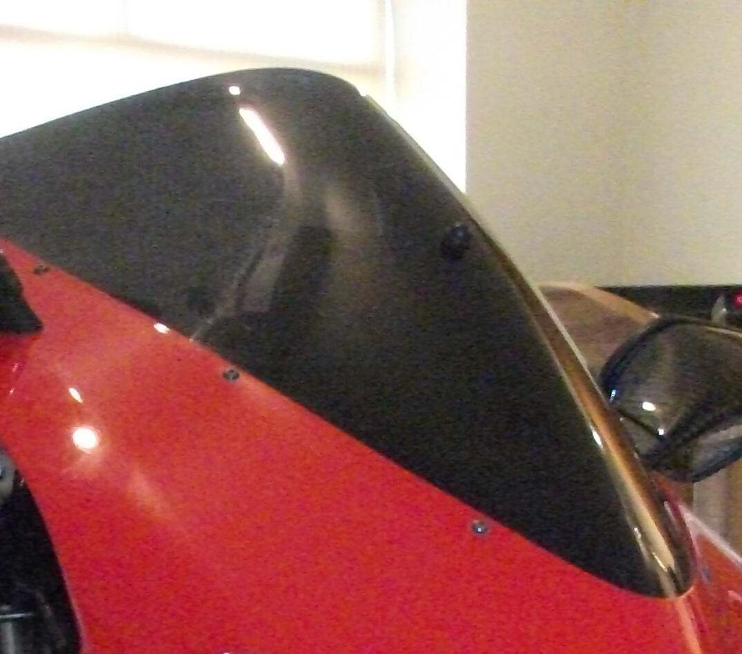

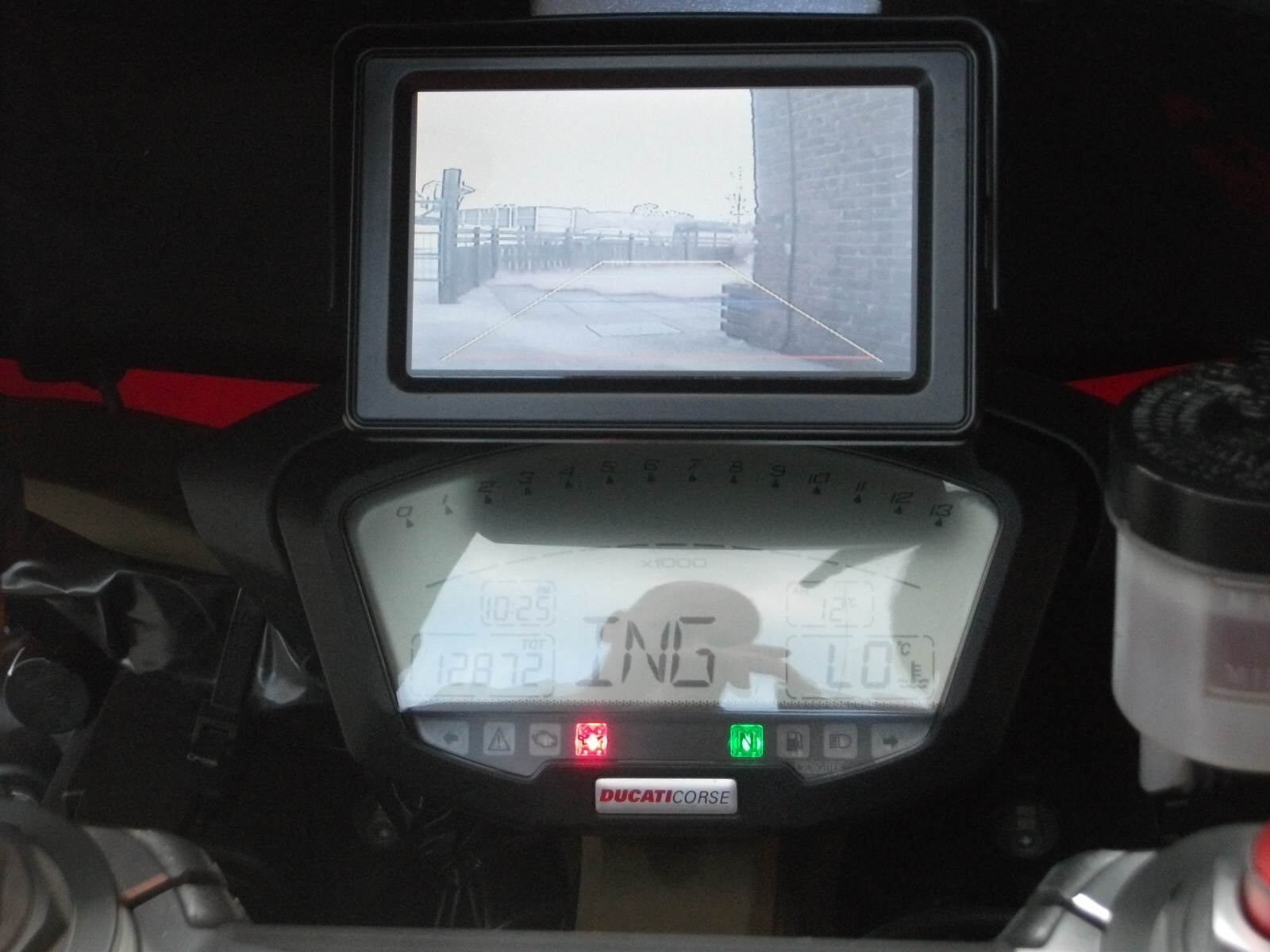

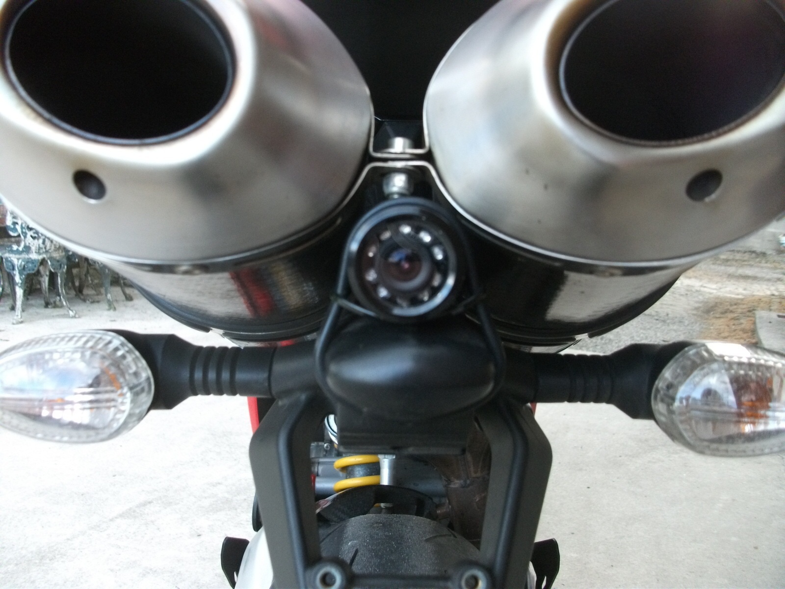

  12. Yes I did this on my 1098. It was a real life saver at times. I only bought a cheap wired system off ebay for about £40. You can get the wireless ones which may be easier to install rather than messing about running the wires from the rear camera to the screen up front. I mounted the camera just above the number plate light. There is no ideal place to mount the screen I had a dark tinted screen on my bike which I drilled a hole through and mounted the screen on the backside just above the dash (see last pic). The dark screen also prevents reflection when it's sunny. I left my mirrors on aswell as it all helps. You don't get HD quality but it's good for keeping an eye on what's sneaking up behind you in that blind spot, which lets be honest is a huge blind spot. It's especially good for spotting other bikes coming up behind!.

  18. Yes. I ran the wiring from both the camera and the screen to battery then my mate who's an auto electrician wired it though the ignition so it turns on/off with the key. There is no reverse wire so to speak. I think the way it works with a car and reverse is, if you wire it to the reverse lights, when you select reverse and the reversing lights come on so does the camera. Obviously a bike hasn't got reverse so it's not an issue. The trickiest bit about fitting was running the wire from the camera back to the battery. I took it through the number plate holder, under the seat unit between the undertray then under the seat to make a neat job.
