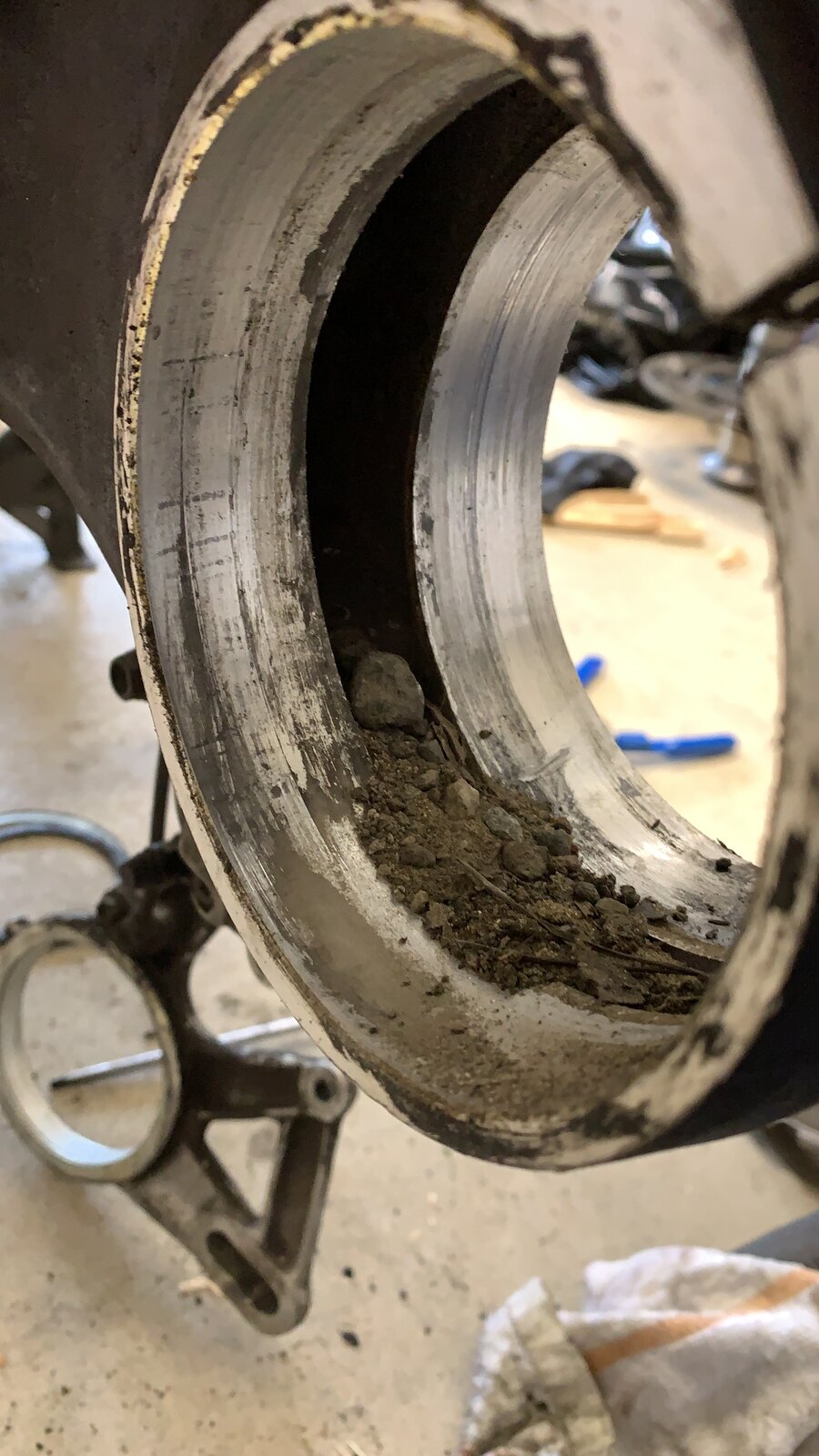

    Just getting round to doing mine.
    So I’ve found mini boulders inside mine !!
    There is another hole about half way along the swing arm too. So will need to plug both of these to prevent this happening again.
    Anyone drilled out the drain hole yet ?

    Been meaning to get to this for a long time. Glad I did now !!
    Never been off-road either !!
    Getting the hub out was a mare. It’s cleaned up fairly well luckily but still some scores.
    Think I’m going to plug all three and maybe make he drain hole slightly bigger should anything ever get in.

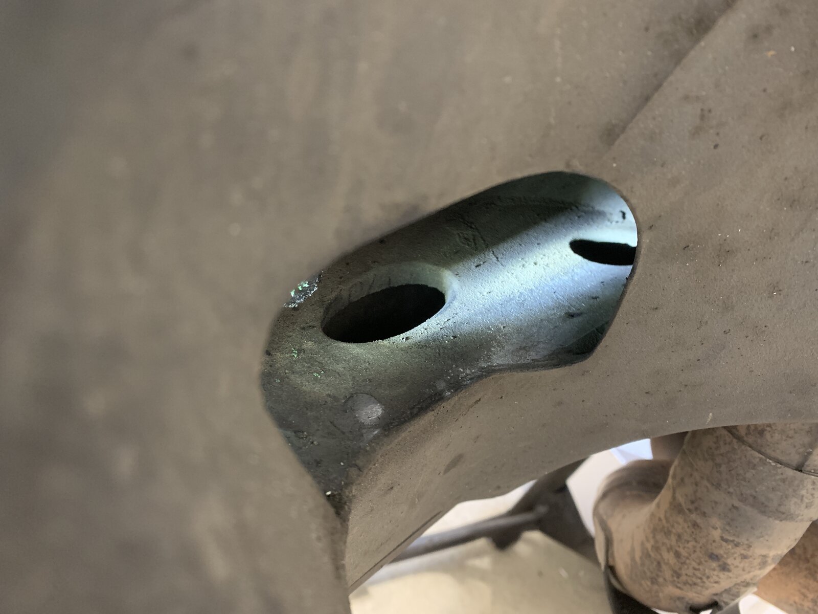

  8. It really isn't the best design! What a shame they weren't plugged from new. I thought I'd resolved the risk of crap getting in but may have to re-visit now :confused:
  9. The DVT models dont have the large hole at the front, but still have the two large holes in the hollow section, I've cut and shaped an old oil container and bonded it over the nearest hole to try to cut down the gravel ingress, Ive scheduled to pull the hub again at the end of the year to inspect/regrease so I;ll see whats in there then, hopefully LOTS less than last time

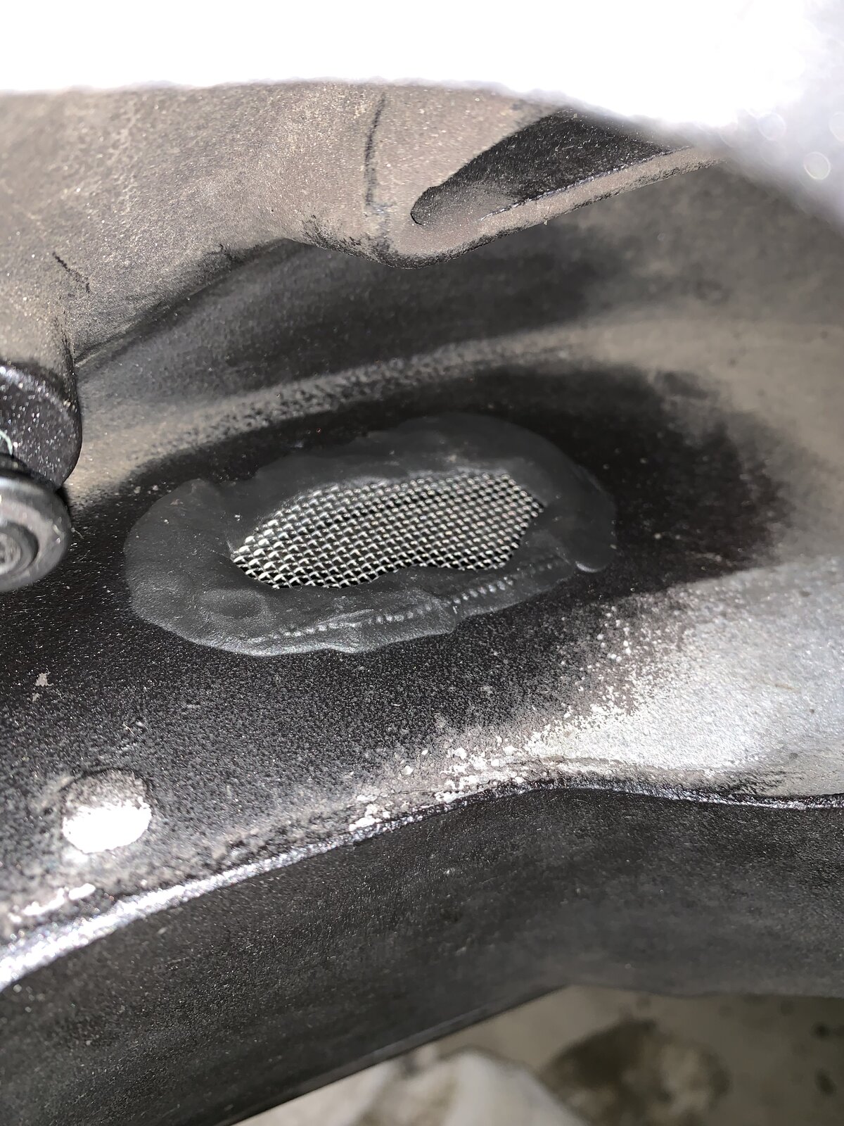

  10. Some sugru and stainless mesh. Other holes are done in the same way. Nightmare to access it and all done with eyes shut and tongue out to concentrate

  12. Think it’s part of the casting process. I personally made the drain hole larger for water and any debris that may still find its way in. But more aware now and keeping an eye out and checking the drain hole going forward.
