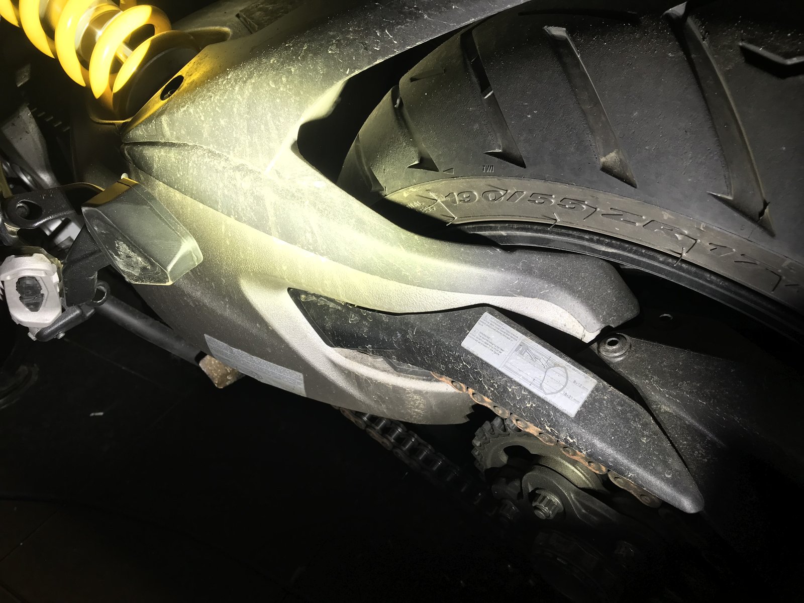

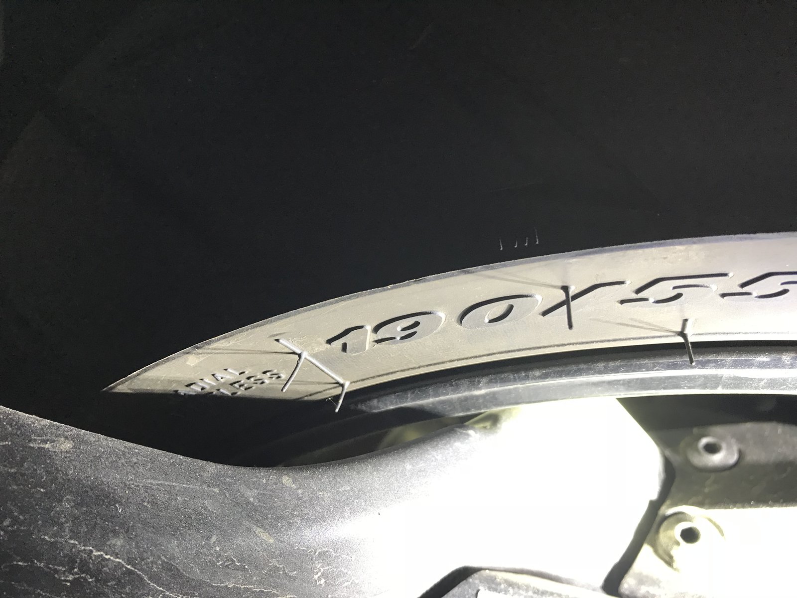

  2. Well, arrived at dealer this morning and they wouldn’t let me ride the bike away. Concerned that something was amis with the rear brake line or the ABS line. So I spent the day blatting about Derbyshire on an X Diavel S with open Termis! Got back and spoke to service desk and it turns out that when the mechanic routed the Scottoiler feed pipe under the cover, it shifted the cover to the right and into the wheel rim. You would have thought he might have noticed that when finishing the job? Anyway, feed pipe now rerouted on outside of swingarm, which looks awful. Either they will have to reroute it or I will. They will have wheel refinished or replaced. So what have I learnt from this excercise? Don’t bother with the Ducati Branded Scottoiler. Better still, don’t bother with one at all. I have used them many times over the years and every time came to the conclusion they were more trouble than they were worth. When will I start listening to my own advice?

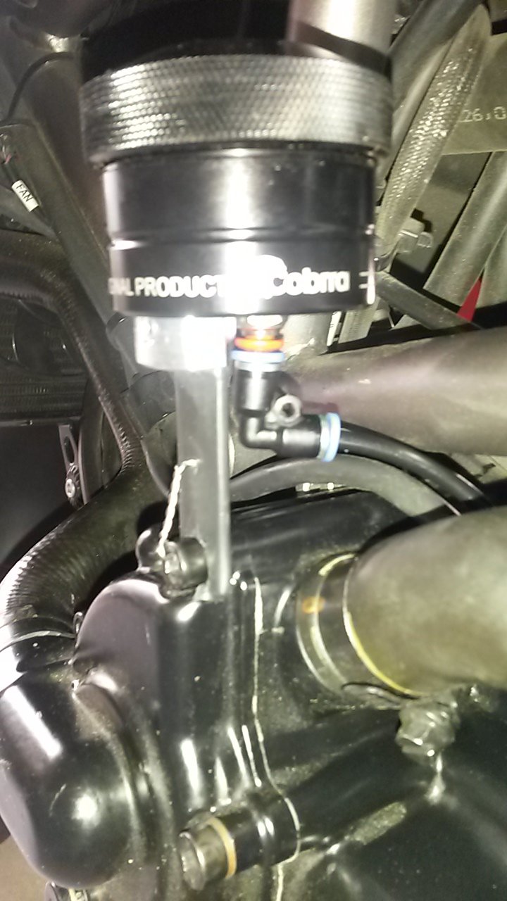

  5. I have used the NEMO II chain oiler too and thought it was a great little device. I was seduced by the idea of the Ducati Scottoiler by the salesman (when will I learn!). As the comment above, I remember a salesman at a HONDA dealer telling me the same thing, when bikes came in as P/X the first thing they did was to remove the Scottoiler and throw it in the bin! Still, it’s on now and other than rerouting the feed pipe from the ridiculous position the mechanic has put it in, its staying on the bike!

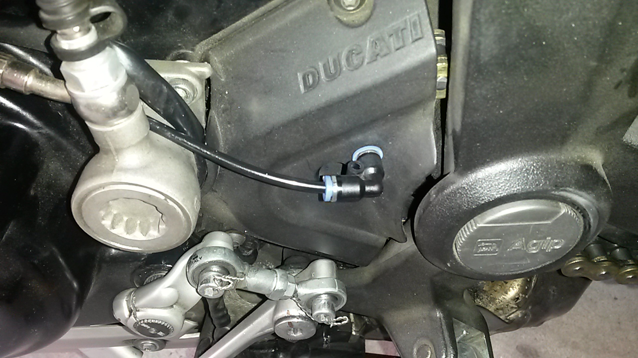

  7. Aero, what's the plug you have in the swinging arm pivot ?
  8. a scewingcap of a Agip permanent special coolant container
  9. NEMO works on the principle of compression (3minutes/200km), the oil is displaced under pressure (it does not flow out by gravity, read instructions
