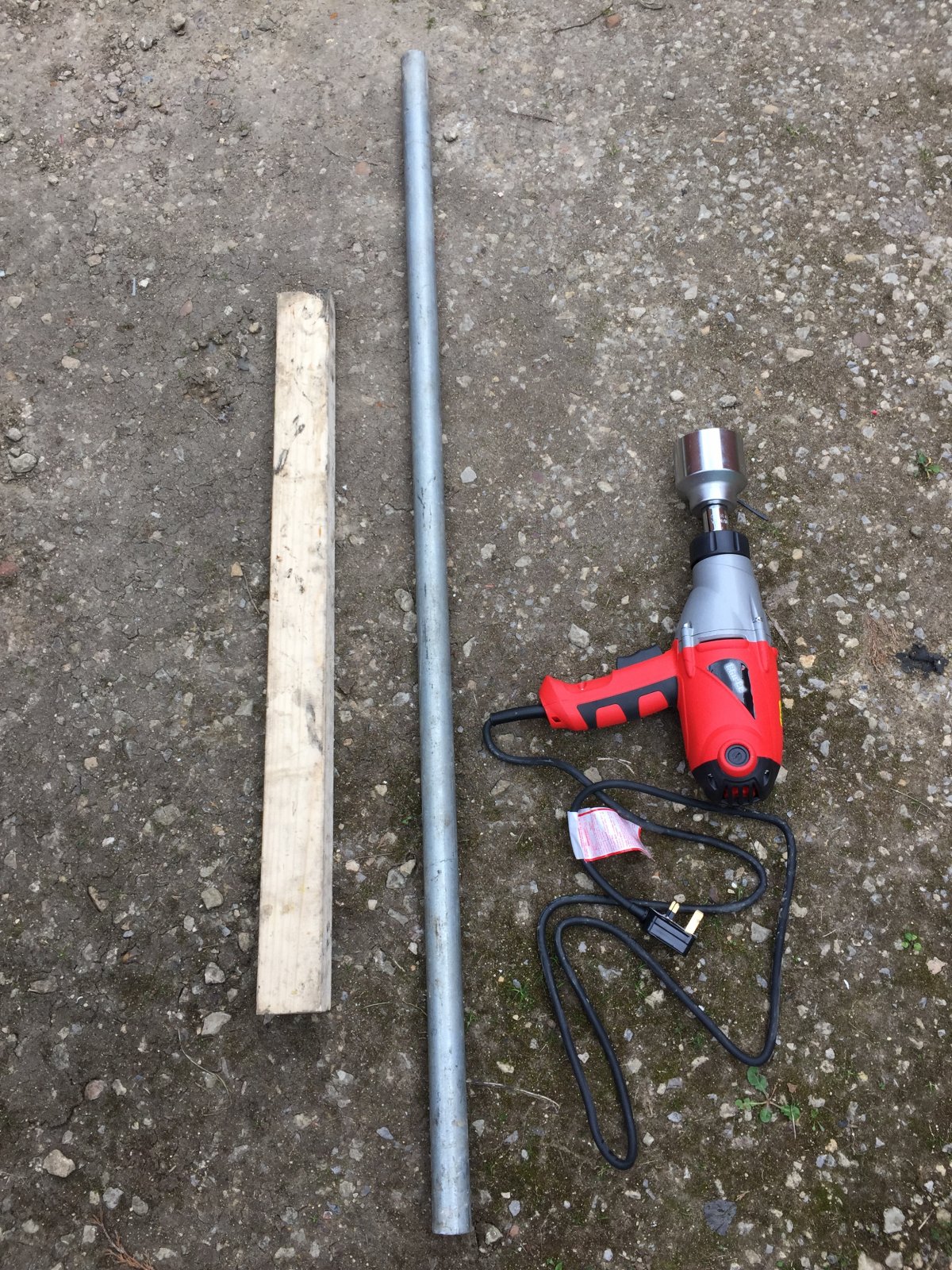

  3. I have had both sides off using a Clarke CEW1000.
  4. Old 5 foot bar and wooden wheel blocker versus new CEW1000, works a treat lol
