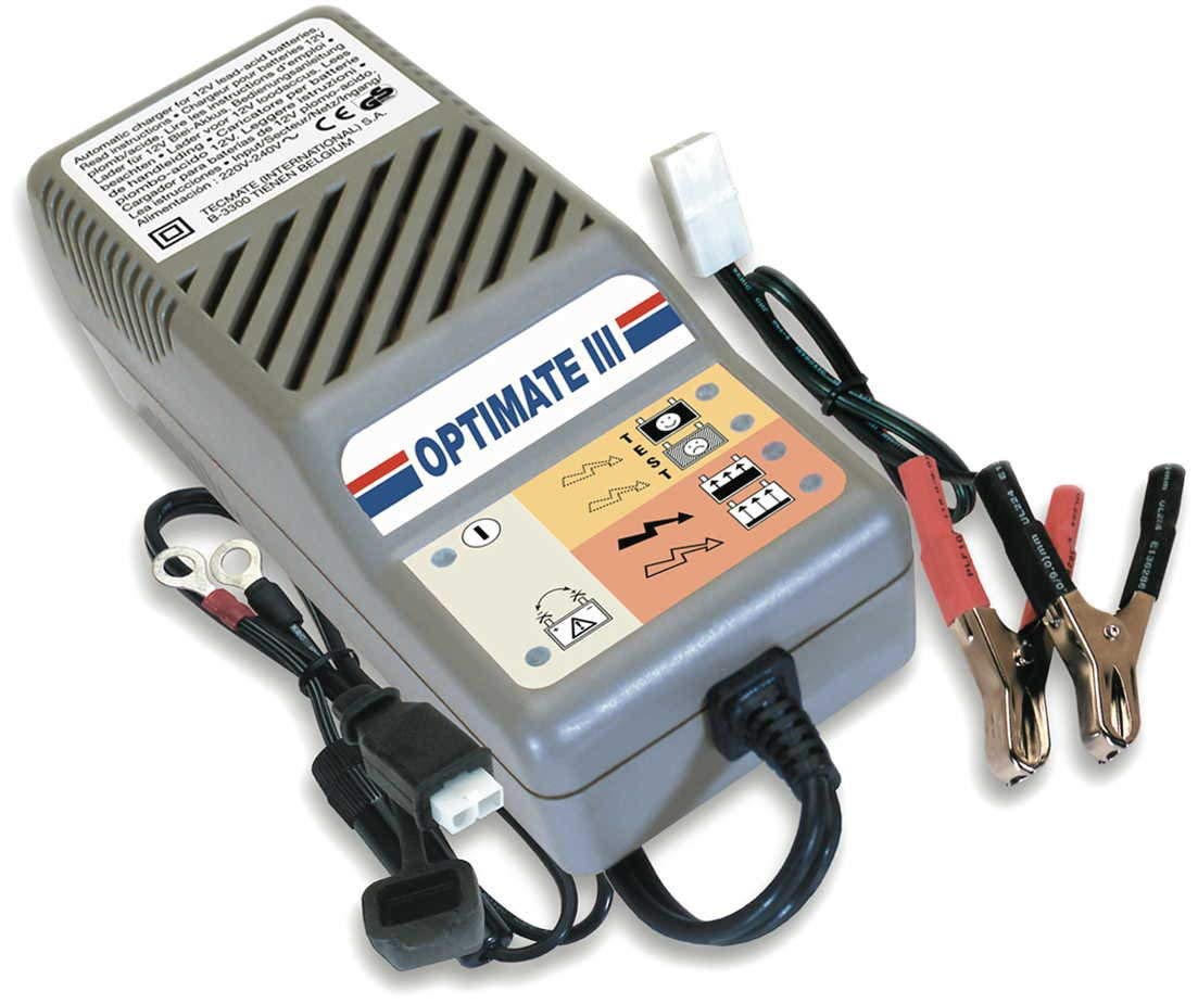

  2. This is the Tamiya Connector, I've just pulled the Optimate out of the cupboard, I now recall that the bike side got left on my VFR when I traded it (dumb move). However, this connector type is easy to find on eBay etc so making up your own shouldn't be a problem. You can, as I understand it, connect direct to the battery terminals. What I do have is the croc clip lead that came with it, this has the corresponding Tamiya connector. You could snip off those croc connectors, add some eyelets, attach to battery terminals being mindful of polarity (though the charger does have reverse polarity protection), and you should be good. IIRC the croc clips were off another charger and the polarity (according to the sleeves on the clips) is the wrong way around for the Optimate.
    Alternatively, one of these and one of these and you can plug straight into the Ducati diagnostics plug if you bike supports charging that way.
    If your bike already has an SAE connector then just buy the £7.99 adapter (check prices elsewhere, might be cheaper). If it already has a Tamiaya Connector then you don't need anything.

  3. Do bear in mind that the one I'm offering here is an Optimate III, like the one below:
    This maybe the same as the one you already have. Have been using this up until a few months ago to keep the original regular battery from the MV topped up, so it does work.

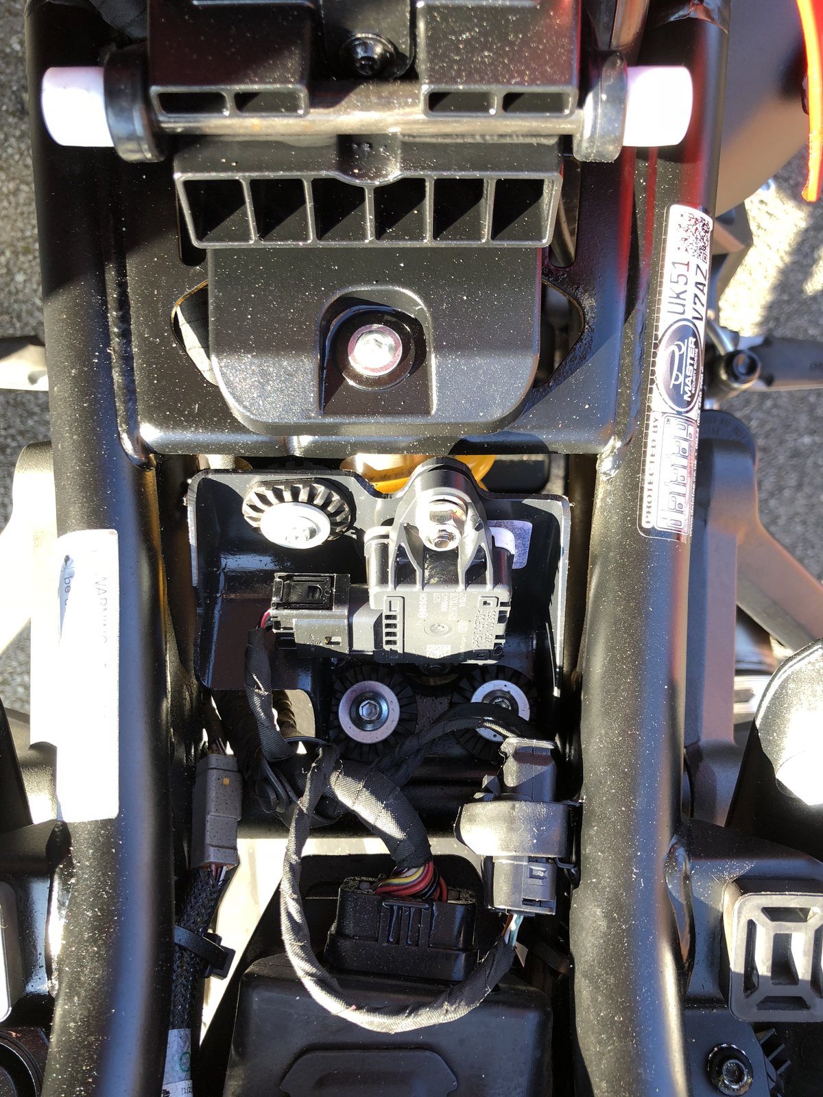

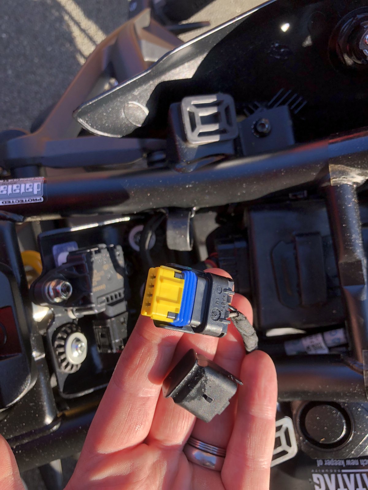

  9. I found this cable under my seat. It’s got a nice rubber strap and when you remove he cover the yellow connector is revealed.

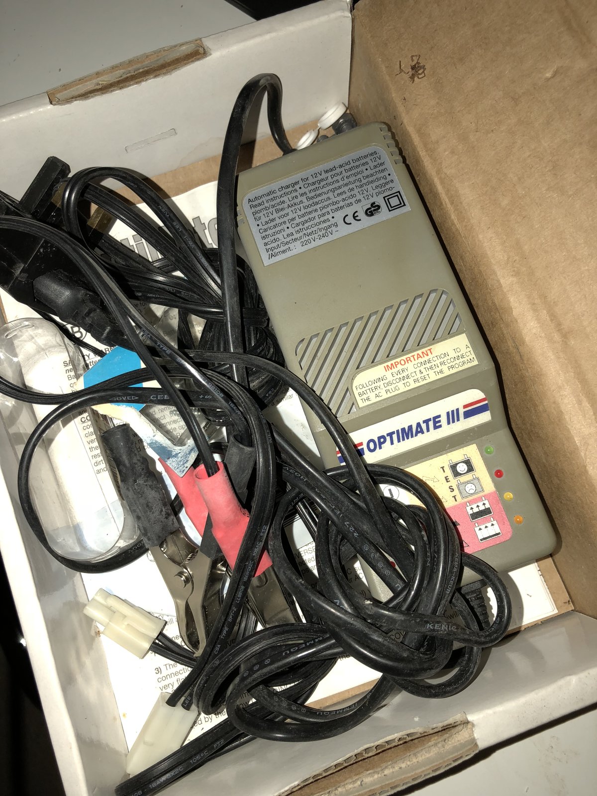

  13. Imagine my surprise, nestled in a box in the garage straight out of 1999! It’s missing the cable that connects to the battery, and I will need a converter to convert the Ducati data port thing. It even switches on! What am a losing out on comparing this to the most recent version?
  14. I’m still using the Optimate III on the Scrambler and the NC29 without any issues. Andy
  15. Good to know, cheers Andy. It’ll be quite nice to make use of something linked back to when I first used to ride. Cheers

  16. Good to see, same as the one I was offering. If you really want to connect via the diagnostics port then you will need to stump up for the right adapter. Maybe a proprietary connector.
    Is connecting that way any different, at the end if the day, to connecting directly to the battery terminals (other than convienence and possibly neatness)? I'm lead to believe that there isn't.
    You have the Croc clip lead, easy to convert this to a direct to battery lead with some eyes, heatshrink and crimp tool. Though ideally an inline fuse should be included.
