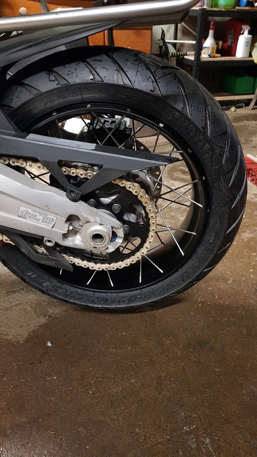

  7. Chain should be decidedly loose on the Enduro, the measurement from chain pin to swingarm is 56 to 58mm. It's in the manual. Bike is supposed to be in urban setting, on sidestand and lowest preload.
  8. 56 to 58mm on the Enduro. i.e. loose!

  11. 56 to 58 is what it was set to. Manual and swing arm sticker states touring mode default suspension settings on side stand.
    Anyway I went out today and checked it again. Somehow slack was only 40mm so I did it all again. This time it's sorted ok, no idea where the mistake was made before but it's sorted. Only difference is that this time, after it's all sorted, I've measured the chain to swing arm whilst on the main stand so it should be easier to do in the future.
