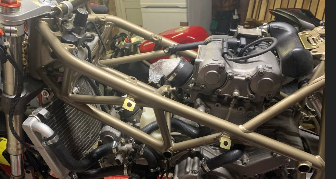

  13. I have the scabbing on my frame in places and it annoys me. I like my bikes patina but these scabs are all around welds etc. Its only surface and flaking paint, its not serious. But I'd like to do my frame but I dont want to over restore my bike as I like the war wounds as they are all mine. Besides, I'd get carried away and before I knew it I'd be into it like a money pit. If anyone has a recommendation as to what type of paint is best to keep it as oem as poss and whom, I'd appreciate it. I'm going to break down the 916 in the summer and keep it in as big a chunk as possible. Ie front end complete, rear end complete and engine complete with only the frame getting a full strip down. All my mechanicals are in great knick as Ive mostly removed most of it over 20 yrs and greased it all up.
  14. i know the feeling when you see the scabs on the frame only too well! i had my 996 done by DW Automotive in Bristol, Del who runs it is a top bloke and has made his way through dozens of 748/9*6's (although not sure if he's based a bit far for you), pic below of mine. Problem was, once he did the 996, i ended up stripping my 916 ready for painting, once you see them coming back all spic and span all you notice is the other parts that need doing!
    @regcheeseman keep the pics coming mate, the best threads IMO are these sorts of resto's :upyeah:
  15. I'm having exactly this issue, the scabby frame is staring me in the face, I promised her that it wasn't 'another project', I could touch it up, but to do properly it needs to be stripped to the frame and whilst the engine is out.....and before I know it I'm stripped every bracket and every single fastener and re-plating them. Maybe I will put it back together and ride it....
  16. I agree Reg, but if we dont do it now it will only get worse. That is why im going to strip mine in lumps. Front end, rear end and engine. My engine is a tight little unit. Has had a full monty and the galley plug work done in past. So no issues there. My forks are ohlins fg43. The rears been in bits, greased up and reassembled. So i dont have any real issues. Maybe engine paint but i like its patina here. I dont plan to change that. So im convincing myself at this juncture, that it is frame only. As part of a planned preventative maintenance schedule for a 22 yr old bike ive had for 20 of those yrs. Am i kidding myself? Maybe.

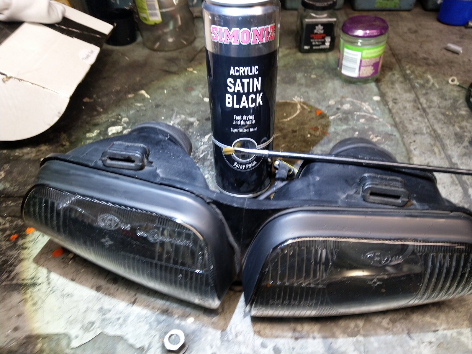

  17. Slowly going through bits and pieces, removed the quickshifter and made good all the hacked into wiring, removed the headlights to inspect the wiring behind, diagnose the neutral light and repair the thread that isn't holding the upper fairing/mirror mount in place.
    A few corroded terminals cleaned up and a helicoil fitted to the fairing stay mount.
    When the lights were out I noticed the black surround on the headlight lens was chipped and flaking so couldn't leave it like that so a bit of satin black aerosol sprayed into the cap from the can and a fine paintbrush resulted in a fairly tidy result. IMG_20210324_203229.jpg
    With the headlights refitted I turned my attention to the carbs and wondered if it would benefit from a throttle balance, as it has always gave great results on my previous inline fours, I cracked open the take off plugs and left it there as it was getting late and playtime was over for this evening.
