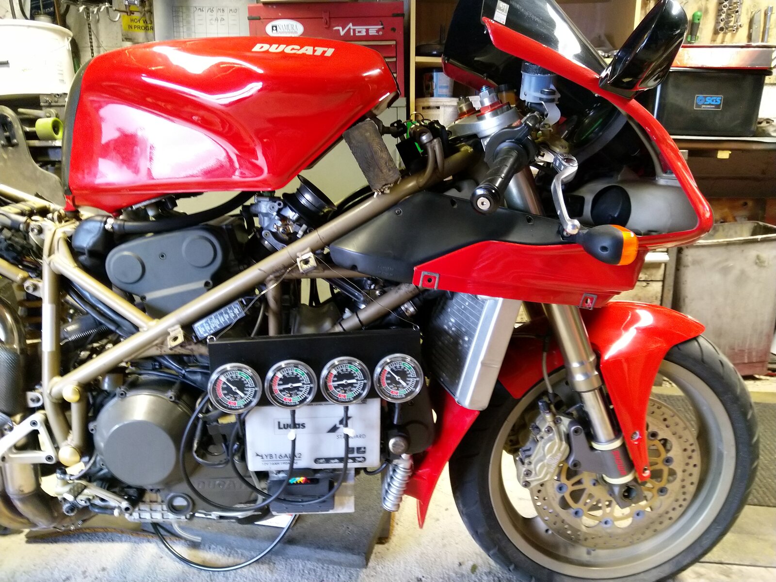

  1. Synchronised the carbs today, they were out by a bit and the engine runs much smoother as a result. Hooked my guages up and propped the tank on a bit of 4x2, every garage has chunks of oily 4x2 stashed around.

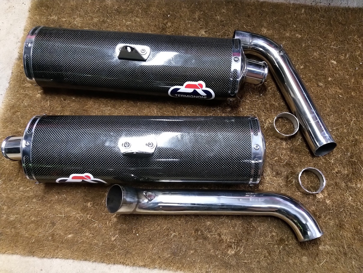

    Released all the brackets on the pipes, there's no way they are ever going to sit right, the only thing I can think of doing is to cut the cans off the pipes, rotate them straight and then weld them back on, I've got a TIG so it should be cleaner than the original blobby mess.

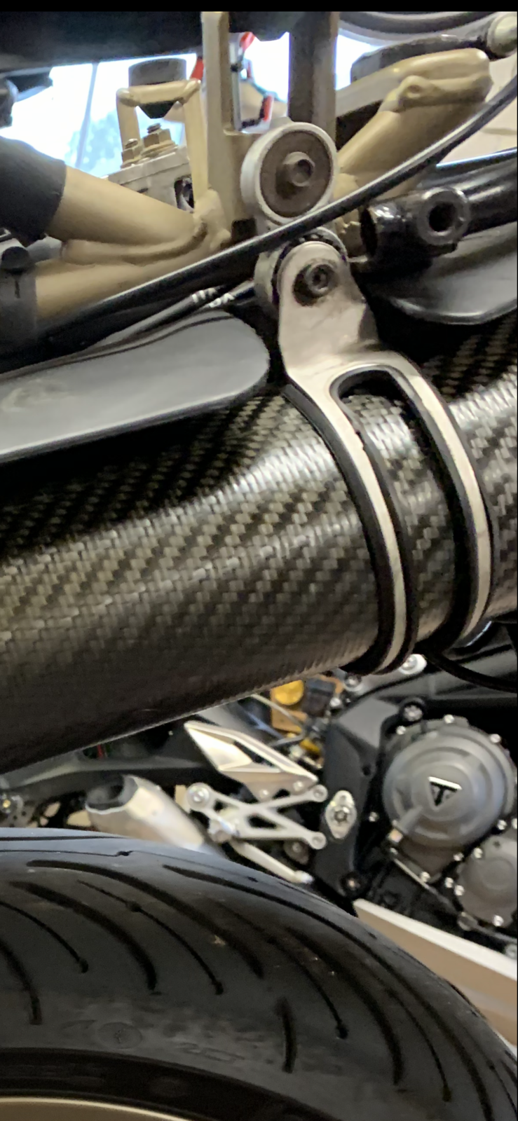

  2. You got the correct bracket mounting? Below pic of my 916 if it helps
  3. I've got the same bracket on my subframe, my cans don't have straps but an L shaped bracket on top of the can. Regardless both cans are twisted the same direction. Its like the collector is wrong but it isn't unless it's from the wrong bike. Nothing is twisted or bent???
    It seems like rotating the cans on the link pipes will be the answer, then the (bent to fit) l shaped brackets can be straightened and will fit how they are supposed to. Perhaps this system was welded up Friday afternoon after a lunchtime session?

  5. Chopped up some expensive silencers
    Polished the pipes and cans up, for a reputed system they are very poory fabricated
  6. Nice project! What make are those cans?
  7. As i recognise those cans on the hinges and carbon weave, the brand is BOS.
  8. I don’t think they’re Termi. The ends look wrong as does the carbon fibre :thinkingface:
  9. Like said in the previous post they are BOS and have a E type approval, which is highly recommended in Germany.
  10. That would explain the poor fit and construction, not sure they are BOS, there was a makers mark, no e mark though.

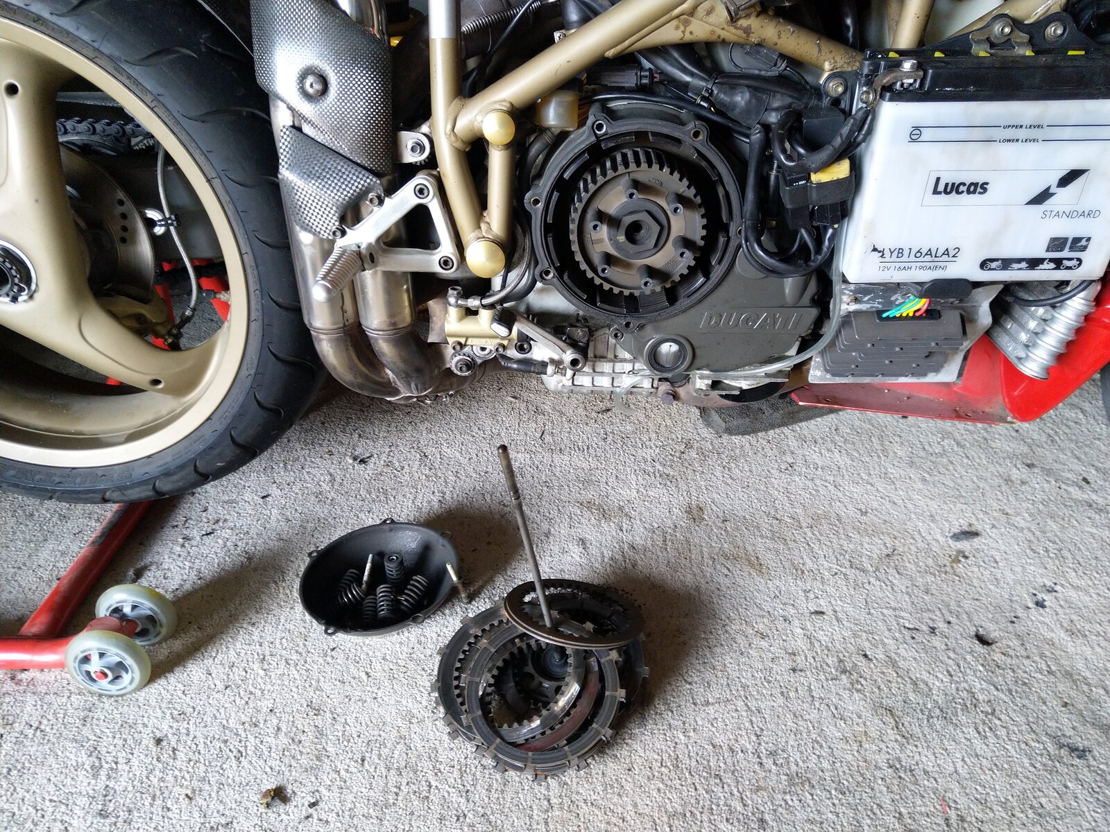

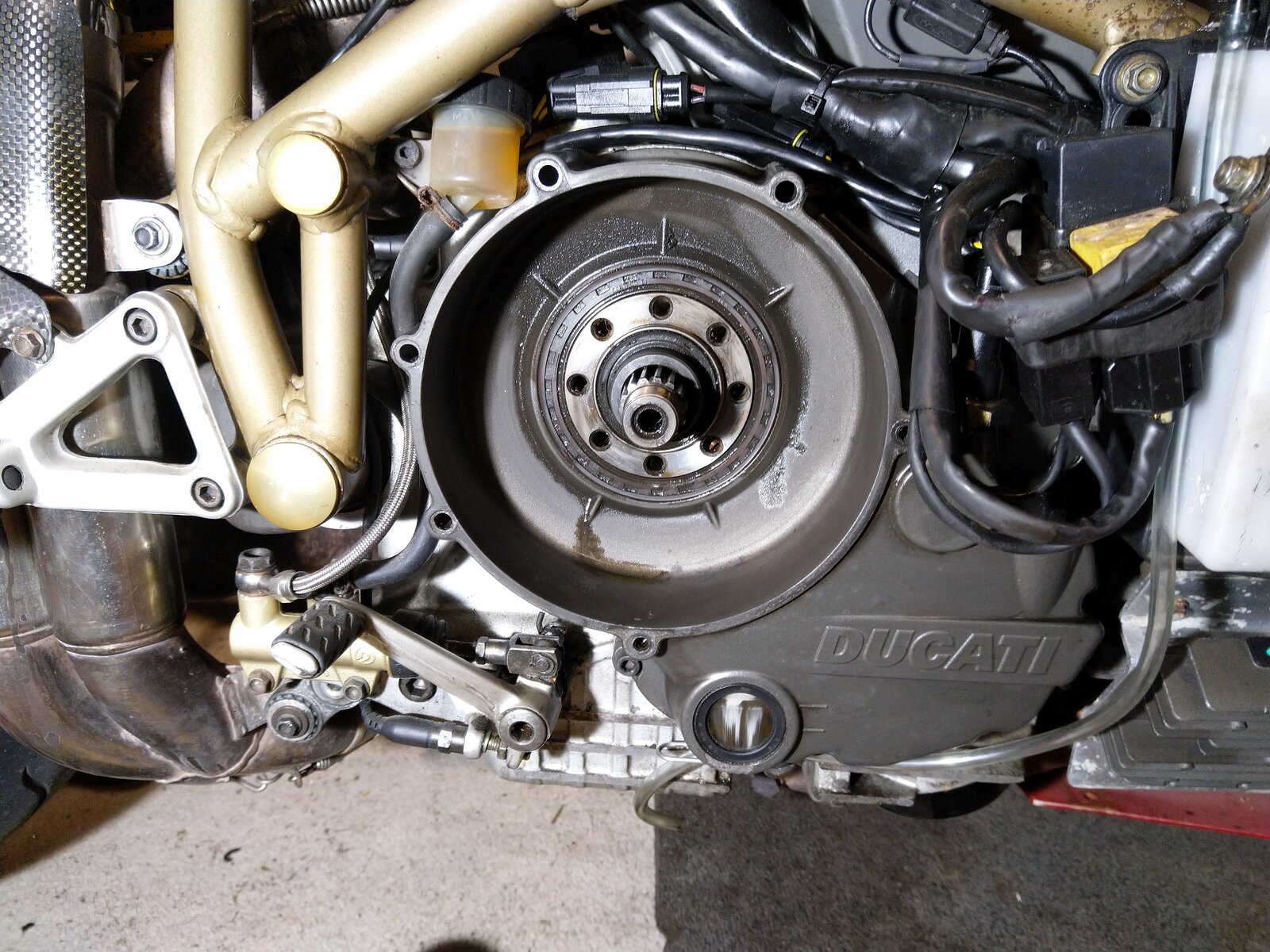

    MOT day today, the run to the station started OK but a few miles in and I was losing clutch, slipping when pulling away or anything over 3000rpm.
    Made it there, got the pass and rode home gently.
    10 mins after getting home

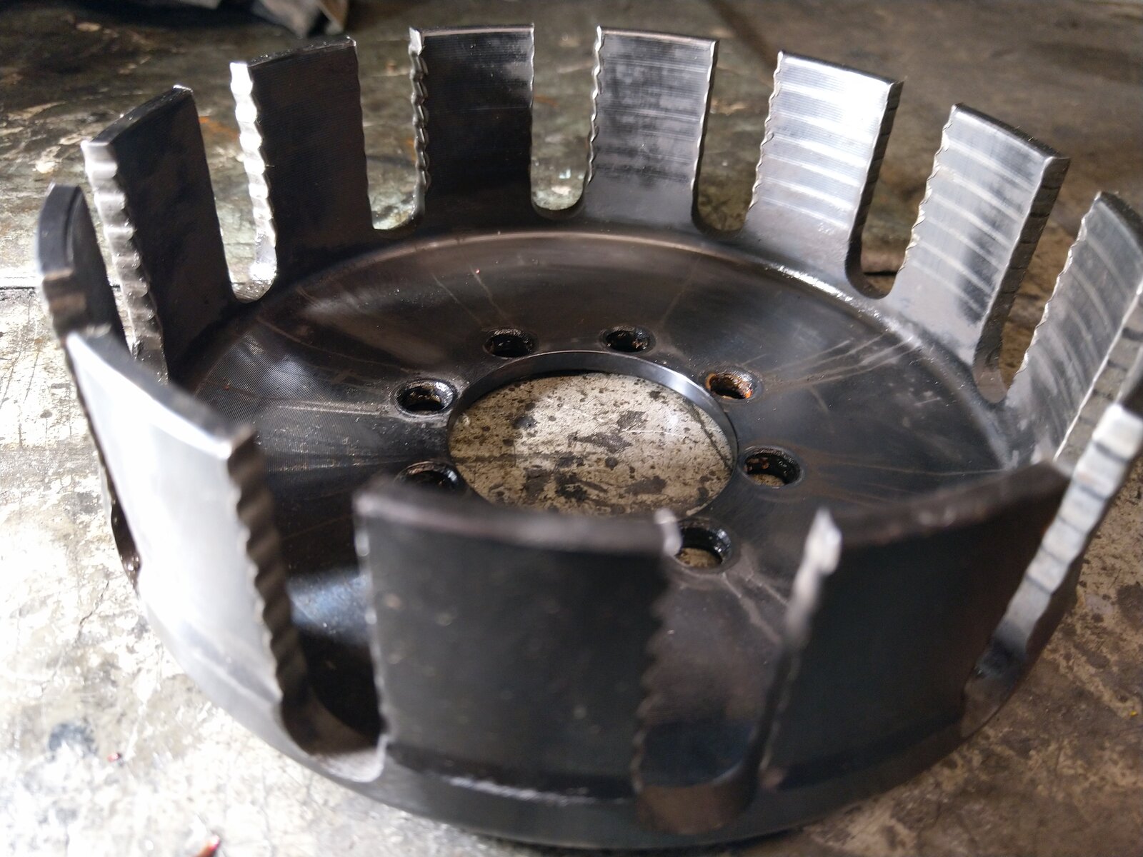

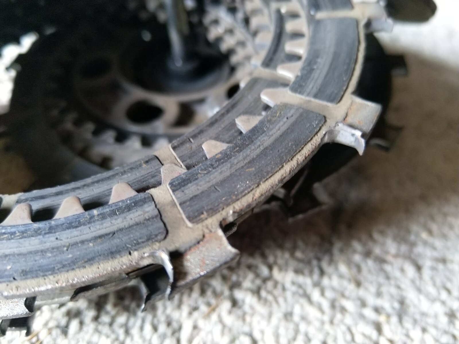

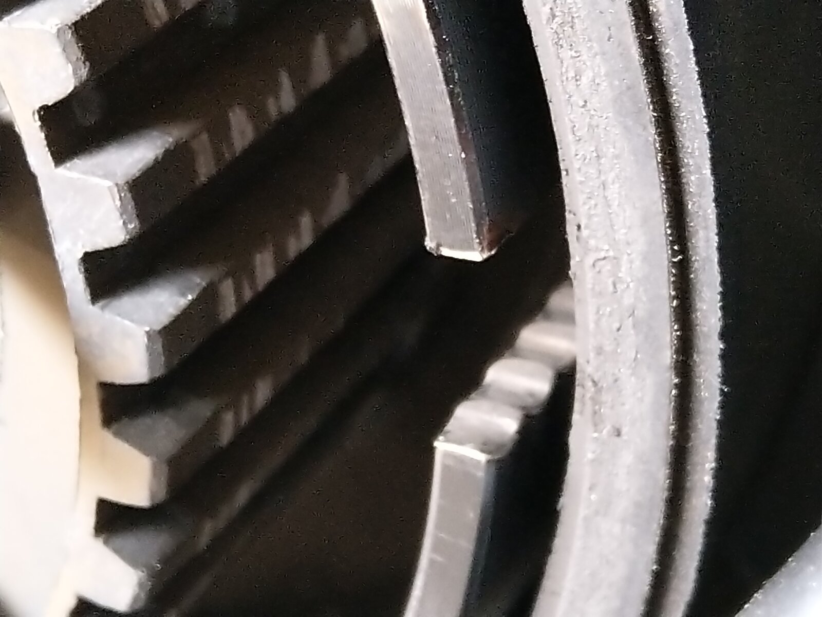

    So easy to work on, the Dewalt rattle gun made quick work of the clutch, basket and hub don't look good IMG_20210413_143918.jpg
    And the plates are hammered

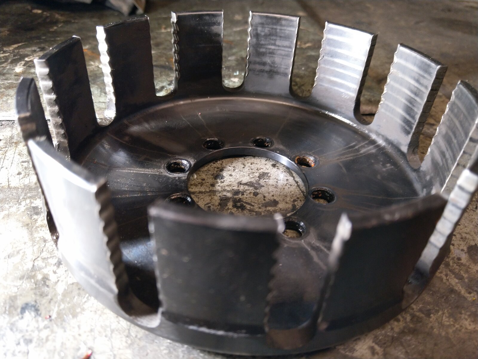

    Stripped and cleaned
    Is this basket OEM - no ducati marks anywhere that I can see
    So what are my (sensible budget) options?
    I'm thinking about filling the basket and fitting new friction plates but the experience on here may have better ideas? Quite fancy an open clutch cover, do these make the death rattle even more pronounced?
  14. If it were a dirt bike I would tell you to file down the basket and go to town.. but not sure how nice it'll feel on a road bike.
  15. If its a steel basket it’s probably original oem, if you fit an alloy basket you need to also fit alloy friction plates to match . I recall ST4(S?) had alloy basket & plates as oem but thats an old faded 10yrs memory from when i fitted an aftermarket MPL? Alloy basket to my Superlight. PS are those D207s the GP version or the cooking /plain street vers? Just reminiscing about having the GPs on my old 916 , they were a good tyre in their day much like Mich TX11 Hi-Sports . I wonder how they would compare to current fast road rubber .
    #55 Macca, Apr 13, 2021
  16. Not a steel basket, friction plates are alloy - thought most clutches were alloy/alloy but I've only experience of jap stuff?

  18. Just been out to check...
    Steel basket and steel friction plates
    7 friction and 9 steels, I'm guessing this isn't standard, just an extra steel bodged in to mask a failing clutch?
  19. I think there was a "quiet clutch" mod that put an extra steel in (1st) posted around the ducati webs a while ago. Needs checking for detail/accuracy, I recall I may have seen it on ducati.ms an eon or two ago, yup loads of posts on there about it. Update, looks like its an extra friction plate in 1st ?.
